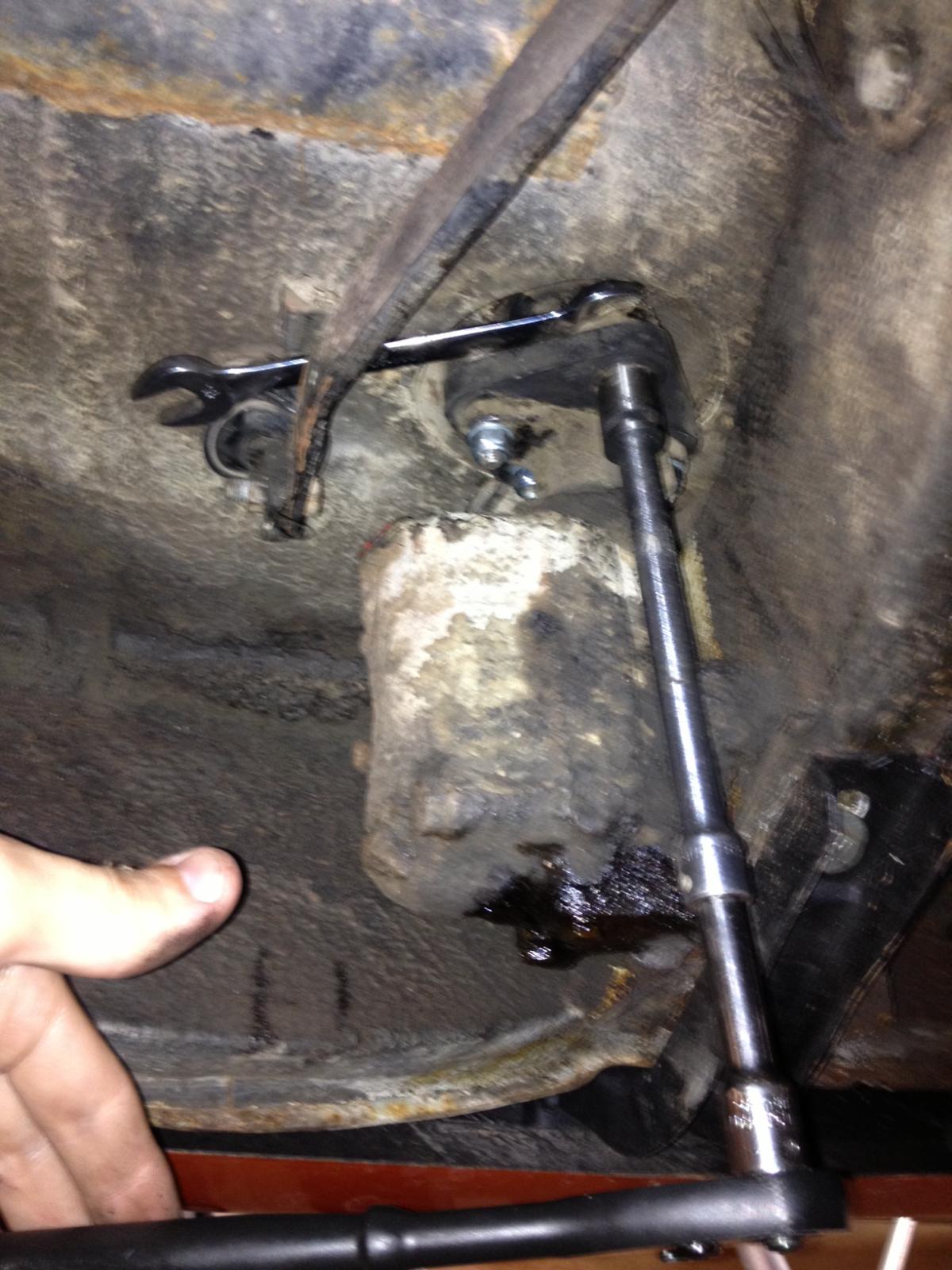

from below. You have to remove all four bolts and the one that holds it to the steering gear. Then replace the puck and put everything back. The steering may be off by a tiny bit if you rotate the steering at all while that one bolt that holds the clamp to the steering gear.
ivwshane
Joined: May 19, 2011
Posts: 1920
Location: Sacramento ca
ivwshane is offline
PostPosted: Wed Apr 10, 2019 5:32 pm    Post subject: Re: Steering Coupling Disc 211415417 (coupler) Reply with quote
Do I remove the one bolt first? How do I keep the column from moving while trying to remove the nuts?

I was then going to try from above but the metal collar/cover isn't large enough to move up the steering column.
That's odd, you should be able to lift the cover with the column in place on a late bus. Try harder, once it's up you remove the 4 nuts and their bolts and slide the coupler out sideways, no need to remove the yoke from the shaft.
Let your backwrench contact the clutch pedal and prevent the shaft from turning.
Never work against the steering lock. I haven't buggered one myself, but Bentley is pretty cautious about it.
