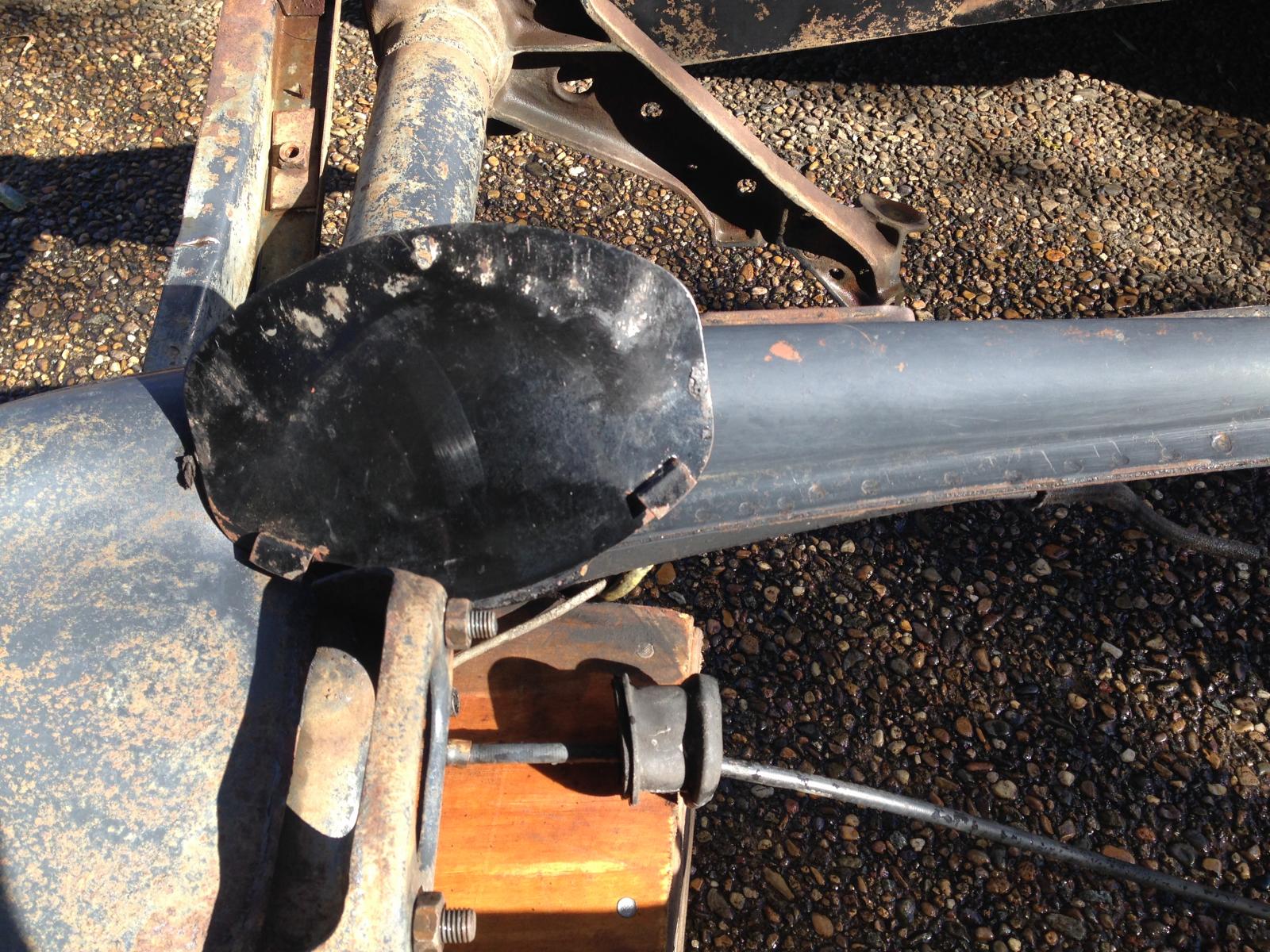

Here's a photo of the spine of the pan and an original black inspection plate showing the difference between black and grey black.

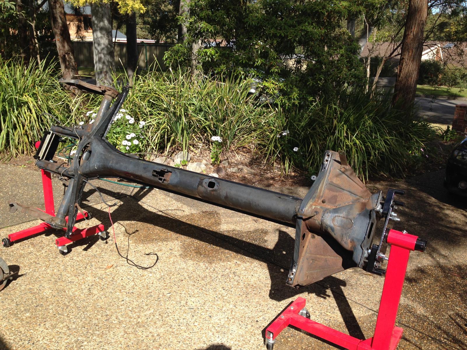

We are talking about the whole pan and spine of the pan.

The picture I posted of the pan that looks a bit blue is definitely a bit faded as I had washed it with some strong degreaser but the sample under the body seal is definitely a dark grey black. In addition the cover plate over the rear torsion tubes is grey black as is the part behind the spring plate (which attaches to the pan)whereas the spring plate and z bar is black.

That photo of the 'black' inspecton cover, compared to the spine of the pan's colour could certainly be chalked up to oxidation ...as well as that photo of the 'unmolested' pan. Have any of you guys tried 'polishing' the grey-black painted areas to see if a good polishing would remove any oxidation, and possibly make them look 'blacker'? I can't think of any rational reason for VW to have used a different kind, or color, of paint on the pans and 'frame' than they did anywhere else that as painted black. If the underbody 'grey-black' paint was something special (ie: rust retardant?) ...they it certainly would have made sense to use it on other areas of the car that were exposed to the elements.

So I can only still believe that the colour of the pan is grey black. The sample piece I have from the under seal area is still polished and not oxidised one little bit. I agree that the picture I posted of the pan is oxidised but it is not black. When I had the paint matched to the sample and sprayed the pan in grey black, I sanded back the first coat well. It does get much lighter but is NOT black.

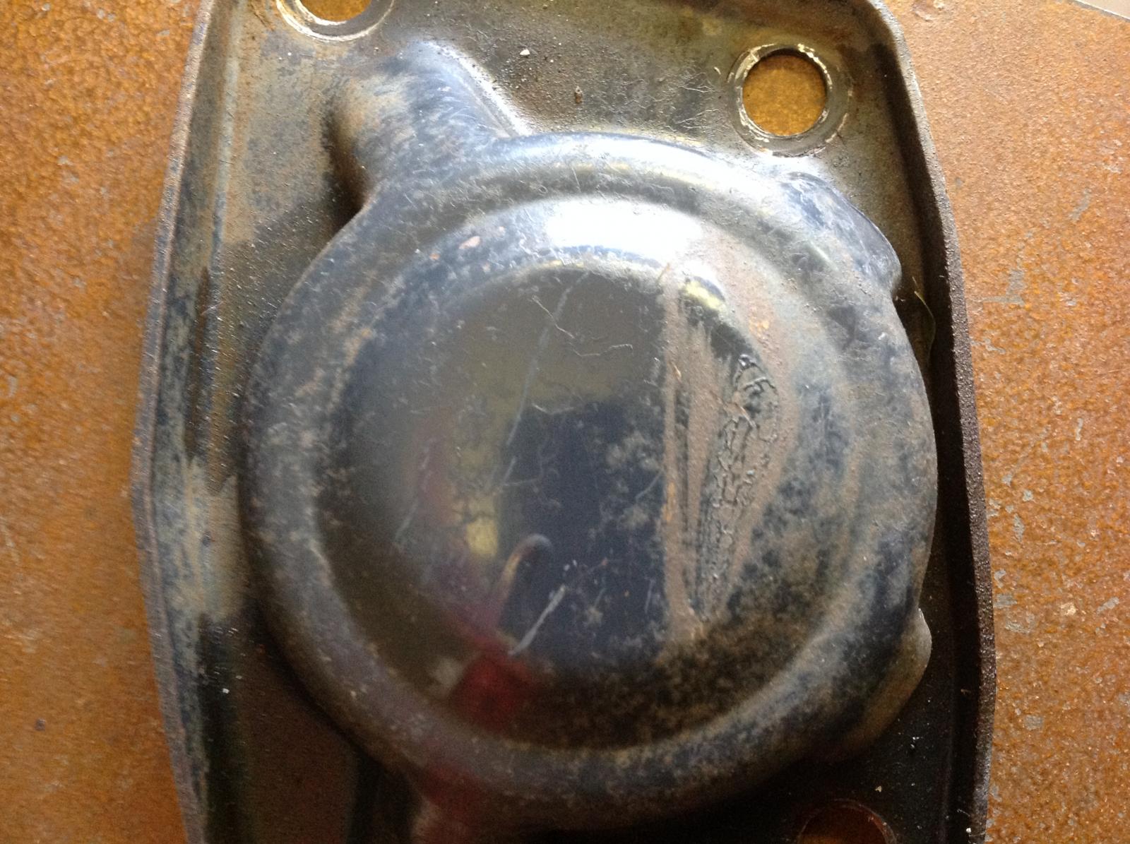

Here's a photo of the torsion bar cover. Other parts around it are black. This is the same colour as the pan. The other coloured parts were equally oxidised but were black like in the photo with the inspection plate.
