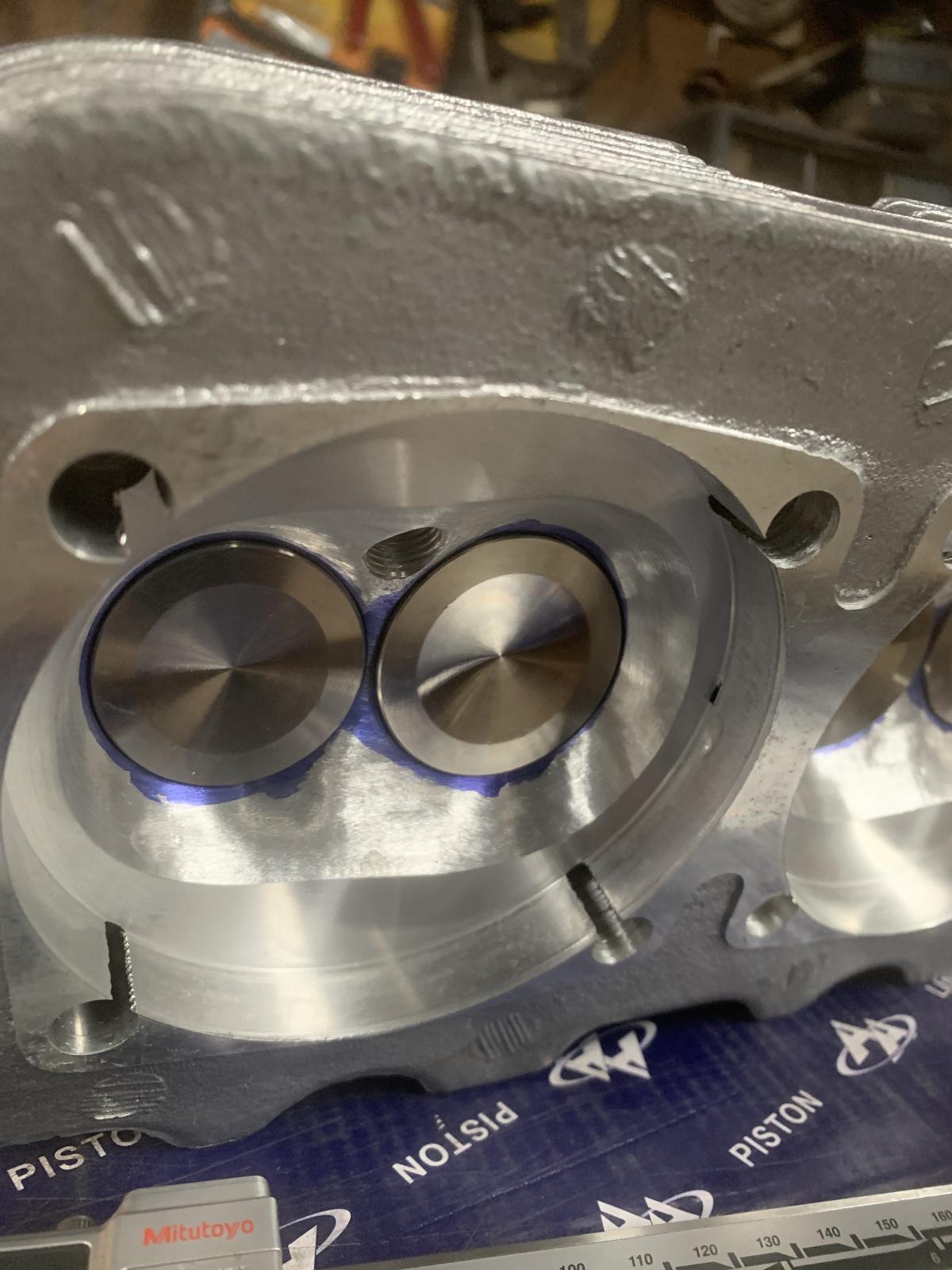

Any ideas why the head registers would be different between the 2?
I needed another set of pistons, so I went ahead and ordered a set of std. length p&c’s.
The cut to length versions measure 101.25mm diameter and std. length measure 100.85mm dia.
You can see the difference in this photo (cut to length on right):

You mean the head diameter? They're usually used for apps where people are running more cylinder pressure, so AA gave us some extra wall thickess. Make sure your head fits.
Well that seams like a good idea, but slightly annoying that it’s not mentioned in any of the spec.’s I’m aware of

Any issues with boring these heads out further? They are already broken through to the fin area.

You gotta do what you gotta do. It won't hurt anything.

I figured so, but thought I better ask the experts. Thanks
