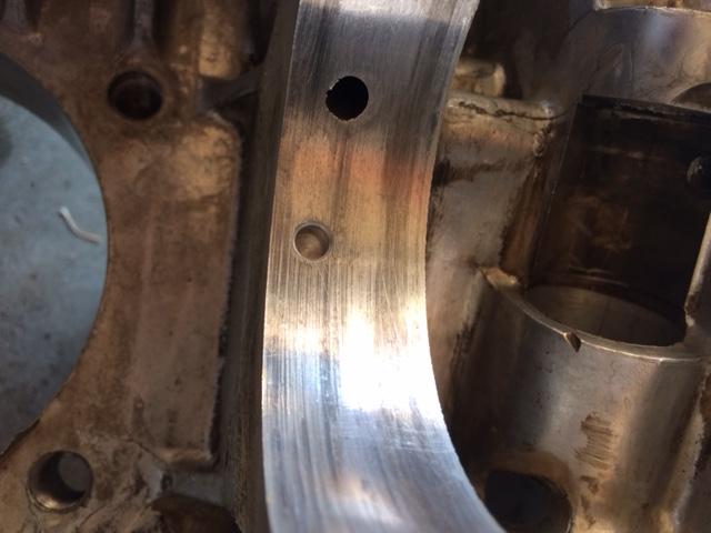

Here is the deal. I have a 1.8L out of a 914. I have opened it up and I am inspecting everything. The PO told me it was running. Everything looks really good so far. Only tiny thing I found so far is it looks like one of the crank bearings spun about a 1/4" and the dowel pin dug into the bearing. No case damage. I'll try to add a picture.

That spun bearing/torn dowel pin is a sign of oil starvation.

PostPosted: Sat Nov 16, 2019 12:18 pm    Post subject: Re: Mechanical vs. Electric fuel pump Reply with quote
THis is the middle bearing cradle. You can see some evidence of "hammering"> I read that this is typical. THe location and the evidence.... which is the bearing stamp being transfered to the engine case. I will need to measure
THis is the 3rd bearing. All is well here.
THis is the bearing that slightly spun at some point in it's life. Only deformed the bearing 1/4" with the dowel. Might have only slightly reduced the oil coming here.... it is the full circle bearing on the crank, close to the fan.
My Toys: '75 Porsche 914, '92 Ski Nautique and now a 1972 VW Transporter Deluxe (punch list fixing)
