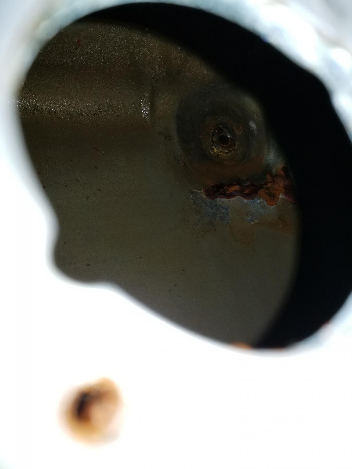

I just wanted to give anyone ordering a tank from WW to crack it opened as soon as you get it. Mine was shipped with standing water inside. This of course, caused some rust to occur inside the tank. I was able to clean it out, but it was a pain and not expected since it's supposed to be a new tank. There was also rust in the threads for the fuel sender. Needless to say I was disappointed in this. I didnt want to send a fuel tank back as it is inconvenient and expensive. So I cleaned it out. I addressed it with WW and they stated they would look into the issue for future thanks. Offered to send me a new tank, but as stated, I'd rather clean out the one I have already.
Shop towels soaked up with most of the water. I used a heat gun to dry up the rest.
Mostly cleaned up..
It was pretty much surface rust and hopefully there isnt any more.

Should treat that with Phosphoric Acid, to keep that from rusting more.
I think it was just some surface rust, I cleaned it out with some chemicals. I dont think an acid treatment was going to be necessary.

PostPosted: Tue Nov 19, 2019 2:41 pm    Post subject: Re: Wolfsburg West tank shipped with water inside Reply with quote
khalimadeath wrote:
You need to get the rust out of the pores of the steel. Plus that acid leaves a coating that resists more rust.
