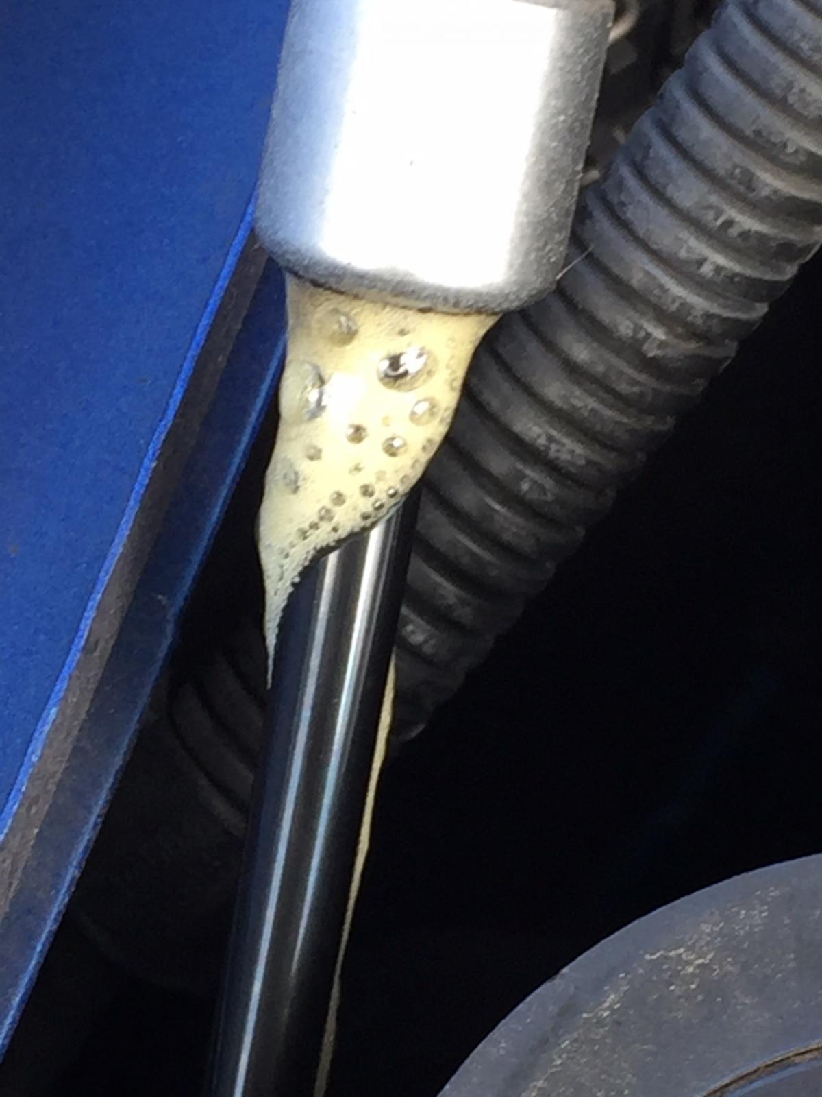

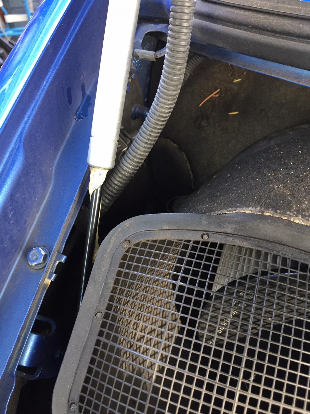

I had a dead windshield washer pump, so in the process of diving into the engine bay I noticed a couple things. One is that the hood struts are getting weak, and I found out why:
The other observation is that the foam around the air intake gills acts like a sponge in the heavy rain we've been having here, and that it also traps a lot of road detritus in the fender well. You rust belt folks should clean this area out annually. I think I'll revisit that foam piece this summer and try to find a way to clean and reseal it with some kind of flexible sealant so as to mitigate the water absorption.

PostPosted: Wed Jan 29, 2020 3:19 pm    Post subject: Re: I've joined the dark side: 2001 Weekender Reply with quote
As a follow up, I just swapped out that leaking hood strut with one I pulled from the '01 Jetta donor for the TDI in my Vanagon. Its extended length is the same, but the body has a larger diameter and the unit seems significantly stiffer. I just replaced that one for now, but you can really feel how weak the other is, so I may go ahead and do both.

PostPosted: Wed Jan 29, 2020 3:33 pm    Post subject: Re: I've joined the dark side: 2001 Weekender Reply with quote
Casey - are you sure that isn't a critter in the well area? Yuck.

PostPosted: Wed Jan 29, 2020 10:42 pm    Post subject: Re: I've joined the dark side: 2001 Weekender Reply with quote
I should check the vacuum. There was a lot of stuff up in there.

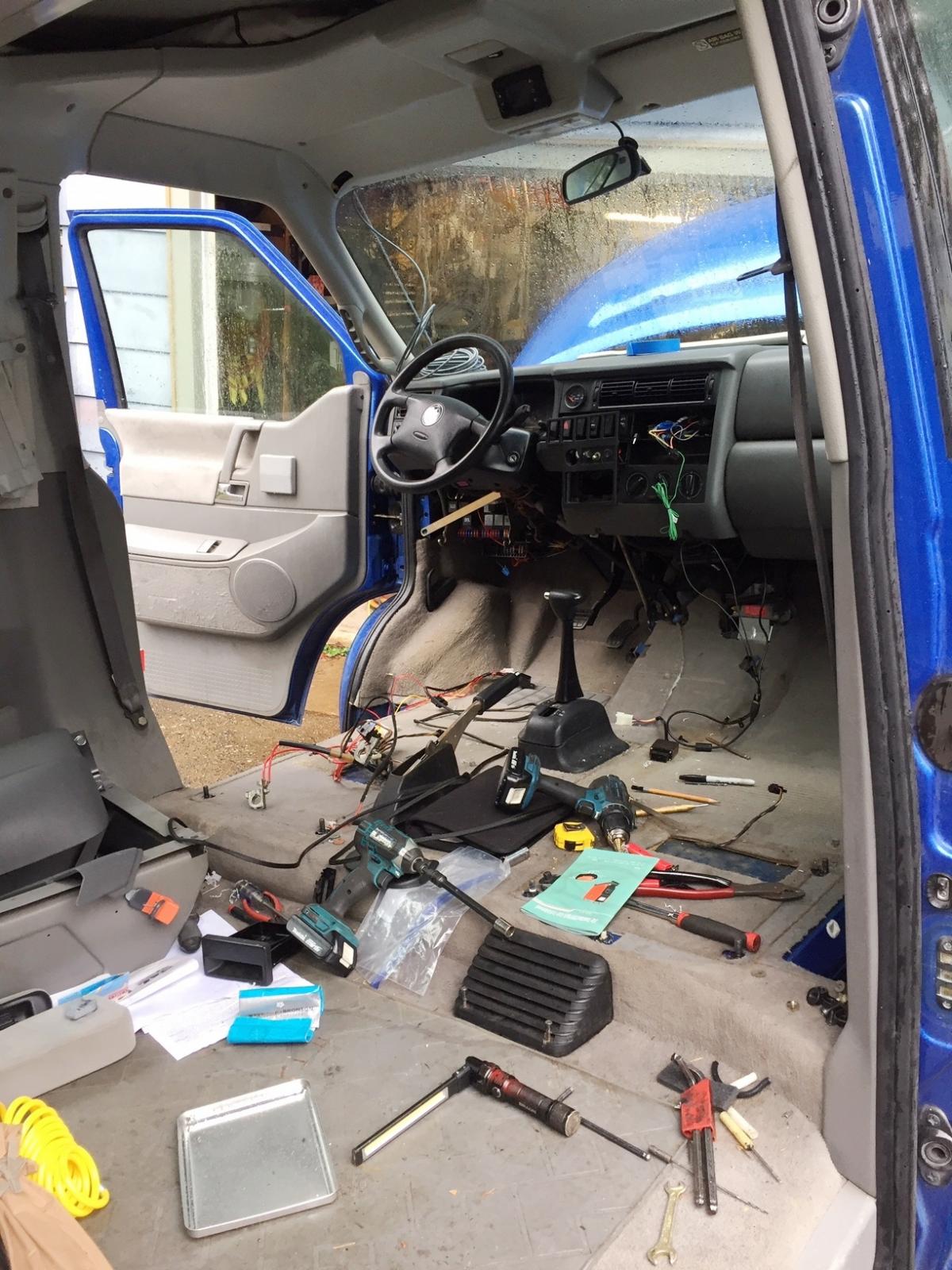

PostPosted: Thu Feb 13, 2020 9:33 pm    Post subject: Re: I've joined the dark side: 2001 Weekender Reply with quote
I'm in the middle of replacing the seat heaters AND installing a diesel aux. heater...AND, we're leaving for Salt Creek Recreation Area tomorrow afternoon, so no pressure.
Casey--
'01 Weekender --> full camper
y u rune klassik?
Abscate Premium Member
Joined: October 05, 2014
Posts: 23734
Location: NYC/Upstate/ROW
Abscate is offline
PostPosted: Fri Feb 14, 2020 4:52 am    Post subject: Re: I've joined the dark side: 2001 Weekender Reply with quote
That blue is so pretty. I was torn between that and the COLORADO red when I plonkeddown the cash for my only new car in my life, the 2002 T4 EuroMaxiBus.
Zeitgeist 13
Joined: March 05, 2009
Posts: 12161
Location: Port Manteau
Zeitgeist 13 is offline
PostPosted: Mon Feb 17, 2020 10:26 pm    Post subject: Re: I've joined the dark side: 2001 Weekender Reply with quote
We had a great time up at Salt Creek, although my project delayed our joining the group by a day. The seat heaters work awesome and the diesel heater was a game changer...until it wasn't.
Because I was so rushed, corners were cut and safety was nudged down to a third consideration--sue me!
First off, my van isn't (yet) a diesel, so I had to figure out where/how to mount the fuel tank. I have a design in the works that both slides and articulates under the van, but I didn't have time to make that a thing. Instead, I screwed it to a plastic cutting board and temporarily mounted it above the engine battery. No problems were encountered.
Note that I mounted a house battery fuse panel there, so I could easily tap into that circuit without gutting the interior.
The heater is installed under the van and plumbed into the rear heater housing. One concern expressed with this approach is that the heated air could potentially blow directly on the rear heater core, which would serve as a heat sink and reduce thermal efficiency. I took this into consideration and glued a thin steel lid from a candy tin to the floor, which allows it to deflect heated air upward and away from either the heater core or the diesel heater inlet. The polyurethane glue is flexible, so the steel deflector can lean over and deflect either or both heat sources.
Astute T4 fans will recognize this temporary exhaust outlet source.
The heater worked awesome during our ~33F degree night and morning. Unfortunately it shut off after about a half hour in the morning and gave an E-01 error code.
This turns out to be a low voltage error. After I got back home, I diagnosed the battery isolator relay as defective, which explains why the house battery was dead flat.
The project items that did deliver during our trip were the seat heater matrices I installed. Very nice even heat and the el cheapo seat covers worked really well for a $15 investment.
Lots of work to be done, but overall I'm pretty pleased with these latest additions to the van.
