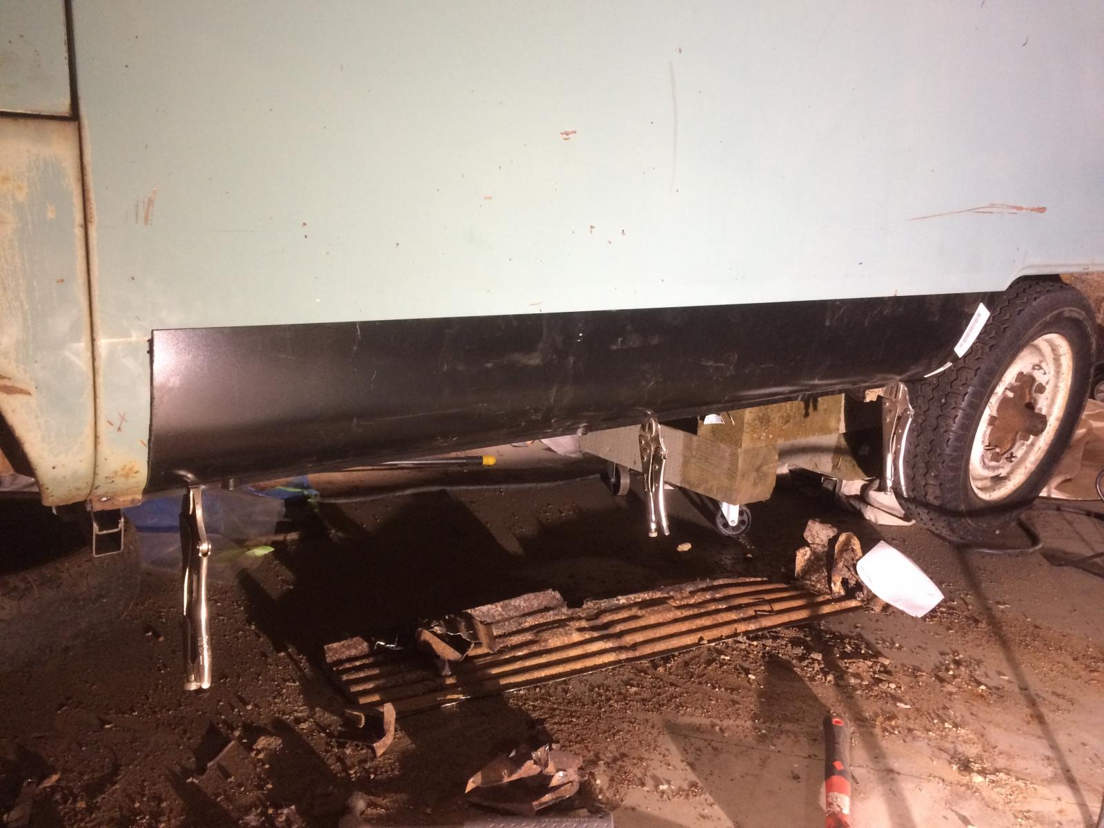

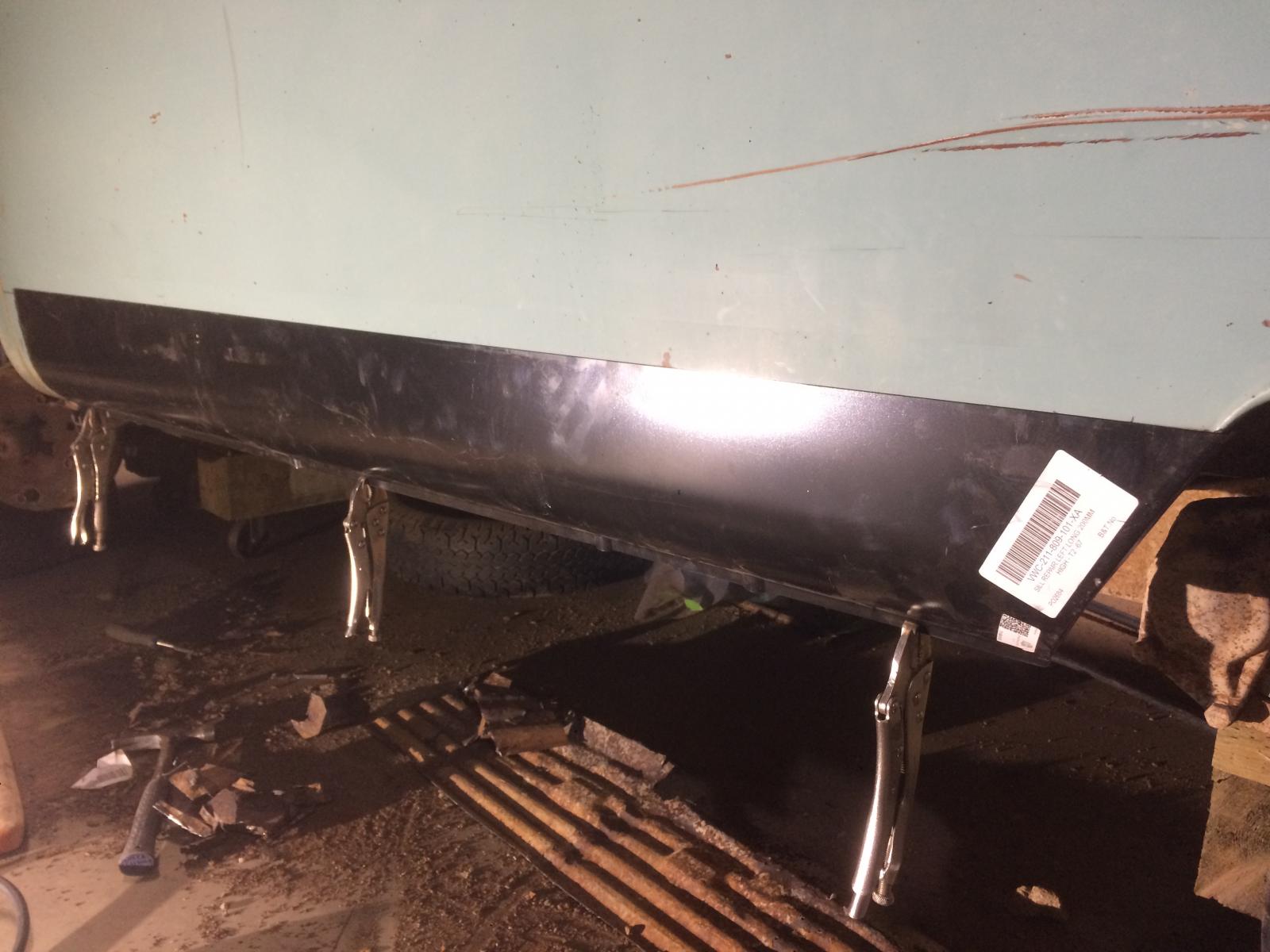

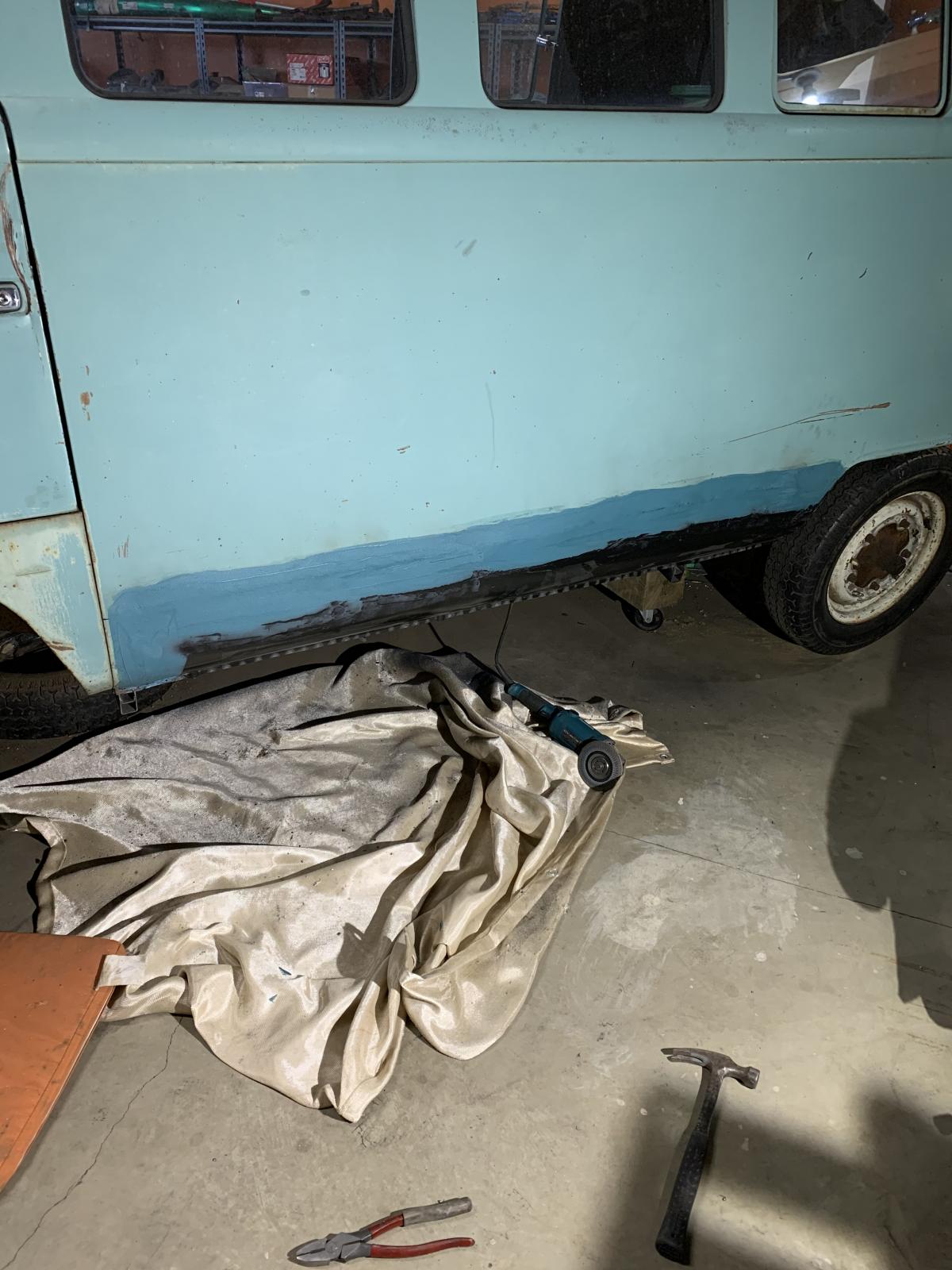

good effort. you can see in your last photo that you have poor penetration on more than half of your tack welds, and then grinding down the outside makes the joint very weak. You should see a solid bead on the inside of the joint as well. A weak joint can flex and crack the filler.

PostPosted: Sat Oct 26, 2019 10:07 am    Post subject: Re: 1964 original paint Turkis Canadiana camper build Reply with quote
Thank you for the info. Again this is my first time doing this sort of thing so any and all input is greatly appropriated

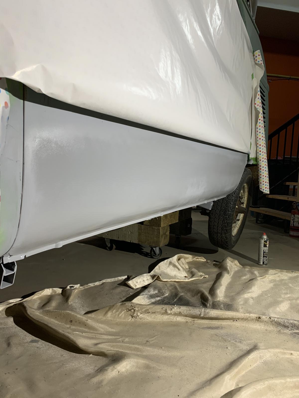

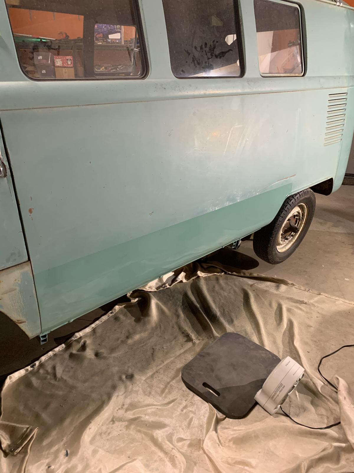

A little more progress

PostPosted: Sat Nov 23, 2019 6:30 am    Post subject: Re: 1964 original paint Turkis Canadiana camper build Reply with quote

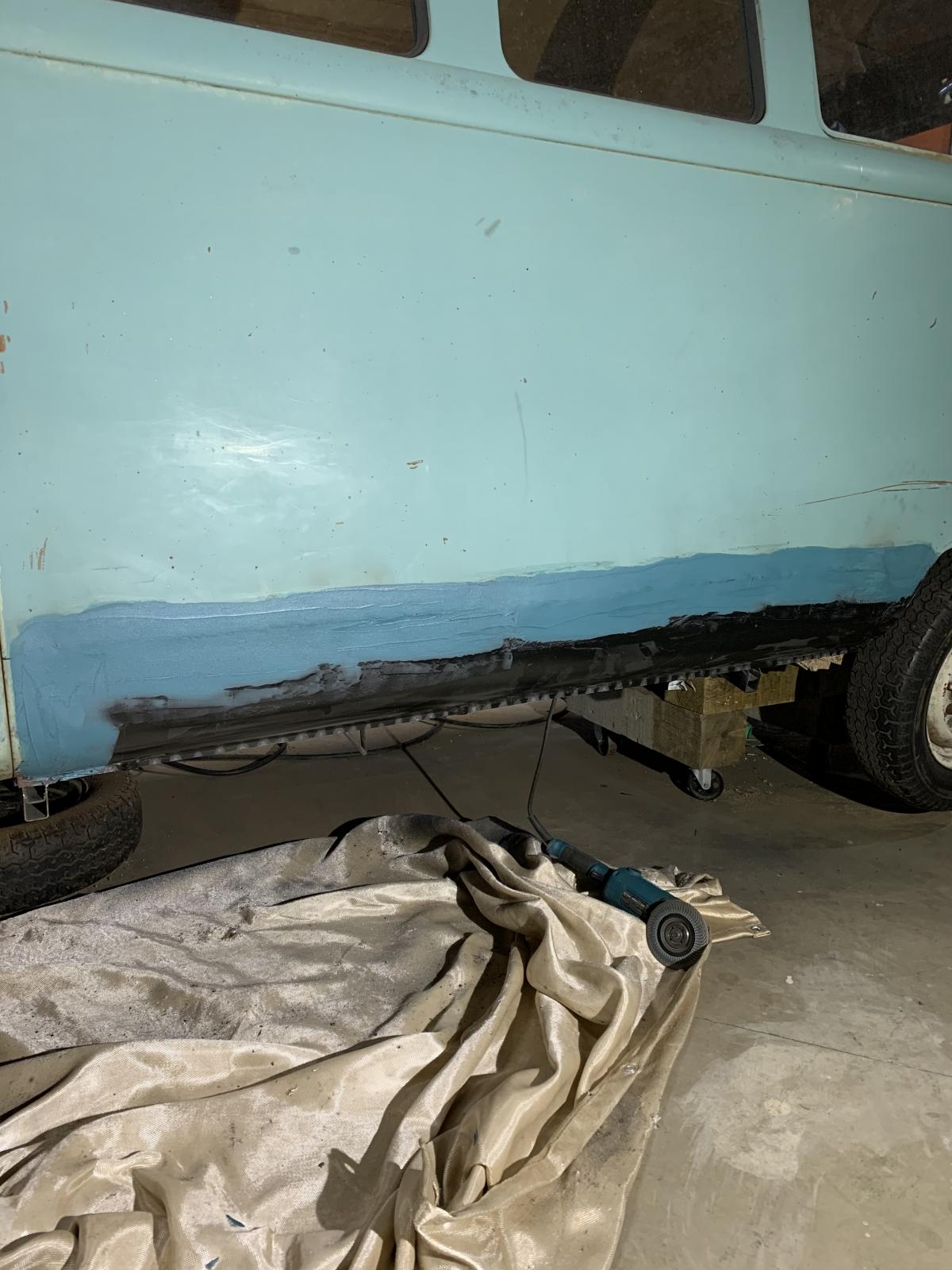

Wow looks good for a first, what spray painting equipment did you use?

PostPosted: Sat Nov 23, 2019 8:41 am    Post subject: Re: 1964 original paint Turkis Canadiana camper build Reply with quote
Just a per mixed spray can made up at NAPA

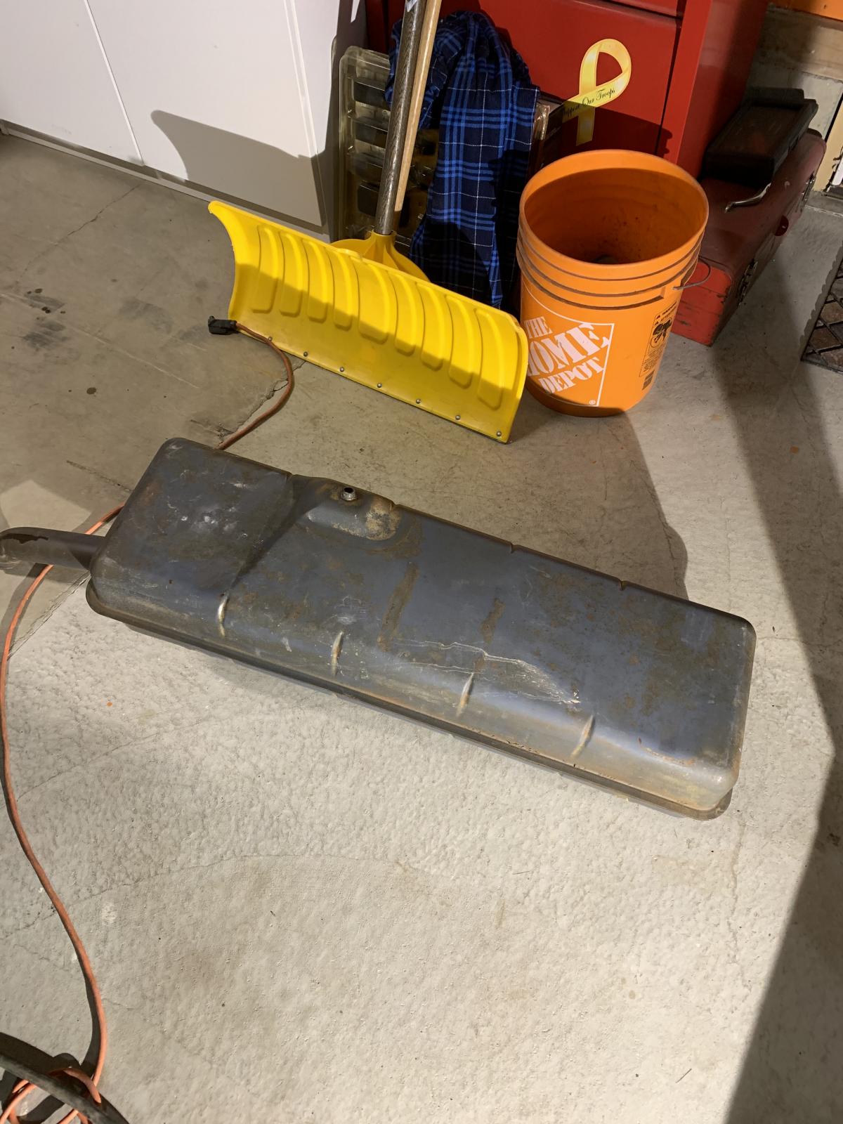

Pulled the gas tank and was very presently surprised on how good it was
