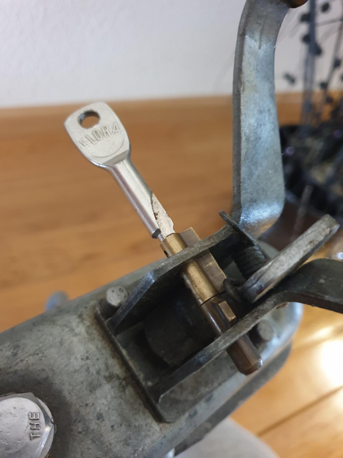

PostPosted: Wed Oct 23, 2019 5:54 am    Post subject: Re: 1974 Westfalia Essen Trailer Reply with quote

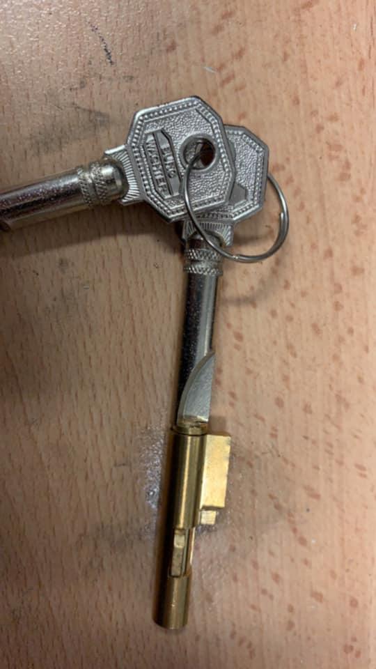

Finally here is the lock I was talking about. I can only demonstrate it correctly when the trailer is mounted behind the bus: in that case the handle is in "rest position" allowing the lock to snap into the groove.

PostPosted: Wed Oct 23, 2019 2:25 pm    Post subject: Re: 1974 Westfalia Essen Trailer Reply with quote
Globusoverland wrote:
Finally here is the lock I was talking about. I can only demonstrate it correctly when the trailer is mounted behind the bus: in that case the handle is in "rest position" allowing the lock to snap in the groove.
Never seen this kind of accessory. But I think it is very, very cool Laughing
What an absolutely cool piece of kit!!! Thanks for sharing! Cool

PostPosted: Fri Oct 25, 2019 6:02 am    Post subject: Re: 1974 Westfalia Essen Trailer Reply with quote
That looks a bit like the steering lock from a plunger-frame BMW motorcycle like the R67. You might be able to adapt the lock from one of them to fit this application.

PostPosted: Sun Oct 27, 2019 9:47 pm    Post subject: Re: 1974 Westfalia Essen Trailer Reply with quote
Ya, that was exactly what I was asking about, but it doesn't look anything like what I imagined. Thank you very much for the pictures.

PostPosted: Thu Oct 31, 2019 12:07 pm    Post subject: Re: 1974 Westfalia Essen Trailer Reply with quote
It looks like I could pull the handle up and rip that lock apart if I wanted to. Let me know if it's as flimsy as it looks and is any kind of real deterrent?

PostPosted: Thu Oct 31, 2019 2:01 pm    Post subject: Re: 1974 Westfalia Essen Trailer Reply with quote
Jason, jou could rip that whole Essen if you pull hard...
This lock is nothing more than a basic item against a hit and run. Wink

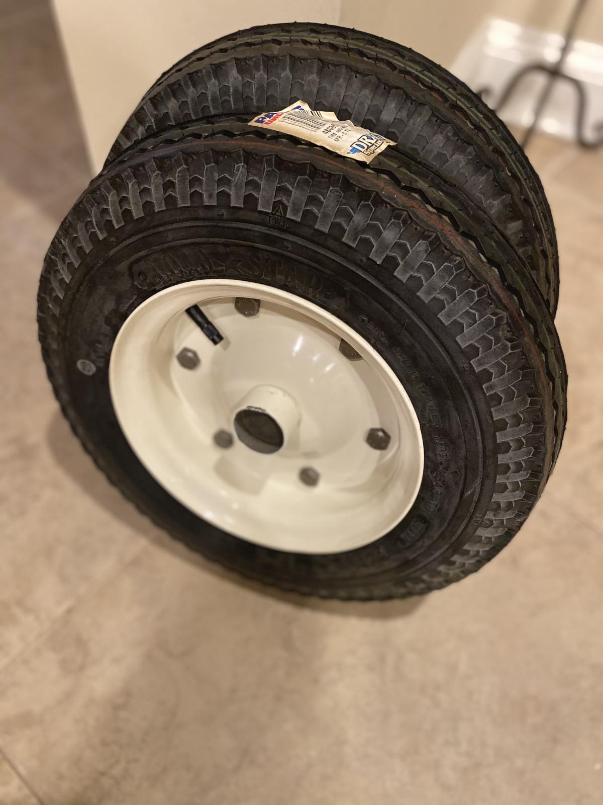

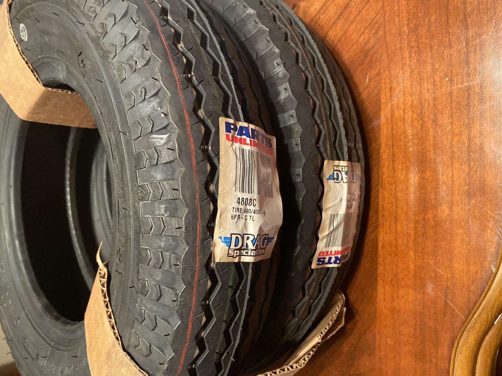

PostPosted: Mon Nov 25, 2019 8:10 am    Post subject: Re: 1974 Westfalia Essen Trailer Reply with quote
Things have been moving woefully slow on the trailer. If you've been following along in the bus thread, I've had my plate full with engine related obstacles. As such, I haven't put a lot of time or effort into the trailer.
However, I had a little time to mess around with the rims this weekend.
I bought some new tires and inner tubes:

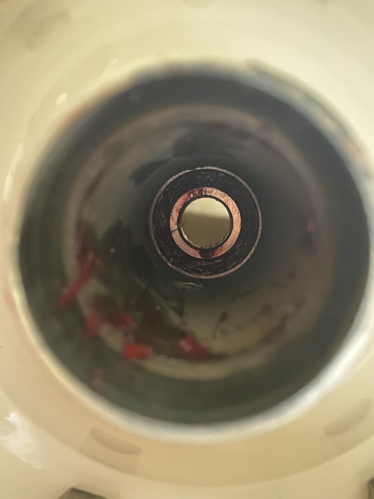

Put the inner tube inside the tire, pulled the valve through the rim, attached the other side of the rim and bolted them together:
Initially, I had bought bearings that were unshielded. That would probably have been fine. However, I did a little digging, and found that I would prefer a single shield bearing instead. The shielded side will face outward on the rim:
The interior surface remains capable of receiving grease from the zerk fitting:
This is the type of bearing (6203ZR) I bought: https://www.amazon.com/gp/product/B007MFTRG4/ref=ppx_yo_dt_b_asin_title_o00_s00?ie=UTF8&psc=1
I must confess that I got a little ahead of myself and installed both sets of bearings for both rims, and then realized that I had forgotten to install the axle spacer, in my haste. Rolling Eyes
New bearings on order. That will hopefully wrap the rims up.
