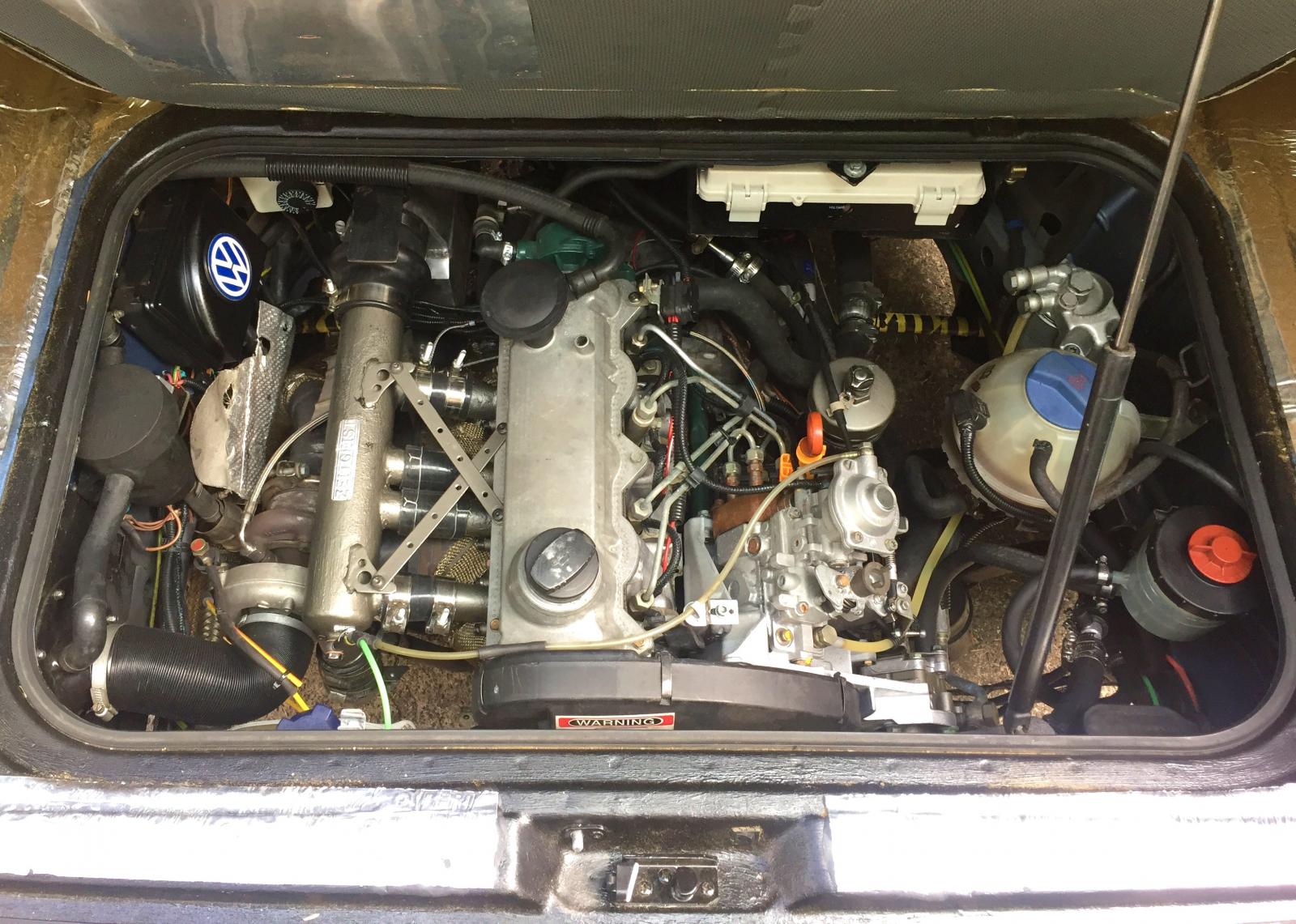

first some backstory Laughing - we bought a diesel van about a year ago after selling another long term fun car and wanting to get back into watercooled vws, but never having owned a van.
it had already been 1Y swapped prior to our ownership, though some previous owner hacks needed to be sorted out. following some cleanup i daily drove it on my 60mi commute around pdx for about 8 months.
i had dreams of putting in a tdi and ended up picking up an ALH donor - a fairly clean 1999 golf with 156k miles - from another van buddy whod been sitting on this car for a couple years but ended up going a different route on his van.
well... life happened...
we moved out of OR last spring and ended up buying a bit of a project house over the summer which blew up the van swap funds. so the ALH was sidelined.
in the meantime i ended up cleaning up the inside of our van, adding a webasto, second battery, etc and we camped in it a few times over the summer and continued to fall in love with it, but its still slow!
i originally had plans over the winter to clean up the 1Y and do my best to bullet proof to survive another couple years of slow lane travel, when we ran across a killer deal on a 1Z.
i have a good buddy whos in my shop putting together an AHU for his syncro tiptop soon-to-be-westy, and we figured between the two of us we probably had another 1-1.5 vans worth of parts to build an early TDI.
so... we picked up the 1Z setup last weekend
what we got is boxes and boxes of new and used parts, an assembled engine with a totally redone head, and a bunch of stuff from the '97 donor passat that will end up getting trashed. the guy i got it from bought his buddys wrecked '97 with 207k miles on it, and was going to put it in a volvo amazon but never got around to it.
i pulled the head anyway, itll be getting ARPs, and wanted to confirm the condition of the bottom end. all appears to be good.
ive got parts coming for a JX manifold, k03/04 hybrid, slightly bigger injectors and itll get a malone tune. ill throw on the AHU intake manifold since we have it, and its easier to egr delete than the 1Z manifold. plan is also for an air/water intercooler.
so... i guess if anyone in the pnw wants a complete 1Y (thatll come out of our van) or a full ALH swap, let me know.
will keep this updated over the next couple weeks as we finish building the motor.
