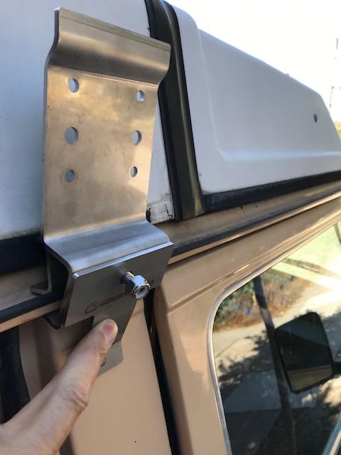

I bought my ARB brackets from Mule Expedition. I was at their store looking at the GW and NW brackets. They both looked good. I went with the GW brackets. My best recollection is that I liked that the GW brackets accommodate both ARB and Fiama awnings and they were a bit more finished due to the powder coat on the GW brackets and the sharp edges on the NW brackets seemed a bit raw. No drilling needed for the GW brackets.
All of this is subject to my memory so YMMV.
It seems like these GW Brackets won't fit earlier model T3 Vanagons? (80 - 84)? I prefer the clean powder-coating but I think the raw metal version from GW are the only ones that will fit my 82 Westy...

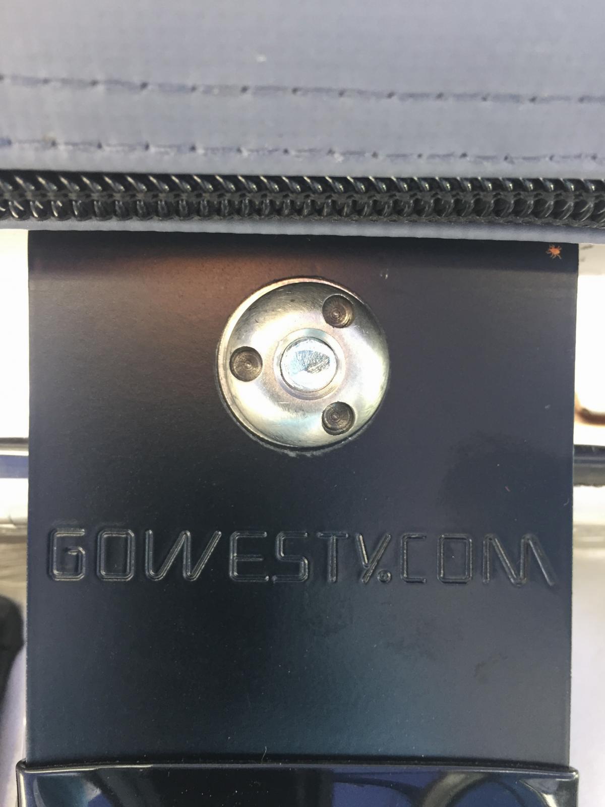

The Go Westy ARB/Fiamma awning installation brackets take a VERY long time to install. I'm very unhappy with how long they took and all the drilling and grinding I had to do. (They were created for Fiamma, but then sold as ARB brackets - "Some drilling required.") I installed the ARB awning 2500 on my 1985 Westy.
First off, the instructions say to slide the M6 nylon nut into aluminum tracks on the back of the ARB unit. Only problem is that they're too thick to fit, So, you have to put the supplied bolt- the bolt head to be exact - into the slot as you might expect.
The second disappointment is that there are not instructions on WHERE that drilling is required. I'll give you some measurements that worked for me.
One key to installing the Go Westy bracket for the T3 Vanagon is that it's a "T" shape, with one bolt locking the assembly to the rain gutter, and one bolt that will attach to the van. That presumably relieves that rain gutter of bearing all the weight. (Lot's of discussion out there about whether that's needed. But I chose to play it safe and add the second bolt per bracket.)
The horizontal placement of the bracket is key, and there's no short cut. Place the bracket where you want it - panel behind the front passenger door, and panel just behind the rear side window. Mark where the second bolt will go, then carefully measure how far apart the two bracket are (Center to center, leading edge to leading edge - whatever you prefer) This is done without the awning being attached to anything.)
Then measure the aluminum back plate overall. (Works for the regular ARB awning, as well as the aluminum case.) Subtract distance between the brackets from the overall length of the aluminum track, then divide by two, that should lead you roughly to how far in to set the brackets. The distance between the two brackets must exactly match the distance you got from measuring the brackets when they were on the van. You going to put the bolts in place, but keep theme loose. You'll tighten them up much closer to the end.
The next trick was grinding down the rectangular "C" shaped part. It fit fine in an area without the plastic trim on the rain gutter lip.
But most of us have plastic trim on the top of the rain gutter upper lip, where the bracket's got to go, that I didn't want to cut away. So I borrowed a grinder and eliminated about a 1/16th inch off both brackets. If that "C" part doesn't lie down flat in the gutter, the angle sends the top part of the C bracket jutting to the inside - to the point that it will interfere with the POP top.
The other hard part was figuring where to drill the wholes in the bracket. This is the "before"
The trick is to use the existing (predrilled) center holes for two, but drill new holes near the lower edge of the bracket for the other one. The measurements I used those for the new holes are as follows: horizontally, the center line for the 1/4" whole left to right, is 5/8" in from the left/right sides of the bracket. Vertically, the center line of the bottom two holes are 7/8" from the BOTTOM of the predrilled holes.
Then, there's the rivnut issue. It's hard to tell when you've tightened the rivnut thing to the point of completely crushing the rivnut - i.e., seating it. It was hit and miss for me. Using their very cheap supplied tool, one worked and one didn't. If you can find a shop to use their fancy tool to seat your two rivets, you'll be doing yourself a favor. (My shop did me a favor and put one in for free.)
Now you're ready to mount the brackets to the awning backing. For the aluminum case, don't forget to use the supplied spacers. (It keeps the unit from interfering with the pop top.)
Keep them somewhat lose, You will tighten them all up later. Then (with help, lift the brackets on to the rain gutter) and start tightening everything. Get the top bolt snugged up fairly tight, then put the bolt into the rivnut.)
This was way too time-consuming. The bracket wasn't originally made for the ARB awning, and GoWesty should have asked the MFG to make a ARB-specific bracket. Wish I'd gone with the North Westy version.

Hey "Private Marty"... It looks like you got the gutter clip in upside down. See screenshots below:

I can't speak for Northwesty's offering, but two RMW brackets have wored great for a few years of hard use for me. This includes quite a bit of forest service road driving and some high wind conditions. No drilling for them either.

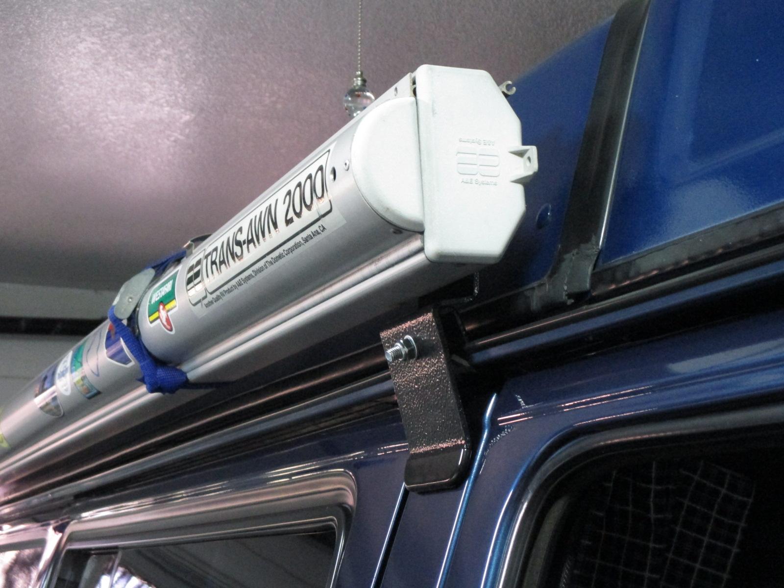

Be aware that a handful of folks have experienced B-pillar cracking thanks to the rivnut. It could be attributed to not installing it with the special tool, but wanted to point out the potential problem.
I've got a metal case A&E Trans-Awn that's been on the van for 30 years (heavier than an ARB, slightly lighter than a Fiamma). It originally had 3 small A&E brackets:
(Borrowed pic)
The only issue was the gutter cracking at the B-pillar. When switching to beefier RMW/VC brackets last summer, no way no how were 3 brackets going to work due to the curvature of the van. If the awning had been forced onto the D-pillar bracket, it would've put a lot of outward force onto the B-pillar bracket (I hypothesize that's why only the B-pillar gutter area is cracked), thus the C-pillar bracket was left out during the bracket swap.
Once the bolts were thoroughly tightened, it's been rock solid. I much prefer the beefier brackets. GW redesigned their bracket; the base is now about as wide as the old A&E brackets I had. IMHO, wider is better. So, I recommend going with NorthWesty's or Van Cafe's.
Edit: Trans-Awn was replaced in February 2020 with a Fiamma. Using the same RMW brackets though.
