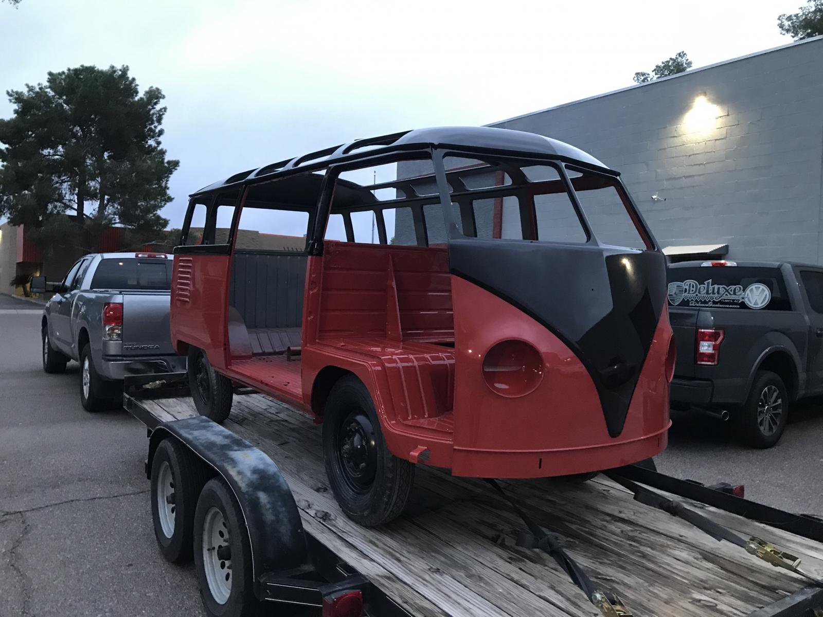

Bus has been painted. Thanks to Matt Howard of Deluxe Customs. Photo of David and 2 proud owners, Dick and Hans Christensen.

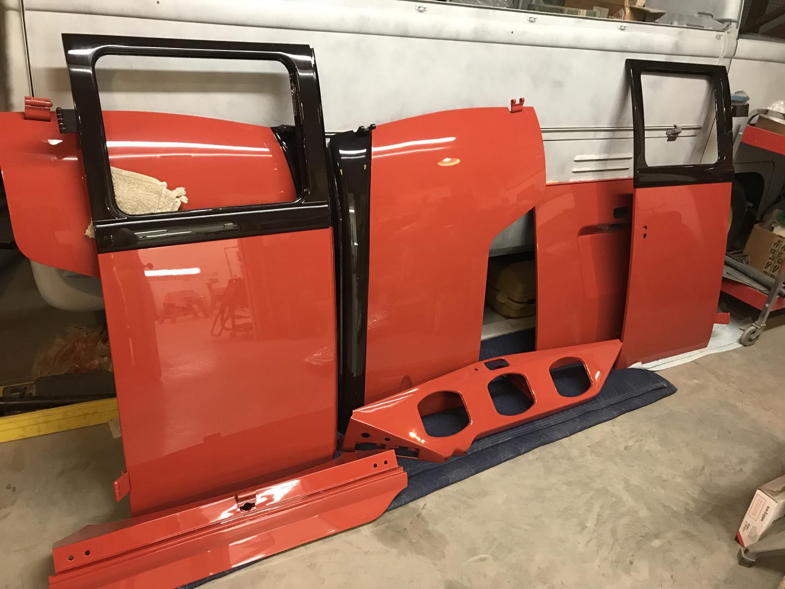

Here's a couple more pics of the bus back from paint...

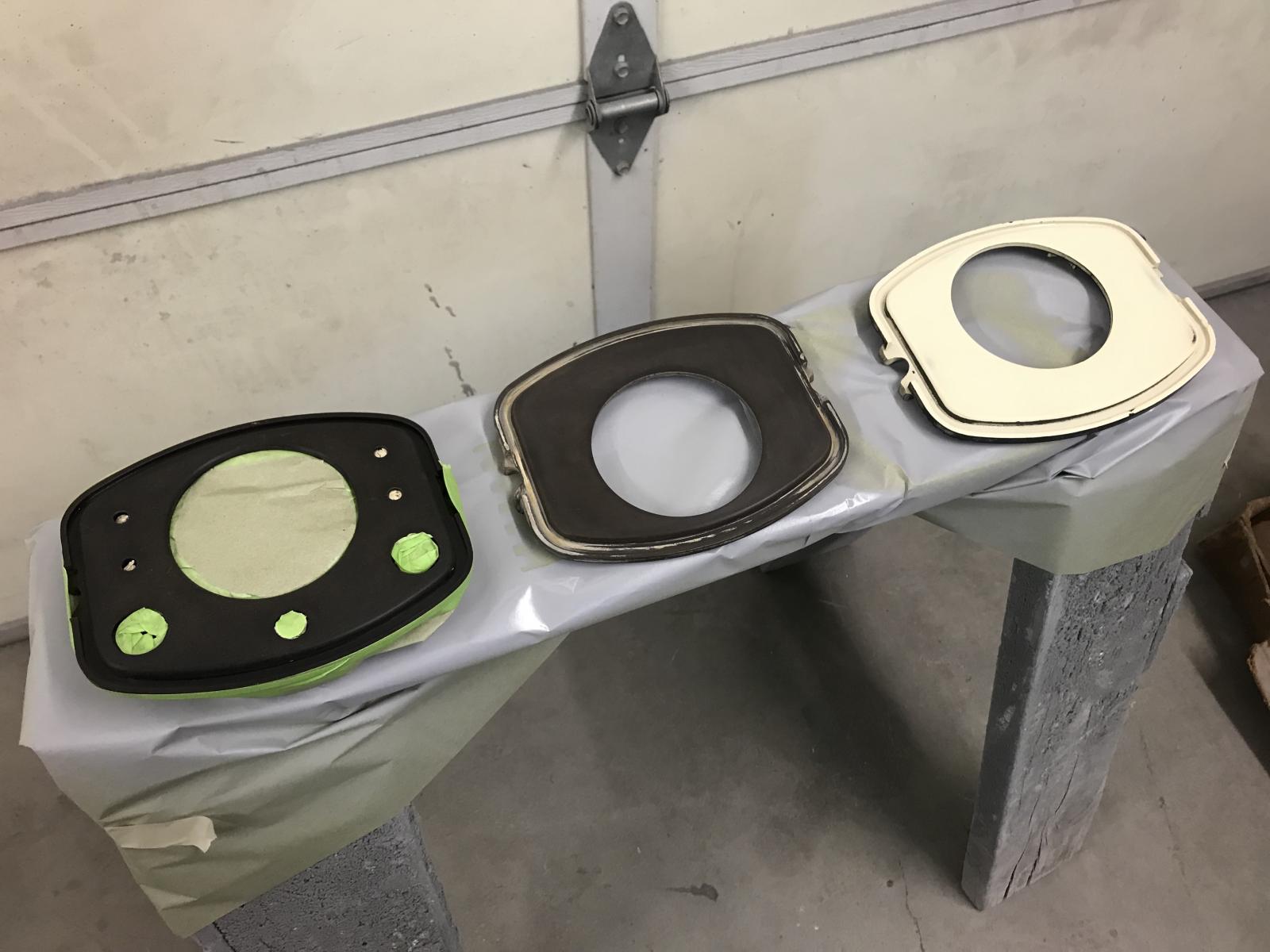

While the bus was away, I painted the dash parts. The steering wheel was recast and painted at Koch's, and their ivory looked good so I had my paint shop match it...

Really nice bus, all job done looks so perfect! Will the rear inside at the luggage tray going to be left in just primer or will it also be painted, or was it in just primer originally?
Thanks! It was left in some kind of primer or sealer originally. I painted it with a flattened grey paint before the red/brown. It's sealed up well and will be left that way.

insane buffing on the doors ! Shocked
and loving those smooth gates ! Very Happy

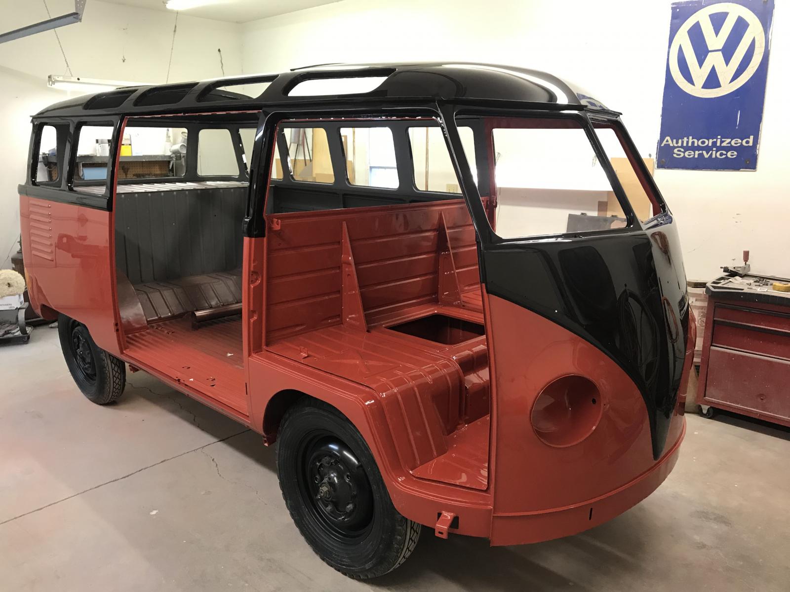

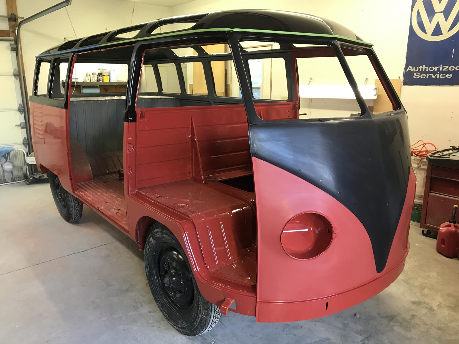

PostPosted: Mon Jan 20, 2020 9:25 am    Post subject: Re: 1952 Deluxe Reply with quote
The bus is all sanded and buffed. In case someone is wondering about the first nose pic, I use the Sharpie like a guide coat. Since I'm only sanding with 2000, it may not be enough to get the dust nibs out. So I mark and sand them out with 1500, then go back over it all with the 2000.
