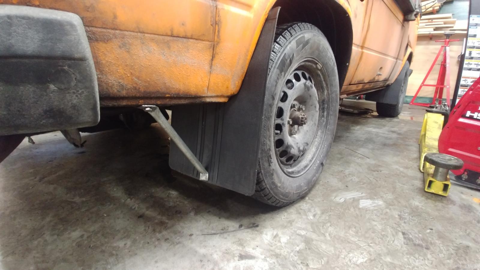

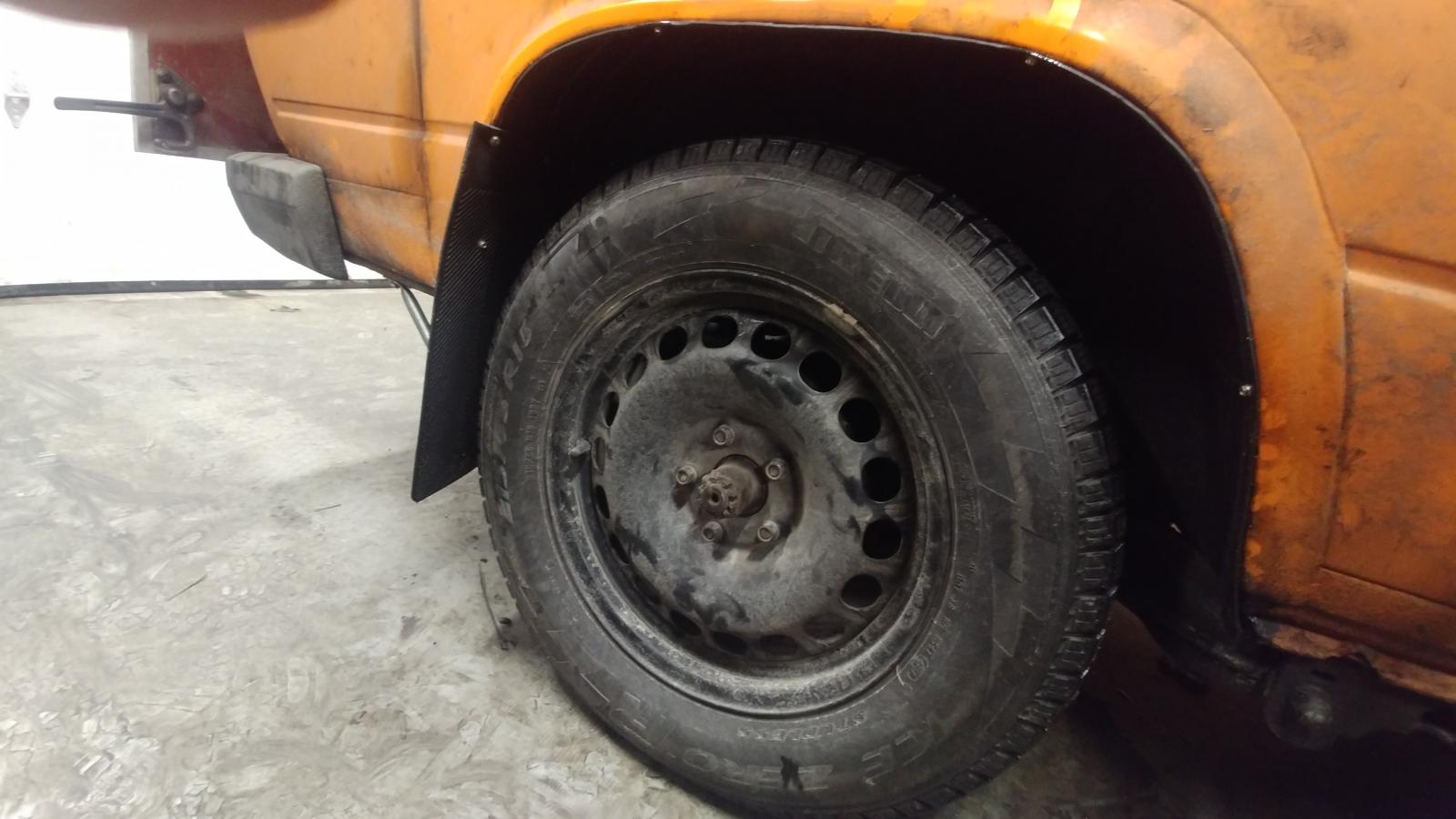

I installed my mud flaps. It consists of those plastic wheel well liners you can purchase and big rubber mud flaps off amazon. I screwed the well liners in using SS sheet metal screws and then I screws the flaps to the liners. In a couple spots it screwed through the liner to the metal. I'm not the keenest on screwing things into a body but there is no way around it if you want mud flaps. All the stuff on the market now involve screwing.
I was worried about the rear ones getting sucked into the wheel as they are flexible flaps and the clearance wasn't the most. I came up with a solution using 1/2 conduit. Works at highways speed. Looking at the picture I am now worried about hitting a bump. Still enough ground clearance to back up over a curb though.

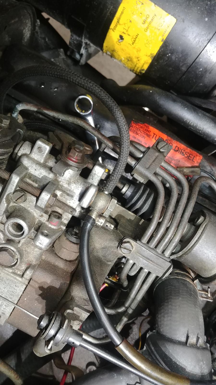

Upon further investigation I have determined that it was the rubber fuel return line leaking at the #1 injector. The leak would weep down to the base of the injector and boil/cook producing bubbles and smoke. It was not injector blow by. I will not need to pull the injectors and replace the seals.
What I did was pull the line off, cut the bottom 1/4" off and put it back on. I'm thinking of replacing the lines, 3.5mm is what I want right?

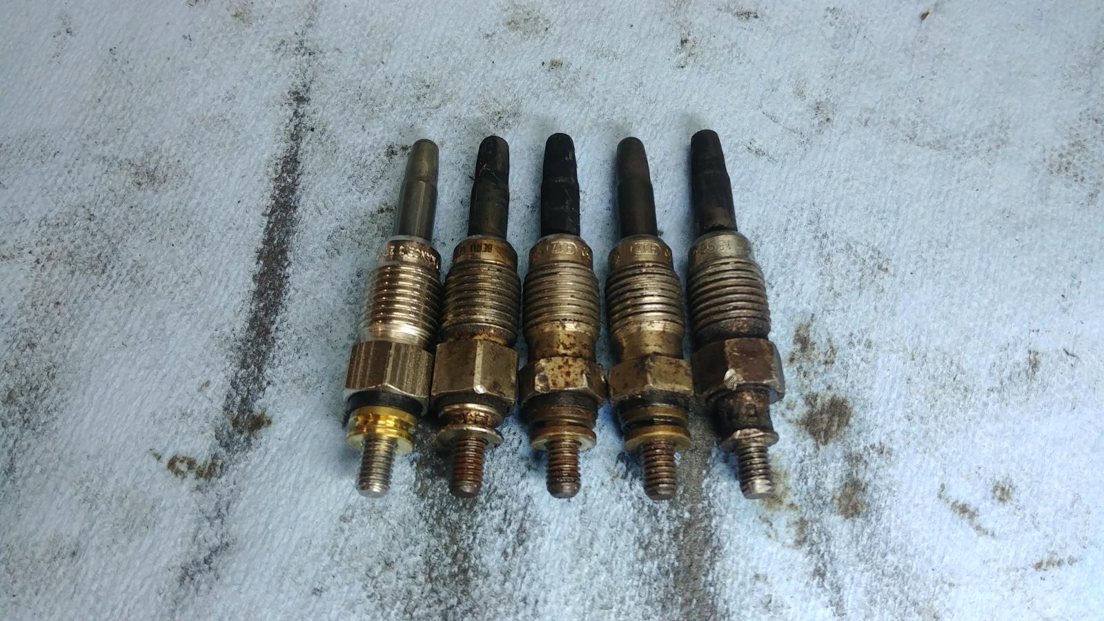

Glow plugs! Decided to do them. Sounds simple but painful. Nice thing is it really only takes an 8mm and a 12mm.

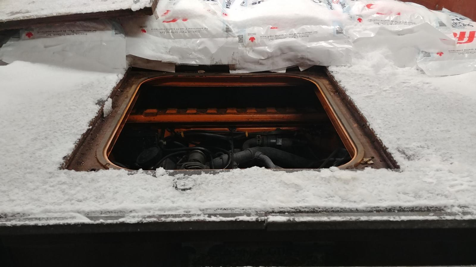

First step as to remove snow around the hatch.
Problem with a sinka/doka hatch is that it's a lot higher than a regular van hatch yet smaller. Means more reaching and bending and it's harder to see.
I started with the easiest one first. It would help me get a feel for the required torque to take it off and put it on. Anyone know what the coolant sensor is used for in the for ground? Is it for the aux coolant pump? Reason I ask is because I broke that tab off.
This was the hardest one. #3. I wanted to take the fuel lines off but they are seized. I can turn the nuts but instead of spinning on the fuel line they twist it instead. Not good. So I had to do with them in place. Not fun.
Get this thing off as soon as you can. It is just in the way.
Here are the 4 old ones and 1 new one(left). There were 3 different brands and not the exact same shape.

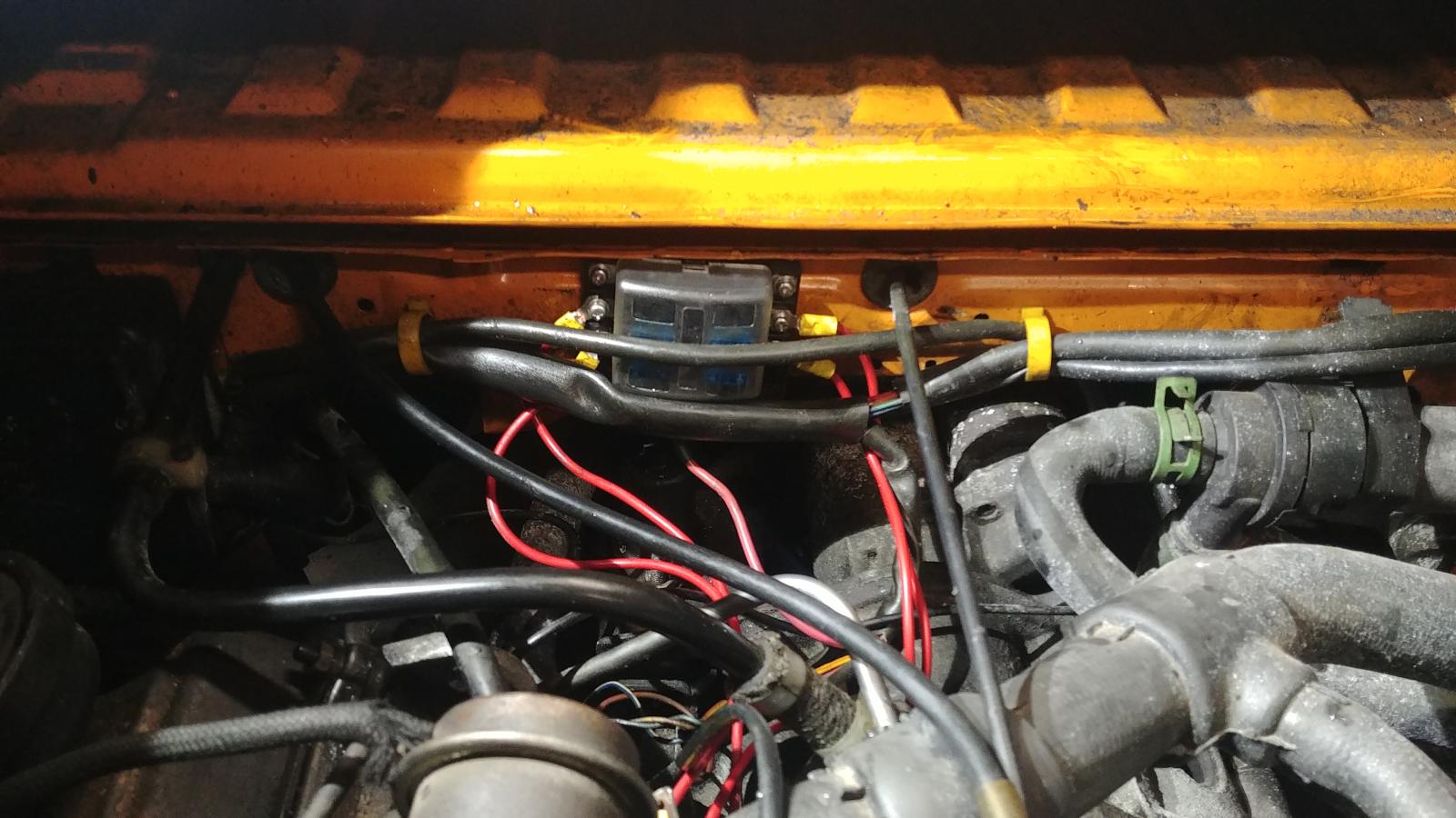

This is the new set up. A variation of pimping ones plugs. I don't really care about taking the strain off the relay. I am not concerned with running individual wires for diagnostic purposes. I just wanted not to have to deal with that stupid brass bus bar nor attempt to get the little nuts back on. Screw that. I decided to go this way. I don't really like those plastic crimp on connectors but it's all I had. The little nuts are half a turn loose. Down side is that you can't fit a ratcheting spanner on the glow plug. Doesn't really matter because I couldn't fit one under the injection pump anyways. The wire assisted a little in getting it into place. Once in place I needed a screw driver to push down on the plug to apply pressure so that the threads would start biting a little.
This thing help too.
This is the little fuse box. I might remove that original big fuse and jump it. Still thinking about that. Nice thing about this set up is that is uses common fuses.
All done.
Remember, all you need is an 8mm and a 12mm.
I tested it with a mulltimeter and it shows voltage. Thermocouple probe also shows a bit of a temp increase on all of them. True test will be if it starts in the morning. It's going to 0F tonight and it didn't plug in the block heater.
TL;DR Glow plugs can be changed without removing the injection pump, fuel lines, or injectors. It is not a fun time though.
