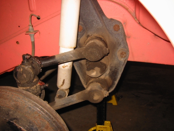

maybe i am missing something here ,and if i recall correctly, yes beetle beams are different in tube distance. I dont have anything but my own beam on my bus currently to compare anything but after a quick gander at trail arm/spindle combos, it doesnt seem all that far off visually throughout.
stock barndoor set up
stock post BD
BD running 63 dropped spindles(doesnt appear to have any change in arm angle)
BD running beetle linkpin(no visual angle change)
BD running balljoint beetle(definate arm angle change)
i have drivin thousands of miles on both the BD with 63 spindles as well as the BD with BJ beetle spindles and i have never found either to be squirrelly or have any abnormal tire wearing. in fact with the BJ spindles,being the most extreme change in angle of all the above, i have to note that my tires have perfect wear still and i probably have close to 10k miles on them. no "intentional" caster changes but my bus is lowered,possibly enough to escape any issues? it drives great for me.
just by the photos of running 63 spindles on a BD beam, i would say there is little to no real difference in the tube spacing from BD to late beams. but from memory, there is definately a difference from bus to beetle.but those link pin beetle spindles sure look pretty uniform.
i only speak from my experiences. i cant vouch for the technical writings ,which would all make sense in theory.
without having each style beam in front of me ,i cant voice anything else other than what i have run on BD.

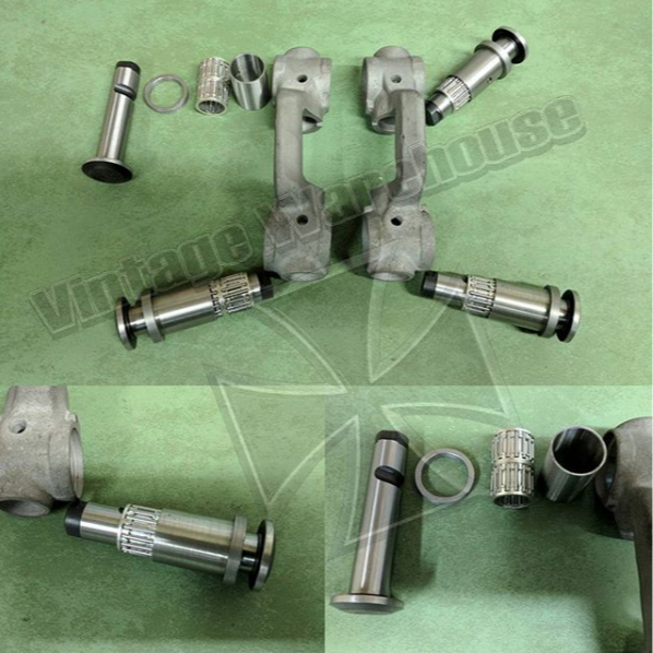

EmpiGT wrote:
I don't have any early bug link pin beams handy to look at. But someone here probably knows. Can t-1 trailing arms fit onto a barndoor beam. So not having to machine anything to use t-1 spindles? That seems too eazy, but to me looks like it can be done. Are the springs bigger in a barndoor beam?
T1 arms will not fit into a BD beam
Here's the way I did it.
Early bus link pins with the heads turned down to fit in side the T1 carriers.
Needle bearing bushings turned down to also fit into the T1 carriers
Spacers made to fill the gap.
Not shown are the T1 sims I opened up the ID to use on the bus link pins.
No need to machine the carriers going this route

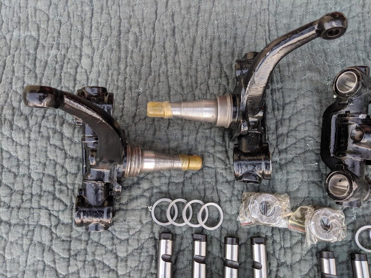

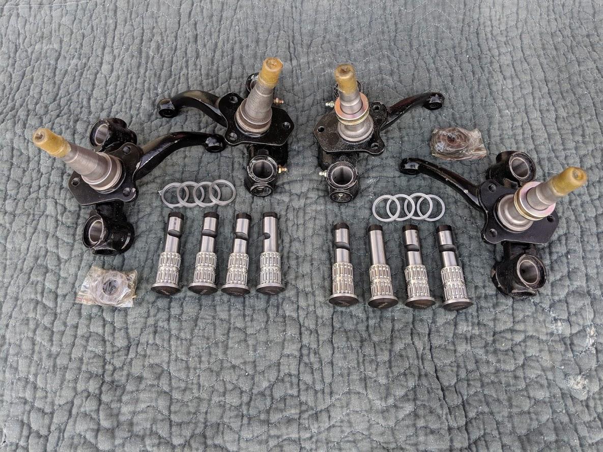

PostPosted: Tue Oct 16, 2018 2:51 am    Post subject: Re: Lowering with T-1 spindels. Reply with quote
edit to replace missing photo and add a photo of a set done with 356 spindles.
Early bus link pins with the heads turned down to fit inside the T1 carriers.
