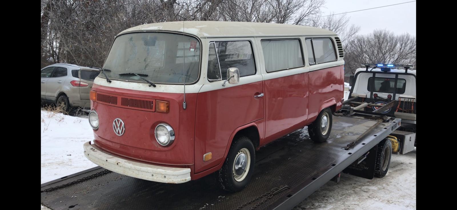

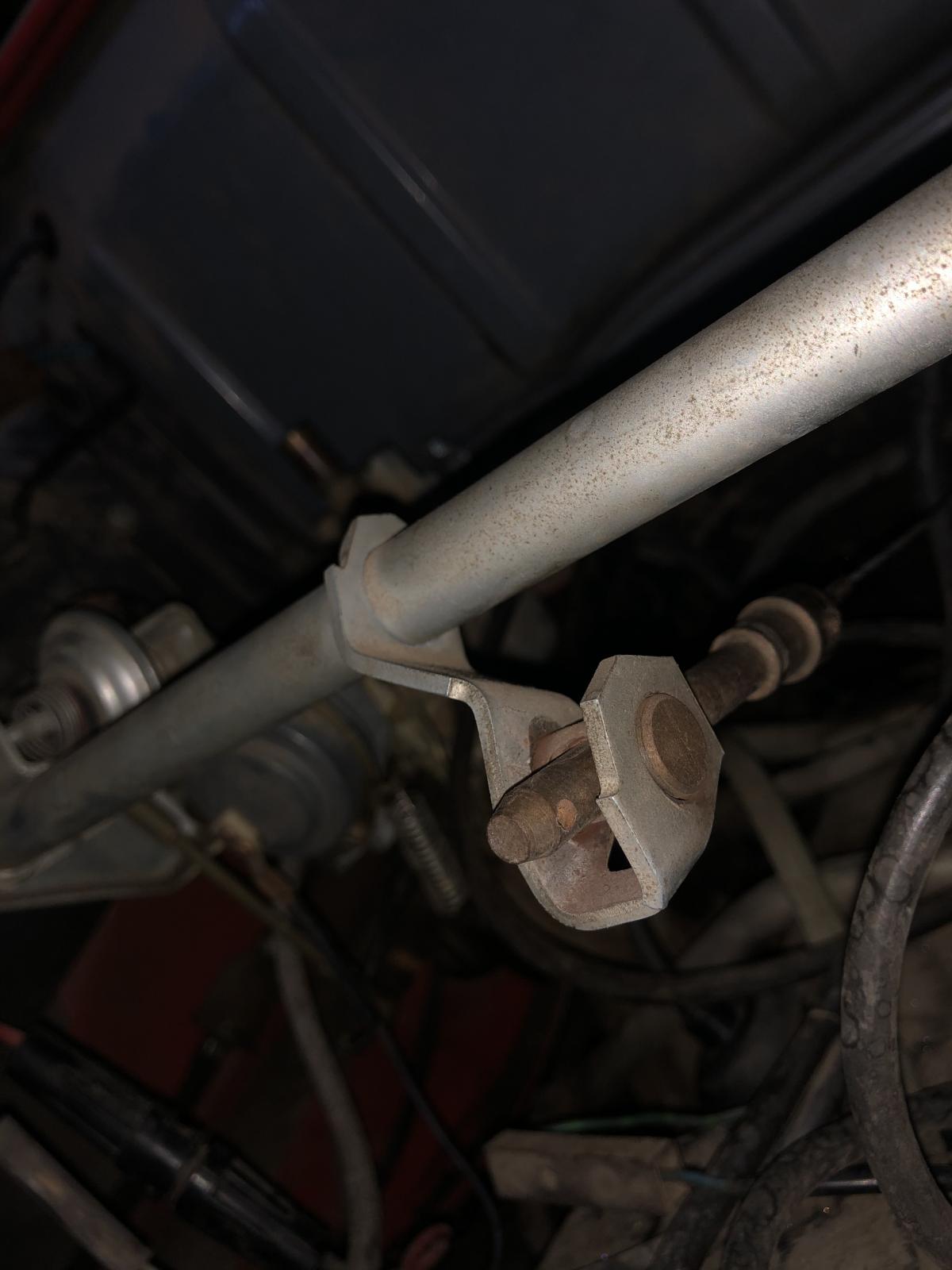

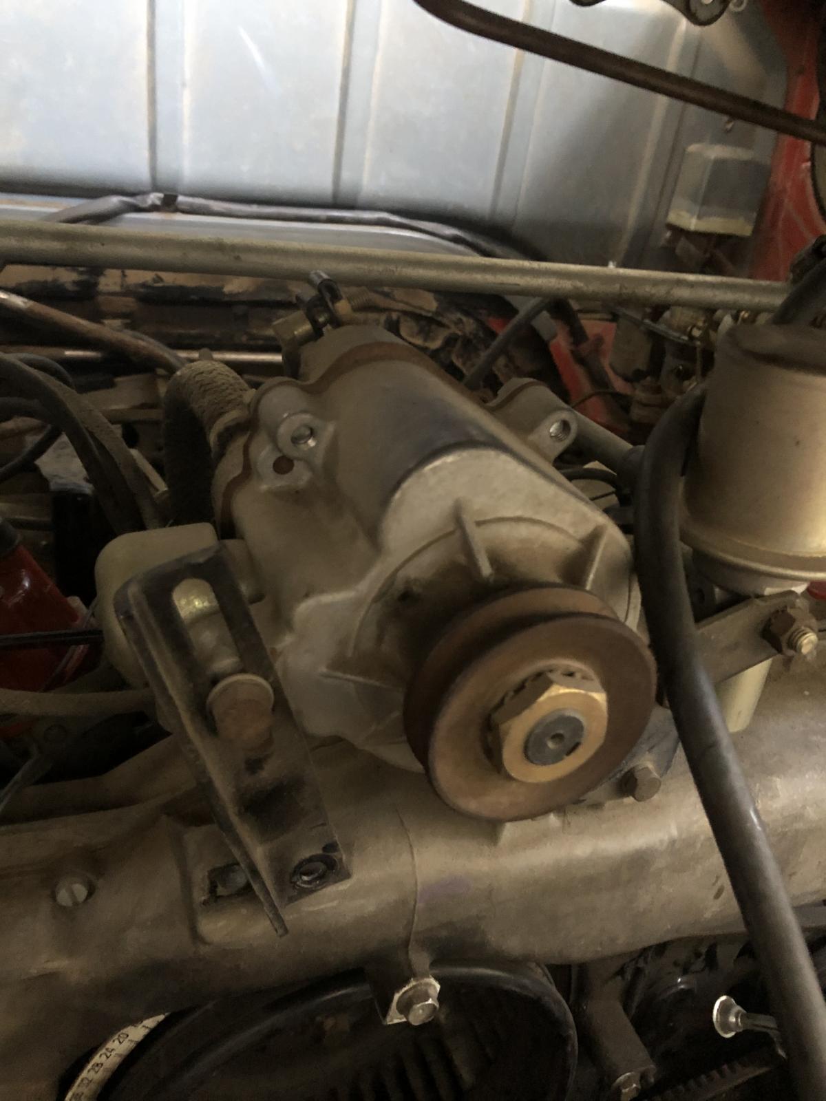

Recently purchased this 73 Bus ,1700 engine.Complaint was that it was leaking fuel out the bottom.Appears some parts are missing like throttle cable return spring ?Anyone school me on what the round canister with relay on it and the fuel lines going into it is for?I see where the return spring attaches to the throttle cable but where does the other end hook onto?Looks like the EGR pump is seized are people removing these or what’s best?Thanks!

Wow!, that's a really clean and original looking bus! (for the most part).
The throttle spring attaches to a hole in the reinforcement rib in the engine compartment roof, there's a little square plastic ferrule in the hole.
The canister is an Eberspacher BN-4 gas heater, score!
There's not many running a smog pump these days, makes a great decoration though. (the EGR is another system under the engine on the left and then along the firewall to each manifold).

Wow forgot all about the heaters on some these VW!So if I remove the air pump can I remove EGR valve and hoses and plug everything?I will have to go look for the spring hook up. Thanks a lot for the response and great answers to my questions!

smog pump injected air into the exhaust stream at the heads to assist in burning any CO into CO2, and HC into H20 and CO2. The technology in general was replaced with catalytic converters. EGR injects burned gases that have no oxygen left into the intake. It maintains the compression ratio but lowers combustion temperature to reduce NOX.

Yes, you can remove the afterburner system and the EGR system as well, you'll have to plug the holes in the heads for the afterburner pipes and cap the manifolds and exhaust where the EGR connected, you'll also need a 72 style crossover pipe for the central idle system (no takeoff for the afterburner pump).
Try to take it off nicely, some day you may want to have all the correct parts.

Ya the original owner had it all undercoated and it’s falling off now but underneath is beautiful .Maybe I will inspect the seized air pump and leave that system on there.I found the plastic insert where the return spring connects just need to find a proper spring now.

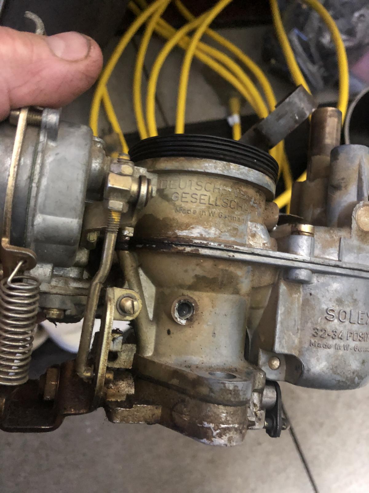

I’ll have to look some more didn’t see that color of a wire near there,but I do have some wires near battery that weren’t used and taped all up.The brass fitting for the distributor advance is snapped off also so I will have to drill that out.Does anyone know what the threaded hole is for on side of carb?It appears to have no hole inside there but just not sure if I can’t see it?
