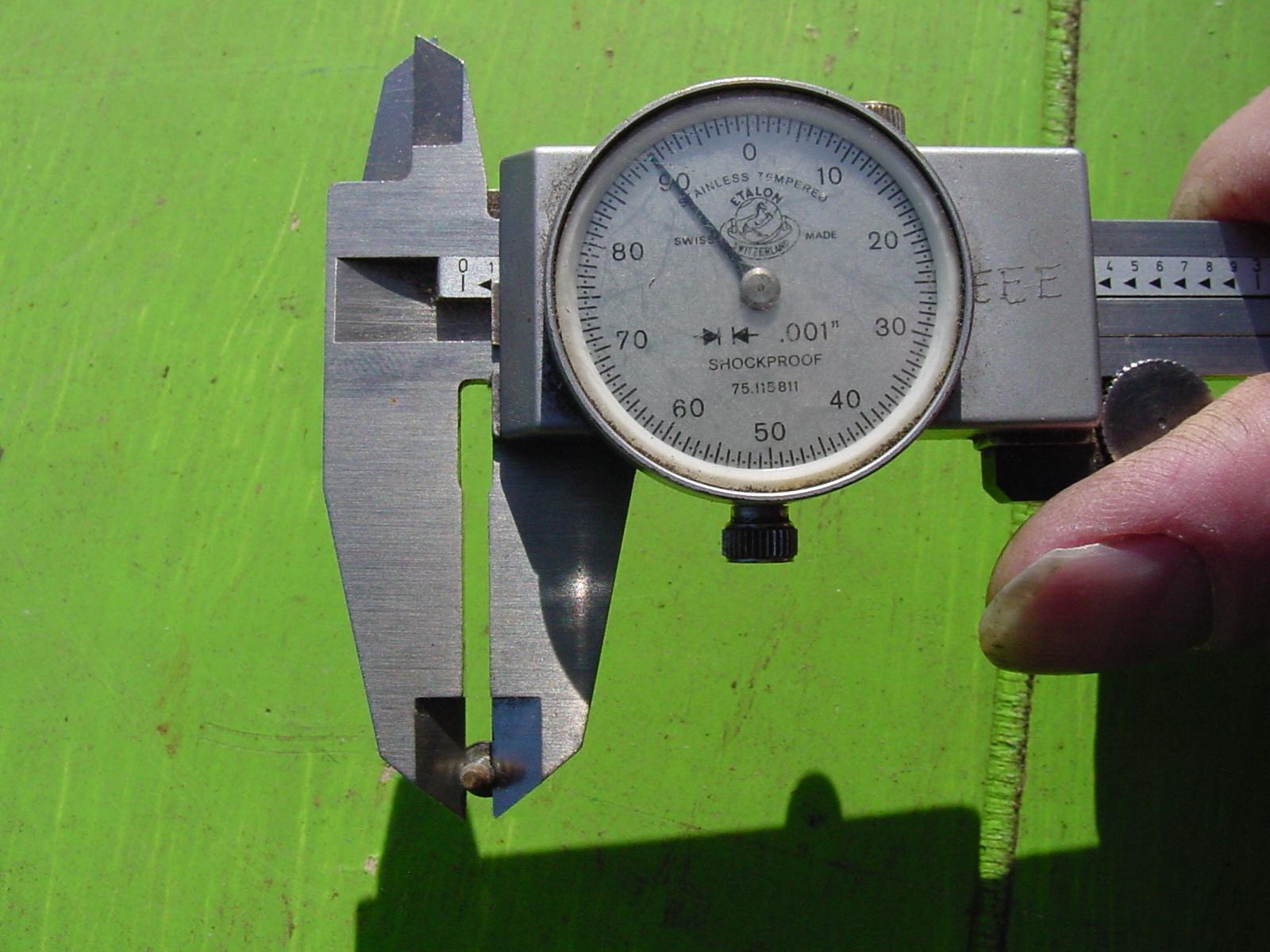

Would you happen to know the type and size of screws used for the plate?
Refreshing an oldie to ask the same question: Does anyone know the type and size of the screws for mounting the VIN and M-code plates to the firewall and bulkhead, respectively?
For a 1962?

Correct, the non-riveted models/locations...the little roundhead, slotted screw.
EDIT: I've looked through parts catalogs a while back and could not find anything. I'd like to know for reference and have that info out there for those that might need to replace them and want the correct type of screw...
Couldn't find any at hardware store either that match correctly...I need a hobby haha.

Here is the M-code plate screw from our midDEC62 single cab.
Length 8.84mm:
Outside of threads 3mm:
Head diameter 5.3mm:
Height of the domed head 2.2mm (Approximate due to the slot cut thru it:
Measured in the valleys of the threads 2.24mm:

Finally got around to pulling out the mounting screw for the engine compartment VIN plate from a cut up bus here. Same general dimensions as the Mcode plate screws shown above.
