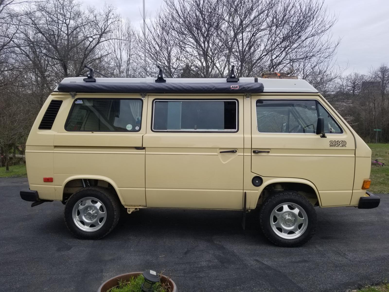

PostPosted: Mon Mar 16, 2020 9:46 am    Post subject: Re: CLK wheels Reply with quote
2wd 83 Westfalia
Burley Upper control arms
1.5" GoWesty lift springs
98-00 CLK 16x7 - I think ET37?
I plan to run my 'desired' 98-00 CLK wheels. I also plan on buying 215/65R16 KO2s.
I'm talking with T3 technique and trying to figure out what spacers are ideal. I'm currently running 10mm and worried about upper fender crunch.

shagginwagon83 Premium Member
Joined: February 07, 2016
Posts: 4303
Location: SWVA
shagginwagon83 is offline
PostPosted: Fri Mar 27, 2020 12:43 pm    Post subject: Re: CLK wheels Reply with quote
I found a deal on some 215/65r16 General Grabbers for $200 a set - installed. Decided its time to put on my CLKs. I had to decide between my $155 chrome set or my $200 powdercoated black set.
I went with the chrome set.
I'm currently running 10mm spacers but I think that is too much. In the rear I can run no spacers. In the front I'm not sure. Need to do some testing.

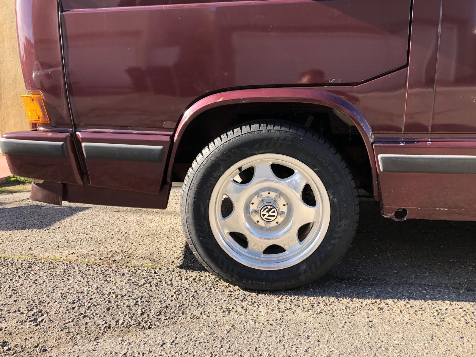

ezmass
Joined: August 26, 2019
Posts: 13
Location: Fort Collins, CO
ezmass is offline
PostPosted: Wed Apr 22, 2020 12:03 pm    Post subject: Re: CLK wheels Reply with quote
Recently installed a set of CLK's on my 1990 Multivan. Running 7mm spacers & conversion studs up front from T3, no spacers on rear for now. I went with 215/60 Nokian Entyre 2.0, mainly because SmallCar and VanCafe both sell this tire so I figured it was well suited for the Van.

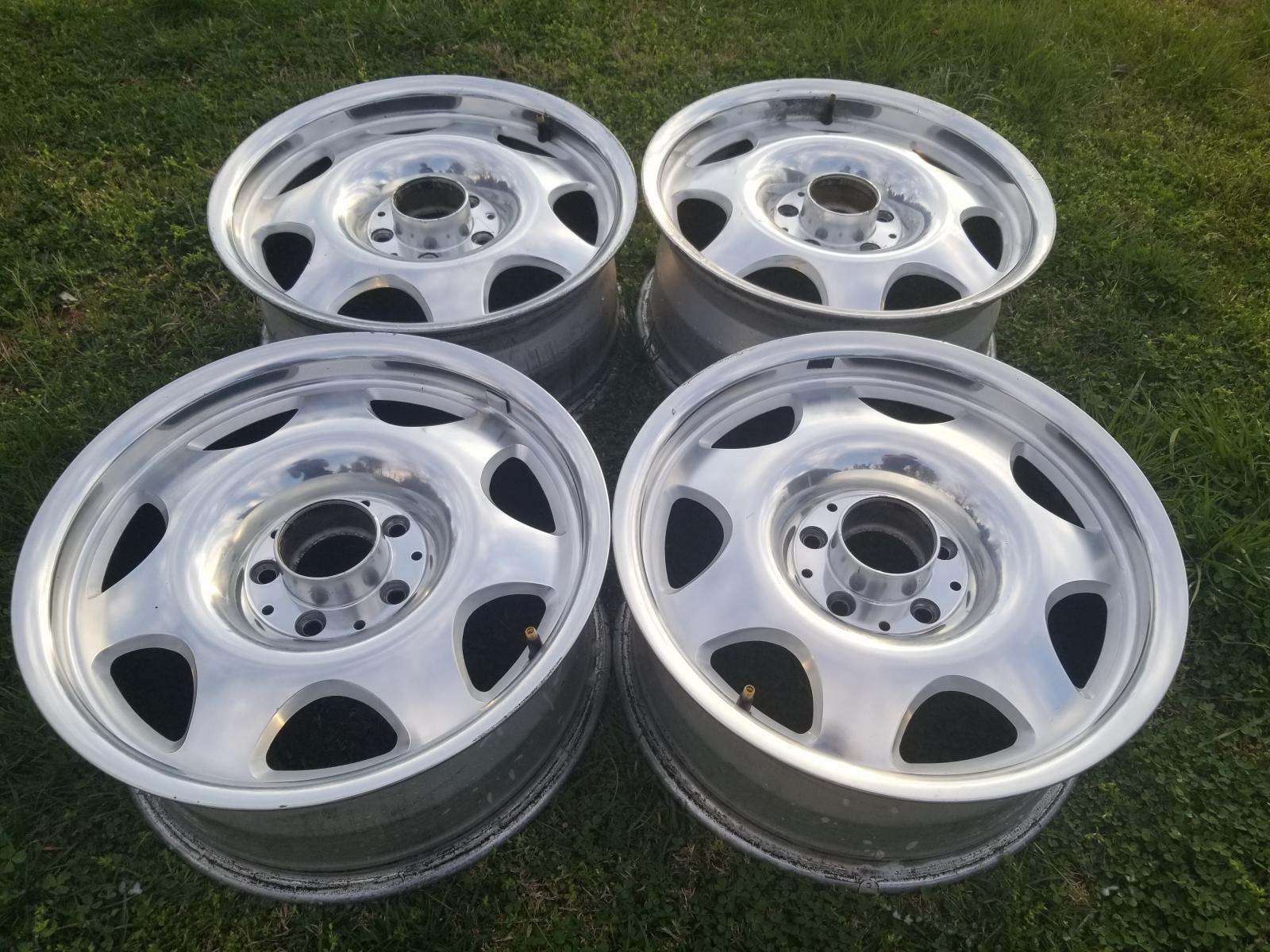

Posts: 4303
Location: SWVA
PostPosted: Tue May 05, 2020 4:33 pm    Post subject: Re: CLK wheels Reply with quote
set of 4 CLK's in Stone Mountain, GA - facebook marketplace - $350
https://www.facebook.com/marketplace/item/235159417898842/
