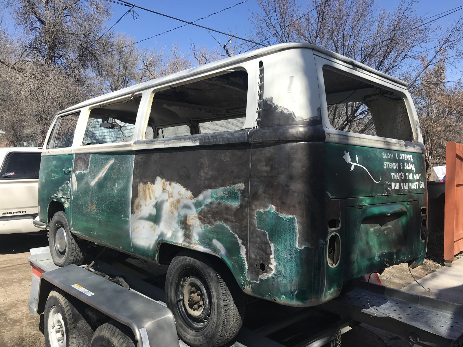

Hello everyone.

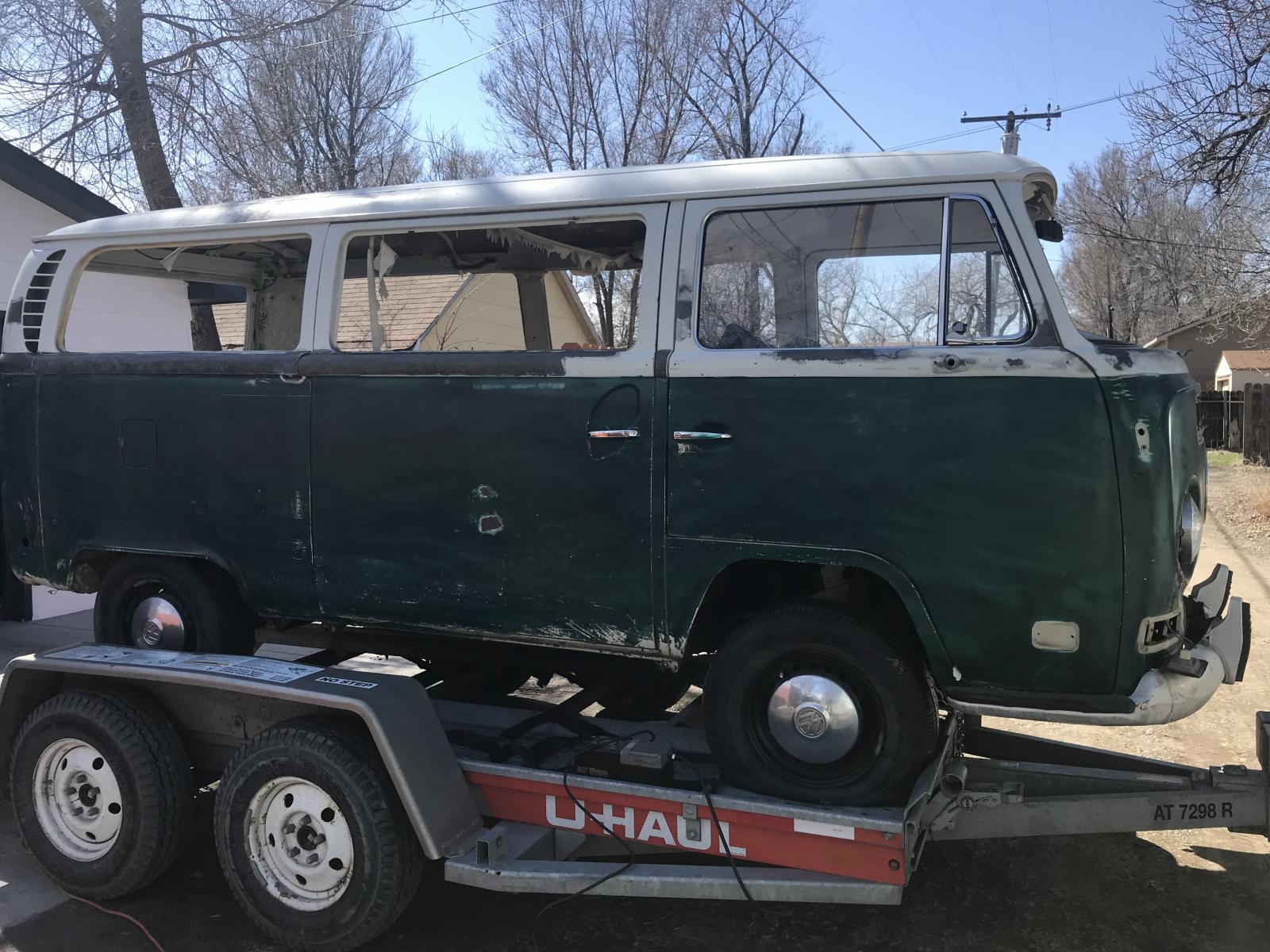

I picked up a 1971 VW Transporter Deluxe last weekend in the great state of Montana. A mostly rust free straightish early bus with part of the interior present but not in the greatest shape. No engine but it did have the transaxle, new tires, keys, and a battery?! The previous owners had the bus since 2009 with some documentation but I found records inside the bus going back to 1998. I thought that was pretty neat.
They said they removed the bus with plans of a complete rebuild but lost sight of the project a few years ago. They said they had many years of fun and hope that it would be driving on the road again someday. I said, not to worry, I'll be getting er going ASAP!!
Here she is all loaded up in Great Falls, MT ready to head to Billings, MT.
Getting the tires aired back up to roll it off of the trailer. Someone had some good thinking back when they painted the bus. It looks like it is mostly spray paint but its been like that for at least 20 years, per the records found inside which identified the color.

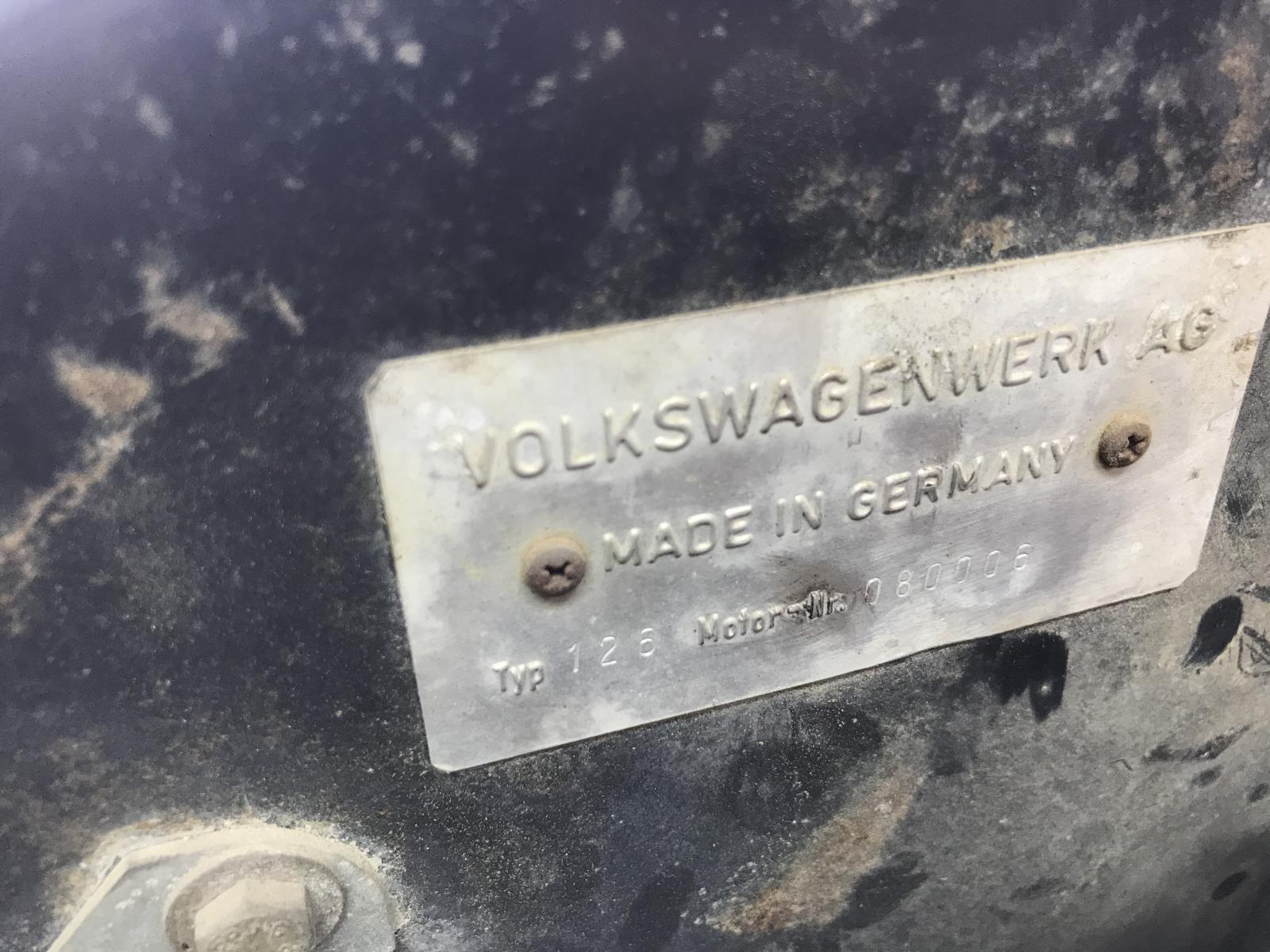

I ran the M-Code plate and here is what came back.

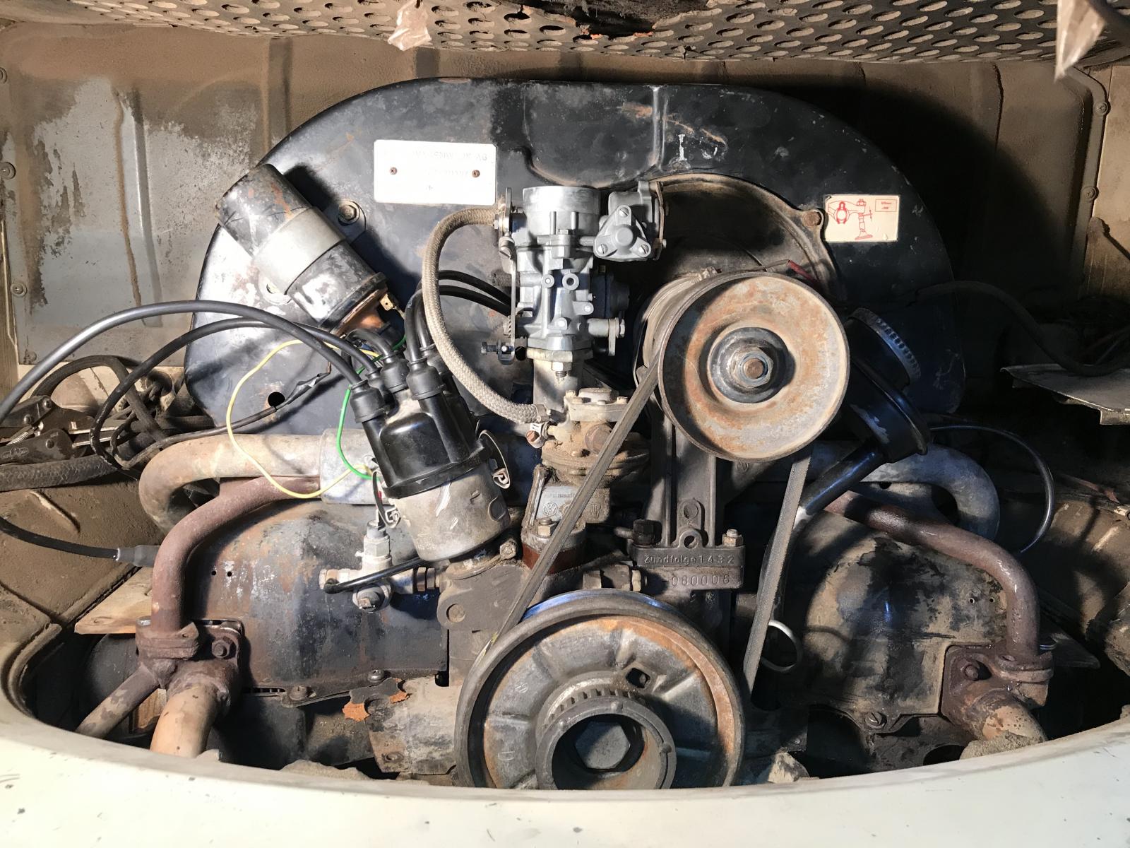

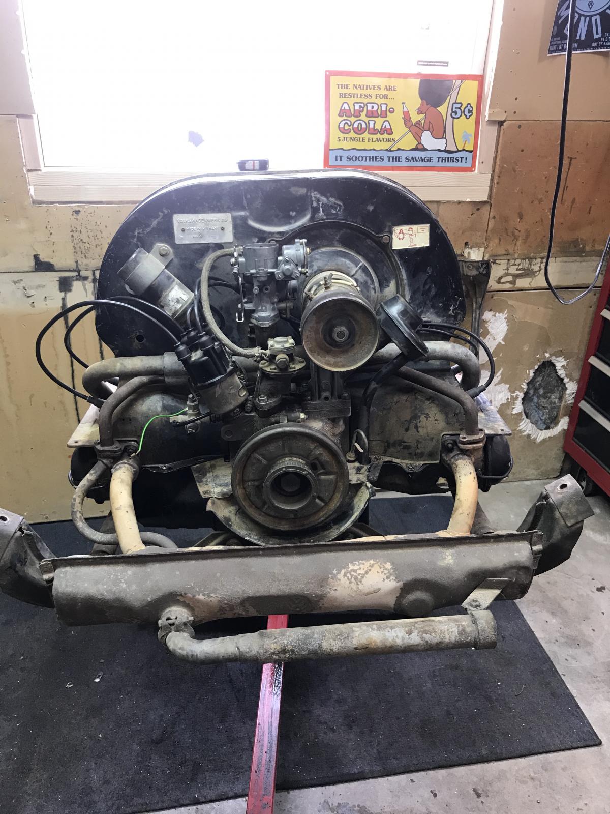

This is the engine I'm putting in. It is a Type 126, 1600cc single port Industrial engine. I've removed the heads and p/c and clean up the carbon; inspected the rods and everything appears to be tight and within spec. New seals and gaskets and got it put back together.
This is my first early bus so I'm learning what is what, but so far I this is what I have.

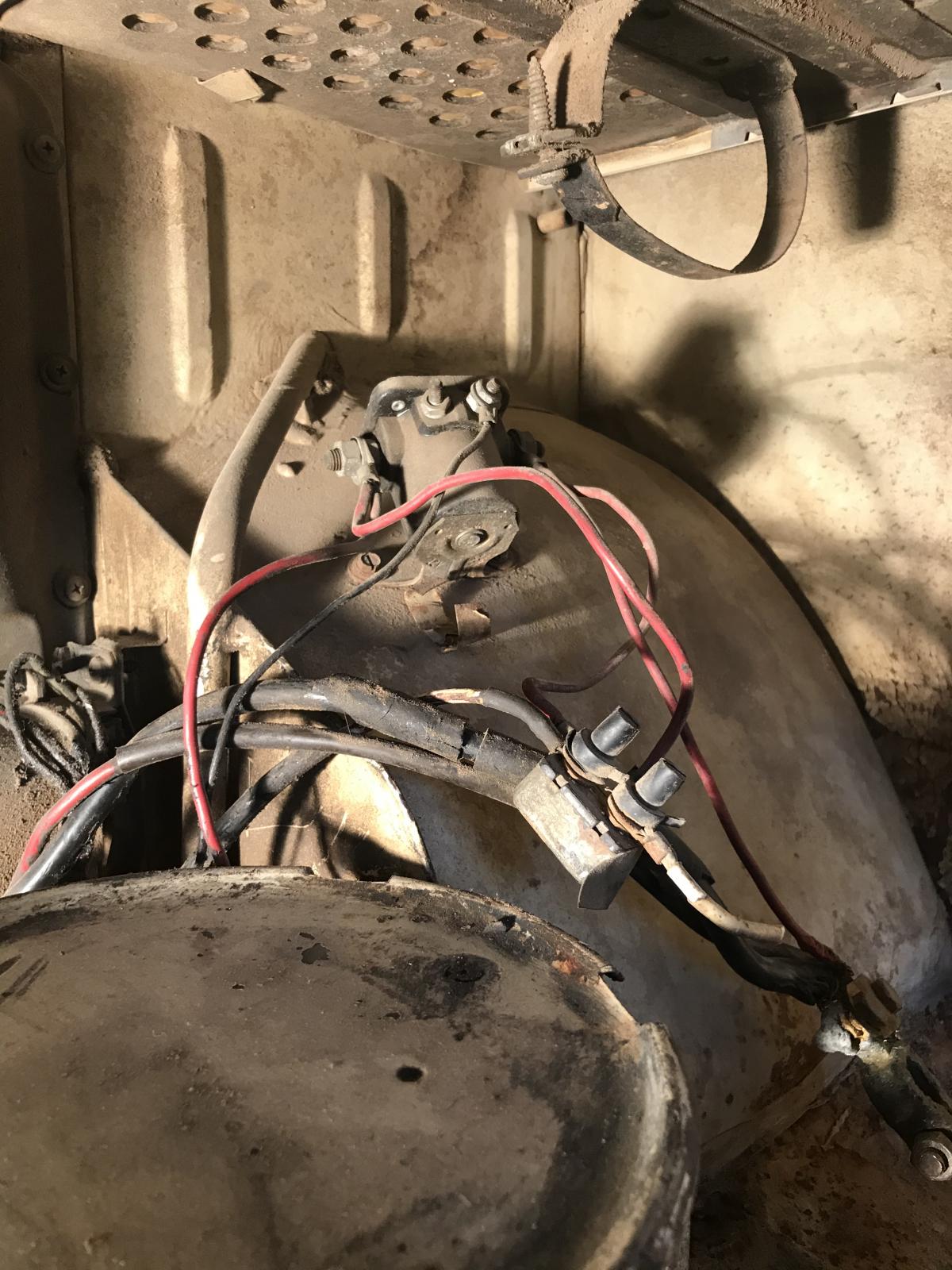

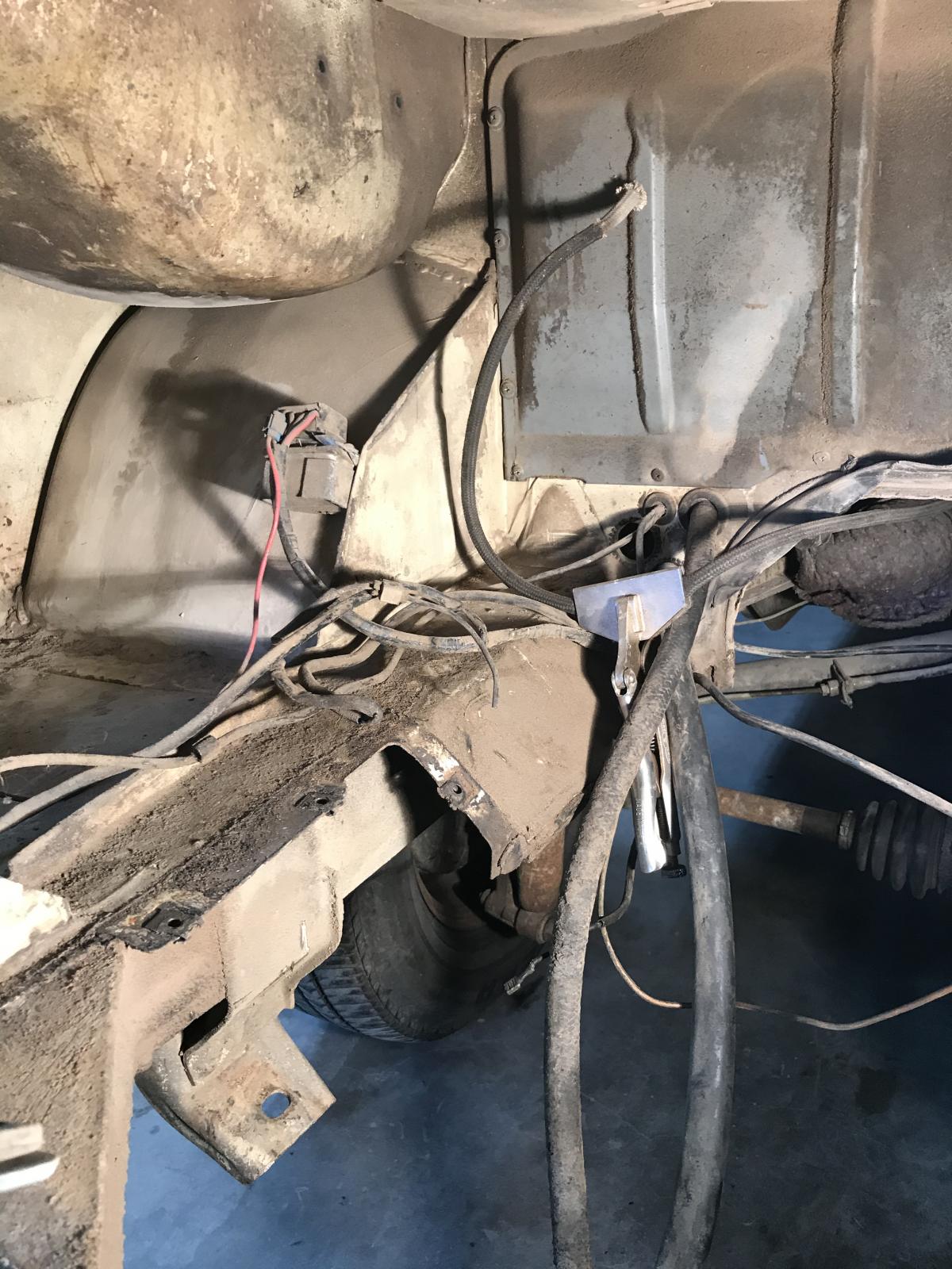

Starting on the right side of the engine bay.
The middle left is the regulator, which has three wire going to the battery. Not sure what the unit is on the top middle with a smaller unit attached to it, which also appears to have a live wire going to it.

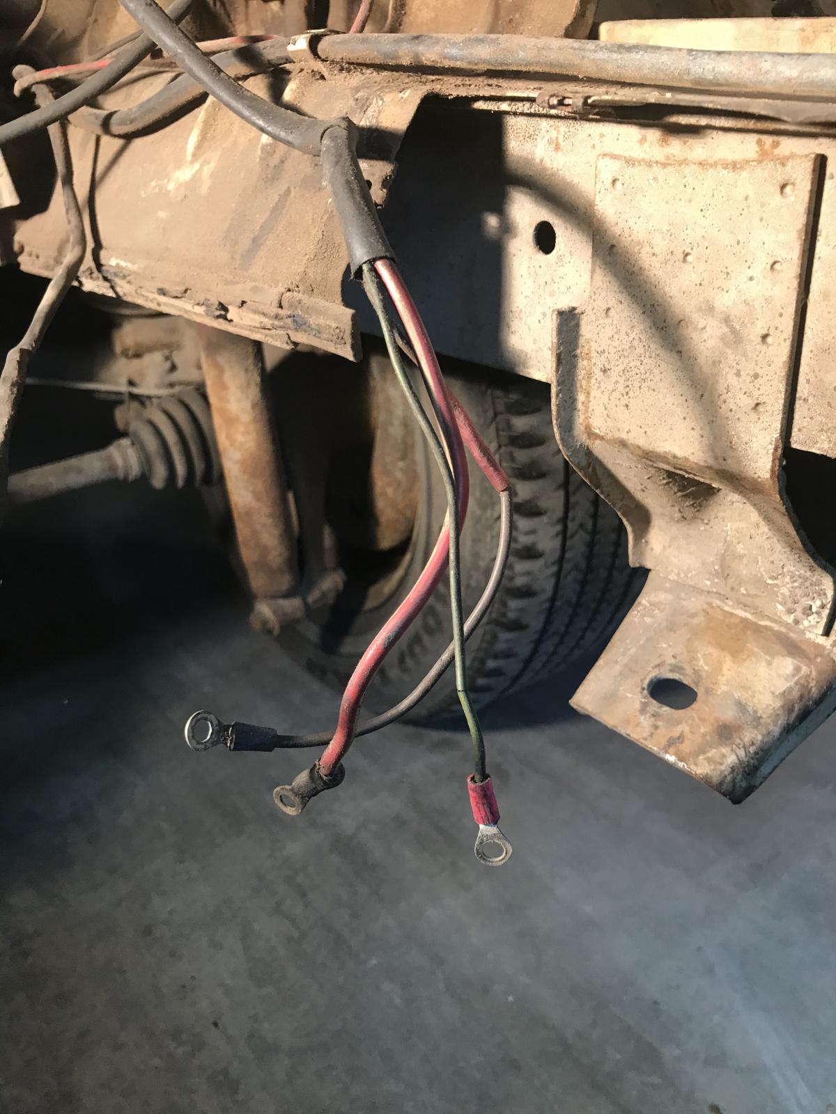

Going over to the left side of the engine bay. Not sure if there was a propane heater at one point but there are two thick hoses with metal fittings. It looks like there is a relay unit that has wires going to the brake lights and back-up lights. There is also a black wire hanging from the light housing, not exactly sure what that is yet.
Planning on prepping everything for a possible install this next week. I was hoping to have it done today but I'm not sure about the current wiring in the engine bay and need to review the Bentley for a level of comfort.
If you have any tips for me on the install, please let me know.

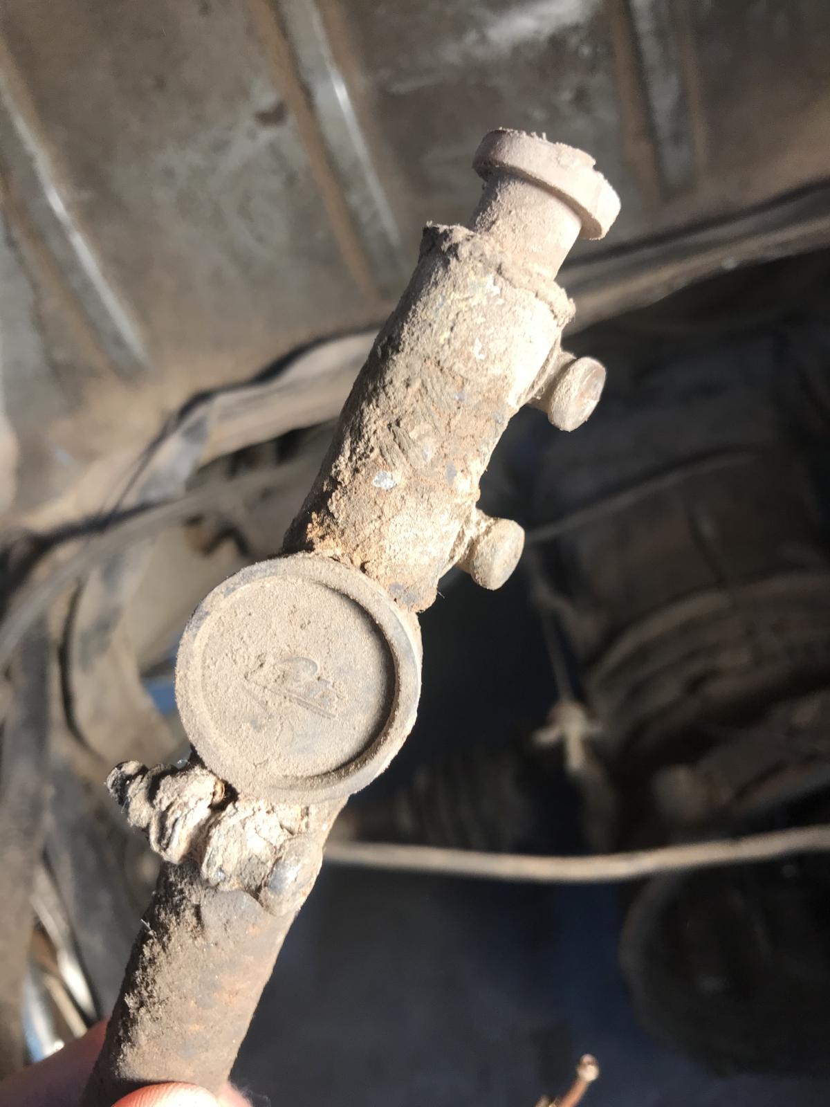

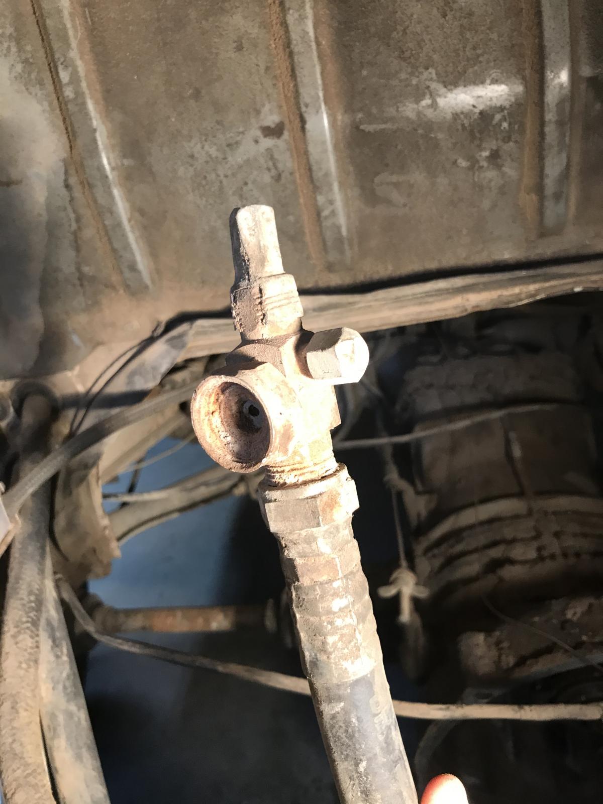

PostPosted: Sun Apr 12, 2020 4:03 pm    Post subject: Re: Sawyer's '71 Transporter Deluxe Reply with quote
On the left
The fat hose with the check valve, arrow to motor, is your brake booster vacuum line. That will hook up to the manifold on the left side
The other fat hose is either heater or AC system, aftermarket.
On the right on top of the fender is a cold start relay, or as I call them , a โ€œ Iโ€™m too lazy to fix my car โ€œ relay
Sorry thatโ€™s harsh. Someone had trouble getting the car to crank, so they installed that relay instead of fixing the problem
Most of that wiring Is badly sub- standard.

Abscate wrote:
On the left
Ok, so I do not have the original engine and with that, I do not have the manifold that has the port for the brake booster. Any chance there is a modification to use with out the manifold port?
As for the cold start relay, I think I'll leave alone until it does not work or I need to inspect it. Thanks for the help in identifying some of the parts.

You might want to go through the ratwell page and figure out some of those weird electrical hacks.
https://ratwell.com/
nice early bay. I've never seen the vw metal tag on the fan shroud before. I wonder why it is there.

I'd guess the tag on the engine is because it is an industrial engine ??

Yes, thats a single port industrial engine, not original
It won't have the vacuum port for the brakes since single port Busses didn't have power brakes.
This is an easy port to put in onto one side (drill, tap, brass fitting) , if you put onto both sides we will poke fun at your here. Very Happy

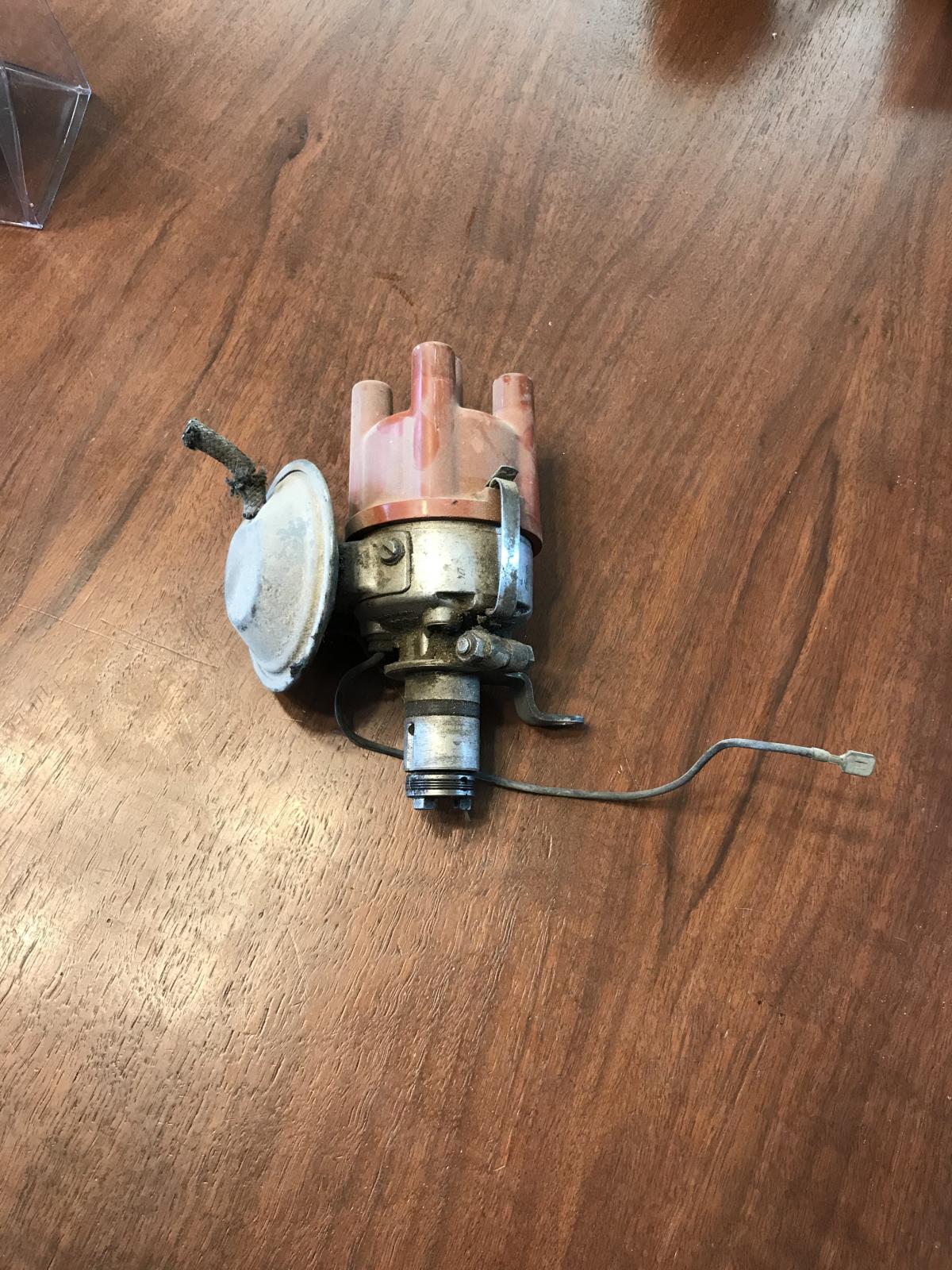

Also, the distributor on the engine is frozen to the case. I untightened the nut and it won't turn at all. I didn't want to try anymore because I thought maybe if it was timed perfectly, I wouldn't need to adjust it? I'm not sure my logic is that great here.
If the distributor is the issue, I do have a 031 that I can try and use. I am currently using an 003 without a vacuum advance paired with a 28 Pict carb. I know the set up isn't ideal but it is what I have to use at the moment. The 28 Pict does have a vacuum so the 031 might go well with it.

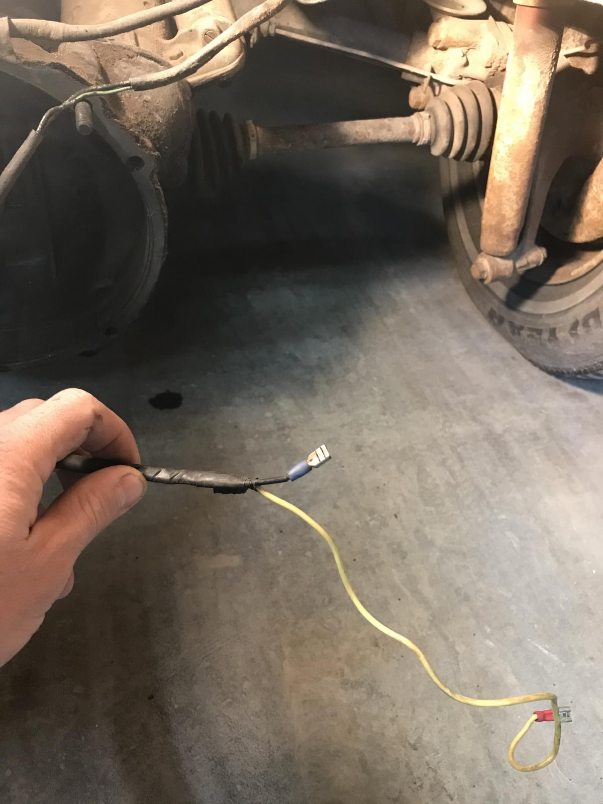

Also, the yellow wire going to the oil pressure is connected to a blue-green wire going to the front, and the black wire it is housed with is going to the coil #15 side.

PostPosted: Sun Apr 19, 2020 11:18 am    Post subject: Re: Sawyer's '71 Transporter Deluxe Reply with quote
Blue-green is the factory sender wire color.
Anytime you have a no spark issue, with power to the coil and engine โ€˜crankingโ€™, use your test light on the negative coil post. If it blinks, everything under the rotor is working as it should. Steady light or no light indicates points or condenser problem, or a distributor shaft not turning.

PostPosted: Sun Apr 19, 2020 11:19 am    Post subject: Re: Sawyer's '71 Transporter Deluxe Reply with quote
Update:
I replaced the condenser and the points appear to be working correctly by cutting off the #1 on the coil when they are not engaged. Still no spark to the plugs...
Could it be the distributor?

PostPosted: Sun Apr 19, 2020 11:36 am    Post subject: Re: Sawyer's '71 Transporter Deluxe Reply with quote
[quote="Jeff Geisen"]Blue-green is the factory sender wire color.
Anytime you have a no spark issue, with power to the coil and engine โ€˜crankingโ€™, use your test light on the negative coil post. If it blinks, everything under the rotor is working as it should. Steady light or no light indicates points or condenser problem, or a distributor shaft not turning.[/quote
I replaced the condenser, and I believe the distributor and coil are now working correctly. Still no spark to the plugs.
