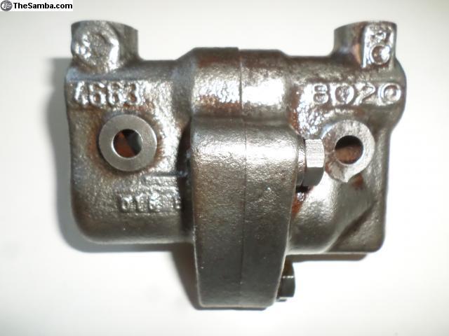

Tcash wrote:
To link to this post copy and paste
Code:
[url=https://www.thesamba.com/vw/forum/viewtopic.php?p=8115511#8115511]Brake Pressure Regulator t2 211 612 501[/url]

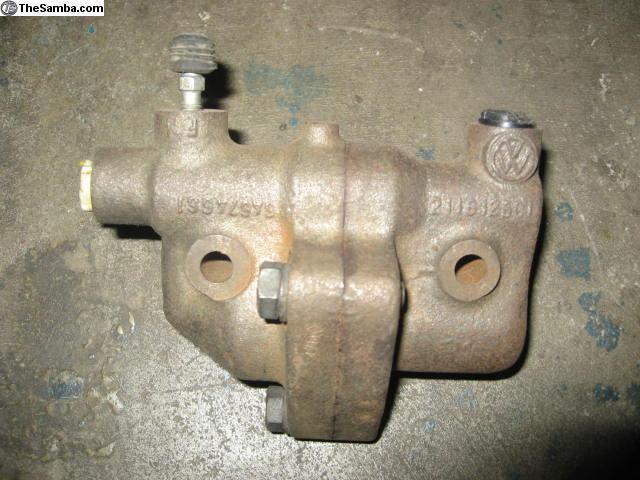

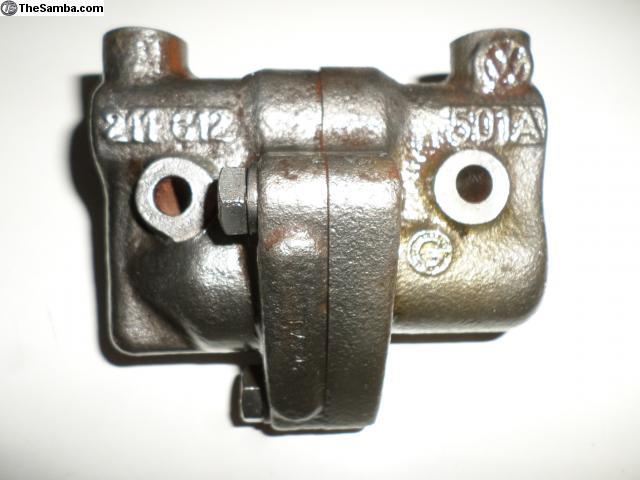

211 612 501 Brake Pressure Regulator Early t2. Note bleeder valve on top of valve.
211 612 501 A Brake Pressure Regulator Late t2. Note brake lines attach to the top. No bleeder valve.

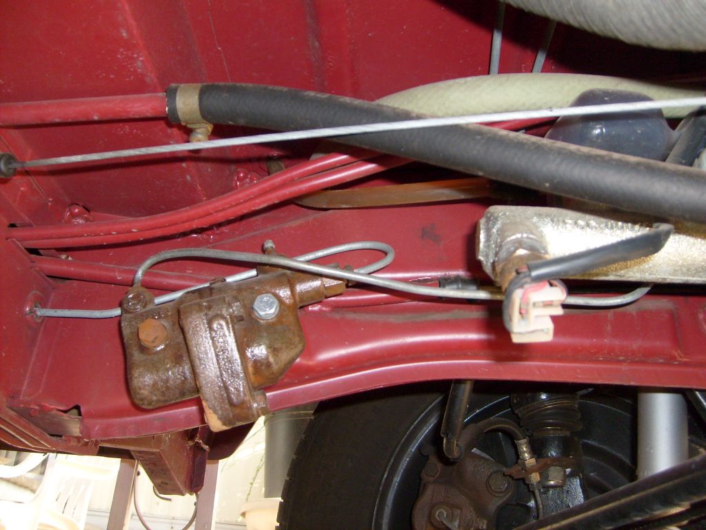

Located on the frame rail.

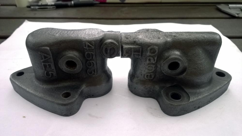

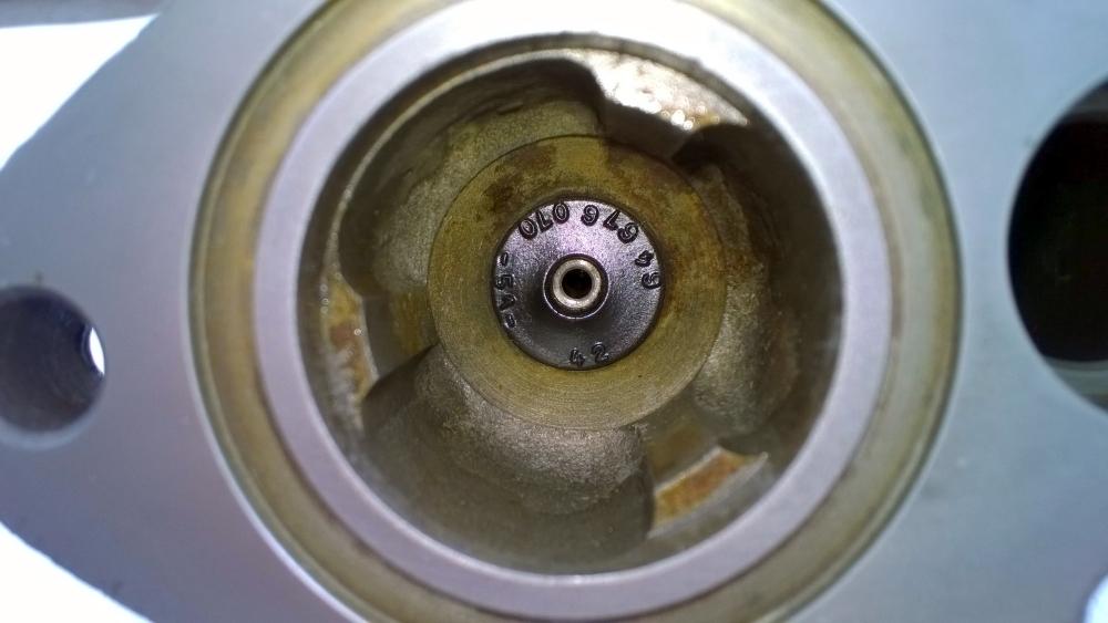

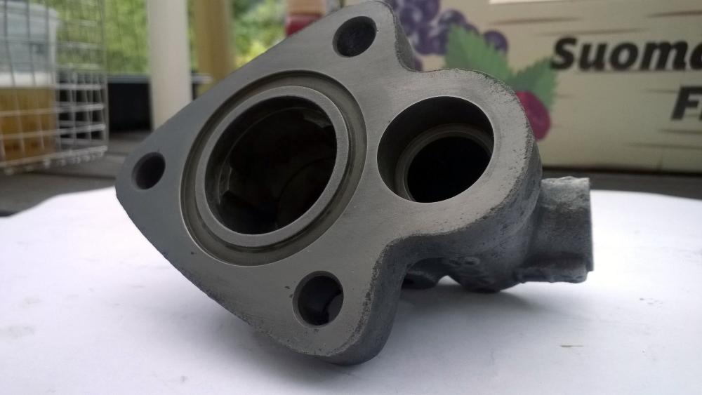

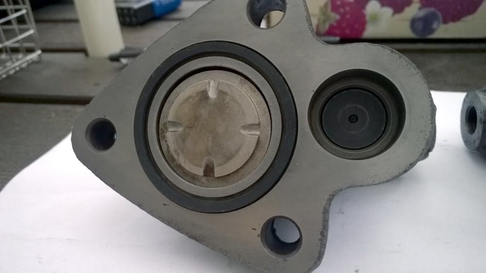

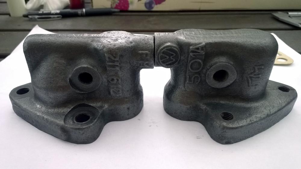

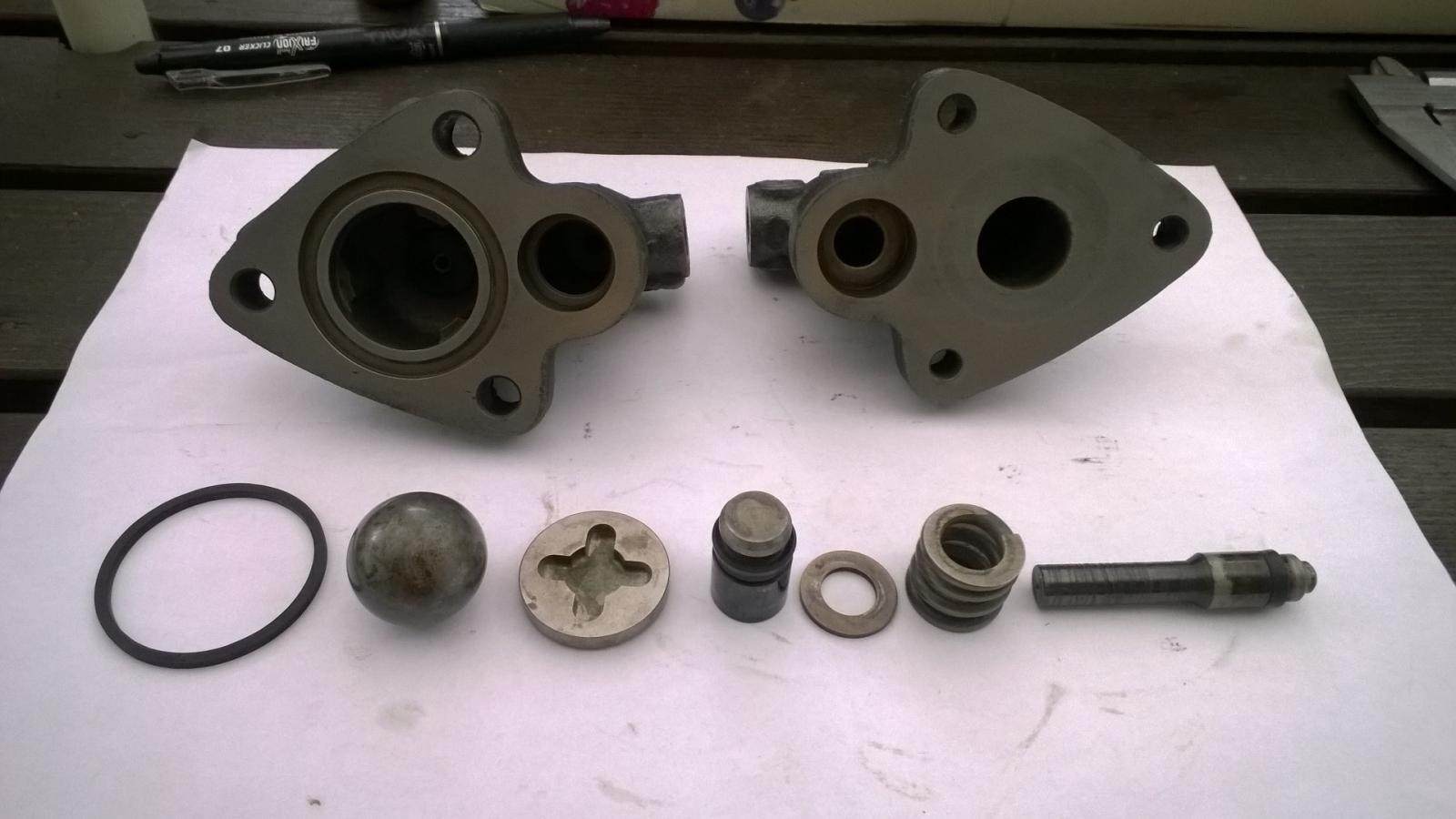

Welt wrote:
Brake pressure regulator got the ultrasonic treatment too. Soaked the whole part in ethanol before disassembly.
Cleaned the mating surfaces with wet P800 paper.
Valve seal was fine. And all the piston bores looked ok. Piston seals were also in good condition.
Made my own gasket to replace the old crusty one.

So.....the late one does have a rubber valve seal and a piston seal. Its interesting how they simplified the late unit.
The seal on the late model is also a standard cup type seal and can be machined from EPDM stock. Ray

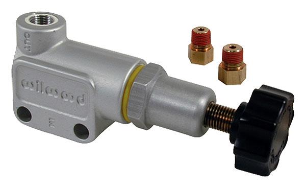

My brake pressure regulator seems to be leaking. Im planning on taking it apart soon. Just curious what kind of gasket material will work with brake fluid? EPDM rubber? I've been having trouble find anything in store that's brake fluid compatible...
Also is it possible to replace the VW style brake pressure regulator with one thats more of a modern design / more readily available?

It was engineered specifically for the characteristics of the VW bus braking system, so I doubt you would find
anything remotely similar in a generic item. The gasket that usually leaks is "paper". There's an o-ring internal
to that with a rectangular cross-section. Someone posted within the last week or so on this forum their measurements
of all the seals in the pressure regulator.

...I did stumble upon this Wilwood brake proportioning valve. It'd be great if something like this was useable in the bus.
Really finding an adjustable one that works for regulating the pressure...is not a problem. Summit alone has at least 400 part numbers and variations.
The difference....is that the bus unit ....uses the inertial forward shift of the bus to tell it WHEN to start regulating. What it regulates to....is not variable. Virtually none of them are.
There are two different kinds of rear brake pressure regulating that are important....not just on a bus but on any car:
1. Long moderate to hard braking (think like downhill at 60 mph) where pressure is increasing...shoes/pads are getting hotter...and therefore brake efficiency will keep increasing (to the point where they get too hot and fade).
The inertial shift is not a big issue with this one but you CAN get rear skidding. At some point when pressure gets high enough....most rear brake pressure regulators....LOCK....the pressure at that point....but sustain it. This prevents wheel skid.
2. Panic braking....sharp, hard jab at the brakes....which causes the rear of th vehicle to lift and the nose to dive. You may not have yet even reached peak "regulating" brake pressure at the rear....but when the weight lifts off the wheels....it takes less force to cause them to lock up.
This is where the inertial (the rolling incline ball) feature comes in handy. It should lock or sustain pressure so it cannot rise any further.
From the cross section diagram posted earlier....I 'think"....the bus regulator does both jobs.
While the layout is different than the 914/411/412 unit.....the parts shape, size and function based on their fluid ducting are the same. That type of unit has a pre-set pressure (based on the spring between the primary and secondary piston).
So even with non-panic braking....when you increase pressure to the pre-set point....it cuts off the feed but maintains the braking pressure on the line. You let off...it instantly bleeds down just like the front brakes at the same time.
The ball keeps the poppit valve closed...until inertia pulls it away...and that just bleeds pressure off....but then when that back chamber floods with this pressure it should equalize across the primary piston...and "may" also modulate the pressure and not just bleed it off. But that last part is speculation.
That inertia effect is pretty important on the bus....for panic braking.
However....if you just needed the normal brake pressure modulation I described earlier....yes....you can find a whole rage of adjustable rear pressure regulators....but you need to choose carefully. It has to have the right range of adjustment and should maintain pressure at the stop point...not just bleed it off.
The 914 model does this. It has no inertia feature like the bus. It has a sensitive set up that is designed to stop increasing brake pressure at 530 lbs.
I have a little bit about aftermarket pressure regulators in this thread
https://www.thesamba.com/vw/forum/viewtopic.php?t=664753
But...with the height and weight of the bus...you really need teh inertia feature....unless you do something that prevents a good portion of it (i.e...less weight in the back, some lowering and suspension stroke limiters).
Ray

I actually started reading your thread! Thats where I got the idea for the Wilwood regulator. I'll have to look more into it. Thanks! Sounds like I should stick with rebuilding the original for now. I'll do more research on the aftermarket ones.
I edited in a question about Karropak gasket material on my other post. Any idea if this would be a suitable replacement for the paper gasket in the original VW brake pressure regulator?
