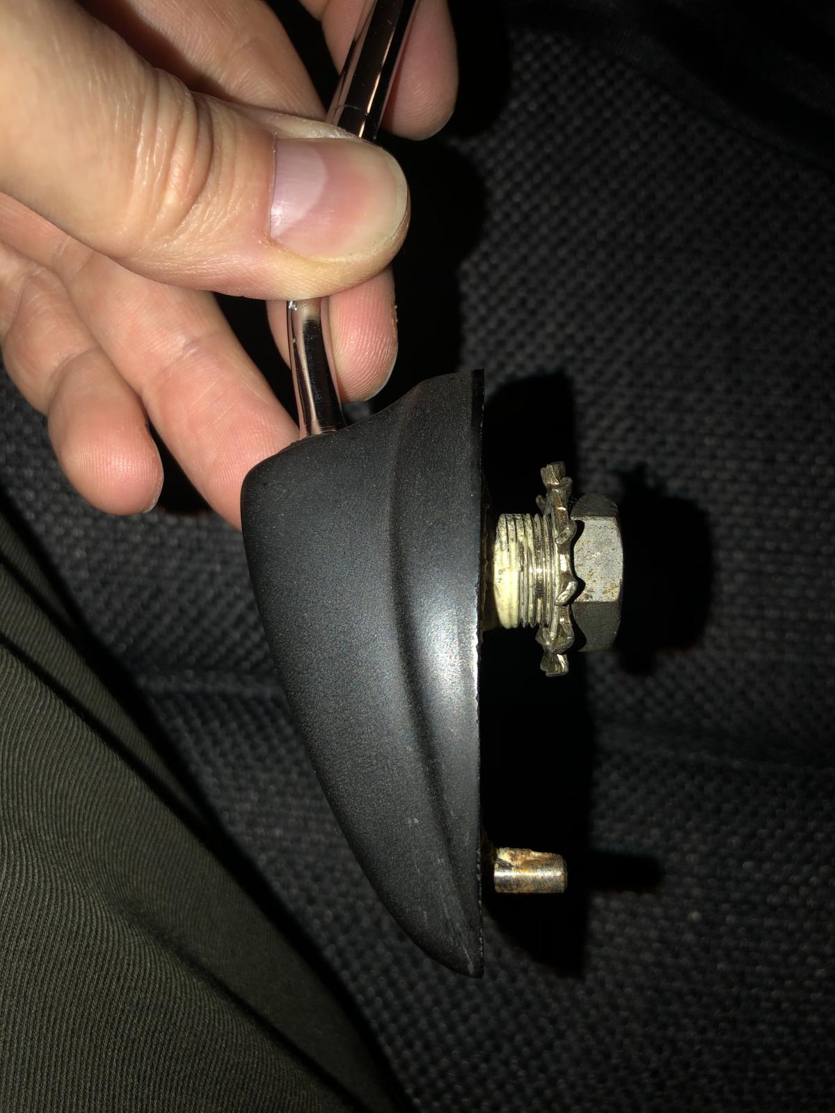

I found the culprit, one of my Motorola male connectors came loose.
I am not familiar at all as to how they should be fitted. Does the ultra thin center wire need soldering in the connector ? How do you do that?

The Hirschmann antenna? I solder it. You either start with a new male plug or heat up your old one and blow out the solder. You have to cut back the woven coax shield to expose a short length of the center wire. Don't melt the plastic insulation while soldering. Most male connectors have a hole in the end to push the wire out of then solder the tip. The braided ground has to be exposed from the plastic sheath so you can solder a little bit of it to the outer ground part of the plug. Sometimes you can invert the braid back over the sheath.

Yes I have a retrosound radio but want to use my old Hirschmann Antenna. If I am not wrong, the double male connection cable uses Motorola connectors or are they of another type?
I must say that I don’t trust too much my soldering skills, and would rather go with a new cable even if not period correct. Does anyone have a source? I found a cable adapter on the net but it seems too short

Thank you. I found a matching cable from Hirschmann .
