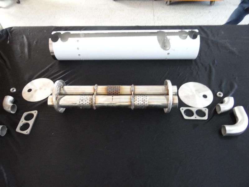

Zed999 wrote:
I came across this which while it doesn't spec the VS exhaust might be interesting.
1 & 3 are paired together inside the exhaust as are 2 & 4.
2 & 4 have to travel a little further than 1 & 3 to escape into the main body of the exhaust which must somewhat make up for the shorter distance through your heater boxes.
This particular one is destined for a Beetle. The tail pipe(s) are connected to the central chamber. There are holes to the outer cambers, but no flow through them as far as I can see and that's where the AFR fittings are. I'd like to see inside a side exit bus version.
https://blog.bbt4vw.com/2019/10/30/asia-factory-tour-building-an-exhaust-vintage-speed/

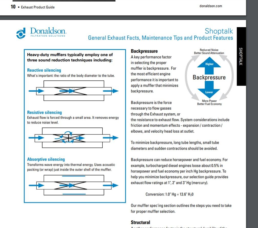

Check this out:
https://www.donaldson.com/content/dam/donaldson/en...-Guide.pdf
Most specifically...this truck muffler company makes stainless mufflers...lists flow rates, has excellent technology, makes mufflers with straight through and offset inlets and outs in a range of sizes.
Specifically look at the tech in the first 10 pages....scroll through and then look at the guide starting on page 65.
Look at style #1 and #2 on the guide pages

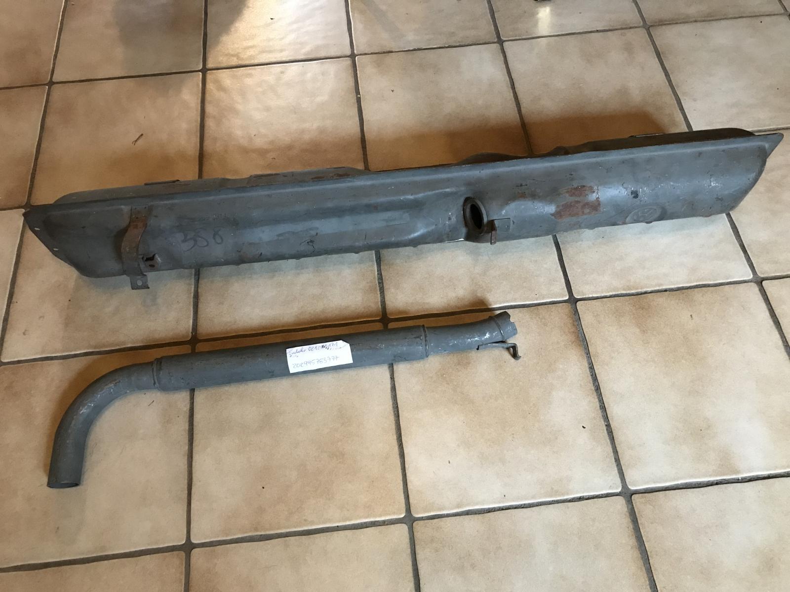

Closed end tube? What is that? Do you mean it has a small tube on the end opposite the tailpipe? That would be an EGR connection. If your 411/412 is not a California car and/or does not use EGR...no...you do not need that tube. You will find at the links below that the ones with EGR tube and the nes without are seperate part numbers and both are available.
For a basic stock exhaust.....for a 1.7L or 1.8L....its not too hard to find one. But....there is wide variation in quality.
The most common one you will find is Dansk. Made in Denmark. However.....while they are perfectly serviceable and do last well...the welding quality is kind of poor. While they will not fall apart...they are a bit restrictive.
https://www.autohausaz.com/pn/13167865-071251053E?...-QQAvD_BwE
https://www2.cip1.com/ProductDetails.asp?ProductCode=VWC%2D071%2D251%2D053%2DE
Other mufflers:
This one on ebay is called a "damper type" muffler. It is about 30% more quiet than the muffler with the end mounted tailpipe....but it a little more restrictive. Not that it will make much difference byt can run a little hotter in hot climates.
https://www.ebay.com/itm/VW-411-muffler-70-74-yr-4...Sw6tte4nyR
Also....the damper style ebay muffler...does not come with a tailpipe. The tailpipes are VERY hard to find. They have not been in production in maybe 30 years. They make both left and right hand versions and they are not interchangeable. So if you decide to buy that muffler....make sure you find out if its right or left hand and FIRST locate a tailpipe. It cannot be used without the center outlet pipe.
There are usually some NOS center outlet pipes for sale in the classifieds...but again make sure they are right or left hand.
THIS....is an EXCELLENT muffler. Leistritz i one of the best brands. Very high quality This one is NOS and Heimlich is a great guy and has very good parts.
https://www.thesamba.com/vw/classifieds/detail.php?id=2071676
If yours needs a new tailpipe...ask him or look at CIP1.
Here is another Leistritz:
https://www.thesamba.com/vw/classifieds/detail.php?id=2202086
Another unknown brand. I would find out what brand and ask to see the stamped information plate before spending $240 though.
https://www.thesamba.com/vw/classifieds/detail.php?id=1456385
This one....would be fantastic! A made in Germany, stock replacement muffler....but in stainless steel! It should last forever. But it says out of stock. Between shipping and Euro cost it would be about $500.
https://www.typ4shop.de/Abgasanlagen/Auspufftopf-f...zontalTab2
Another option I hear very good things about is this:
https://store.vintagespeed.com.tw/1973-~1979-Type-4-Engine-Baywindow-BUS-c33978055
Ray

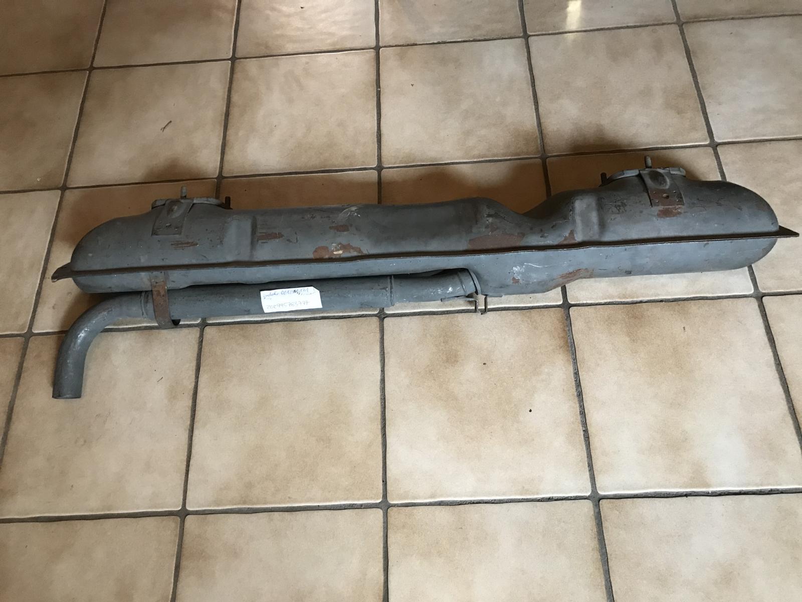

PostPosted: Sat Jan 14, 2023 10:13 pm    Post subject: Re: Ernst 411-412 muffler cross section and dissection Reply with quote
Was looking for info on this muffler, and ended up here. This will fit the 914
with both the notched, and port hole valance’s. Each requires the correct tailpipe. Also seems like it’s stainless, definitely not just stamped steel.
Photo show’s comparison to early stock muffler.

PostPosted: Sun Jan 15, 2023 8:16 am    Post subject: Re: Ernst 411-412 muffler cross section and dissection Reply with quote
The two numbers:
The top number 52 04551 is a Wagner part # for a muffler that fits a range of vehicles from 411/412 to VW bus.
The bottom number with the DK prefix....from everything I (and others) have been able to find appears to be the Dansk part # for the same product.
We have some discussion or these numbers on the first page of this thread and if you search those numbers there are some other discussions in the Bay window bus forums.
As noted on the first page of this thread, over a long period of time we are pretty sure that Wagner, Starla and Dansk have all been seperate parts of the same parent company and may still be and now owned by Jopex.
As for whether it's stainless steel..... on one hand I would be really surprised because outside of the link I posted back in 2018 to a specialty company in Germany who makes stainless reproductions of this muffler for ~$500.....I have never seen a stock stainless muffler made by any of these companies for the aircooled VW market.
On the other hand....with so many companies involved in the manufacturing of these mufflers both now and going back decades....and the fact that Wagner was and has been originally known as one of the companies to first specialize in stainless exhaust system parts.....maybe it is stainless.
Ray

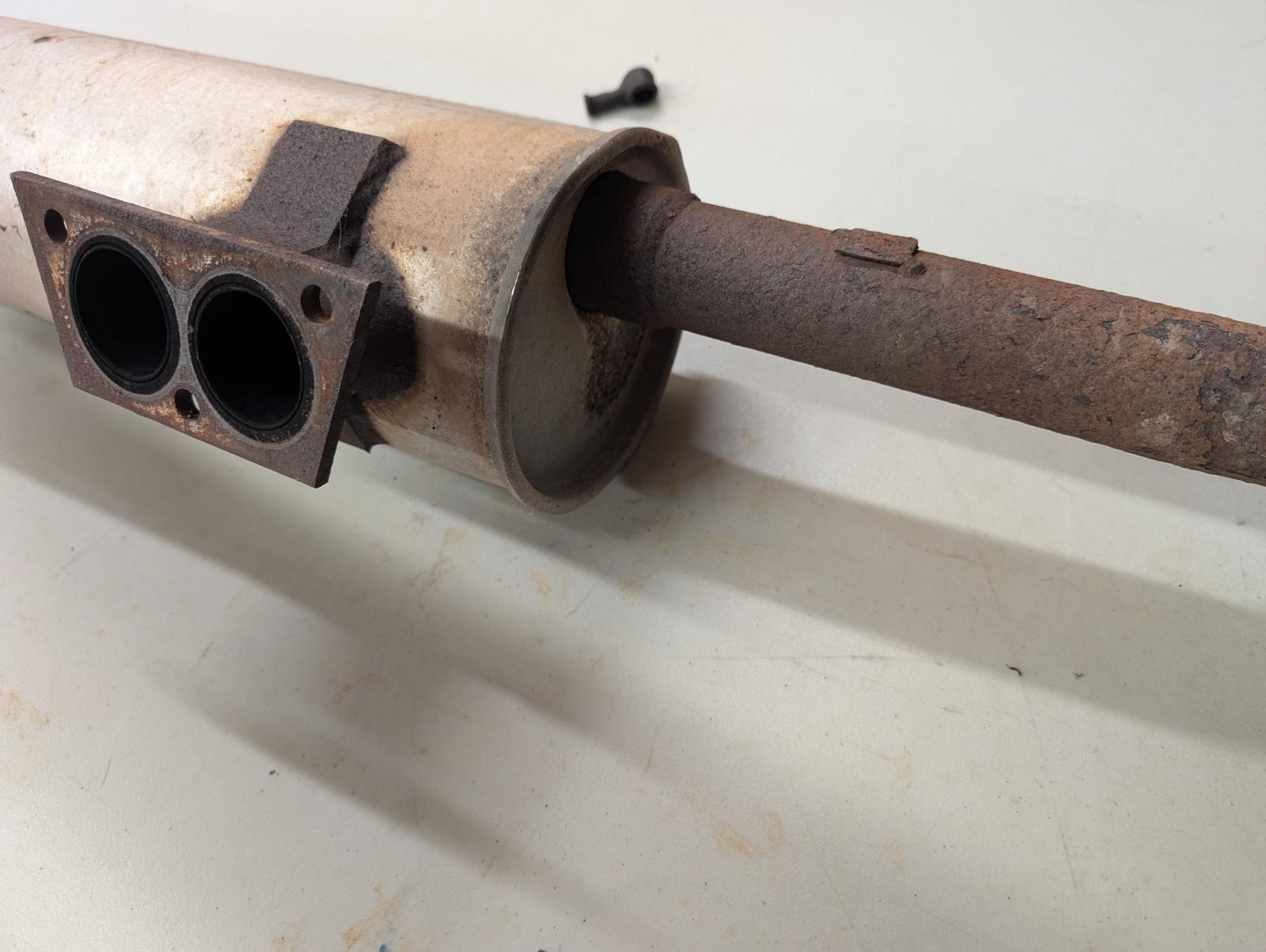

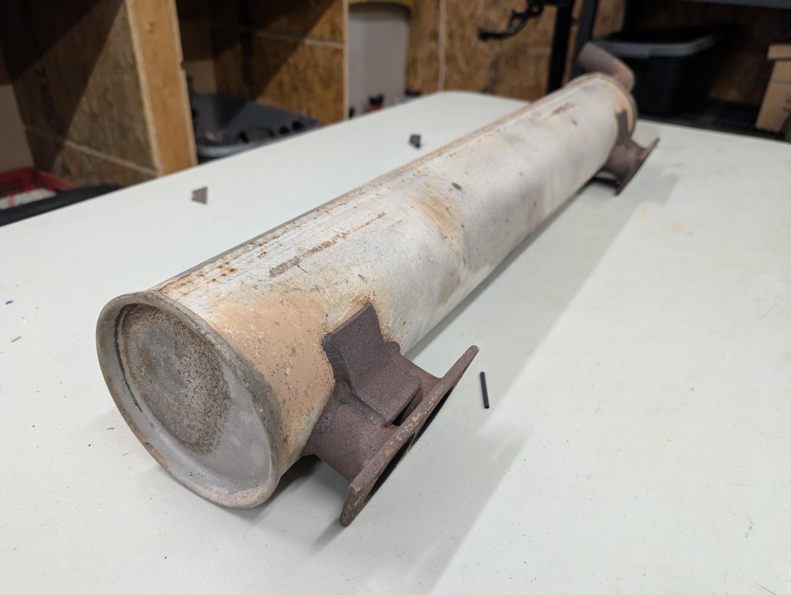

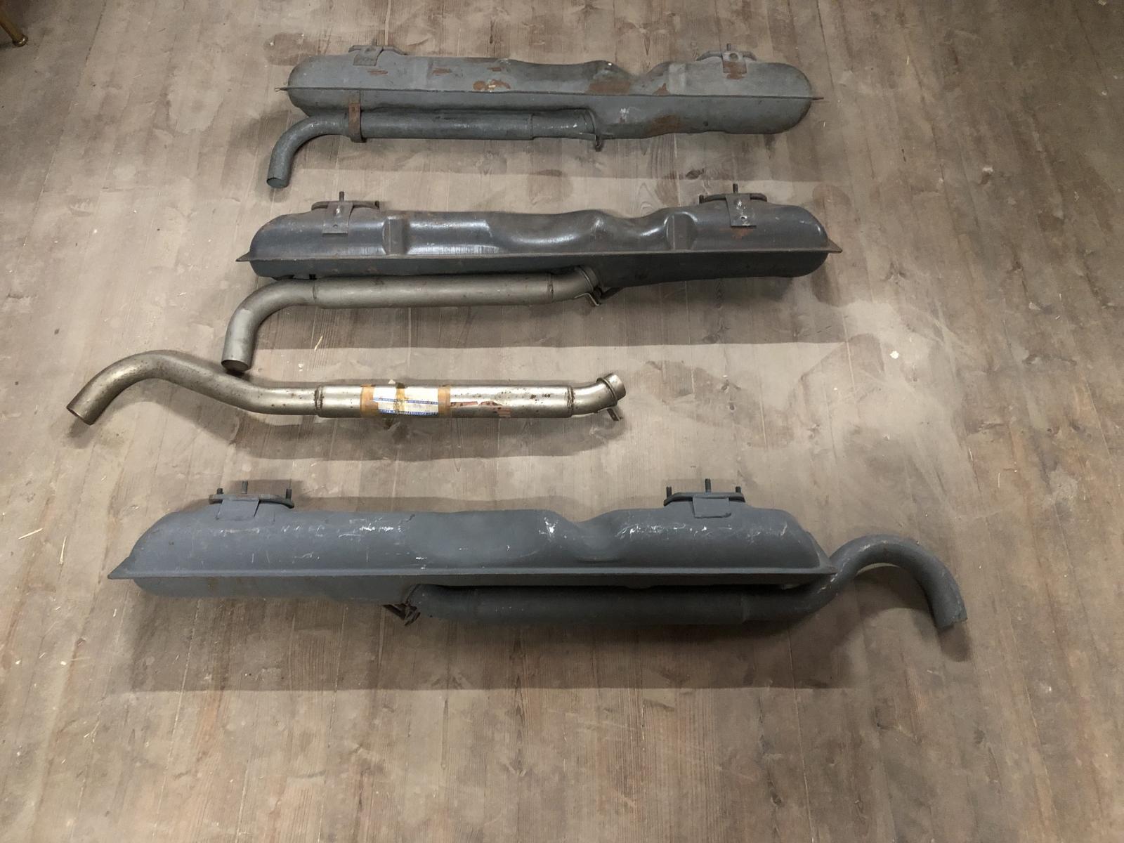

I am also finding thia thread to be helpful and informative at the moment. I am at the point of fitting my exhaust onto my engine that I just finished and got installed back into car yesterday.
I am running csp ss headers and was planning on using the one I have that I thought was a stock muffler while I decided/ afforded a new muffler.
I have been considering the vintage speed one mentioned in this thread.
But as I look at this muffler that I plan to clean up and use for now that this does not look like any of the other ones in this thread nor does it have any stampings. I am guessing at this point that it is somewhat custom made ..
The inlets just dump into the main cylinder and Id imagine it has a more simple design like vintage speed one but with just one exit pipe...
Not sure if this is a good option or not or if anyone has seen one like this?
It ran decent before with no overheating issues and was quiet.

kgarchivinusa wrote:
Lange muffler
Typ V92
VW Transporter 1,7 l
66 PS ab 8.71
VW 411-L 68 PS bis Mot.
Nr. V 0100000
VW 411 E-LE 80 PS bis Mot.
Nr. V 010000
VW 412 E-LE 80 PS
Porsche 914/4 80 PS
… KBA 20230
Made n W. Germany
Very nice equipment! If one is needing a stock muffler it is very hard to beat those.
In order of best equipment by brand for these mufflers:
1. Ernst:
2. Leistritz
2. Lange
I say they are tied for second and the build quality is no less than Ernst.
3. Wagner. Very good quality but varies from certain units down in the lower end (and usually priced that way) very similar to Dansk. But the top end more similar to Lange and Leistritz.
4. Dansk.
I seem to think there was one more brand but memory is failing today.
Lange as a company is VERY hard to find any information on at all. If you start searching, the first thing you come across is Lange and Sohnes...fine watches. You should look at that site just out of curiosity Laughing Shocked ....their shittiest watches start at $75,000 while teh all platinum case watches start at close to $500,000.....damn.
The closest thing I can find to "lange automotive products" is now a Chinese based company with manufacturing in about seven countries.
As I noted a while back in this thread I think I found information that at one time, most of these OEM muffler companies were bought and or owned by Jopex.
I had a Lange muffler on my first 411. I was in college and the exhaust on my 411 that I had since 2nd year in highschool would no longer pass safety inspection. Rusted out.
I found a certificate/coupon in the glove box from the original first owner (this was 1981 and the car was a 1972)....from the Meinike muffler chain shops.
Even a that time in 1981-82, a quality brand factory muffler was ~ $120 or more.
More than I had in my budget. It turns out that the previous owner of the car had damaged the original muffler at early mileage and went to Meinike to have it replaced and paid for a lifetime TRANSFERABLE warranty.
I dropped into a local Meinike shop and was hoping to just at least get something like a big discount with that certificate.
I parked my car on the lift for inspection and handed over the certificate and asked if it was still good (it was about five years old). I sat down to read a magazine and waited. About 25 minutes later they pulled my car out of the bay and it was quiet....and had a brand new Lange, right end exit muffler on it.
The bill was "$0"....I was stunned. The owner of the shop said it was a $155 muffler with installation. He said normally he would hate to have to fork over that expensive of a muffler for a warranty repair....but that the muffler had also been on the shelf in a box for about a decade and was technically "off the inventory" so it was no loss.
He said the guys in the shop were actually kind of excited to see what the hell kind of car that muffler actually went to. Yes, it would also fit buses and some Porsche 914 but the main part # description was VW 411/412....and in Oklahoma city....those were not common to see.
EDIT:....Ah yes! The other brand was "Starla"...which I think was the high end of Wagner.

My personal „top ten“.
After long time I found the rare 35 mm pipe for the OEM Volkswagen muffler (until mot. No. V 0049 186)
1. OEM Volkswagen
Driving the Leistritz 76 1 0595
2. Leistritz
3. Lange

All VW 411 muffler varieties in a row.
Up to down: Up until Mot. No V 049186 D=35 mm, middle from Mot. no V 049187 D=43 mm and Limousine. Below Variant.
