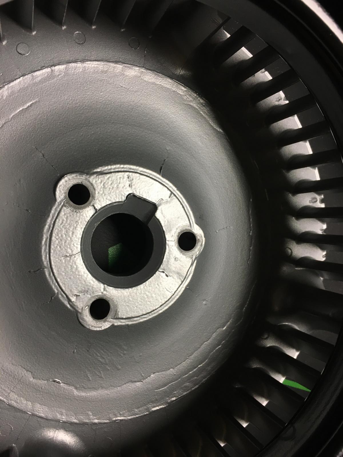

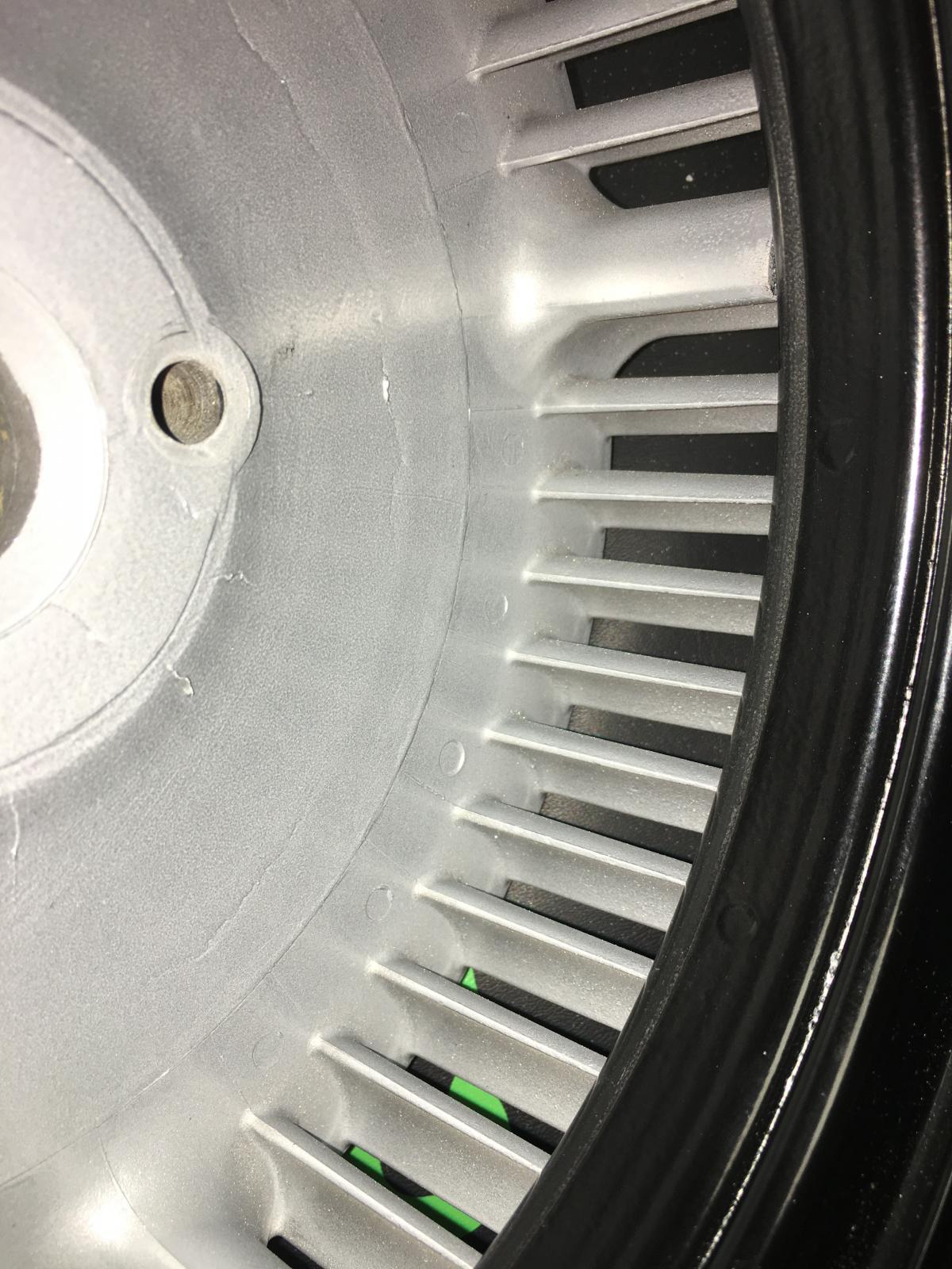

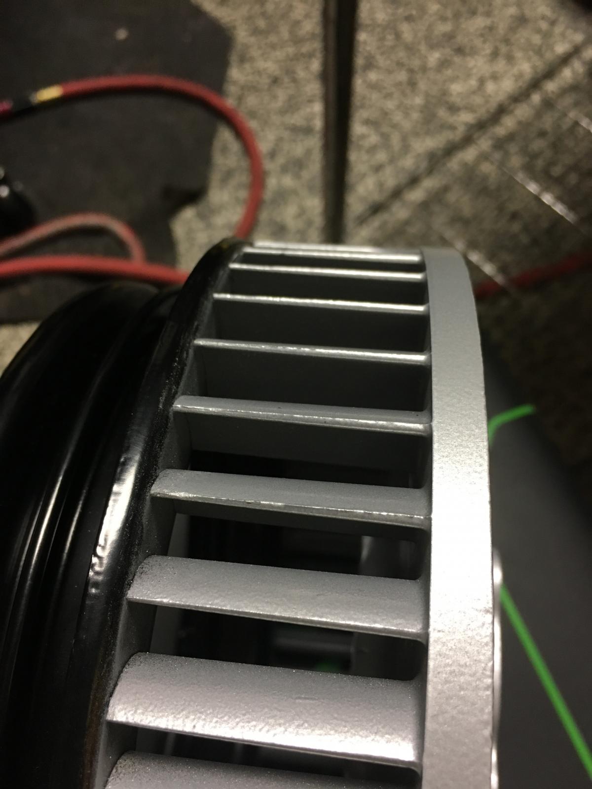

I powder coated my fan so I guess we’ll see how it goes. I didn’t dissemble the fan assembly but I did media blast it. I did silver for the fan and black for the pulley.
was that Mike at Powdercoat-it on Roseville Rd? My concerns on the fan are thickening the vanes, getting it out of balance, or not having a solid surface to bolt to, or if it delaminates over time then the pieces go into the engine.
A thin coat of aluminum paint won't thin out with time but I am afraid that the powder coat might thin out and allow the fan to work a little. Did you do anything special like have them do a thin coat on the vanes, or fan?
American Standard Snorkeling Terrier

PostPosted: Sat May 30, 2020 1:01 am    Post subject: Re: Fan Shroud(housing) - original finish?(gold) (Type 4) Reply with quote
SGKent wrote:
Lol all powder coating was done by me. You’d have to be really bad at powder coating to put it on uneven enough to affect the balance. I also probably took off as much weight in grime as I put on in powder coat.
In one of the pics you can see where the bolt/washer rubbed on the coating and as you can see it didn’t flake off.
Of course a professional powder coater could probably do a better job and be more precise but I’m happy how it turned out.
