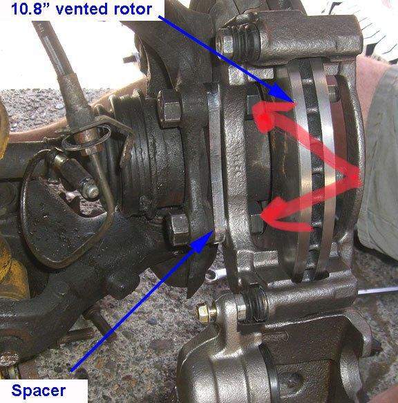

It would appear that one could just bolt G60 calipers to the outside face of early model spindles? The spindles were already threaded and the G60 calipers are not.
In the photo I’ve attached someone has put through bolts and then used either nylon s or whatnot on the inboard side. Why couldn’t one just use the threaded portion of the pre 86’ spindle and just bolt the carrier on. I understand you have to put the rotor and carrier on at the same time so using a wrench would be tedious but it’s a Westy.
Thanks folks.
