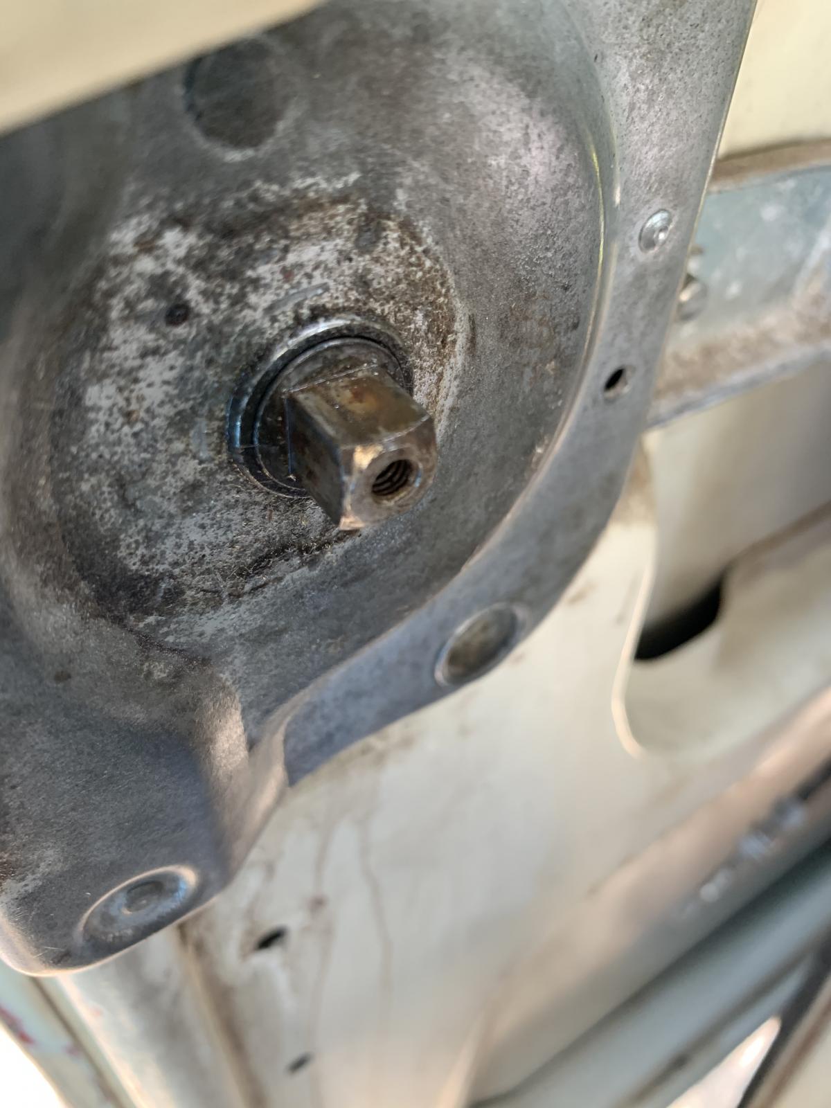

I am doing some service and replacing a missing collar on my 73 bus. I am having trouble removing the exterior door handle. The handle stud on my bus seems to have a fitting that prevents it from sliding out of the mechanism as seen here:
I can’t tell if this is a washer that is just fused on or if it’s a solid piece.
I did find a tiny grub screw on the exterior door handle collar and removed it as seen in the photo below:
I have consulted the Bentley and it does no my show a washer or collar as part of the door handle stud.
I would be grateful for any help here as I’m now stuck.

Bad news, once long ago that square shaft slid through the round part (which is part of the latch). PB blaster and heat might loosen things up eventually, your other option is to beat the living sh*t out of it with a brass hammer and hope it moves before you mushroom the end of the shaft too much. Putting a screw into the end of the shaft tight helps with the mushrooming somewhat, don't expect it to look like a screw afterwards though.
Oh yeah, I forgot about the fun part...., all that bashing cocks the outer handle on the shaft and makes it loose sometimes, having a helper pull out on the outer end of the handle during the swear fest might help that a little.

Thanks for the quick reply Bus Daddy. And I found out what that tiny grub screw is for - it releases the tumbles for the key lock. I removed it so if I pound on it, I won’t damage the tiny springs and levers.

try to push it all the way back in and use a mill file on any burrs that are hanging it up. I recall that a couple passes on each flat helped mine come free.

It's not good news when the first thing someone says in a post is Bad News. And it was bad news. I gently worked, then gentle turned into of a more determined attempt, which turned into a more and more of an all out banging. It did not budge. I used heat, small files, PB blaster, etc. And then I really got into trouble when the small pin that holds the rear facing level (that connects to the rod that connects to the rear latch) fell out of the assembly.
Knowing that the assembly box has a closed back, and knowing that I cannot access the back of the unit unless it's been removed, I abandoned ship as did not want to damage the door itself. I got on line and found a used part from BustedBus and it will soon be installed on my bus.
As I've learned over the years, what seems to be a simple task can often be thwarted by rust and corrosion. All I wanted to do was to install the missing exterior collar that I recently purchased. What I thought would take a couple of hours turned into what BusDaddy referred in his post as "A Swear Festival."

Bummer, sounds like it's in there for life. The nuclear option is to saw off the handle on the outside, then you can go at it on the bench with better backup methods while hammering, at least you still have a chance of saving the latch unit that way.

Yes, it's a bummer. But truth be told, the mechanism was always stiff and there was a funny hitch-in-the-get-along so I'm OK with replacing it with an OG part.
My plan is to drill out the rivet heads, remove the outer plate and hopefully get better access to the problem. IF I can get to the handle shaft through the front, then I can at least cut and remove the fused barrel fitting.

Not that this thread is a big hit but removing the barrel from the door handle shaft is proving to be difficult. Most of the barrel’s metal is fairly soft and is easy to cut. But there is also layer of harder metal that is not letting go of its grip.
I wonder what the devil happened to make this so difficult to remove the door handle shaft?

this image is from classifieds which isn't the best place to get an image. It shows what an early handle looks like. Did you try smacking the handle on the end with a lead hammer? Get a lead hammer if you do not have one.*

obviously don't use a steel hammer because it will flare the end and make it worse. Brass can do that too. That said to me it looks like the lock and the handle are toast. You don't want to damage the door any but maybe at this point I might consider something like this after filing the square sides to make sure they aren't flared. Then replace the lock and handle after having it re-keyed.

Thanks Steve. I bought a used latch that is in excellent shape. I’m hoping to salvage the handle and install it on my newly acquired latch. I removed the key tumbler before starting this extraction process so if needed, can swap it to a different handle.

As I dug down, I discovered that rust was the culprit that kept the latch handle trapped by the barrel. Now to get the cable and rod adjusted so the I can close the back half of the door.

Next time you soak it in penetrating oil and smack it with the lead hammer. Then more penetrating oil. The smack may loosen it up enough that the penetrating oil can get in where it was rusty, and loosen it up. Glad it worked out.
