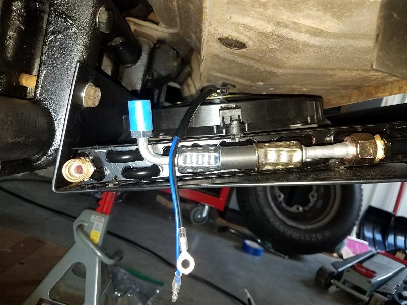

It's snowing, Lets work on the AC some more.
I mounted this larger fan. There isn't much clearance to the bottom of the car but it still seems to move a lot of air, and the mounting tabs reach the screw holes on the edge of the condenser (fate?). I'm feeling pretty good about it.

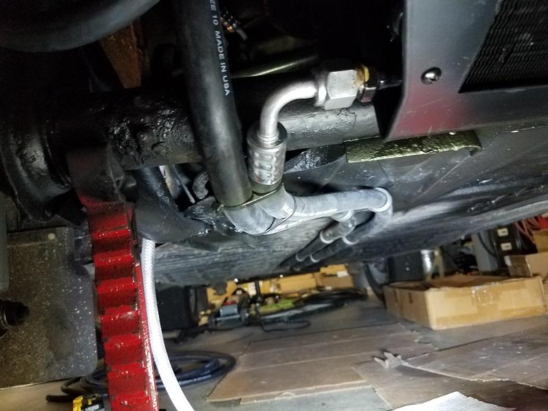

Hoses!
I'm not too sure about having this "in the line of fire" in the wheel well, but here it is. This is where Gilmore says to put it, and I'll be darned if I can figure out anywhere else. I even bought a horizontal dryer to try and couldn't fit it anywhere either. It's all about how to mount it and still get the stiff bulky hoses in without impossible bends etc.
I installed this low pressure safety switch here. This was also surprisingly difficult to find a place for, no straight sections in the high pressure hose anywhere. The Gilmore kit didn't come with this but who am I to follow directions Razz.
I found an unused switched terminal on my Ron Francis fuse block labeled air/heat with a 20 amp fuse already in it (second terminal from the left, red wire). Well that part was easy.
I'm getting close, I wonder if it will work?

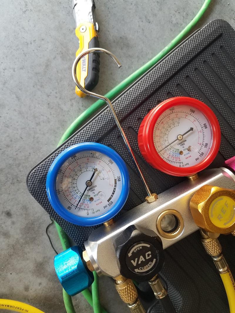

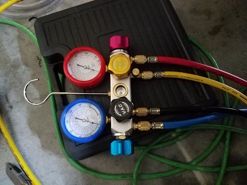

Ok, here we go! I'm ready 'cause I watched a youtube.
Purging the system.
It's holding a vacuum! I never doubted it (lies, I gave it 50/50 it would leak all over the place).

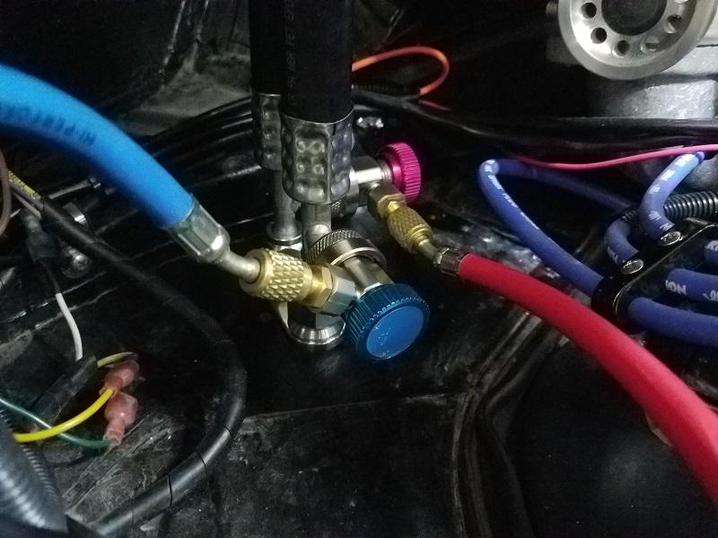

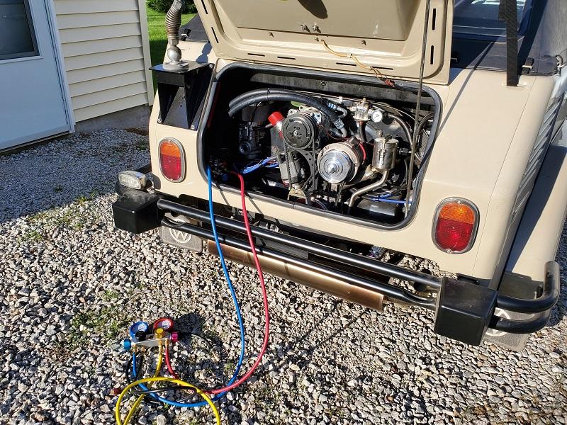

Here comes the stuff.
Almost there! I stopped at 22oz of refrigerant at 170psi, within Gilmore Enterprises recommendations.
Yippee! I can't believe it actually works. The only issue I had was the condenser fan and the compressor clutch were on the same relay, so when cycling the fan would coast down and act as a generator. This would cause the compressor clutch to disengage gradually, slipping as it went. I rewired with a separate relay and it now clicks in and out like it should.
At idle it drags the engine down about 150 rpm, so some adjustment is in order. Maybe even a tune up or something resembling regular maintenance? Shocked

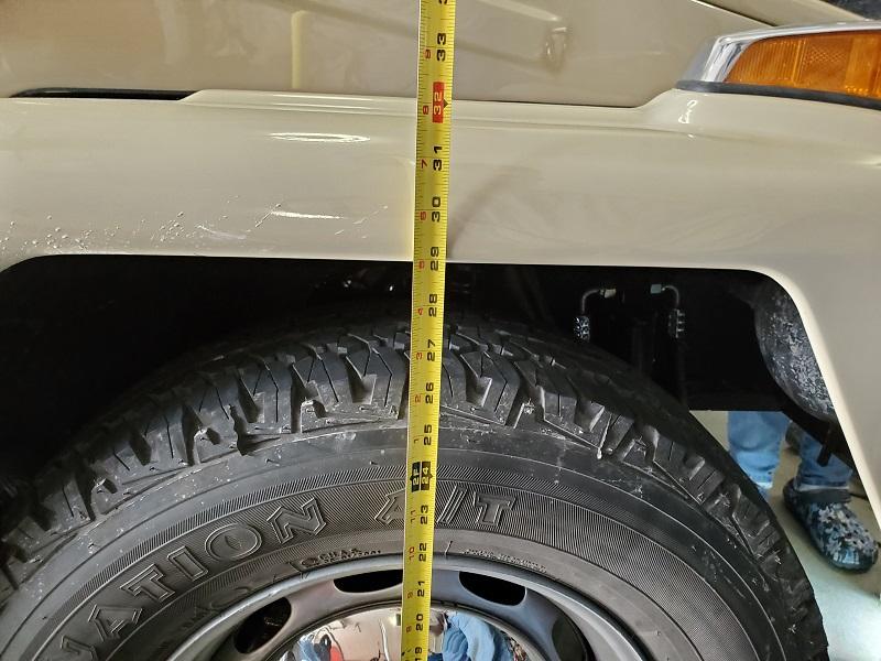

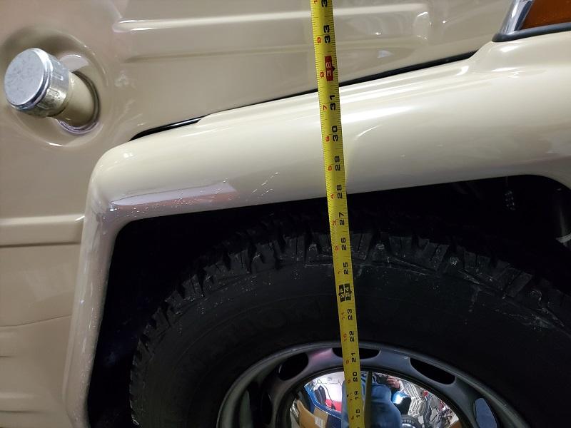

Sometimes while navigating down/side sloping terrain during a turn one of my front tires will rub the fender. The right side tire tends to do this more than the left.
I've been wondering what would happen if I put air shocks on the front, just to give it a little boost, or if it's even possible to do. I already have them on the rear. I was inspired by a discovery with the airlift bags on my camper. It has very stout suspension, I added the bags just for leveling. I have read many accounts of people using the coil over shocks, resulting in poor ride qualities. You might assume that adding this type of lift would also cause the ride to be harsher but not so fast. Raising the camper a couple inches at the bumper resulted in a noticeably smoother ride. My hypothesis is the air bags are more forgiving than the truck suspension, and the bags are simply partially lifting it off it's own suspension.
Anyway, back to the thing. I decided to give it a go for the entertainment of it. I poked around the Monroe site and learned some specs but not really all I needed to know, so I fell back on a time honored method. I guessed Confused . After a few internet clicks and a couple days I'm the proud owner of a set of Monroe MA810 air shocks. The layout and length are right, but there are no bushings in the bottom eyelet end.

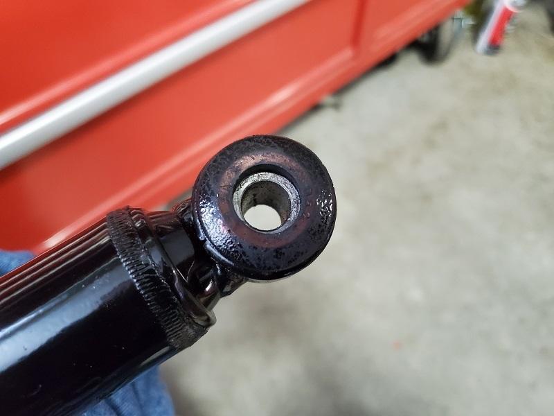

I cut the bushings out of some old shocks and cleaned them up.
The length was too short, so I added a piece cut off another bushing.
I was concerned the diameter of the shock was going to be too big and rub the torsion arm, but it turned out ok. They barely touch at full droop, then gain more clearance as the suspension compresses.
Raised it a little bit.
It turns out just like the camper the ride feels a lot more compliant, it's actually really nice. Who knew! It might get to stay this way a while.

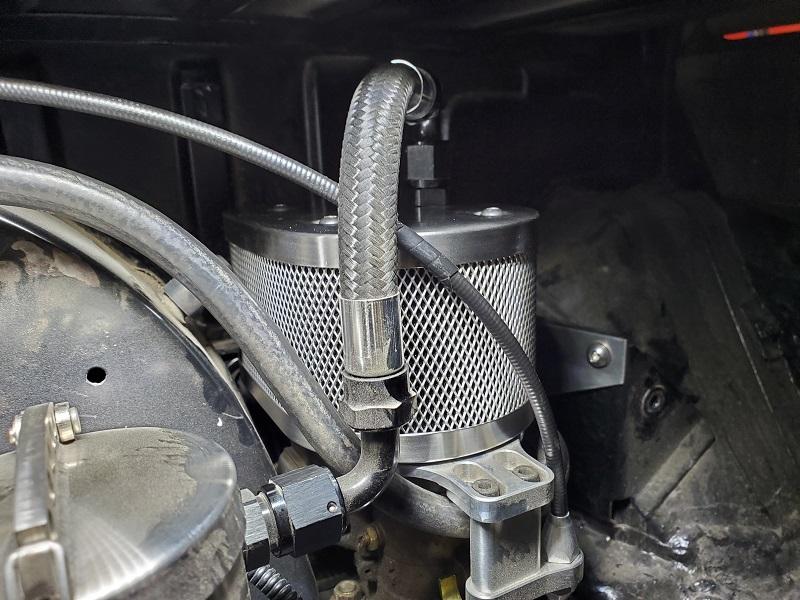

I decided to spend some time today installing velocity stacks from aircooled.net. I have no idea if they will do anything, just consider it screwing around. Will it run better? Worse? Will it sound different? I secretly suspect nothing will happen but that's not very scientific. I enjoyed putting them in, so there's that. Razz
Those tall standoff nuts for the air filter with the beaver chewings in them come that way for this purpose, so I had to do it.
It was storming rain plus tornado warning when I did this and owing to the fact I'm a sissy I put off the test drive for a bit.

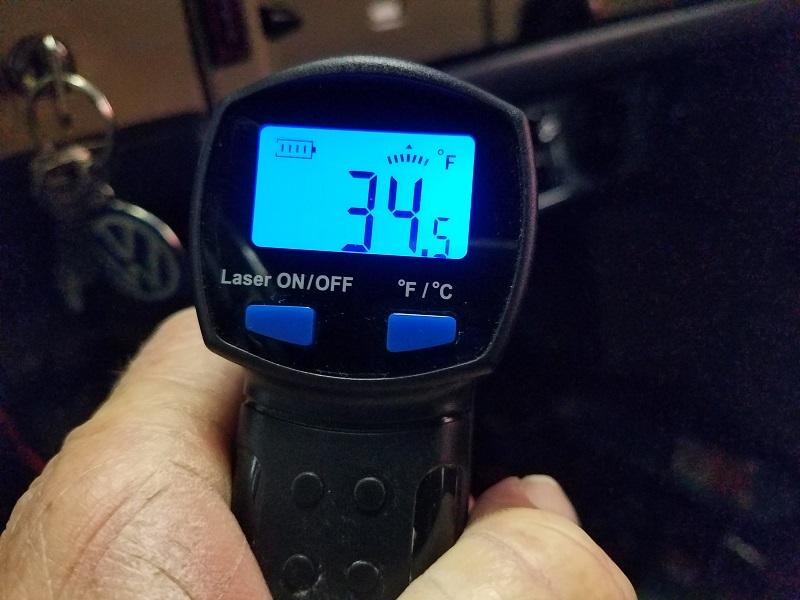

I've had a bit of air conditioner drama lately. When I installed it the weather was still fairly cool. Now that we're getting some hotter temps outside I've been driving around testing it, and I've lost the high side hose from the compressor at the back to the condenser at the front. Twice. After some research, observation and meditation I have come to believe it's building too much heat (= pressure) in the possibly too long high side hose. To address this today I added a second condenser, In perhaps a desperate state of mind I put it in here.
This surely is the least desirable place to put a radiator, except for maybe duct taping it to the muffler or something. Yeah I'd like to see that too, just on somebody else's car. I wanted to keep it close to the compressor and out of sight. I think I'm on the right track, I went for a long drive and then threw the gauge on it, the pressure is staying in range not climbing like before. Also the coolant stayed inside the hoses, isn't that convenient! We'll see when it gets really hot out but I'm optimistic.

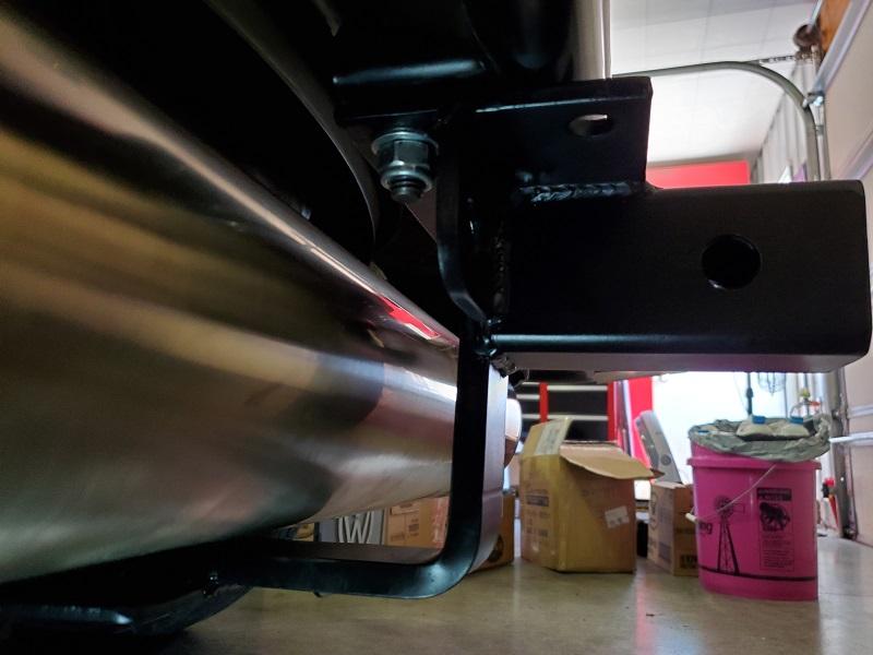

PostPosted: Sun Jun 07, 2020 8:01 pm    Post subject: Re: My 181 project pics Reply with quote
Today I cut my thing shop trailer hitch apart and welded it back together in a fashion that clears the vintage speed muffler and the scat oil sump.
I'm not real proud of that welding. Some days I do alright, this wasn't one of them. Good thing it's under the car.
