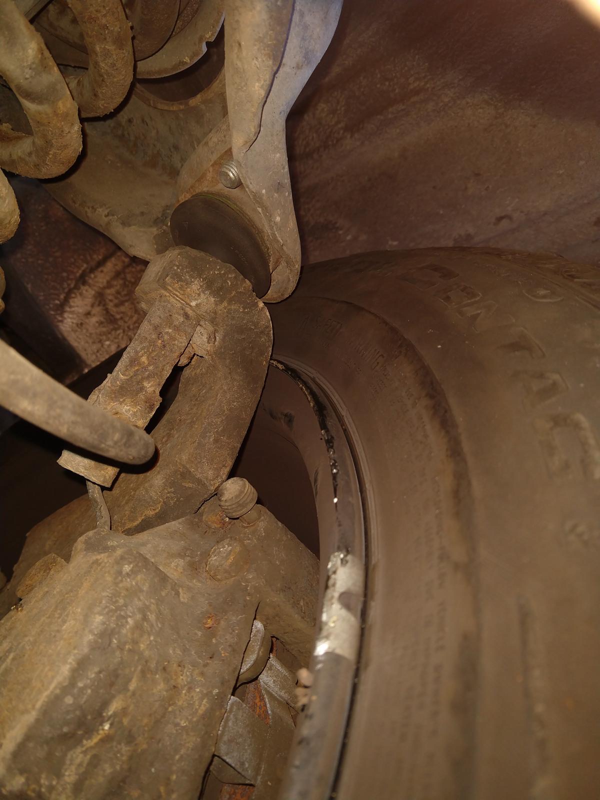

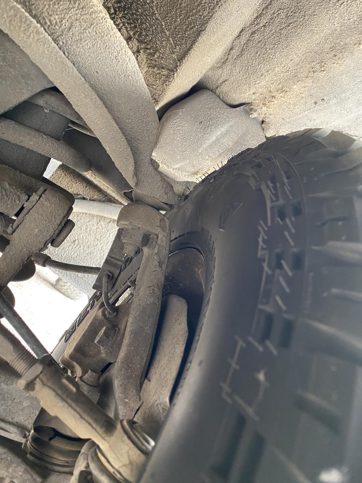

Hello all - I just picked up 4 two year old 15" gowesty steel wheels and tires that are stamped with ET25 on the outside. As near as I can tell, they are exactly like this -
https://www.gowesty.com/product/wheels/25242/15-inch-steel-wheel-set?v=
Which says they should be able to mount to my rig without any modifications. My van is an 85 with a build date stamp on the passenger door frame of 10/84. As far as I know, I don't have a big brake kit or any other front suspension modifications. The Bentley does have a separate section for the front suspension for rigs before 10/84 and after 11/84, but I haven't looked at it enough to determine what the differences were.
When I put one of wheels on the front passenger side, it is right against the upper control arm. Has anyone else experienced this? I emailed Chris at T3 as well, but at this point, I can only assume that I'm going to need spacers - at the very least on the front??
Thoughts?

Here are some pics -

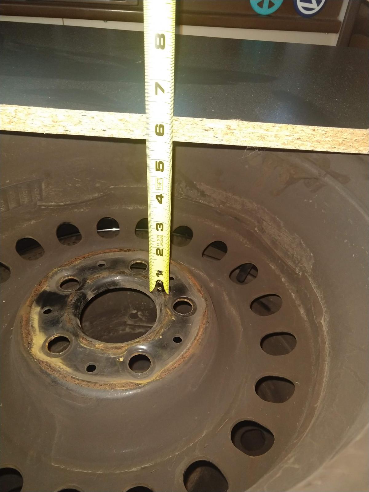

Can you measure the backspacing? ET25 on a 7" wide wheel should have a 5" backspace measurement (4.98" to be exact).
Take a look at the pic below. That is a stock steel 14 x 5.5 wheel. It has an ET39, which measures 4.79" of backspacing. That means your wheel should only be 0.19" deeper on the backspace.
This gap in the pic between looks way more than 0.19".
Are you sure the stamp says ET25, or is it ET35?

Thanks for the reply. I'm not completely positive I measured correctly for backspacing.
I took the 15" off and put the 14" back on there and it looks like your pic, there was not a lot of space, but there was some and it definitely was not against the arm like the 15" were.

Lay a straight edge on the wheel lip only. This can be difficult with a tire on. Then measure from the center surface of the wheel that contacts the hub to your straight edge.
https://www.more-japan.com/blogs/2011/08/23/how-to-find-out-the-offset/
jayinduluth
Joined: August 16, 2012
Posts: 123
Location: Southern California via Duluth, MN
jayinduluth is offline
PostPosted: Thu Aug 27, 2020 10:37 am    Post subject: Re: 15'' tire options Reply with quote
Thanks for the info.
So it appears to be a bit more than 4.79"... even with the tire on..

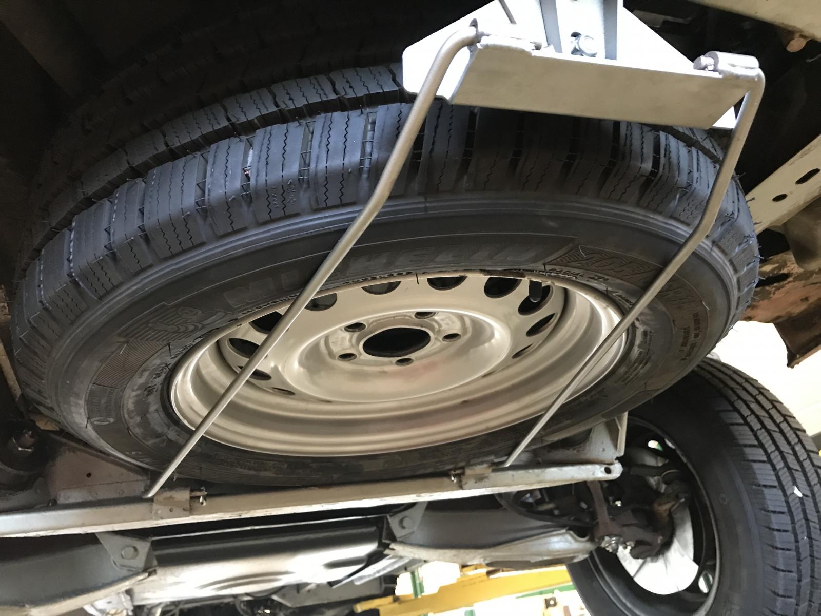

Late to this thread ,but I have 205/65/15" tires on 15" Mefro steel rims, I think they're 7" , could be just 6.5".
I needed to change my stock clam shell over to a more open design like the one below to get my fully filled tire to fit. No rubbing on anything.
The guy who made and sold this carrier seems to be gone now, but Van Cafe and others have versions similar. Or, you drop the hinging section from mods that you already know about .

Chris at T3 emailed me back after seeing the pics and said it was a new one on him, that based on the pic, he suspects the wheels are ET33 and not 25 and something is not accurate during the assembly of these. He also suggests 7mm spacers.

That straight edge needs to rest on the rim egde to get a good reading (not tire). I cant tell in the pic
Sorry about that, it is on the tire and not on the rim. I measured the distance from the rim to bottom of the straight edge and its 5/16" and my other pic was 5 and 9/16", so that still puts it around 5.25"..

PostPosted: Fri Aug 28, 2020 11:43 am    Post subject: Re: 15'' tire options Reply with quote
Gowesty emailed me the following -
Not sure what wheels those are, but I do not believe they are anything that we offered. We have only been offering a 15” steel wheel since October of 2019 and before that the last time we had a 15” steel wheel was 10 years ago. If the front end alignment is set correctly, you can add a 5mm spacer to move the wheel outward to prevent the rubbing. Thanks!
So my really good deal on wheels and tires are getting $200 more expensive due to me getting spacers from Chris and T3.

A straight piece of wood cut to length set on rim lip might work for taking a measurement.
If you jack van up at that wheel, any play in bearings etc. ? Does wheel then clear the knuckle?
Does van track, drive straight? Is camber (alignment) correct?
Those look like South African rims. I have a set the has similar stamping. Oddly, 2 of mine are ET30, and 2 are ET25. I got them from Van Cafe about 3 years apart.
