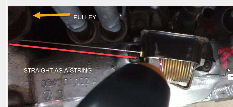

In the past I have done the boiling water in the kitchen test.... But today I realized that I had not tested my fully installed T-Stat. So I got out the heat gun and the laser thermometer and gave it a try.
FLAPS and STAT ARE COLD.
ADDED SOME HEAT.
FLAPS MOVE.

Looks pretty good, but why is the cable curved when it's in the hot position?, the lever doesn't look like it's in the full hot position (straight up), is the failsafe spring installed correctly?, looks like it's only letting the flaps open 3/4 way.
As for the hot water test (or heat gun), never ever test a thermostat out of it's bracket, it has to be corralled in the bracket to prevent stretching it past it's useful range of operation. What you've done there is fine, but I have seen others blow the thing up to 4+" long, they never recover from that.

I'm referring to the lower section, it doesn't appear to be under much tension, yet the flaps aren't fully open, the moustrap spring on the crossbar should be pulling on it hard enough to almost straighten it out.

Pretty straight....

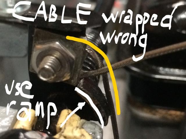

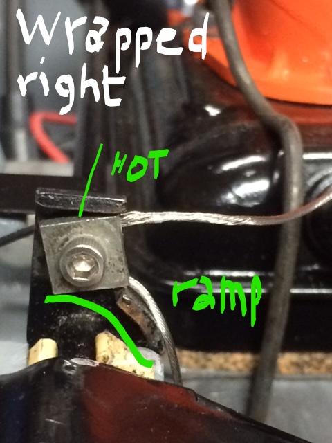

SUCCESS. I think I HAD the cable wrapped incorrectly. Same goes for the TIV in my 914. There is a curved "ramp" on the flap rod at the pinch point for the cable. If you wrap the cable UNDER the pinch bolt, the cable rides on the ramp.
You can see the use of the RAMP in this picture. I am calling this correct. Why else would they put the ramp there? I think it keeps from having a sharp bend in the cable and gives it longer life. As if 45 years was not long enough.
HERE IS A SHOT OF THE SPRING. Looks right to me. IIRC when installing the spring, there is only one way to go. Either it is too loose, just right, or you can't quite make it go any tighter. Brilliant.

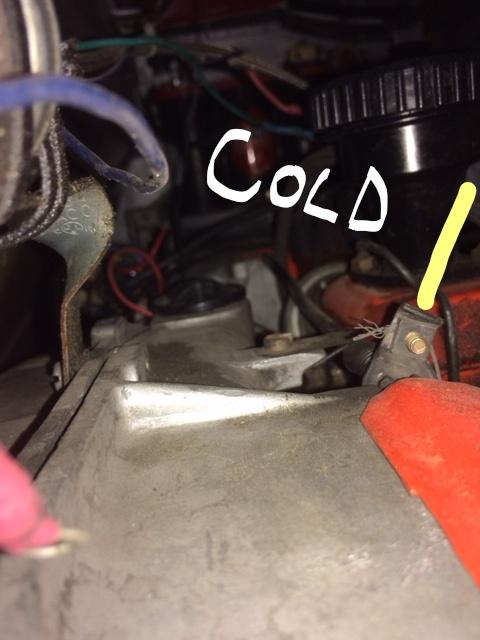

This is my 914. Started her up to get her warm.... I have the cable wrapped wrong here too. But the tab is pointed straight up when hot.
HOT.... Flaps open fully

Much better! Smile
