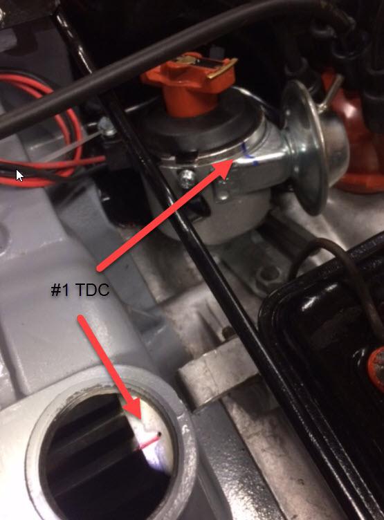

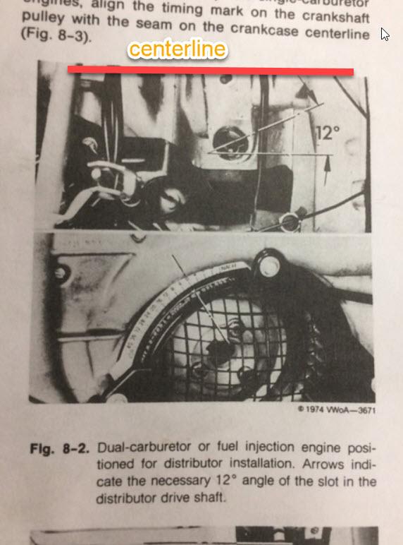

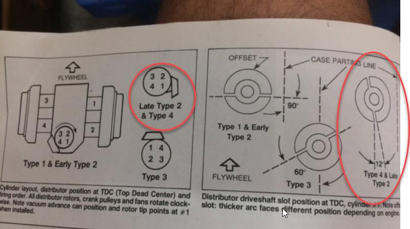

I believe you are correct on the direction..... this picture in the Bentley screwed me up. It is actually 2 pictures. The bottom one has the parting line of the case running north and south. THe top one has the parting line running east and west. But that is not completely obvious. THen they tell you to insert the disty drive shaft with a 12* angle to the parting line. So I assumed both parting lines ran N-S.
So I pulled the disty and the shaft looked just like the picture..... Then I got Tom Wilson's book out and found the error of my ways. Much better description....
shot down the hole....
Now my button and vacuum can better match Tom's sketch.
