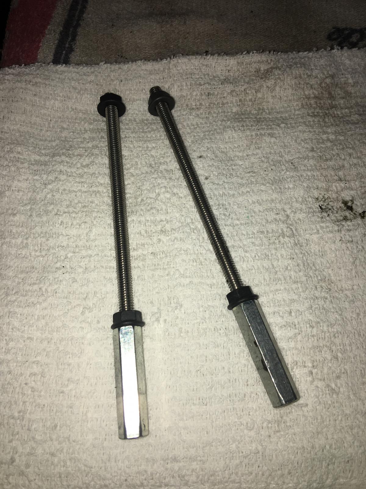

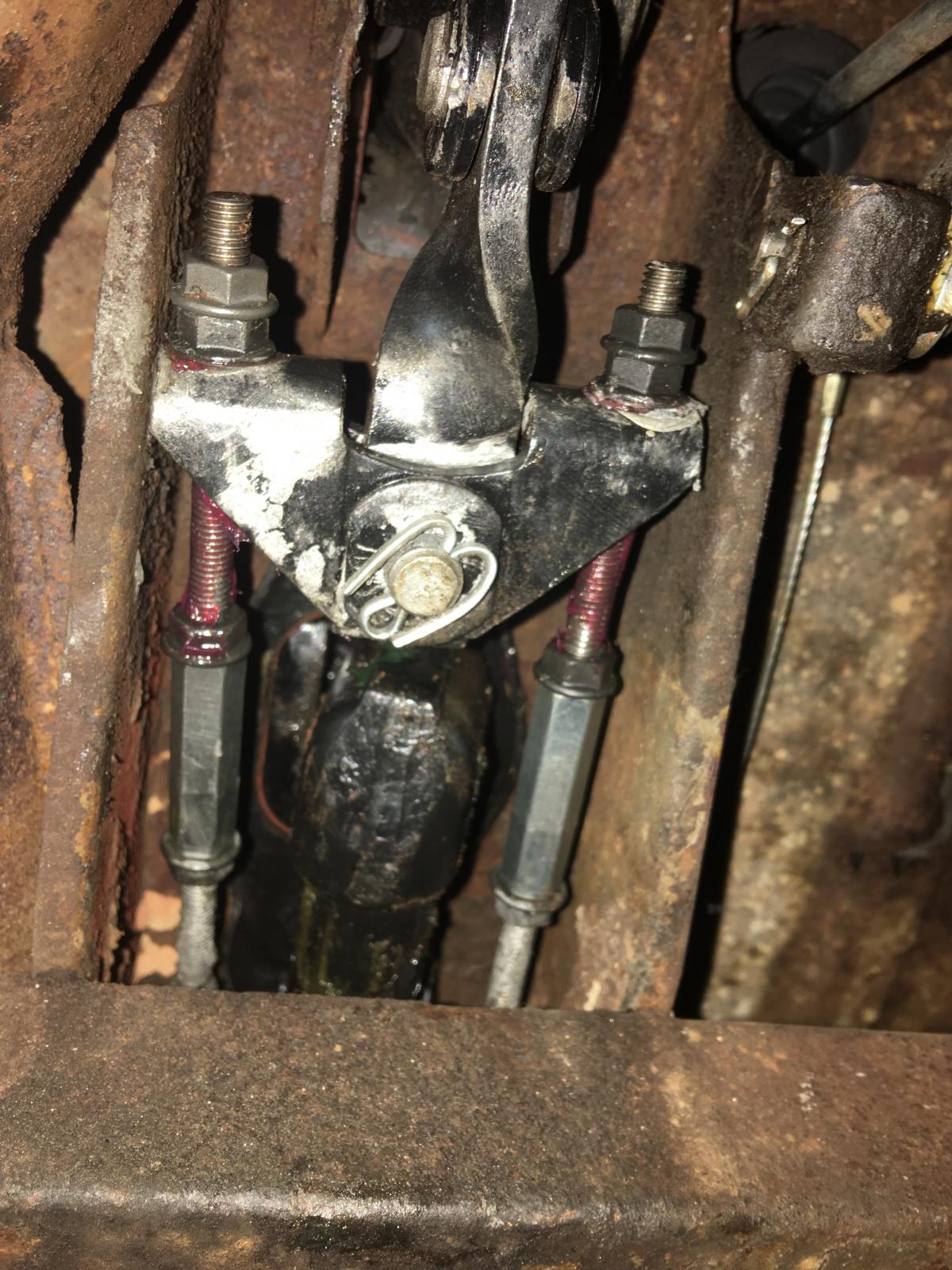

I swapped the early split emergency brake springs for shortened bay window springs and that worked on the rear, but the cables are too short now so I made extensions from 6mm all thread and threaded sleeves and it worked out excellent.
