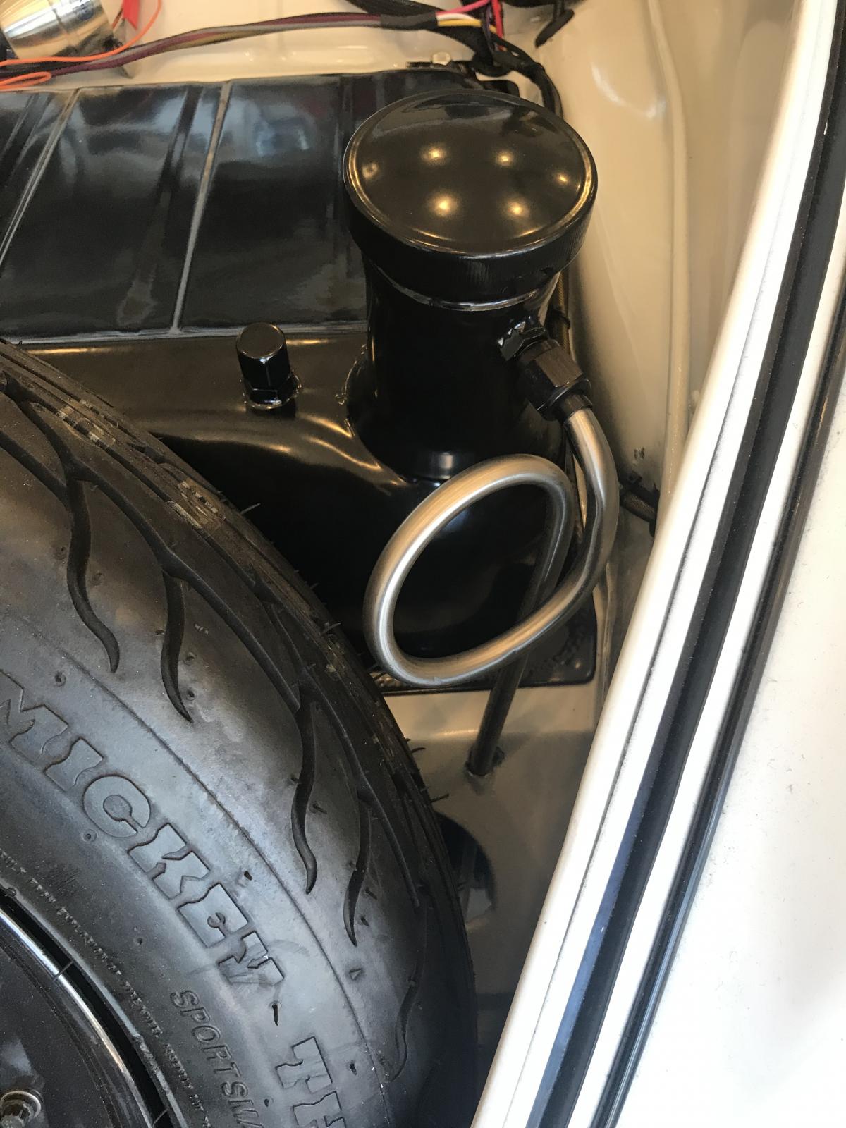

My 61 tank had the vent on the filler neck. We made it a -6 when the tank was new. I did a stainless pig tail and vented it down to the ground

If any fuel sloshes into that vent it will get trapped at the bottom of the pigtail. It will not take much to block off the air from passing, just like a plumbing p-trap.
