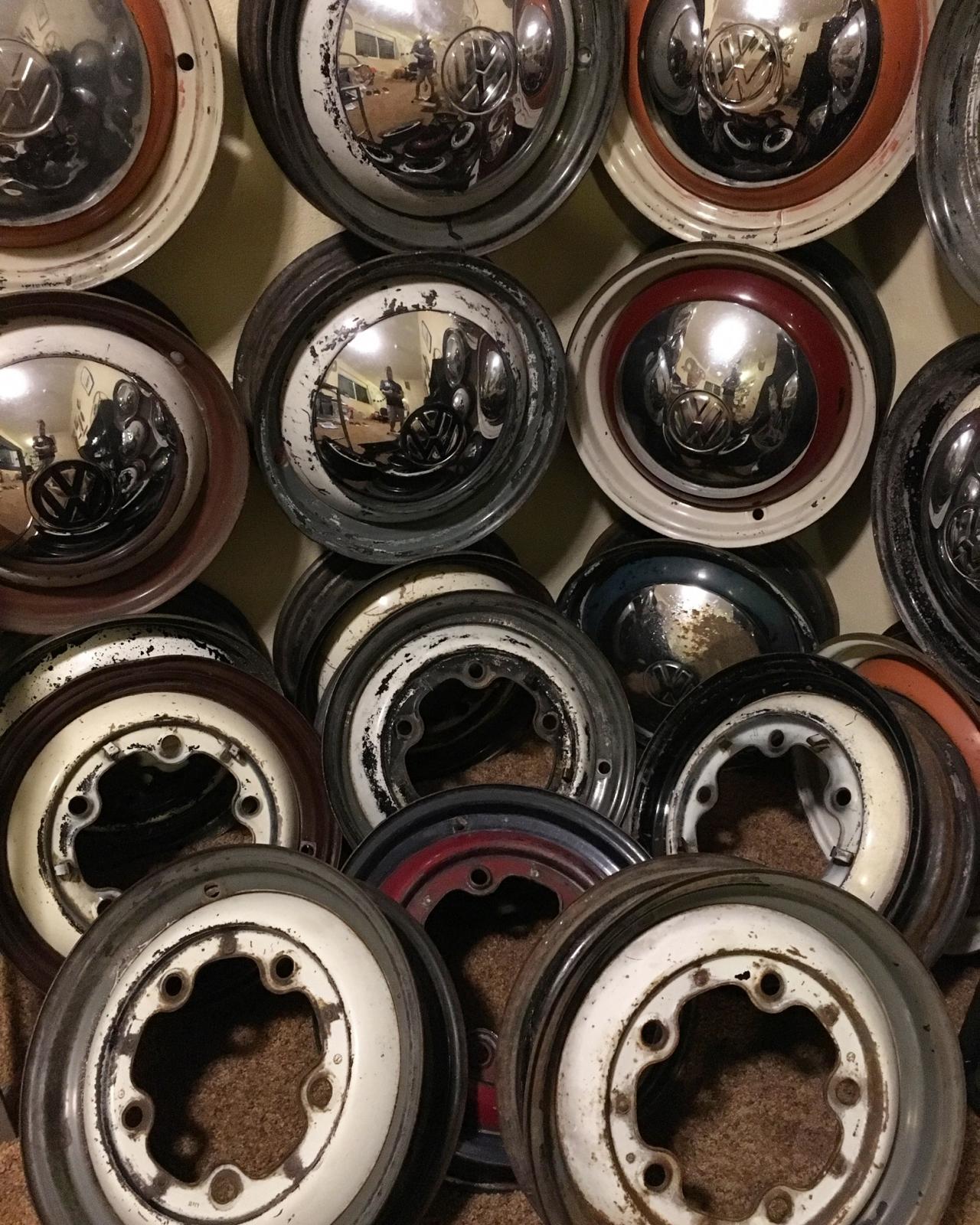

Every wheel in my collection is 80% gloss.
Don’t think the factory would of mixed gloss percentages, but they always surprise us.

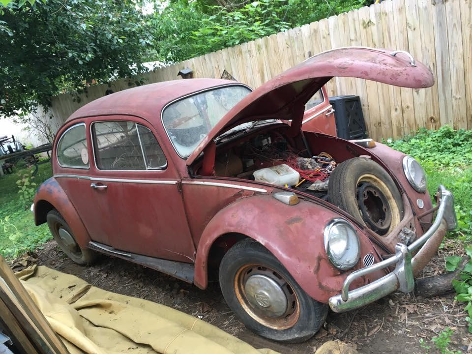

Not sure if this will help you, but here's my 66 when I first got it with original factory paint on the wheels.
