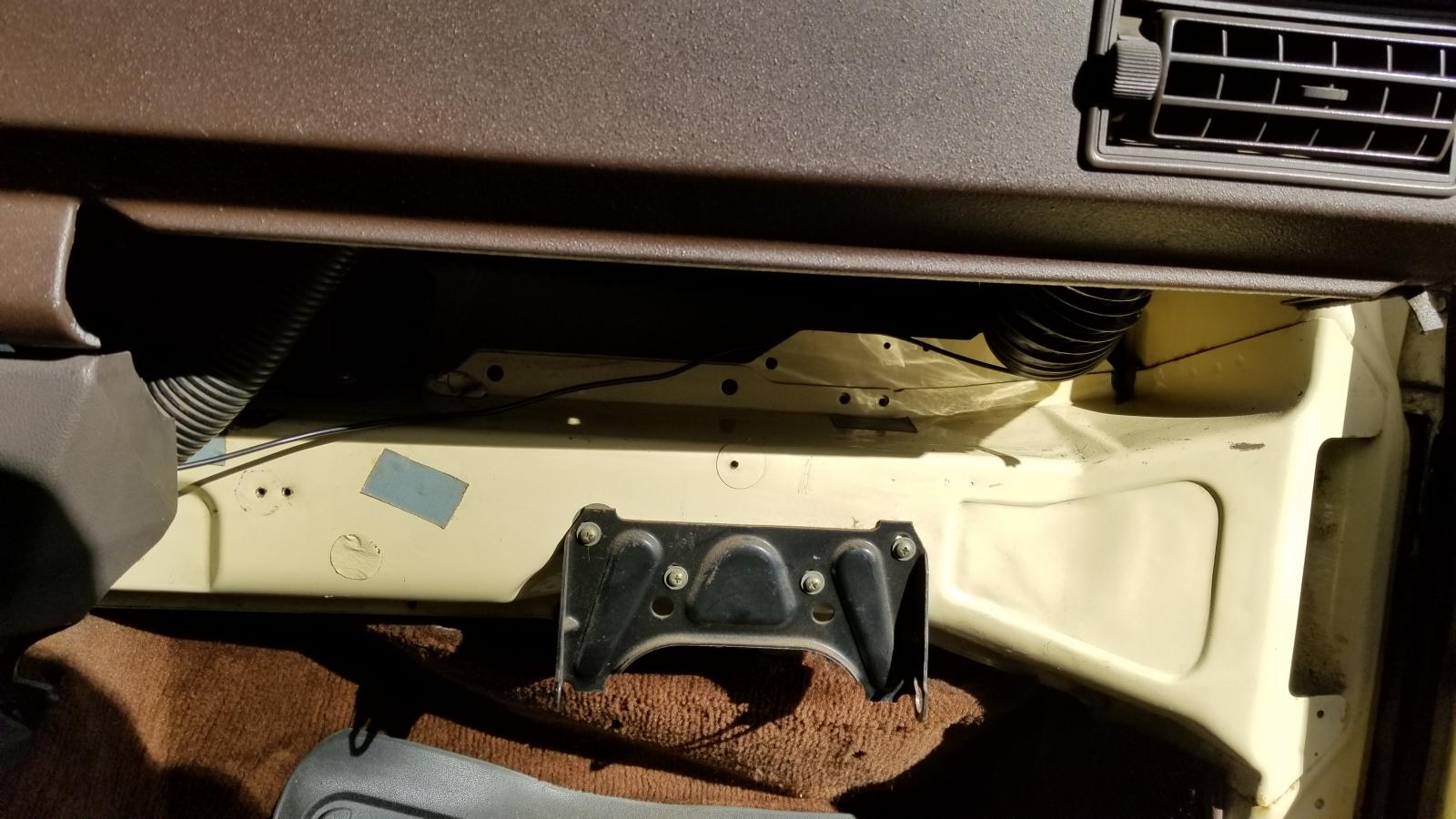

How is the glove box strike plate supposed to attach?
I removed a dealer installed AC and the strike plate was part of the evap assembly.
I've bought a new plastic glove box strike plate but the dash no longer seems to have a place to attach it.
There is no material where it would go to screw into.
I think I'm missing a part, but don't know what.
Looking straight on at where the glove box sits
Looking up from the floor to where the strike plate would attach if there was a bracket or something sticking out from behind the dash

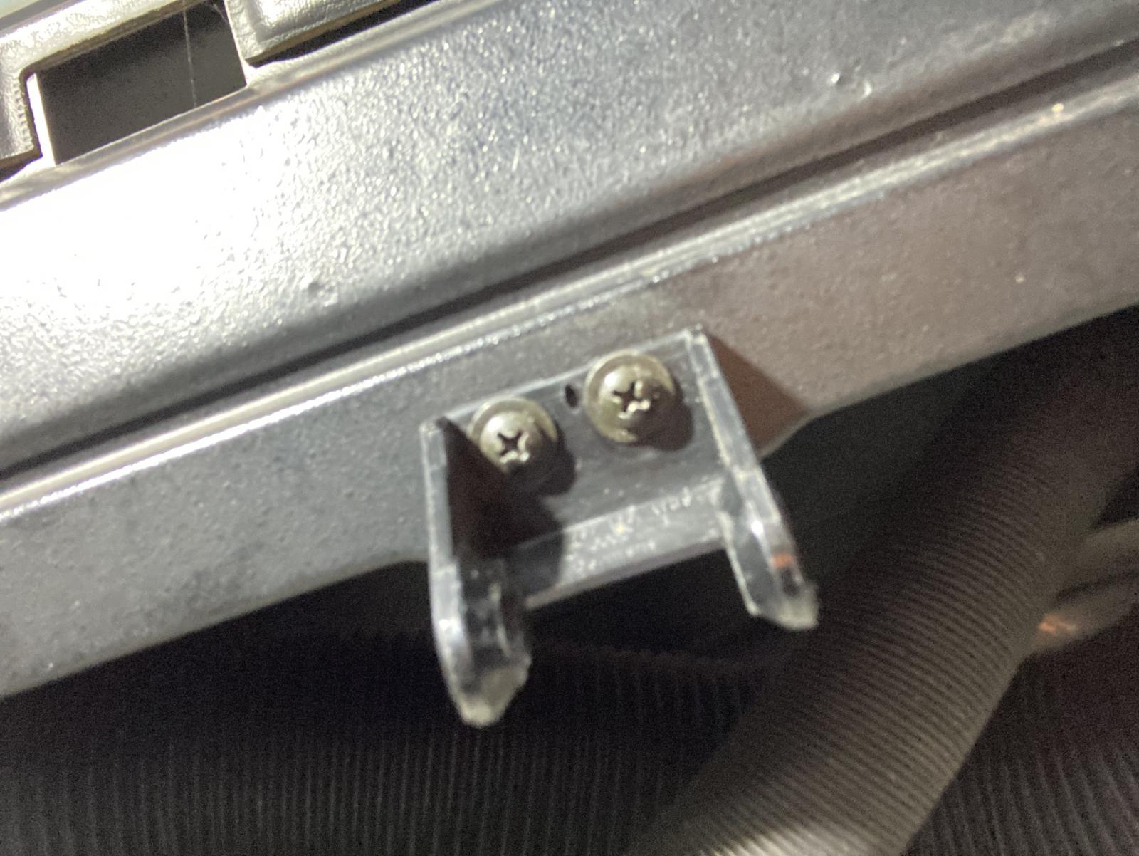

Hmmm.... Found a picture of the piece I'm missing.
The "lip" under the dash above the glove box.
No idea how to find/fabricate that.

jimf909
Joined: April 03, 2014
Posts: 8154
Location: WA/ID
jimf909 is offline
PostPosted: Tue Jan 05, 2021 3:45 pm    Post subject: Re: Official lazy person's stupid question thread Reply with quote
Here are some photos from my 1990 so there may be differences with compared to your 1980.
- Jim

PostPosted: Tue Jan 05, 2021 4:18 pm    Post subject: Re: Official lazy person's stupid question thread Reply with quote
Those are the perfect pictures of the piece I'm missing (that "lip" it's attached to)
Thank you
