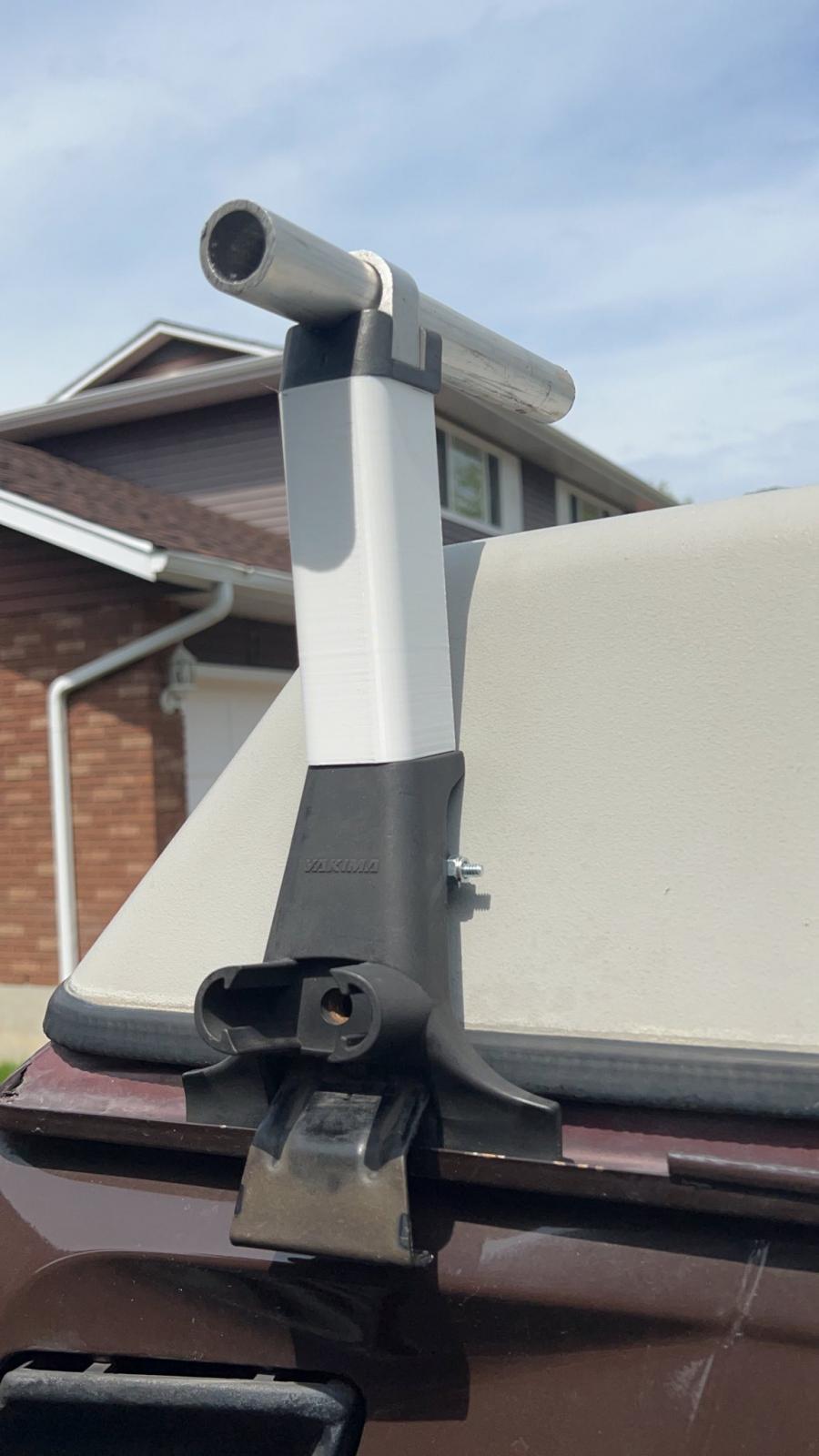

I finally took the time to 3D model and print my Yakima adapters... I used a 6" bolt and PETG. I have not been able to bring myself to putting the mounts on thru the fibreglass. Drilling thru the fibreglass is permanent.
