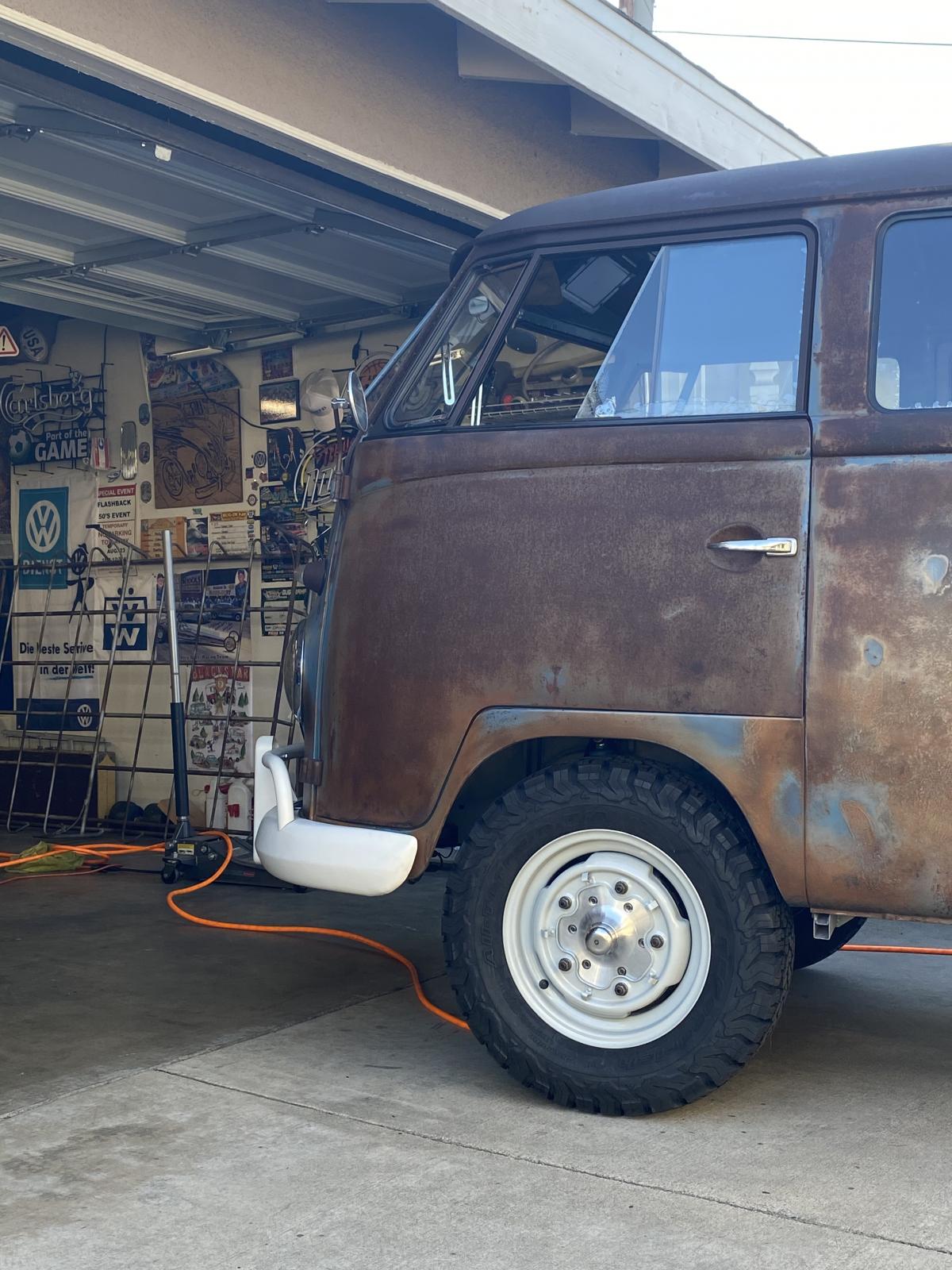

My 1960 walkthrough Kombi with a new set of BFG 215/75/15’s. Loving the change from bias plys.

It looks really good, Did you have any issues getting the tires on the rear and do they rub anywhere? Nice pictures

No rubbing. Rears went on very easy. Just deflated them a bit and worked them on from the rear going forward. No issues whatsoever.

Thanks, for the update. I appreciate the help. Your bus looks good with the BFG's on it.

do you limit the spring travel or the way the tire move up and down?
i plan something like this on my 57 SC, but i am afraid of rubbing anywhere...

No rubbing at all. The suspension set up is stock with Bilstein Shocks on all 4 corners.

I run the same set up. Get a slight rub when I hit big bumps fast

I have 215/75/R15 on my 64 Single Cab and I'm in the process of getting a new 2180 stroker. Getting some repairs done to the tranny as well and have the opportunity to change the gearing. What gearing are you running? I've got the 4.12 R&P and 0.82 4th gear. I'm considering going to a 3.88 r&P

The motor is a 2110. Big nut transmission with a 3.44 RP and a .89 4th.

New tires installed today. They are also 215/75/15’s
realmechanic
Joined: May 22, 2005
Posts: 31
realmechanic is offline
PostPosted: Mon Jan 11, 2021 6:34 pm    Post subject: Re: Large tire/big meats - Stock suspension Bus thread Reply with quote
Had to deflate the rears to get them on so it’s definitely a tight fit with that size tire on my 60.
