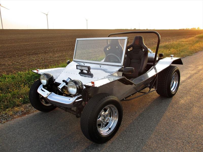

Burro update, coming along good.

One of the things I've noticed about burros is the way the seats are as far forward as possible. This is in contrast to the later "sand rail" sporting type of off-roader where the seats are just ahead of the torsion tube. The Burros were the earliest "utv". Designed as a beast of burden.

PostPosted: Wed Sep 16, 2020 7:38 pm    Post subject: Re: Need help please... grandfather / grandson project Reply with quote
Yes sir, they are further away from the tube vs the sand rail. I like how the seats are setting in the Burro (a little higher up than some sand rails) allowing for some bend at the knee. The sliders have about 8" travel front to rear.

PostPosted: Thu Oct 08, 2020 5:27 am    Post subject: Re: Need help please... grandfather / grandson project Reply with quote
When I saw the first pics my thoughts were GET RID OF THOSE UGLY FENDERS SO IT LOOKS LIKE A BURRO AGAIN !!!! But that last pic shows what a really good job your uncle did. It kinda has a Manx flavor and fenders would definitely be nice in the rain or a muddy trail.

PostPosted: Thu Oct 08, 2020 6:36 am    Post subject: Re: Need help please... grandfather / grandson project Reply with quote
The Uncle that put the Burro together when new added the tubing marked in red before skinning the buggy with metal, (original shape marked in yellow). When my other Uncle bought it in the 70’s he added the fenders. Said he wasn’t too fond of the tires slinging manure in the cabin when driving around the pasture.
