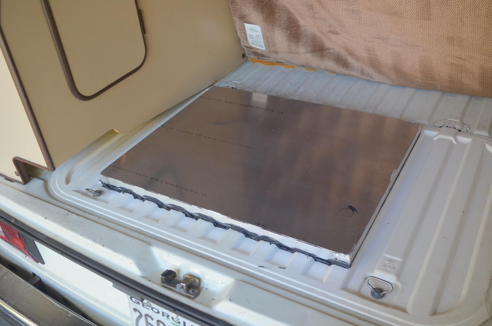

I picked up my 2WD from Greg last November. This is the configuration of the deck lid:
It's about 1" high. I made some panels to level out the foam pad.
The difference in elevation between the pulled out rear seat and the rear pad is not noticeable. We won't know for sure until we're able to sleep on it.

That's not much at all. Nice.

White sealant would look a bit better but so far it`s not bad at all.
You could also print a picture of the original lid on a sticker to apply it on to fool the internet Laughing Laughing

PostPosted: Tue Jan 12, 2021 2:16 pm    Post subject: Re: OFFICIAL: Boxeer.com 2.0 TDI CR engine review thread Reply with quote
OK, so the top's not very pretty, but you can't disrespect the underside of the lid! Wink
