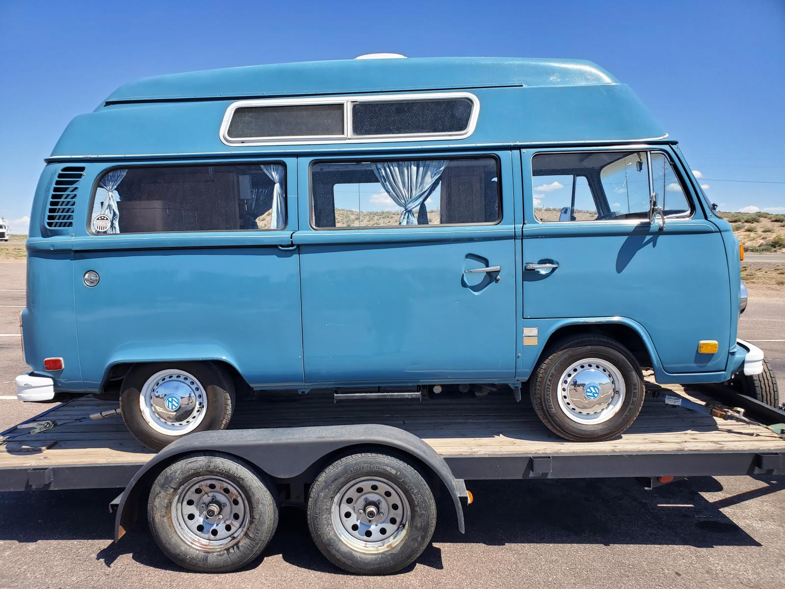

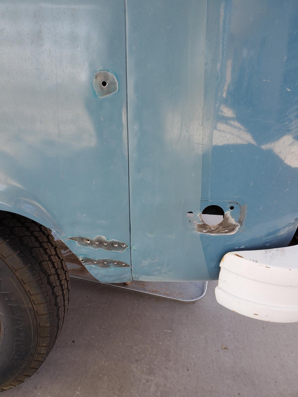

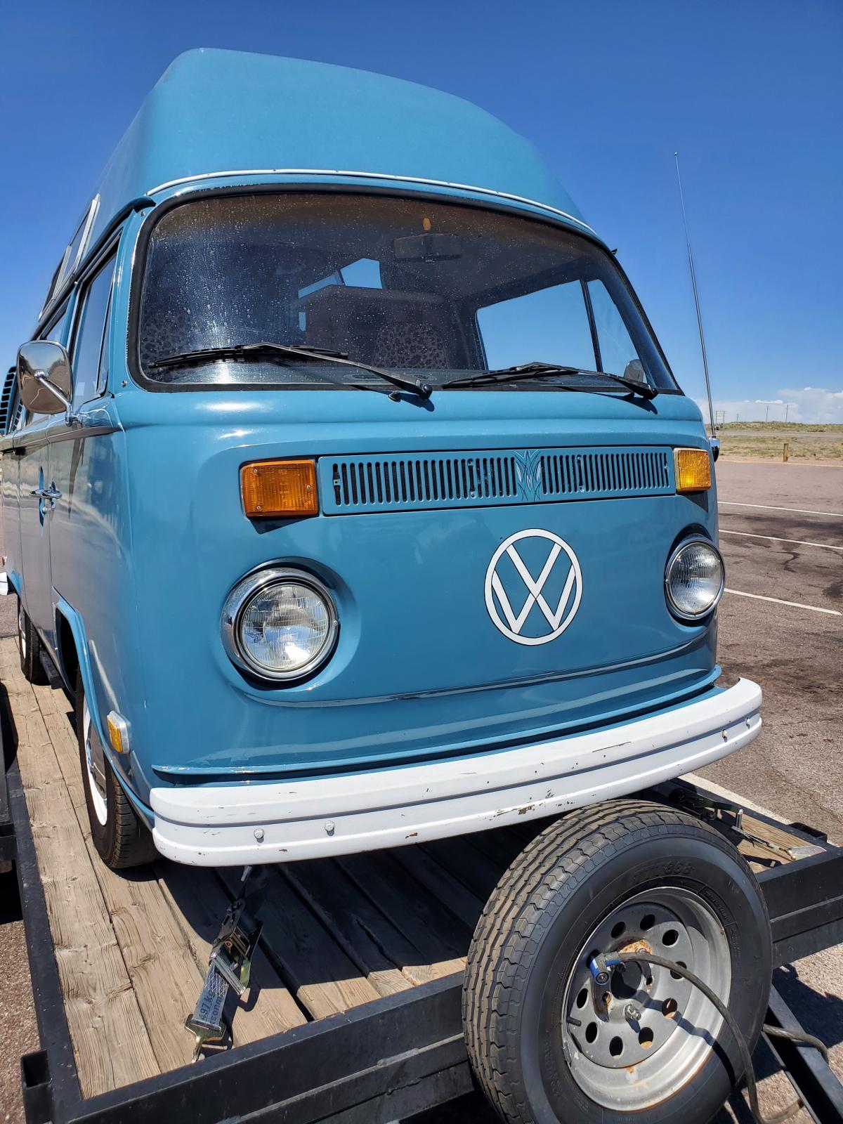

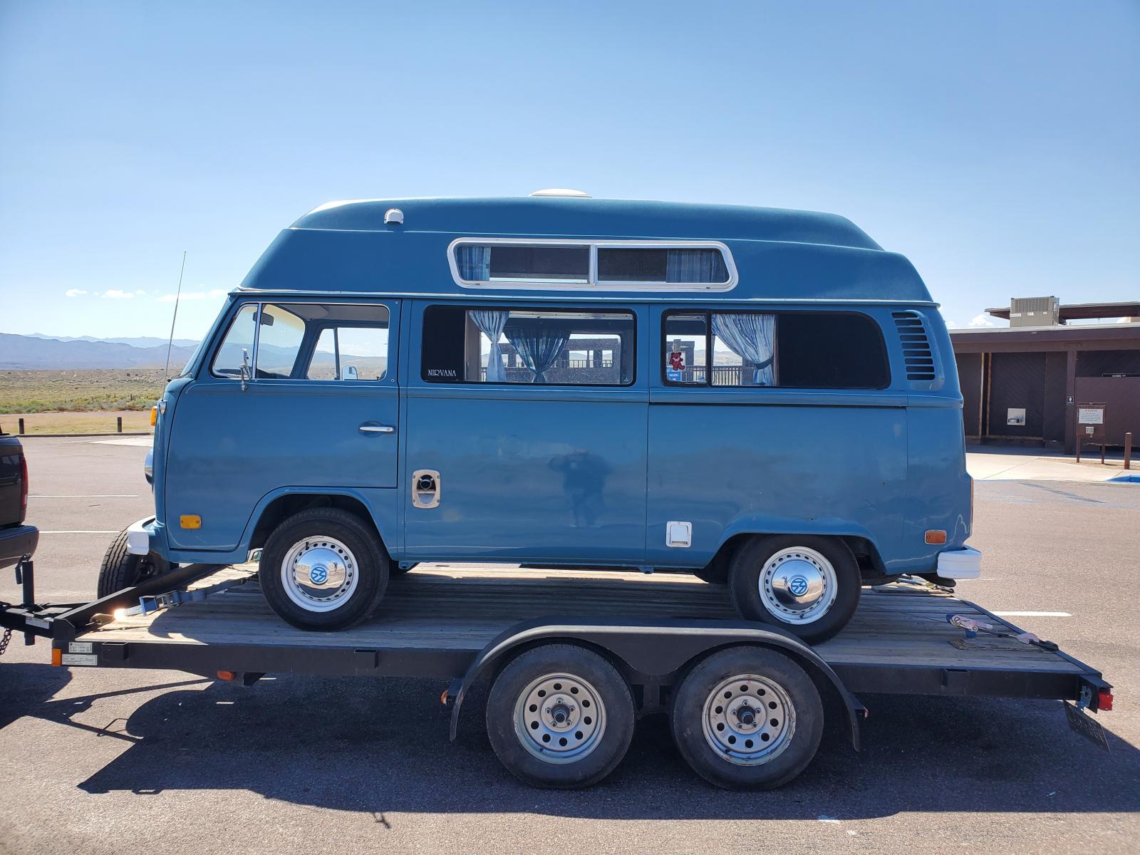

Here is my 1974 Safare Camper I purchased on Ebay back in September of 2020. I have always loved Hightop's, so when this one came up for sale I jumped on it as it seemed really solid. Needless to say there were a some hidden issues I found upon inspection after winning the bid and going to get it. While loading it on the trailer it barely wanted to drive onto the trailer and seemed to be lacking in power. Almost all of the window seals were dry rotted, the light lenses were deteriorating, and once I got it home I found a lot more. Nothing was too bad, I just wished the seller had been more forthcoming. Regardless I am trying to make my way through correcting them all and getting the Bus to where I want it.

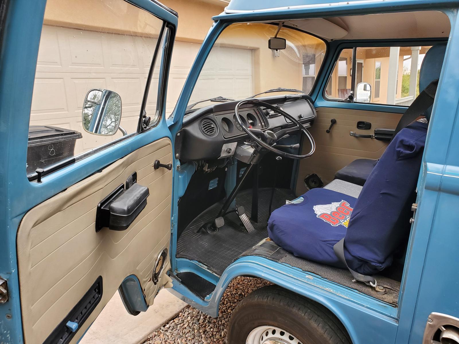

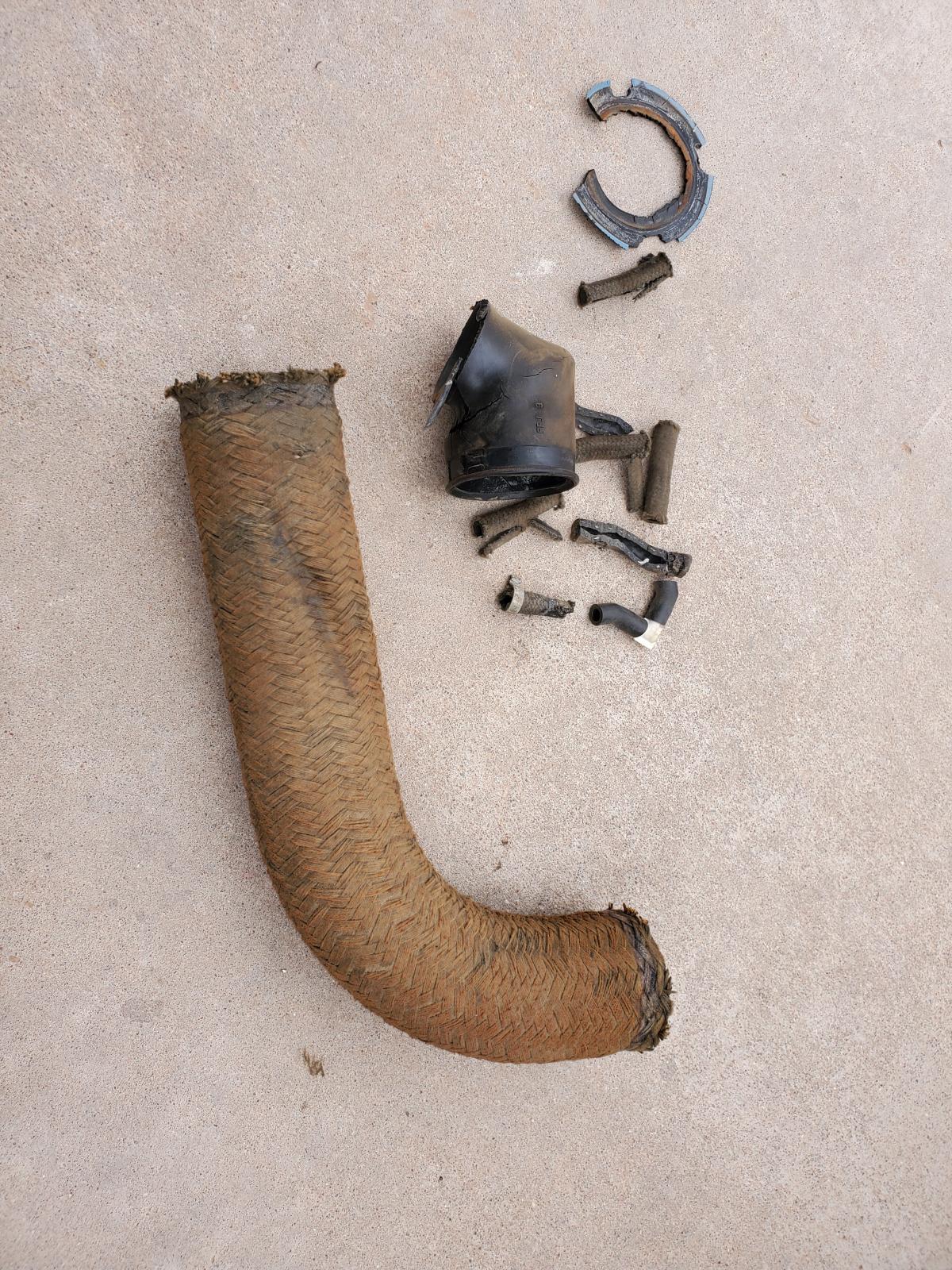

Once I got it home and unloaded I went to work. Cleaned it up, threw some T-shirts on the seats and started dreaming...........then I did a basic tune up. Oil, plugs, wires, shifter bushings. The carb linkage was trashed, shifter coupler was trashed, shifter plate was cracked apart, distributor was trashed, coil was dented in, giant hole cut out behind the passenger seat. So I went to work and started repairing and or replacing all the bad parts.

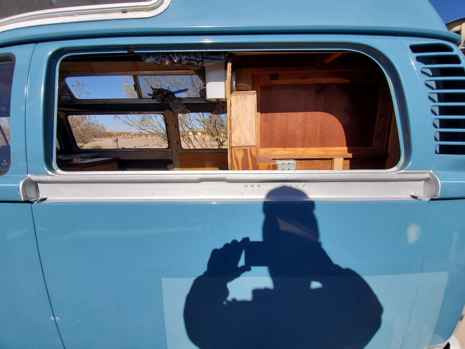

I ended up fighting with the progressive carb and could not get it to run well, so I ended up getting a set of Dual 44 IDF's from a friend and installing them along with a 009. We got it to run decent and I felt as if I was making headway. I ordered some window seals and swapped them out, removed the bondo from the left rear quarter and rattle canned it, put a few patches in the windshield frame, coated the windshield frame with master series silver(it will have to be replaced eventually), cleaned and painted the track covers, swapped in a solid left rear glass(smokers window was rusted out), made some curtains, made some new tables, bought some new panels from Werksburg and installed them, installed a new wiper switch, installed the correct ignition switch, fixed all the wiring behind the dash, painted the upper dash, got rid of a lot of the ghetto fixes that had previously been done, fixed the speedometer, replaced the brake warning light, got the shore power panel and outlets working, and made some new seat covers.

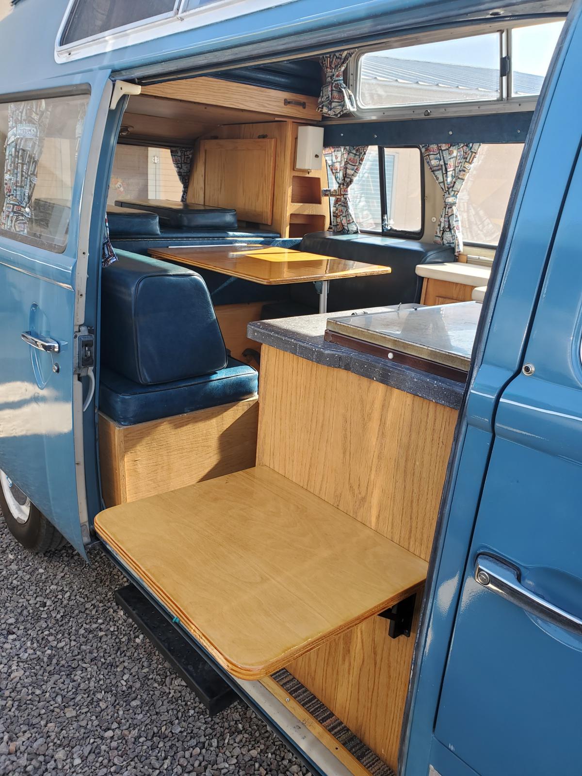

Thanks! As far as interior I believe part of it is original.........but who really knows. A previous owner at some point removed the sink and water tank and installed 1" plastic counter tops. Motor is toast so I am probably gonna do a 2180 Type 1 conversion. |

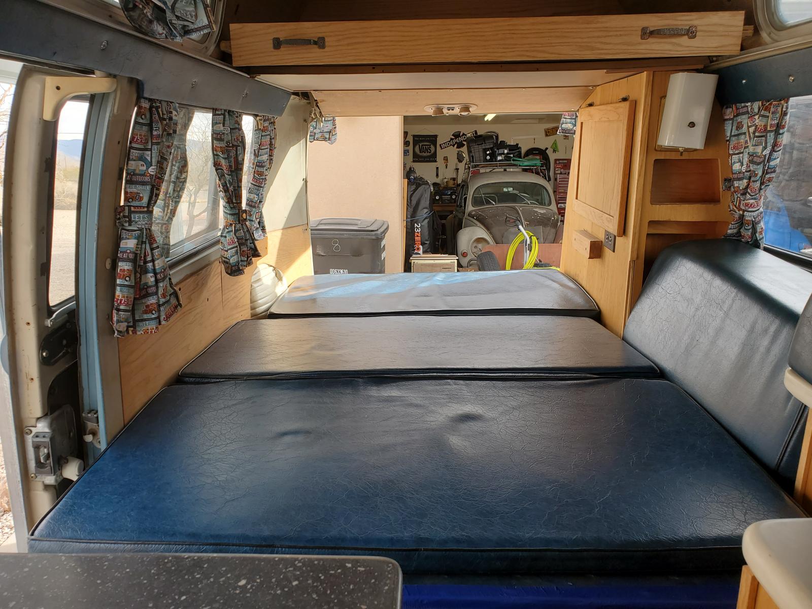

Nice machine, I love the Safare camper design, to me it's like the perfect use of available space, especially the booth style seating. Any chance of seeing beds set up? |

I will try and snap a few pics this weekend. |

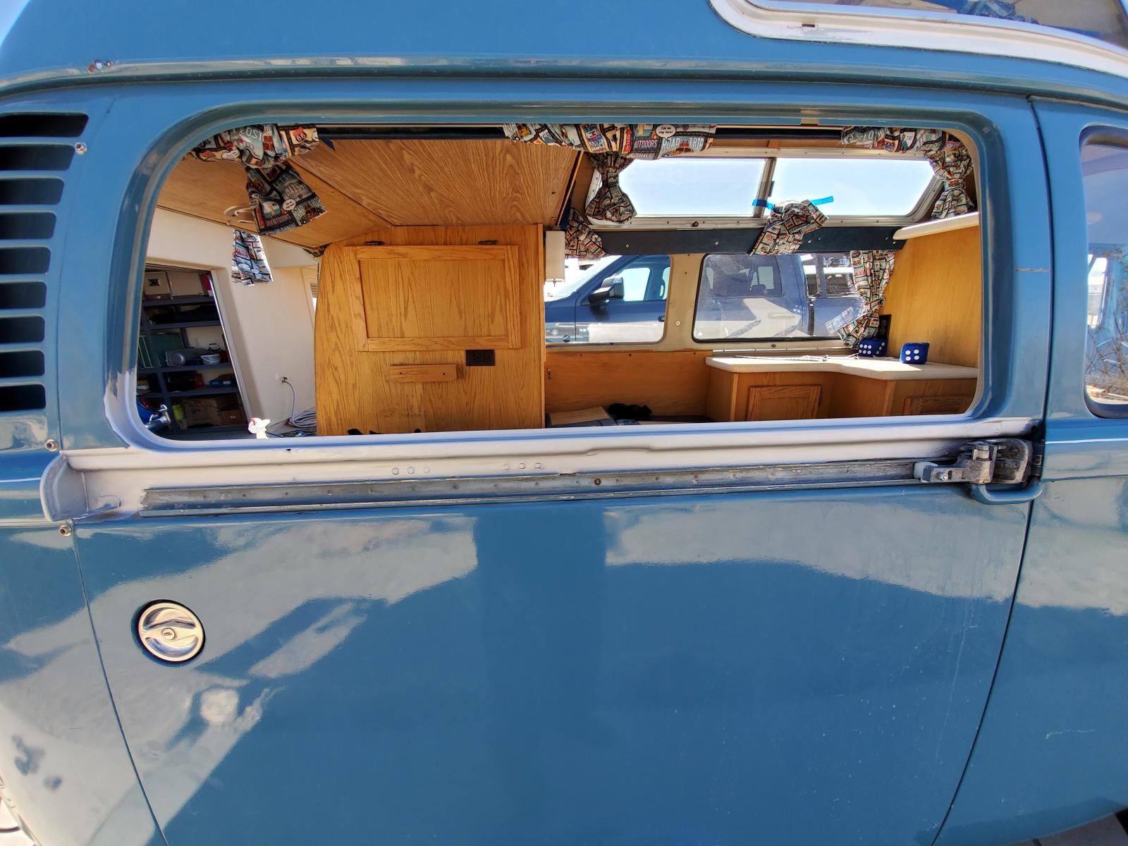

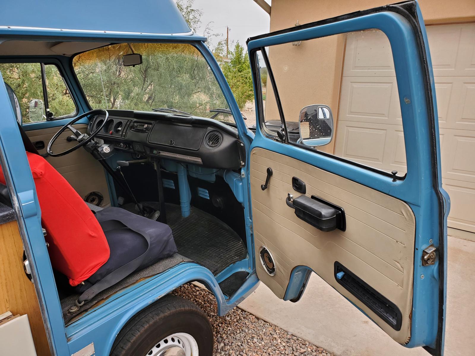

What a pain....... replaced all the fuel hoses for the gas tank and vent system on the Bus. Then I took some pics of the beds as requested.

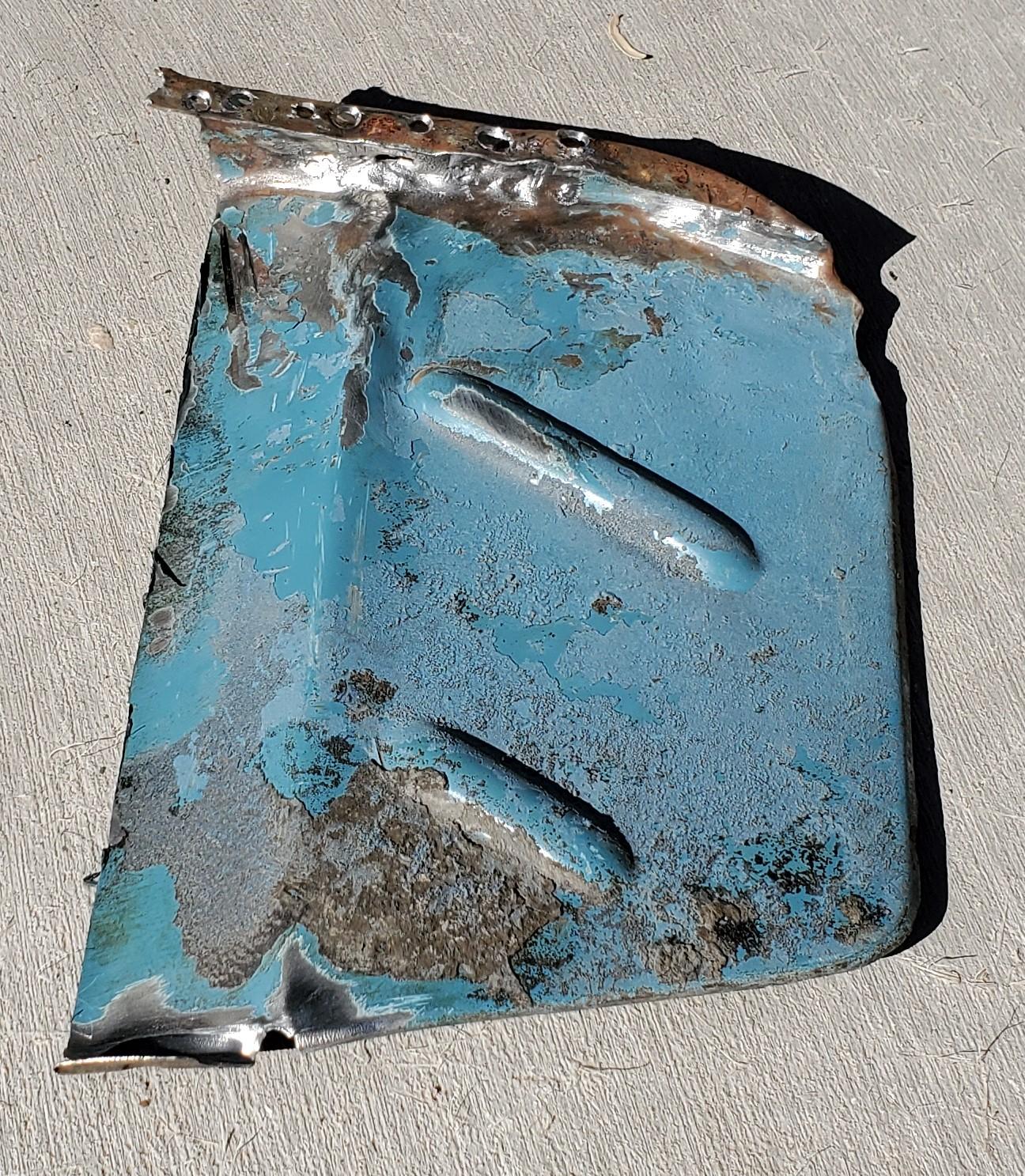

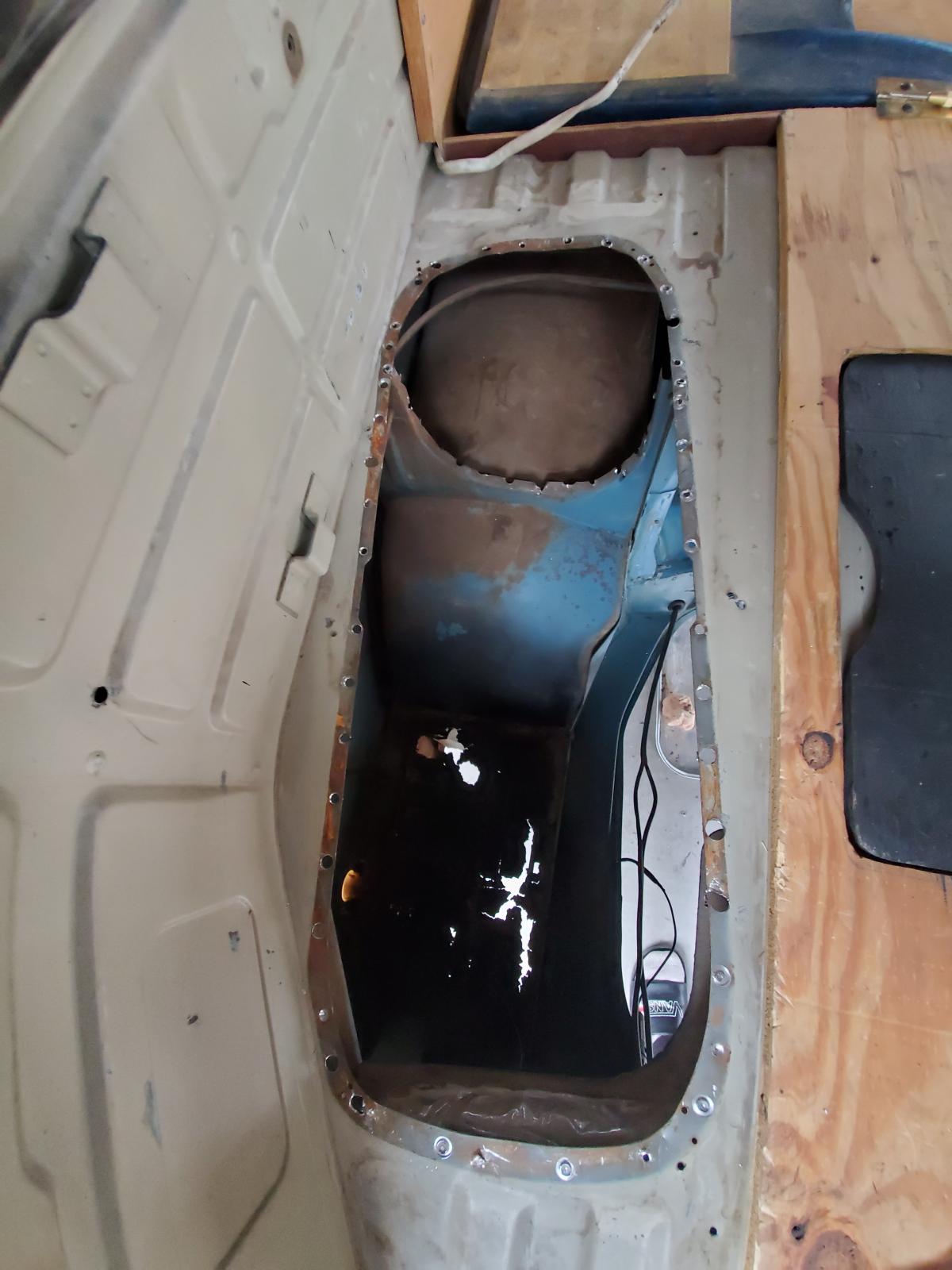

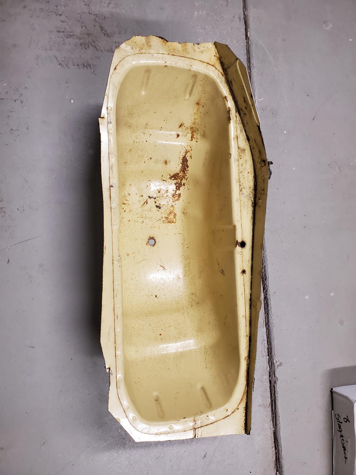

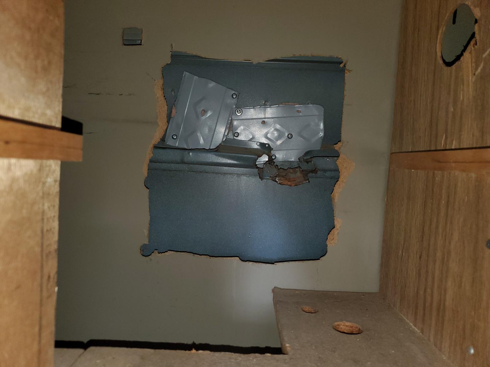

Here is two more hack jobs a previous owner did when they removed part of the spare tire well and the sink.

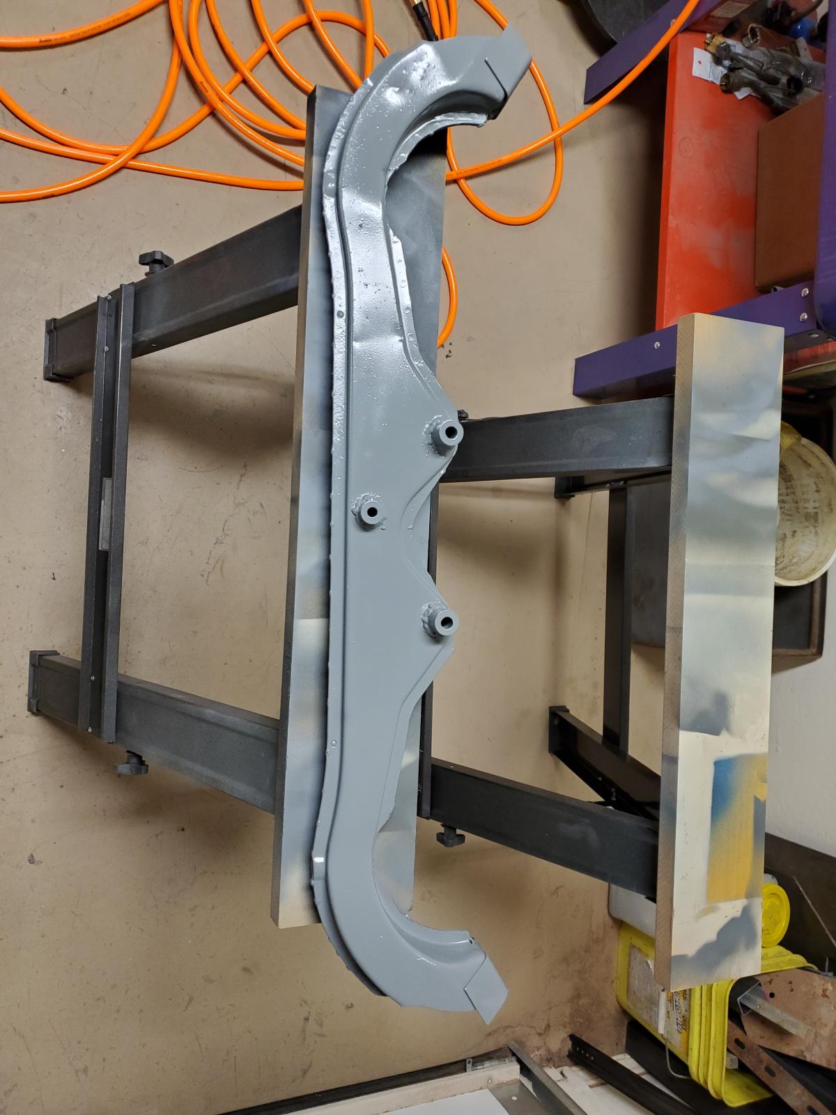

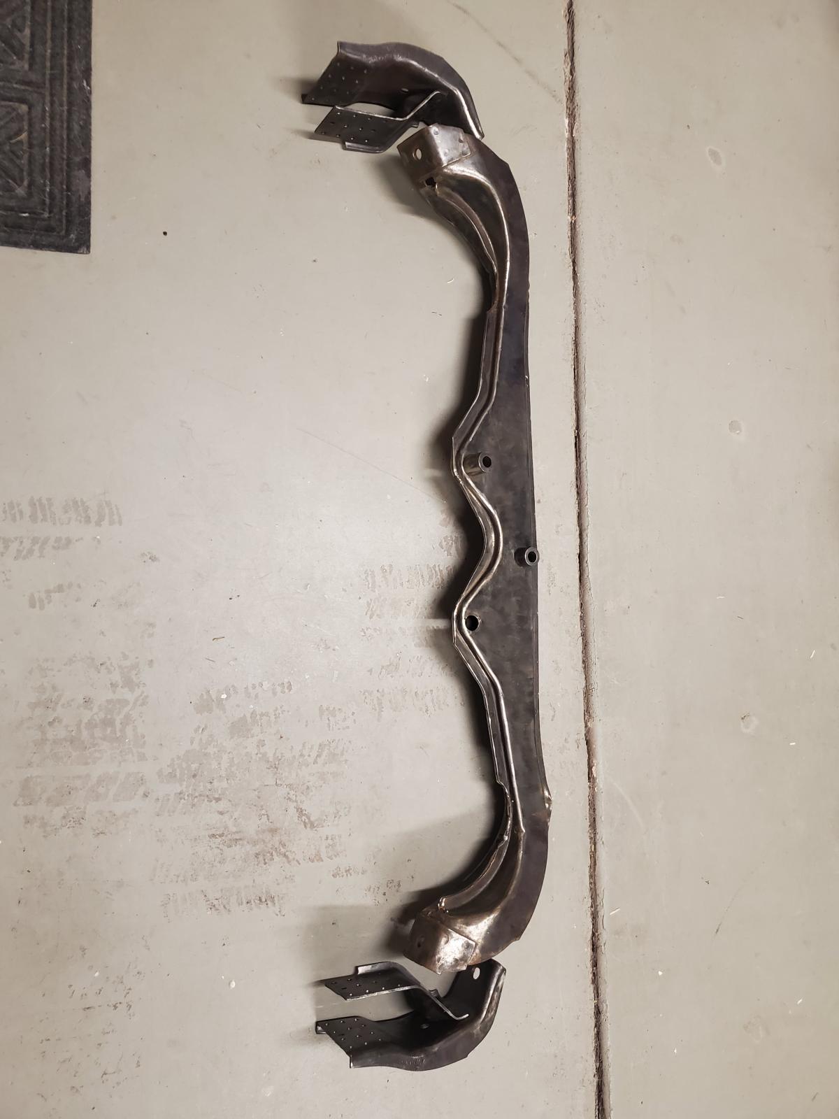

Not much else going on at the moment other than collecting parts for some s/m repairs. I picked up a used 68-71 mustache bar and frame brackets, a spare tire well, Creative Car Craft fiberglass Type 1 conversion tin, and both battery trays.The bar needs a bushing replaced and straightened. Its a little twisted.........nothing a little heat and a press can't fix. Just got to find a press and a bushing that is the correct size.

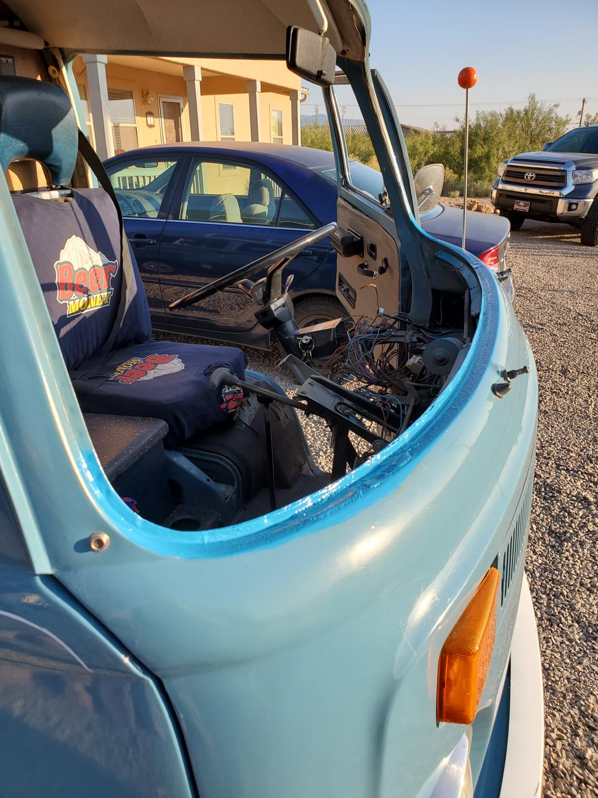

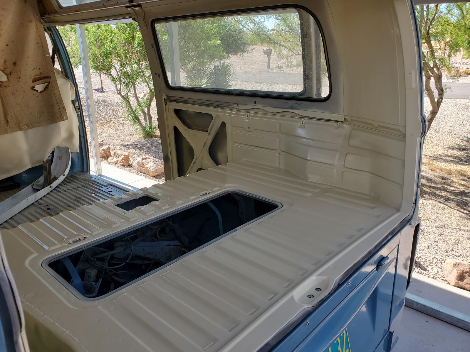

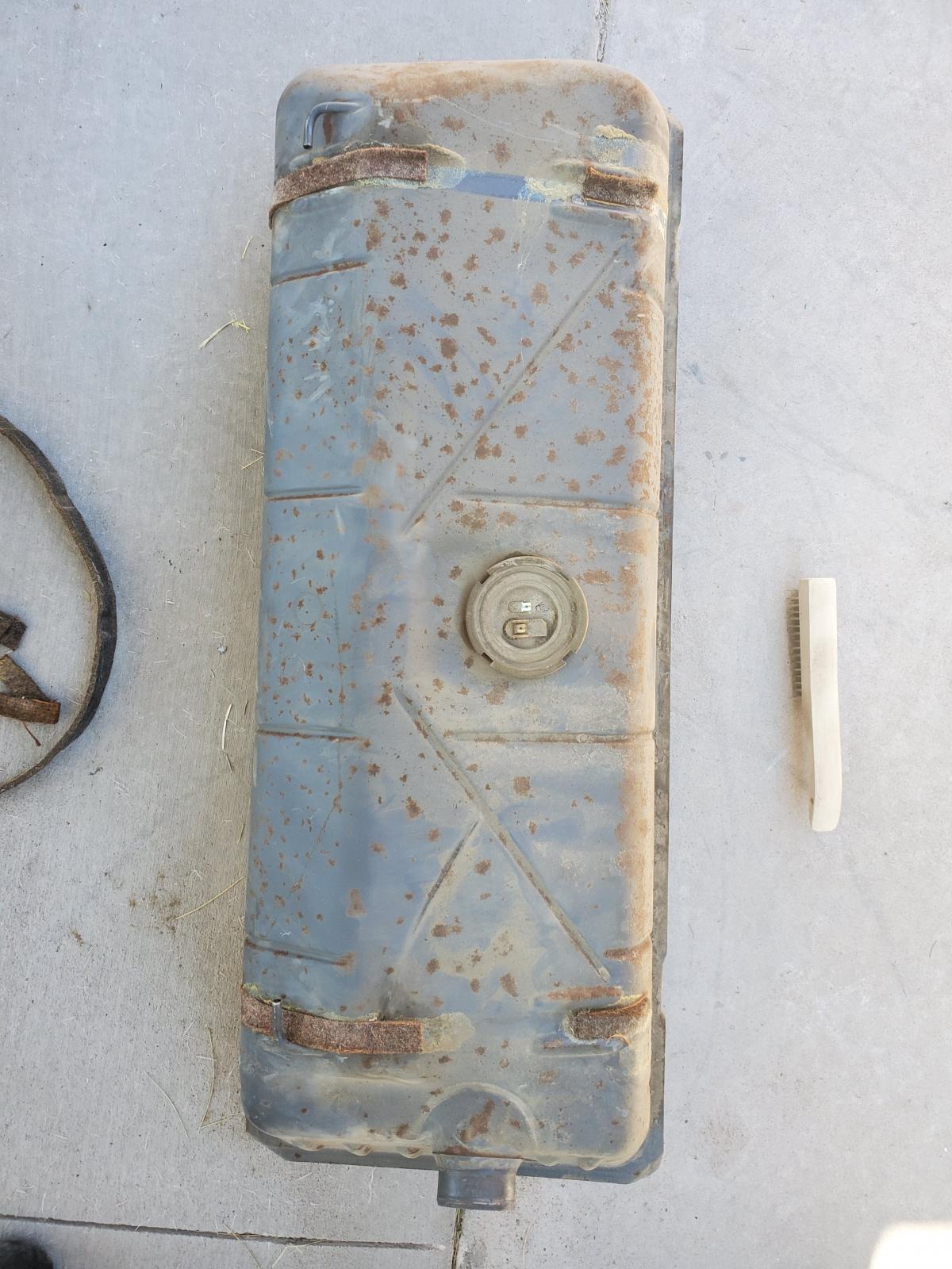

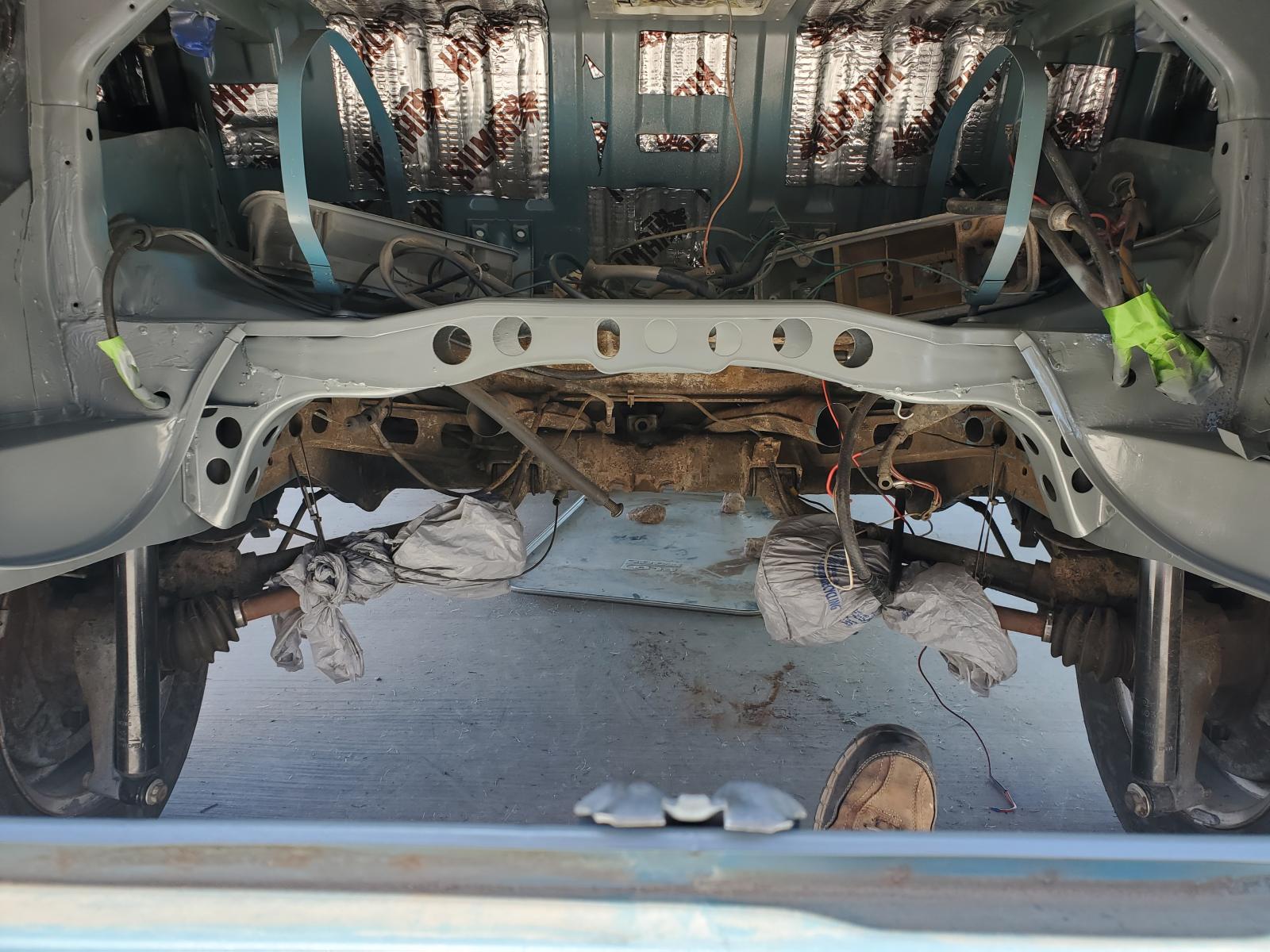

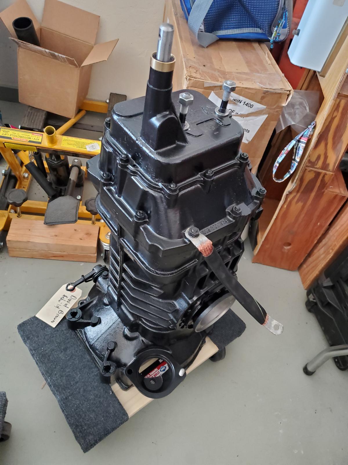

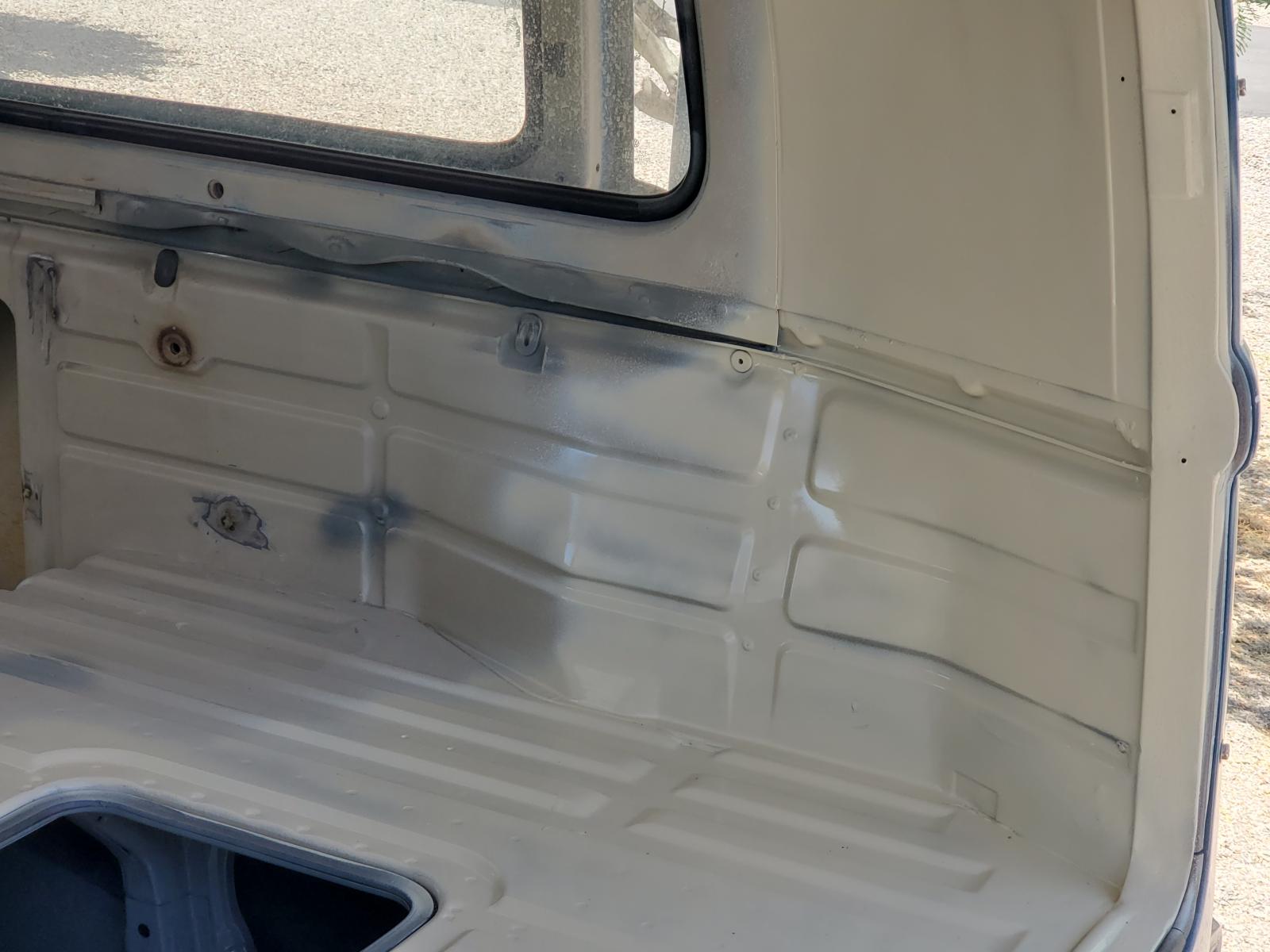

I decided to go ahead and pull the transmission out to get it overhauled, then I pulled the gas tank and freshened it up, stripped the interior, cut out the old crusty battery trays, stripped back the paint and filler for metal repair, and pulled out the remaining piece of the spare tire well.

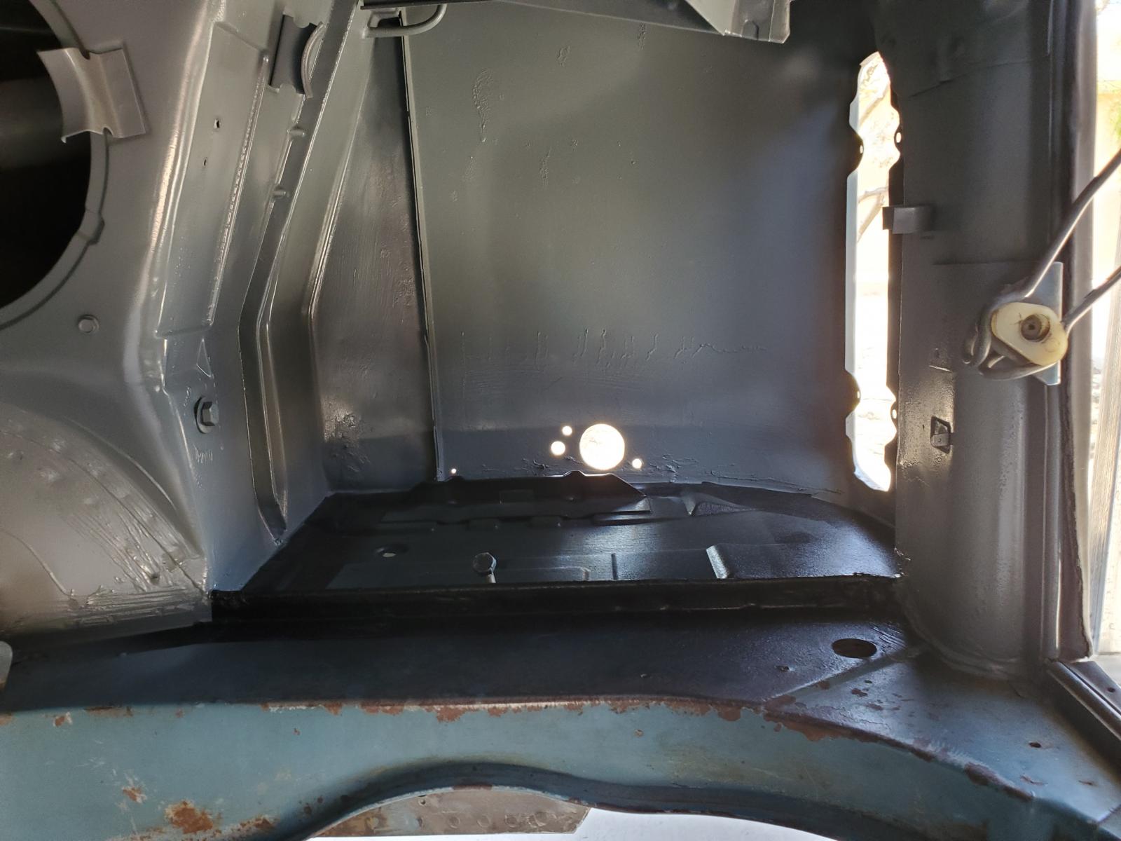

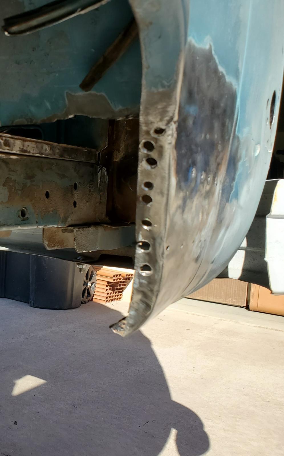

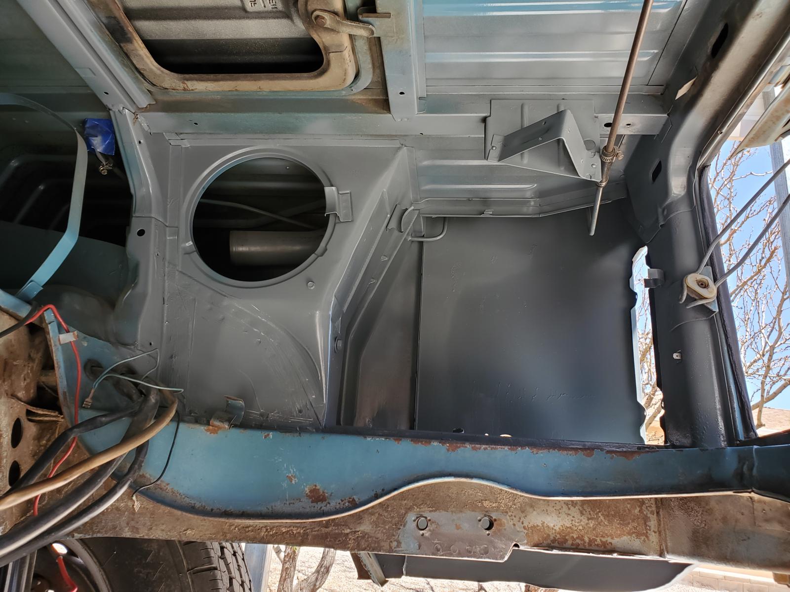

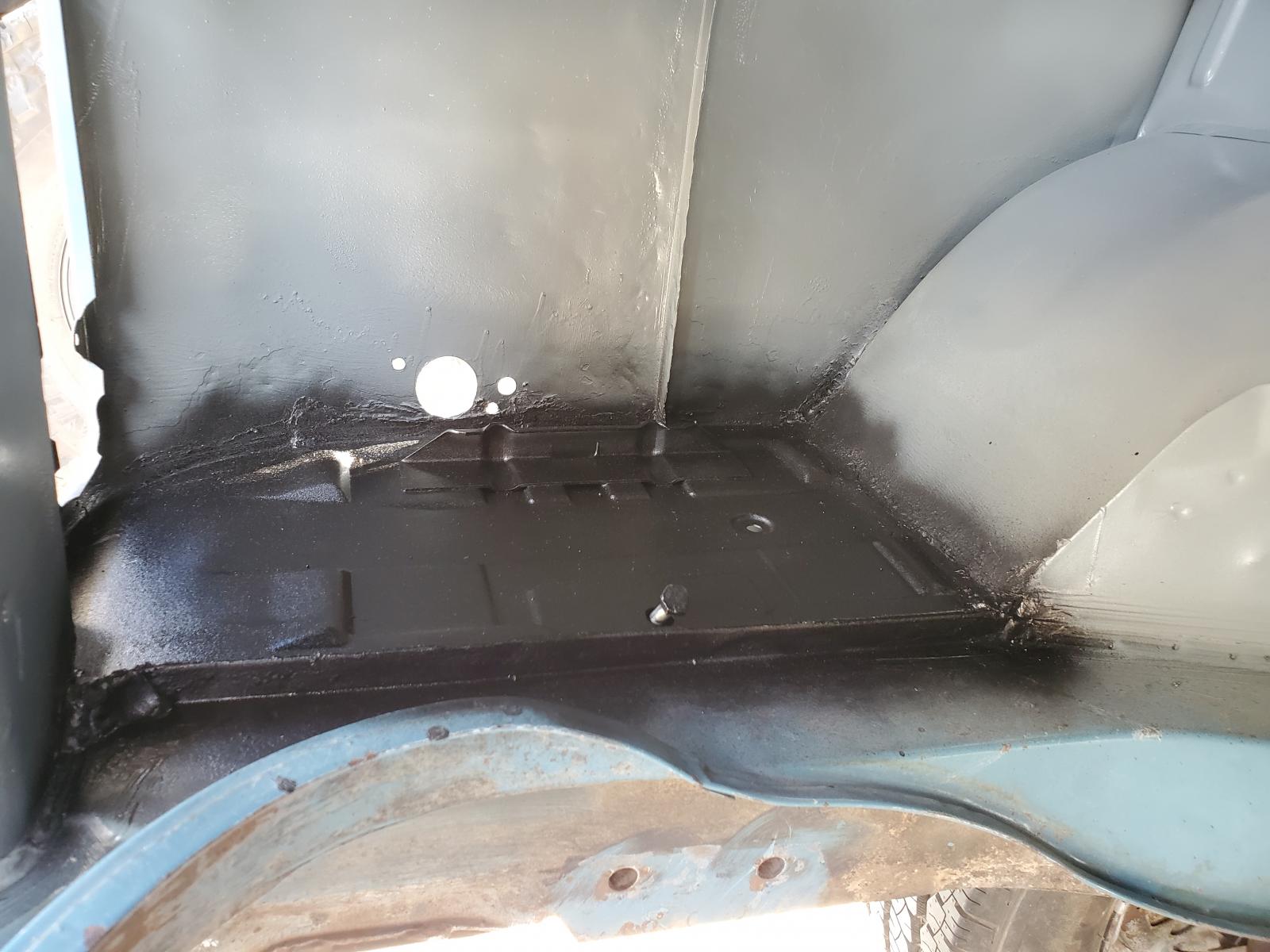

Made a little headway over the last week. Had to fight with the battery tray on the right side for a while but I got it in. Ended up cutting out part of the left side inner fender well so I could try and straighten up the metal.

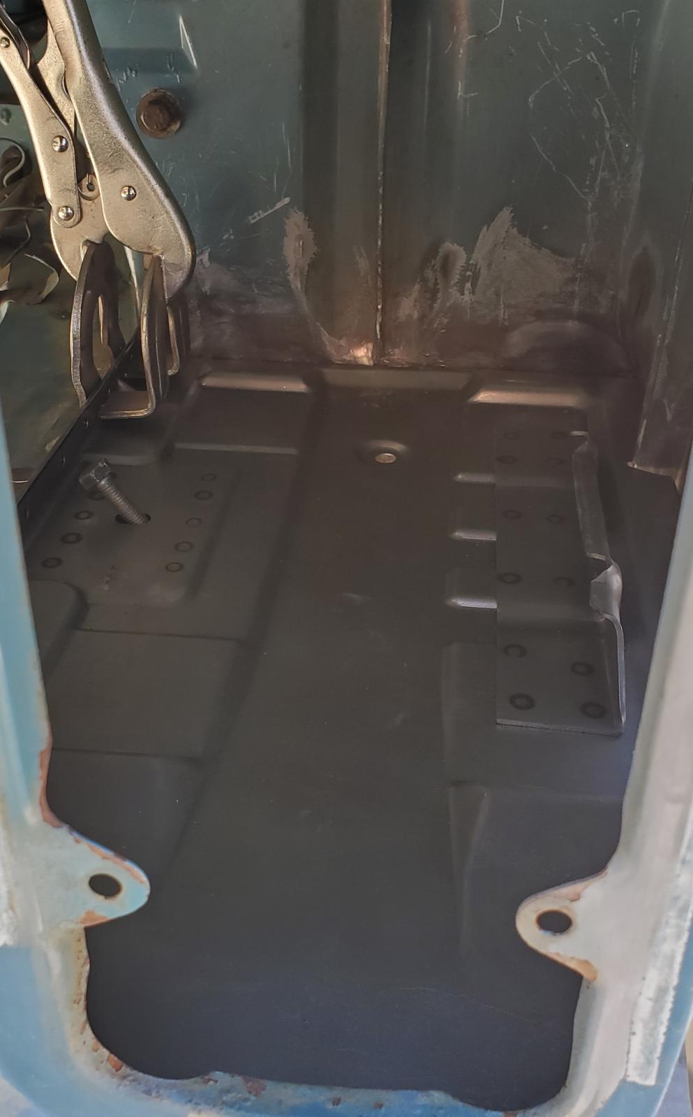

Posted: Sun May 09, 2021 9:41 am Post subject: Re: 1974 Safare Camper |
Made some more progress but didnt get to finish as my welder ran out of gas.

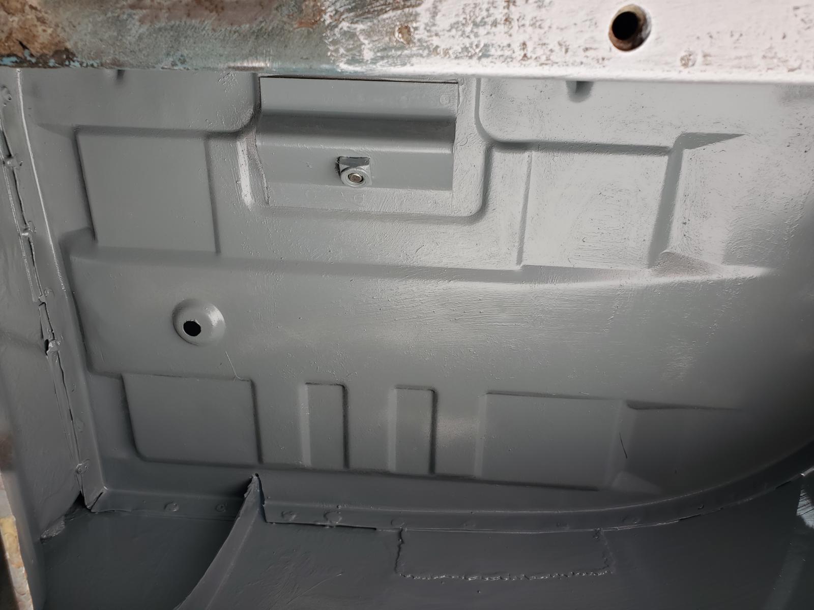

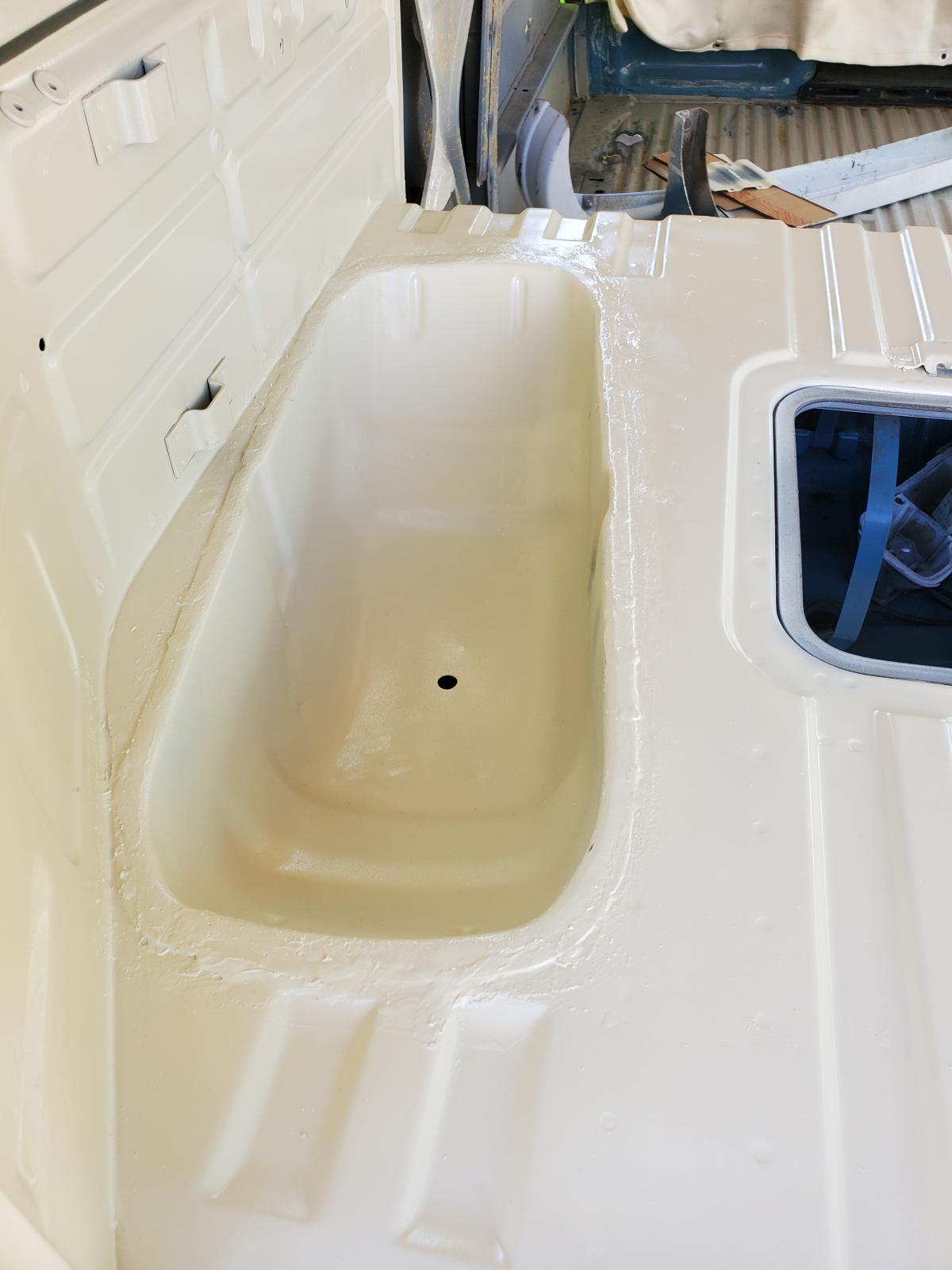

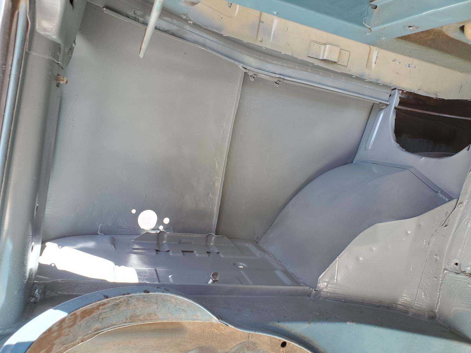

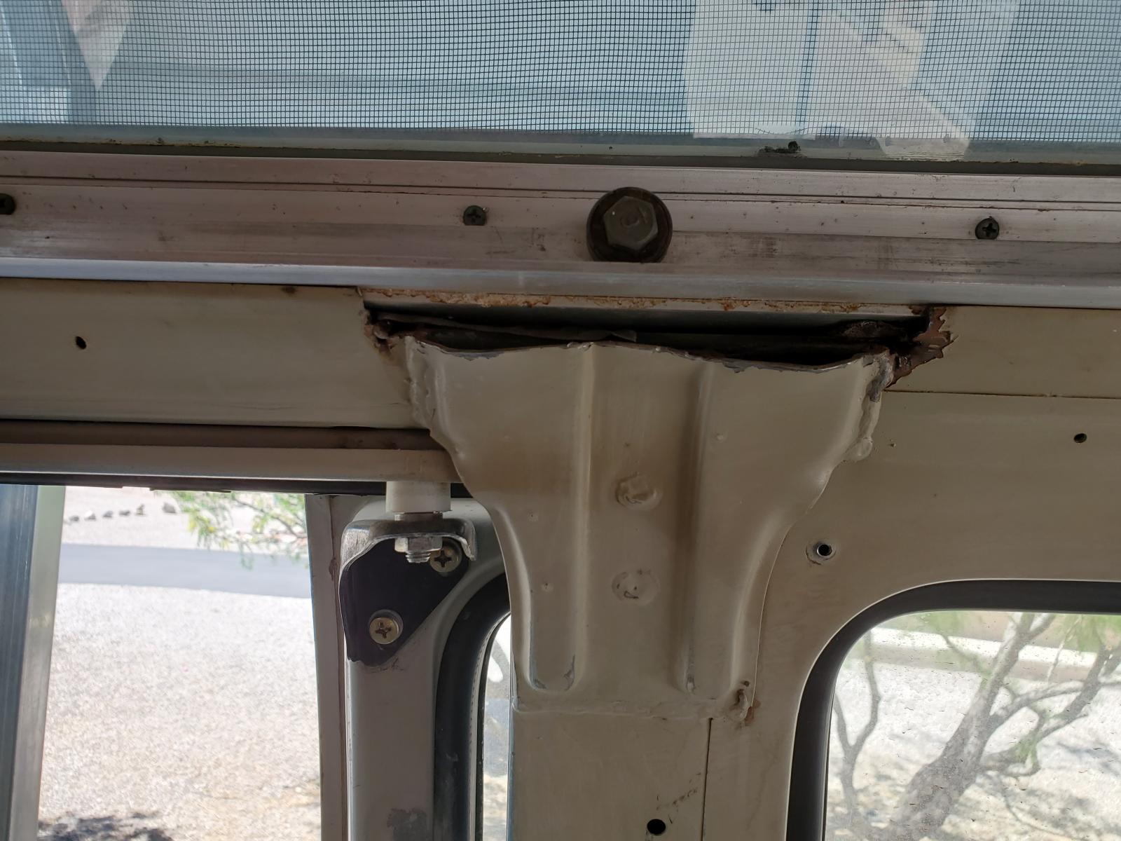

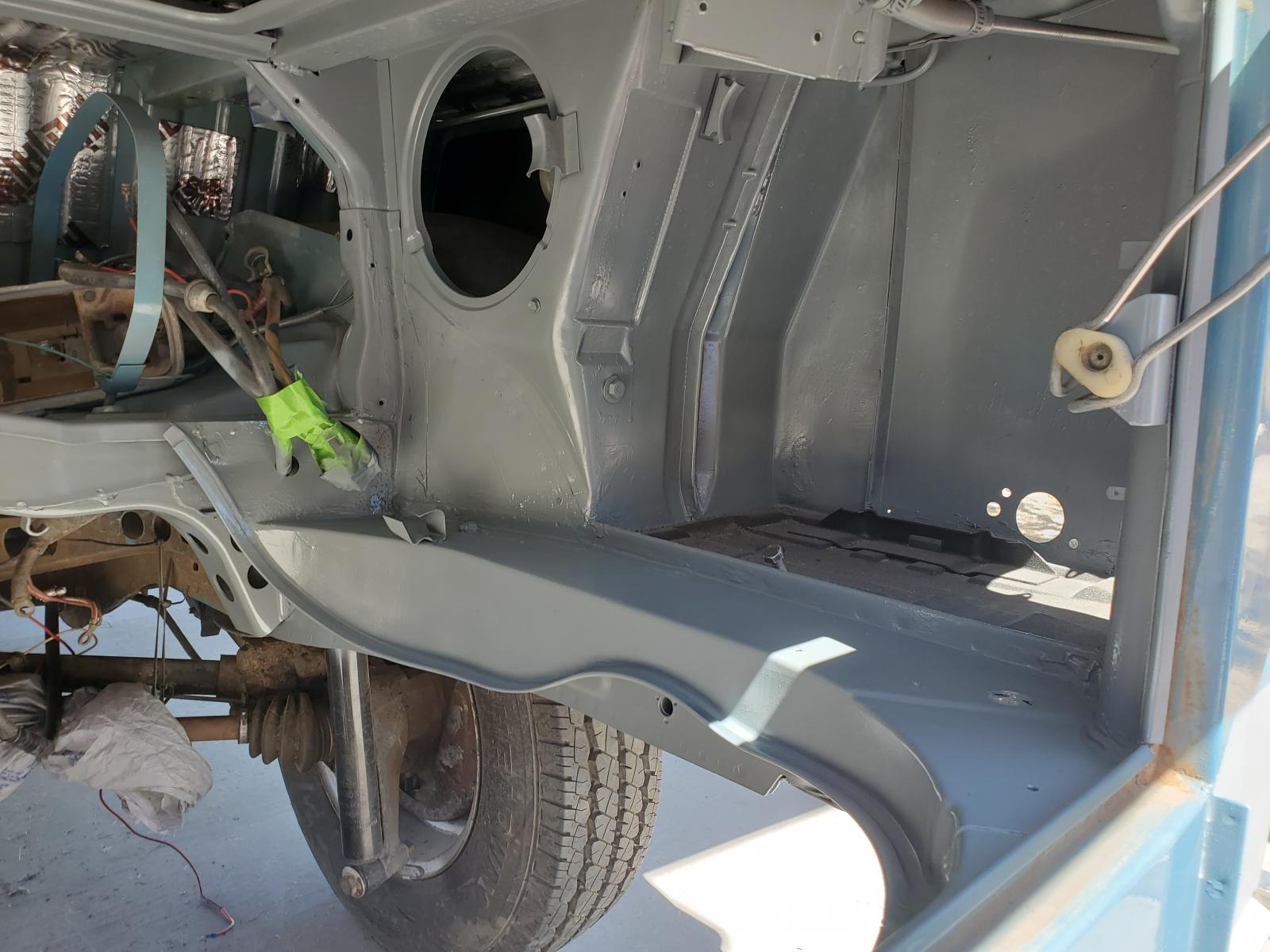

Made some more progress this weekend. Spare tire well is fully welded in and seam sealed. Welded up a bunch of random screw holes as well and then threw down some almond paint. I also discovered the Safare hatchet job they did for removing the roof cross brace. I will have to address that once i get around to pulling the hightop off. I also installed a sending unit access.

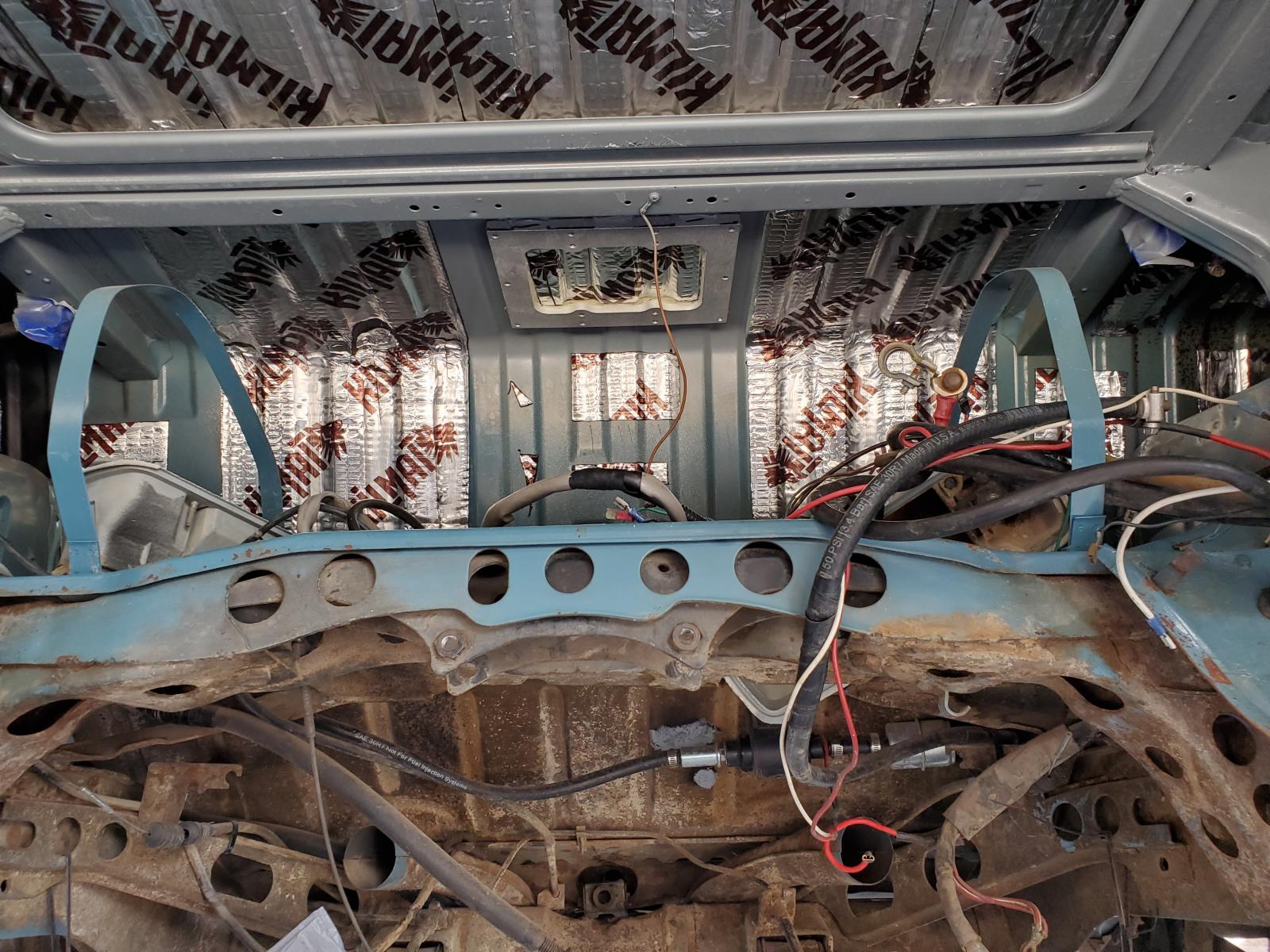

Posted: Sun May 23, 2021 1:29 pm Post subject: Re: 1974 Safare Camper |

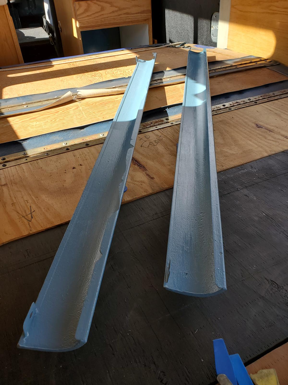

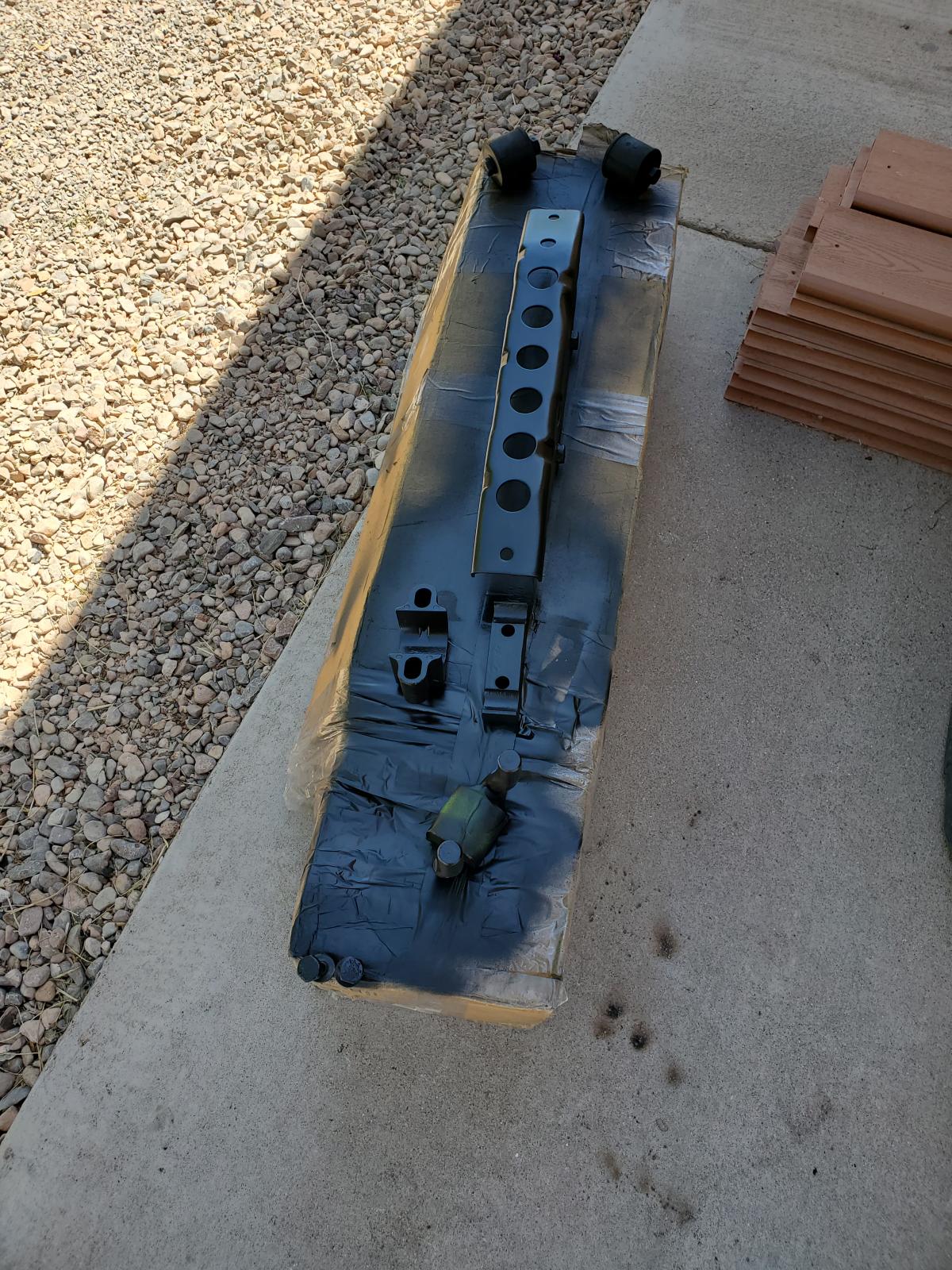

Picked up my Transmission from the shop on Friday and pressed on with cleaning, painting, and installing sound deadener.

Looks really great so far!
Remember to remove the paint from the mounting surface of the starter. _________________ '78 Bus 2.0FI
