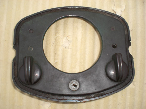

We know that in '49 they swapped the position of indicator lights in the pods. with the oil light being on the left early, and on the right after (and yes, the other lights swapped sides too).
I am trying to ID this pod. It is purportedly a KDF era pod, but has details of a later pod. Green light on the right. Brass ground fork (I know that '46 and '47 pods had a steel ground fork). Unfortunately it is broken off so I can't see any date code that might have been there. It is missing an extra brass block terminal that is above the wiper dome light switch (when the fork is on the other side as in '46-'49. So it has a lot of the features of a late '49 and up, but a Cogwheel VW logo....!
Is it possible that in '44 the green light was on the right, sometime after they swapped sides, then in '49 they swapped back again? Anyone have any pics of or docs of KDF era pods that show the light positions? TIA

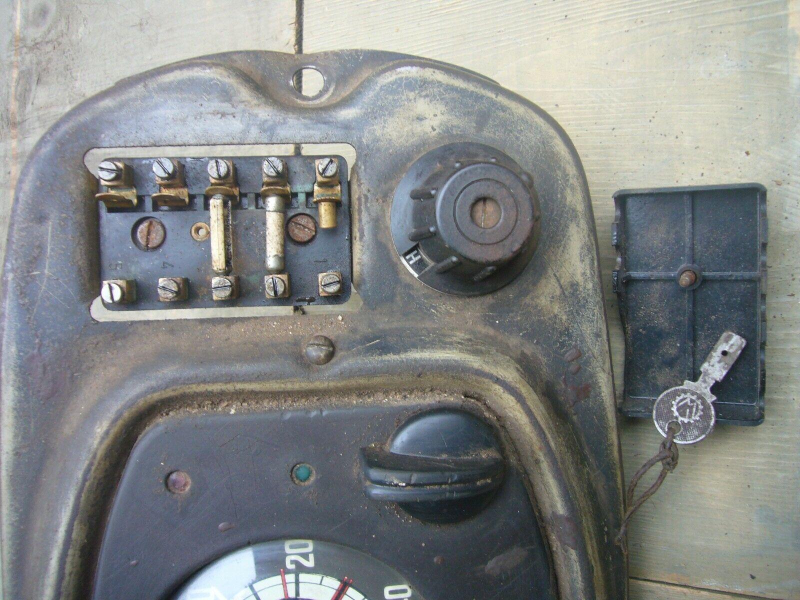

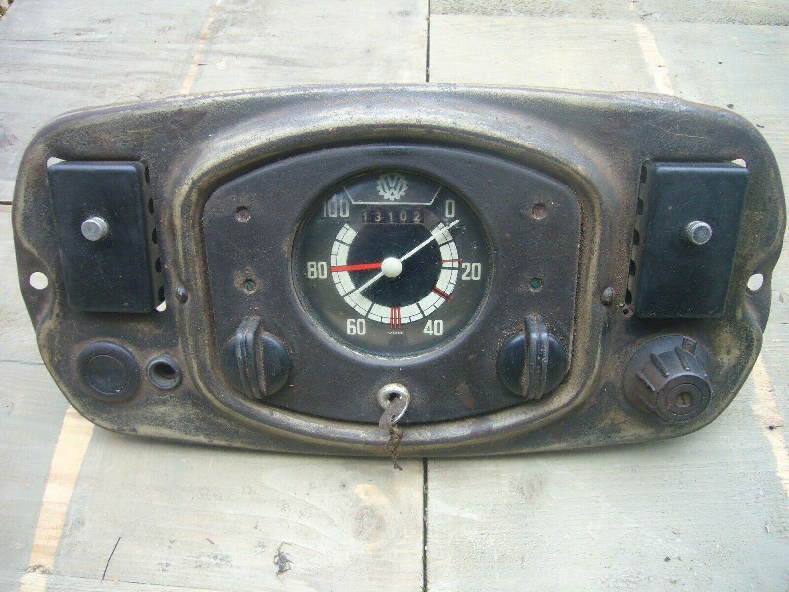

On the subject of KDF era dash pods, the one in the picture below, a Kubel item, sold on German Ebay recently, 31st December 2020 to be precise, by somebody in Boden, Germany, which sold for the sum of 5,728.90 Euros, plus delivery!
I can just about remember the time when you could buy a complete Kibel for that price! Little did the person taking this off a Kubel know what price it would fetch in the future.

I don't think a Kubel would have had a 100km speedometer.

PostPosted: Wed Jan 20, 2021 5:52 pm    Post subject: Re: KDF Speedo Pod? Reply with quote
Martin Southwell wrote:
Well it looks to me that the green/oil light is on the right there, concur?
If so, then those are the "late split: positions which, *if* that is truly a KDF era pod, would confirm that they did flip the indicator positions some time in the early 40s, then back again in late '49. But I wouldn't believe it unless I could see a pic of the backside of that Kubel pod and see a cogwheel logo. Maybe unlikely (and would suck for the person who paid $6+ for it apparently), but they could have just faked it with a common standard split pod.

PostPosted: Thu Jan 21, 2021 3:42 am    Post subject: Re: KDF Speedo Pod? Reply with quote
These photos should help you make up your mind! Note that there is even a KDF key.

PostPosted: Thu Jan 21, 2021 4:52 am    Post subject: Re: KDF Speedo Pod? Reply with quote
The pictures of this Kubel-dash....it all looks fake to me. I would not trust these parts for reference.

SplitPersonality is offline
PostPosted: Thu Jan 21, 2021 4:53 am    Post subject: Re: KDF Speedo Pod? Reply with quote
Repro "fat" face-dial on the speedo, black plastic big knobs....

PostPosted: Thu Jan 21, 2021 5:40 am    Post subject: Re: KDF Speedo Pod? Reply with quote
Hi JH.
Just looking at your photo where the toggle bolt mounts it to the dash. Is that brown paint scraped off? I assumed they were raw bakalite not painted?
