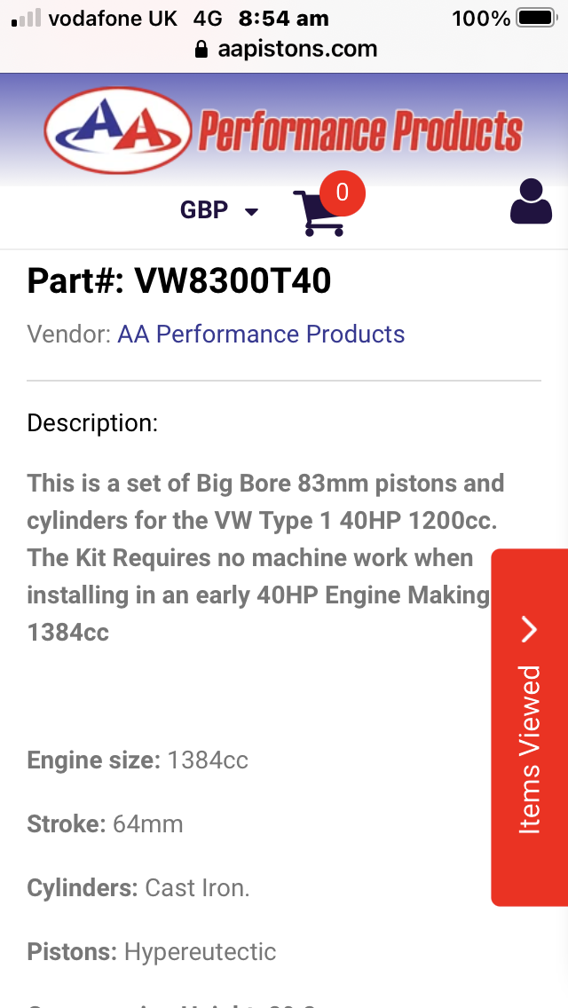

Albertoprop17; I think you have hit the nail on the head!!!! Please have a look at the listing below, I haven’t seen any reference to this fitting on the 90mm case. I will contact to find out. But hopefully you have cracked it.
Brass gears; this idea of spacers or spigot rings has come up a couple of times. It couldn’t just be left to float but I think we are getting closer to an idea that might work for a while

PostPosted: Fri Feb 05, 2021 2:10 am    Post subject: Re: late 40hp model dual relief case? Reply with quote
https://aapistons.com/collections/piston-liner-kit...l-european
Here you have it, I think you can find them on your local aircooled shop

Alex Juszczyk
Joined: February 02, 2021
Posts: 40
Location: South east UK
Alex Juszczyk is offline
PostPosted: Fri Feb 05, 2021 4:16 am    Post subject: Re: late 40hp model dual relief case? Reply with quote
Albertoprop17; you are an absolute gent!!!!
Thank you so much. Iv contacted loads of uk dealerships and it’s not a common product over here but I think Iv found one AA dealership so fingers crossed at the moment but it’s looking promising.
I’m assuming this is the simplest way to give the engine some extra “geegeez” to handle that gt box?
