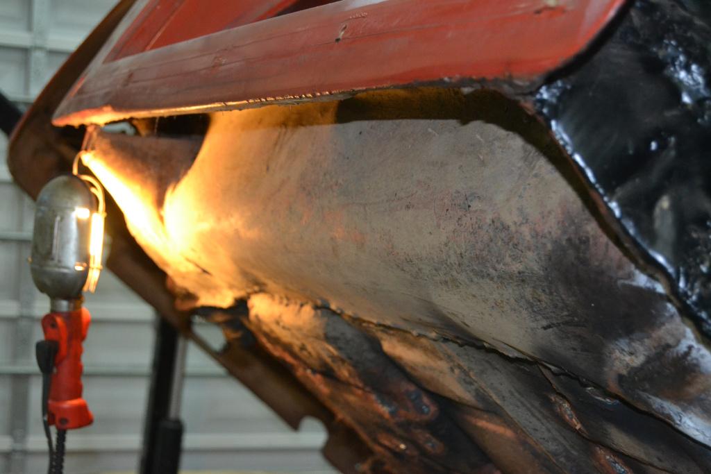

After some delay, I am removing the final parts from my T5 in order to take it to the abrasive blaster.
My references are the Charlie White (RIP) FSM reprints, Henry Elfrink, Harry Pellow, Floyd Clymer and Autopress LTD.
When I used to grease the front end, I always wondered where all that grease went. Now I know: into the axle tubes. I managed to get the torsion bars out, and the needle bearings out of the ends of the tubes, but so far the plastic bushings don't seem to want to come out. There's still too much grease in there to see what's going on right now. I need to clean all the grease out so I can see the plastic bushings and whatever else is still inside, and because otherwise the abrasive blast will stick to the grease. This has to be one of the worst parts of a Porsche or VW resto.
So while I continue to clean the grease out, can anybody give me any suggestions about how to remove the plastic bushings? Also, are there any other parts inside the axle tube that I haven't discovered yet? Thanks a lot.
P.S.: After I removed more of the old grease, I discovered that you can't get the fiber bushings out until you remove the 4 grease nipples that protrude a little bit into the axle tubes. The center clamping piece is also still in there, and I guess you use that to drive out the fiber bushings(?)

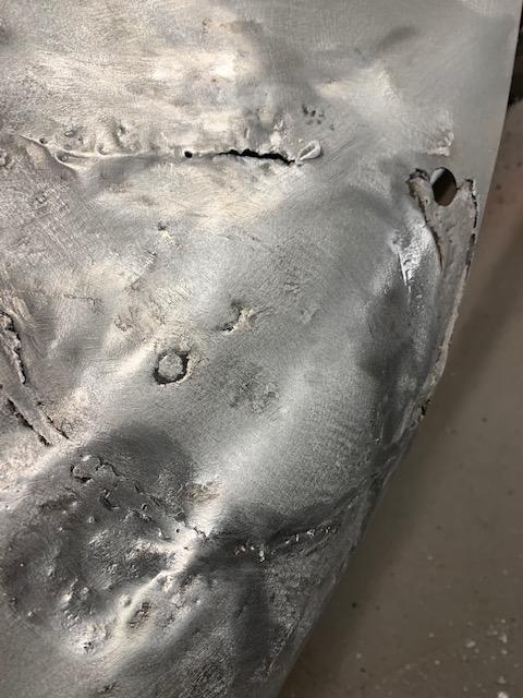

After abrasive blasting, I discovered that the body had several problems that were covered with Bondo, and of which I was therefore previously unaware. And it does need floor pans after all. But having seen several examples of their work, I am confident that Lance and Josh Lighthall can make it like new again.
Last edited by William Crowell on Tue Feb 23, 2021 8:07 am; edited 1 time in total

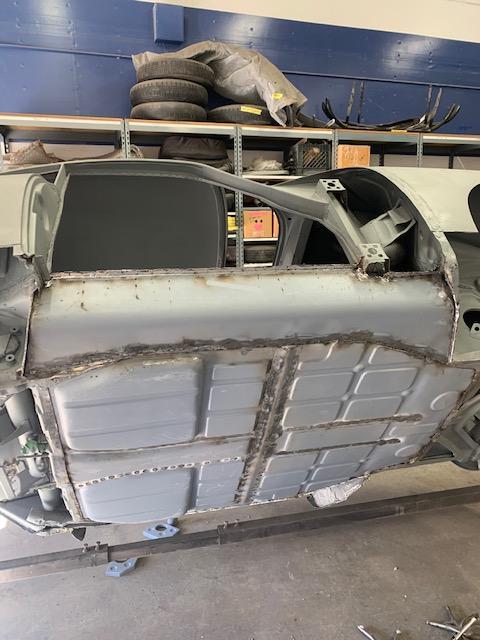

PostPosted: Sun Mar 07, 2021 1:45 pm    Post subject: Re: T5 resto back on track; now I know where all that grease went Reply with quote

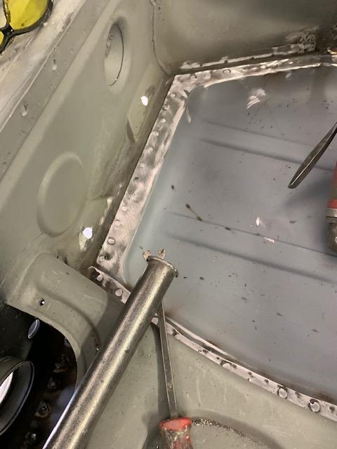

The floor pans are in, and a perimeter kit was installed.

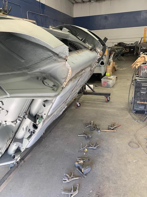

PostPosted: Wed Mar 24, 2021 6:38 am    Post subject: Re: T5 resto back on track; now I know where all that grease went Reply with quote

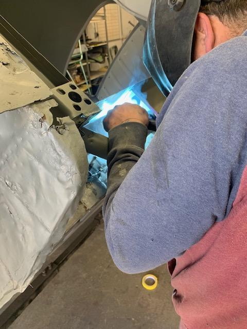

Lance and Josh are installing the longitudinals.

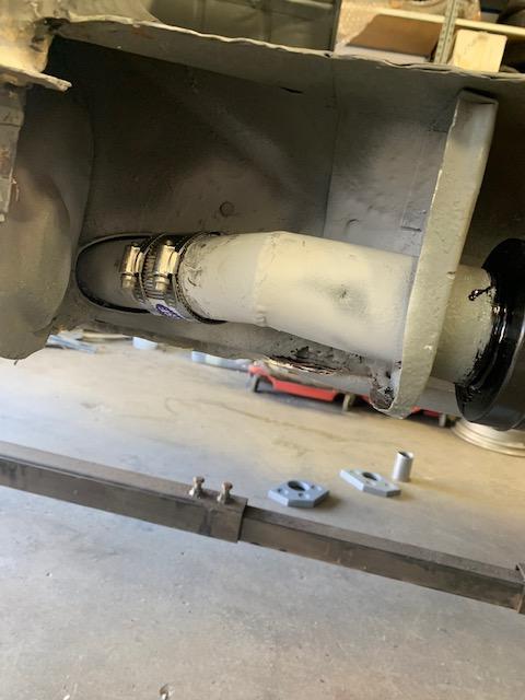

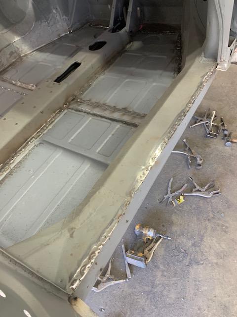

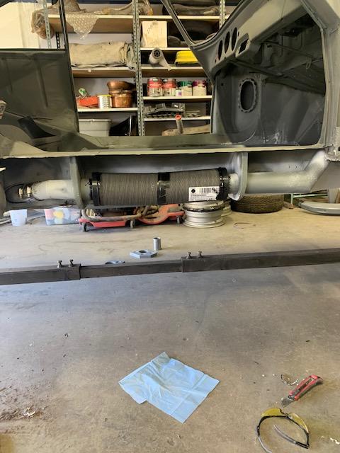

PostPosted: Wed Mar 24, 2021 11:50 am    Post subject: Re: T5 resto back on track; now I know where all that grease went Reply with quote

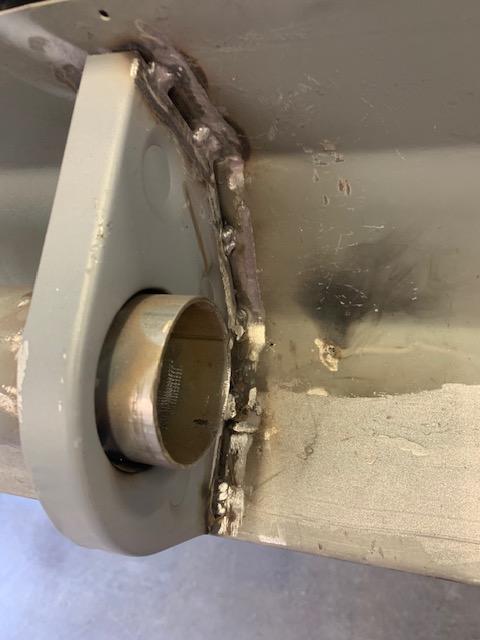

Repairs were necessary in the longitudinal area.

PostPosted: Wed Mar 24, 2021 2:50 pm    Post subject: Re: T5 resto back on track; now I know where all that grease went Reply with quote
William,
Very tidy work indeed, you have some real craftsmen on it!
Also a very nice touch with the German tubing in the longitudinals.
