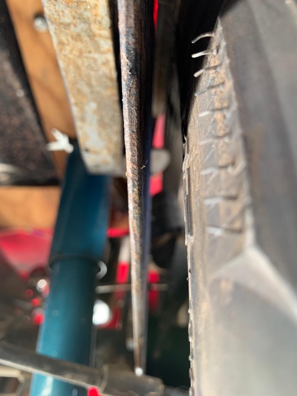

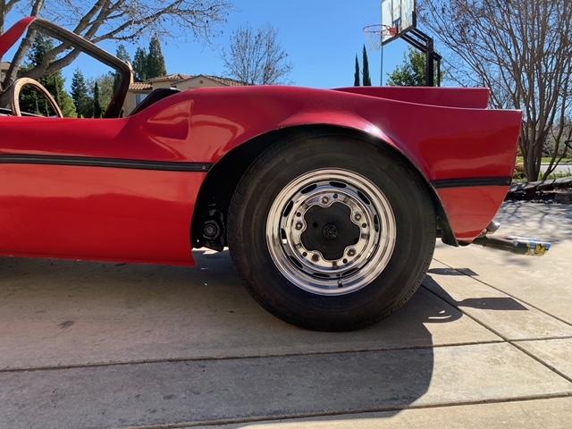

PostPosted: Sun Feb 21, 2021 8:56 pm    Post subject: Re: Just brought home a Vopard Vokaro Reply with quote
Another day another tire comparison. In these photos I have the 205/75-15 on the rear and the 205/70-15 on the front. The front is on the 5.5.rim. I'll be sticking with all 4.5 rims for the final fit.
I obviously wouldn't drive with the tire this close. Just wanted to see how the 27" tire helps fill the gaps. If it were on the 4.5 rim and the body moved back and centered it would actually fit. Surprisingly it actually can turn lock to lock even though it's so close on the back there. It's so close but yet so far from being where I need it to be.
In the view below you can see that there is about half an inch between the 205/75-15 tire and the spring plate.
Teeroy Premium Member
Joined: April 20, 2003
Posts: 3823
Location: Eastern WA
Teeroy is offline
PostPosted: Sun Feb 21, 2021 10:02 pm    Post subject: Re: Just brought home a Vopard Vokaro Reply with quote
Ski jump faces up, not down into tunnel. Thats plenty of room between tire and springplate.Try the 165 on the front again, but adjust the beam down some. This after you get the tires centered in the openings. You could extend the front end of the pan you have instead of doing a new.

dlyle
Joined: March 22, 2019
Posts: 313
Location: Morgan Hill
dlyle is offline
PostPosted: Sun Feb 21, 2021 10:13 pm    Post subject: Re: Just brought home a Vopard Vokaro Reply with quote
I do have the ski jump facing up. Not sure if I mentioned it but this car sat for 26 years without running. Could there be something else making the shifting so stiff? If I had a stock shifter handy I'd throw that on there to see if it was better. I think I need a curved shifter though or it will hit the dash.
I may go with a slightly taller tire in the rear to fill the gap. That's a 205 on there now that is 27" tall but I may be able to get one that is 27.7" tall.
This was lowered all I dare until things are centered. I've been looking in to spacing the beam forward 1". Anybody know if there are spacers to do that?
Posts: 3823
Teeroy is offline
PostPosted: Sun Feb 21, 2021 11:53 pm    Post subject: Re: Just brought home a Vopard Vokaro Reply with quote
The picture you show, the ramp is going down into the bole on the driverside, its supposed to stick up and be on the passenger side of the hole
Posts: 3823
Teeroy is offline
PostPosted: Sun Feb 21, 2021 11:58 pm    Post subject: Re: Just brought home a Vopard Vokaro Reply with quote
You will need to cut the frame head off, they make castor shims, but they are only about 1/4" thick

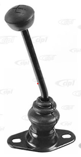

NJ John
Joined: September 21, 2007
Posts: 2792
Location: HdG, MD & NJ
NJ John is offline
PostPosted: Mon Feb 22, 2021 6:27 am    Post subject: Re: Just brought home a Vopard Vokaro Reply with quote
That’s a Sparkomatic shifter. Lots of pics in the gallery and probably forum topics, too.

dlyle

dlyle is offline
PostPosted: Mon Feb 22, 2021 9:25 am    Post subject: Re: Just brought home a Vopard Vokaro Reply with quote
That was a picture of how it was installed wrong. I talked about that in the in the post above where I had the picture... Smile

PostPosted: Mon Feb 22, 2021 9:29 am    Post subject: Re: Just brought home a Vopard Vokaro Reply with quote
Teeroy wrote:
I had a shifter like that in my old buggy when I cirst got it, was terrible. You can use a stock shifter, just heat it and bend to fit. You can shorten it too if needed, to make it cofortable.
Yeah, need to try something different and that will eliminate or confirm where the problem may be.

dlyle
Posts: 313
dlyle is offline
PostPosted: Mon Feb 22, 2021 9:35 am    Post subject: Re: Just brought home a Vopard Vokaro Reply with quote

dlyle
Posts: 313
dlyle is offline
PostPosted: Mon Feb 22, 2021 9:39 am    Post subject: Re: Just brought home a Vopard Vokaro Reply with quote
Teeroy wrote:
Not a stiffness problem, but a lot of shifting problems on shortened pan cars come from the end of the shift rod not getting clocked correctly in the shortening process
When I had the shifter out it seemed like the shift rod in the tunnel went side to side easy enough. The shifter out of the car moved easily side to side too. When I bolted it back up that seemed to be where I got the binding. I'll try and find another shifter and see if it has the same problem.
It seems like lots of people of had problems with this kind of shifter. Assume they have to be installed right or they can cause problems. What's a good shifter to use.....preferably with a bent handle?
dlyle
Posts: 313
dlyle is offline
PostPosted: Mon Feb 22, 2021 9:50 am    Post subject: Re: Just brought home a Vopard Vokaro Reply with quote
That's it! I noticed mine did not have the FV on the side so it must be the Sparkomatic. Thanks for the info!
