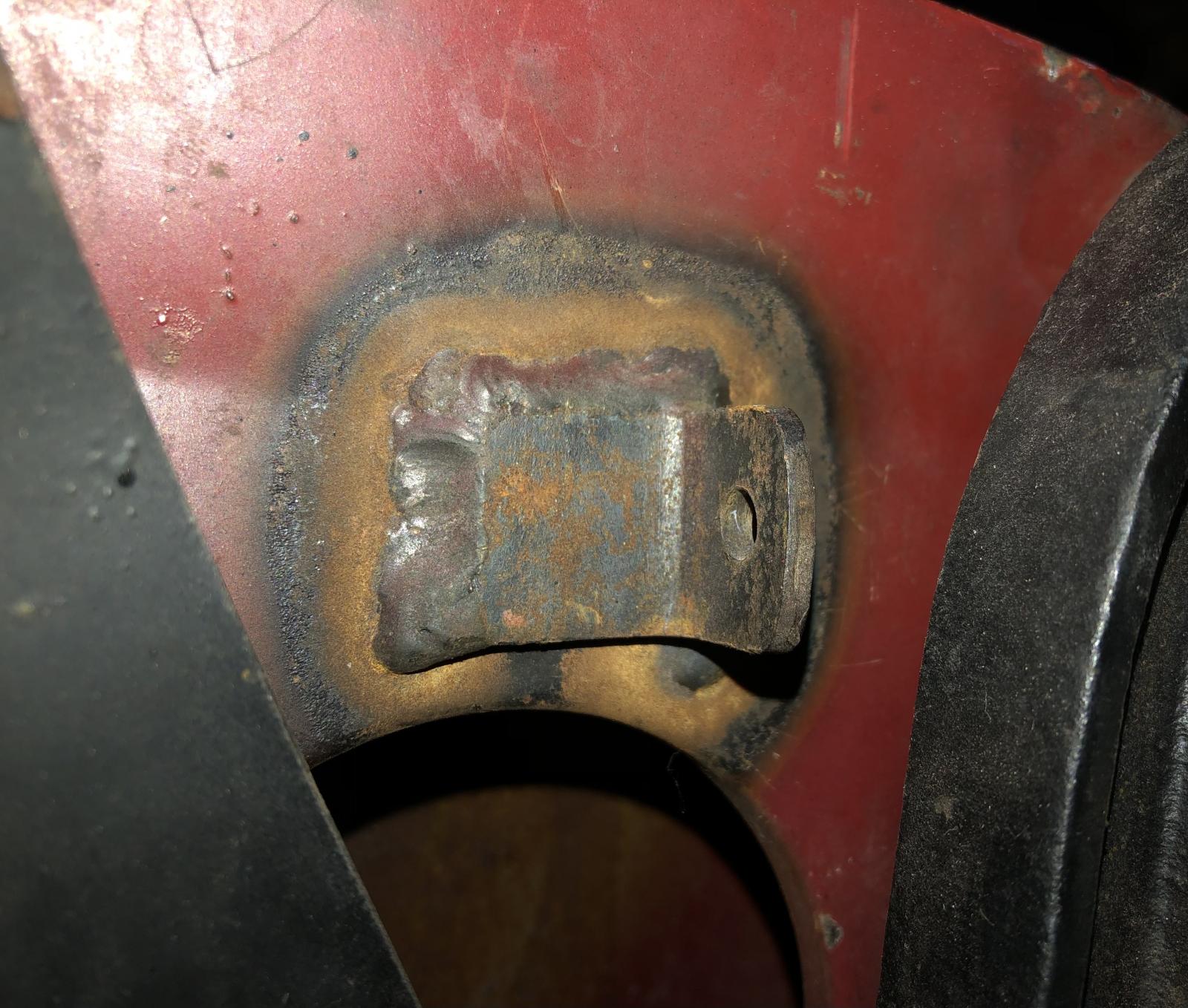

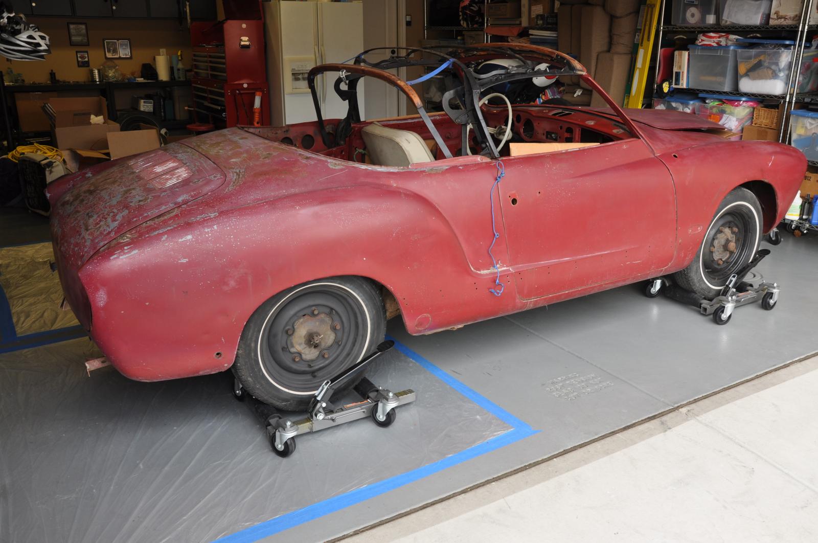

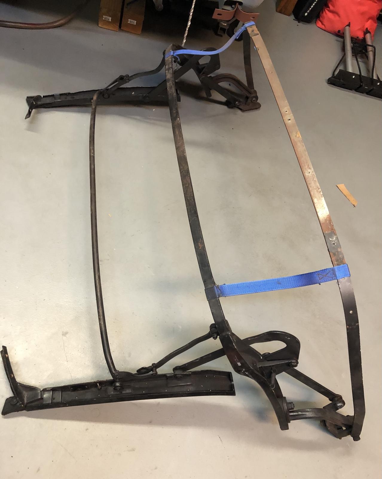

Starting a new thread about a vert top issue/mystery after some folks caught some issues while responding to another post. I really need expertise to figure out the issue and correct it before going to body and paint. The history behind the car is it was a 63 vert basket case and was not a complete car when I bought it. The prior owner was converting it to a glass rear window car and did some modifications, but never finished the job and it sat for 20 years unfinished. I am now finding and fixing the issues, but need help identifying what should be there and what should not so I can return it to 63 correct and buy and install a plastic window top.
The PO removed the parcel shelf and did other modifications to accommodate a glass window and top, so my questions are the following:

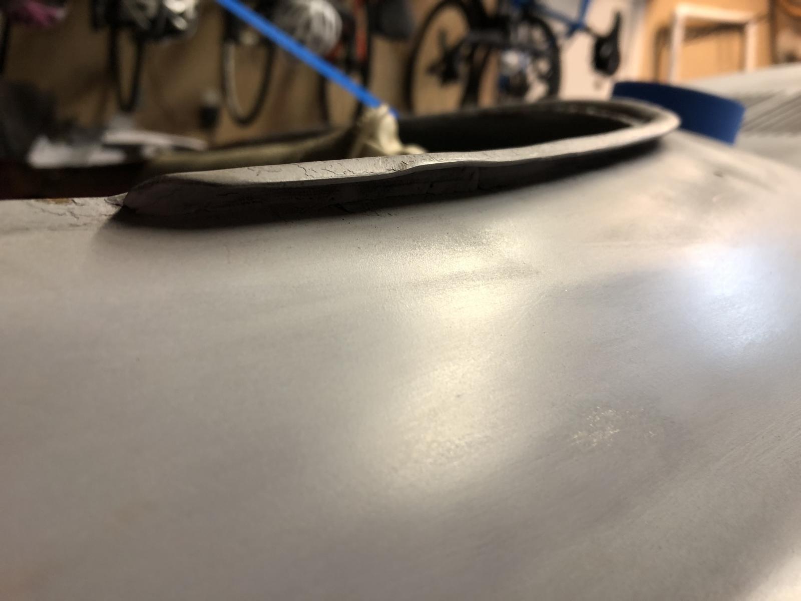

1) should a 63 Ghia vert have a lip around the rim of the rear window for a tension cable to mount the top? I saw video of a glass window install where the lip was required, but don't think I need it for a plastic window top. I've included a pic of my car with the lip in place and a pic of the donor parcel shelf from a car which did not have a lip for the top and should be from the same period as mine. I'm going to reinstall the parcel shelf you see in the pic.
2) Does a 63 vert need cable tension mount points inside the cab to tension the cable that runs through the lip you see in the pic which is used for of a glass window top. I am under the impression that lip and mount points are not period correct for a 63 or needed for a plastic window top, correct?
3) I believe my top frame is correct, but was tweaked a bit to accommodate the glass window. Looking at the windshield frame, see pic, and my wood bow and locking mechanism I think I'm good there, but it appears he changed the strap and the spacing at the rear of the frame. I do have the wood bow that goes over the rear bar, but not pictured in all the pics. Any feedback about the frame besides the spacing and incorrect strapping?
4) Anything else I need to look for to confirm I have what I need to correct the car to accommodate a new plastic window top?
5) Is there any Ghia experts open to getting on the phone with me for a video walkaround of my car who can help me determine what I need to fix to properly install a plastic window top after installing the parcel shelf?
Apologies for the long rambling post, but looks like I've opened a can of worms and could use some help. THANKS in advance!!!!

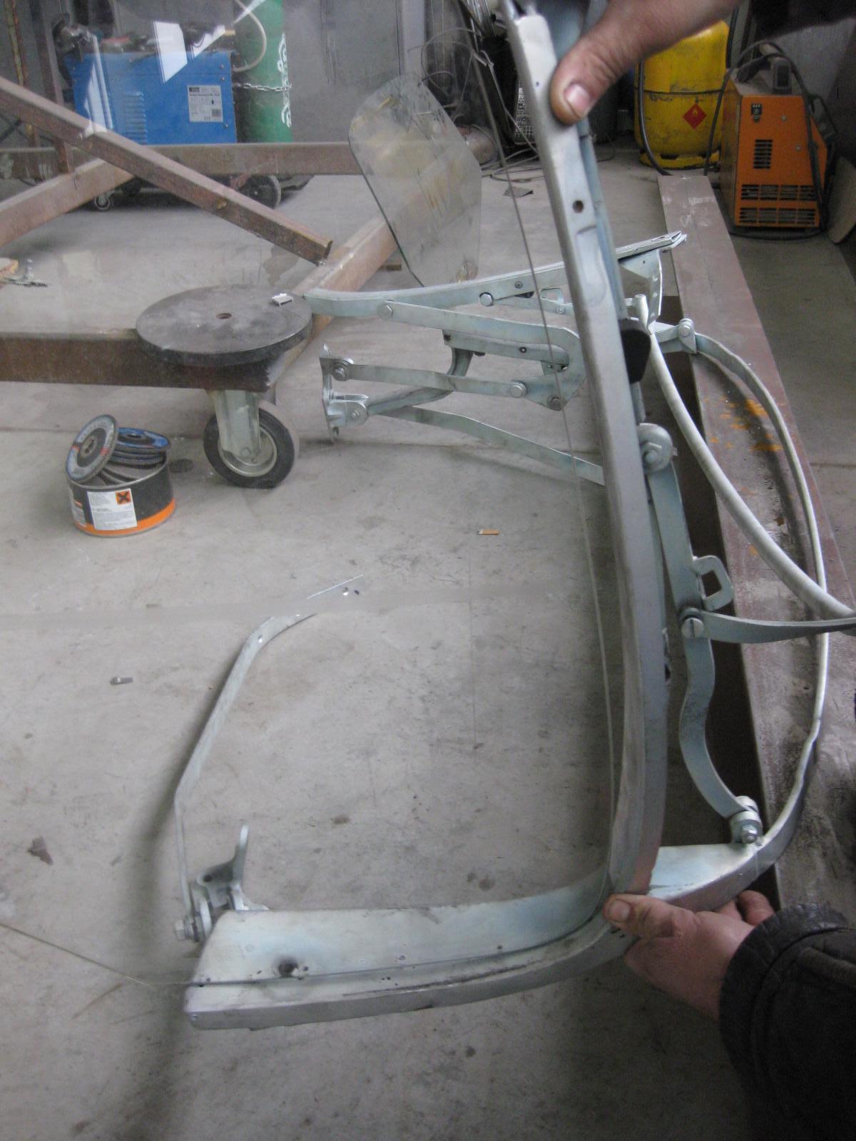

If you look at these pictures, you can see that the rear bow which is laying on the floor is made of two side pieces and the middle part is missing. The side pieces have bends in them. I suspect the middle part (not shown) is wood, but have not found a picture that shows it. The rear bow you have looks like the newer bow for a rear glass window. You likely will need to find the original early bow.

Any feedback on the rear lip that is in place which I don't think is necessary?
That lip is not correct for a '63. That feature was introduced part-way thru the '67 model year when VW started using a cable to attach the lower edge of the top to the body of the car. Prior to that, a wooden tack strip was installed around the rear opening, and the lower edge of the top was stapled to it. I'm re-posting my photo from your other thread showing the tack strip partially installed in my '67. The top frame shown here is exactly the same as the one originally fitted to your '63.

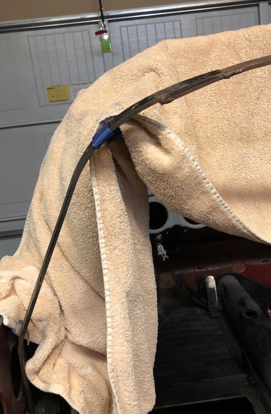

took a closer look at my vert top frame and think it may be the correct rear bow frame with a meal strip welded in between the two arms to stabilize it. Looking at the close up it looks like the end is tapered and the wood bow appears original and would fit with or without the metal brace. The PO had the latch for the glass window mounted on it which would make sense why he stabilized it. Do any of you who know early Ghias can tell if those rear bow frame arms look correct if the brace wasn't there?

Your entire convertible frame is correct exept the welded part on the last bow. Remove the added piece of metal and clean the welds. Cant say nothing about the wood on tne bow cause photos doesnt show enoght, but these wooden bow are different in shape - glass and plastic window bows are different in shape and size.
There's a lot that can go wrong with the top frame unfortunately. Take a look at this topic, that we help you a lot.

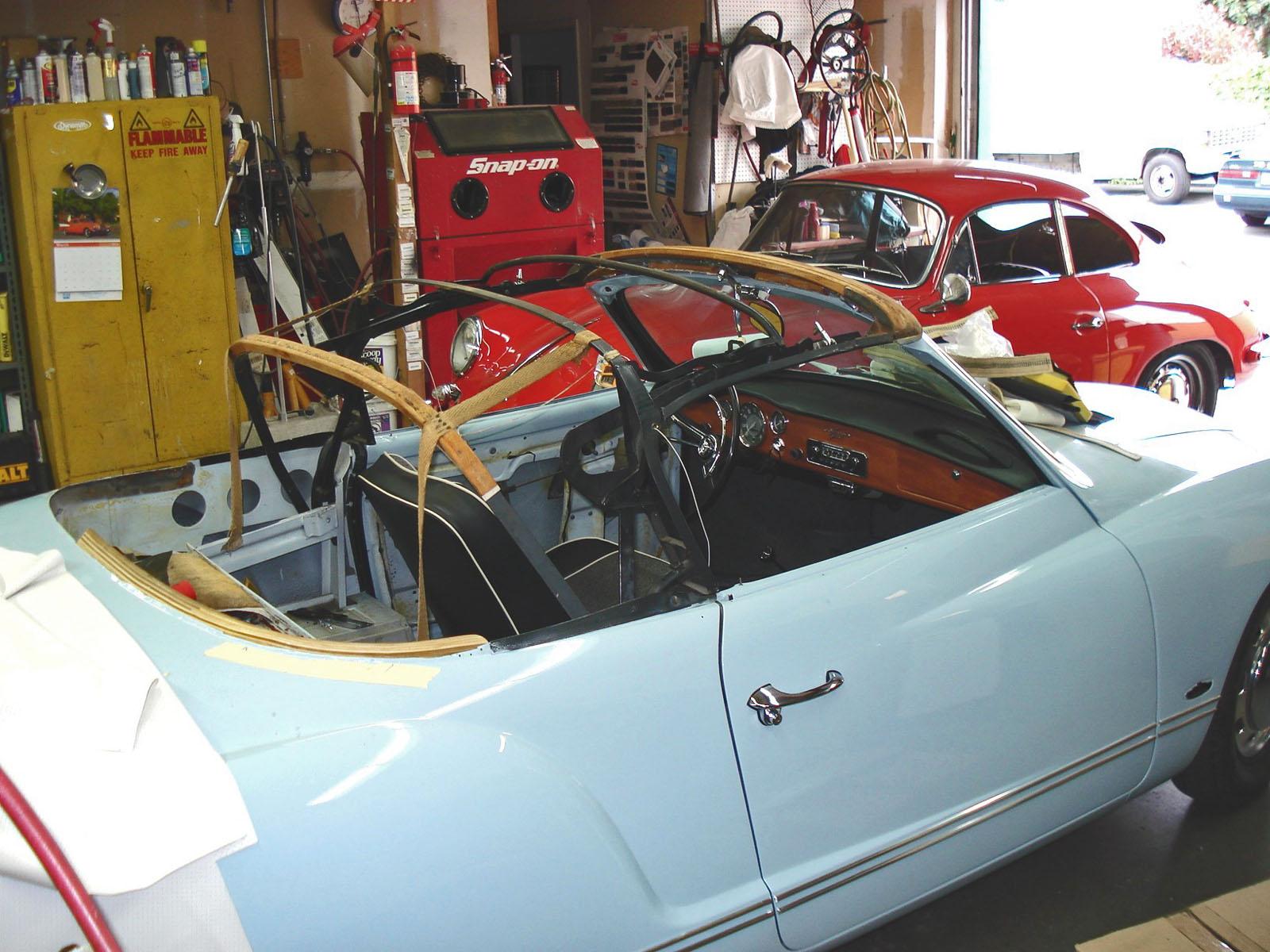

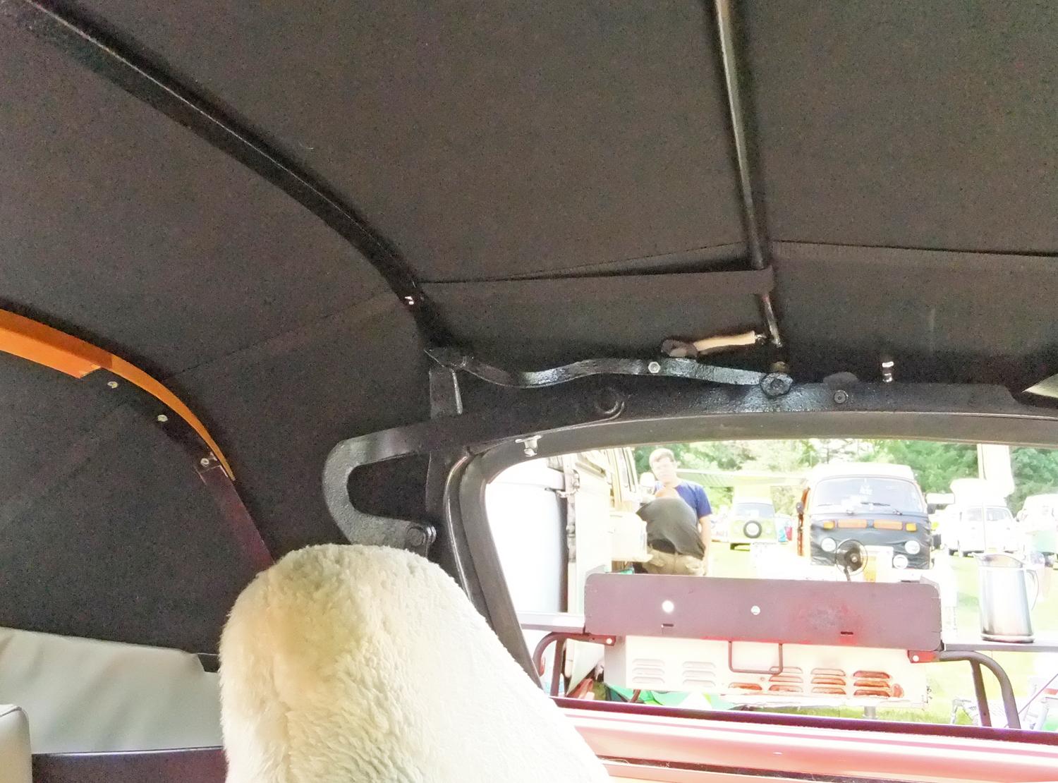

Some more photos for your reference. Here's my '64 being fitted with a new top back in 1986. The top frame is original to the car. You can see the wood rear attachment bow sitting loosely on the rear metal shelf. It would ultimately get fastened at the top of the vertical metal piece on the body, as partially seen on rcooled's car. Also you can clearly see the shape of the body lip edge. Your donor car piece looks correct for your '63, matching the rear bow mounting holes and the body lip shape. The large holes that are on the red paint portion of the donor piece (near body front edge, just to the rear of where the top would end) should not be there.
The wooden rear bow of the top that is fastened to the rear hoop was original and reusable.
This shot gives a slight reference as to the tapered ends of the rear hoop bow. The Ghia is a '65 and was modified on the interior to not have a headliner.
Hi Rome,
Surprising that we don't see more Ghia tops installed like this? After all, most other manufacturers of convertibles were just like this. I like the original Ghia top, but for someone who is going to simply ride only on nice days with the top always down, this is just fine and so much easier

Big Mike, I agree with Disc's assessment that your rearmost metal bow needs to have the welded-on connecting metal strap removed. That's the piece welded up from underneath here.
There should not be a spring on the original factory top, seen on the '65's "bare" inside shot.
Realize that your original Ghia top had not only a headliner, but padding for noise dampening and shaping. Those components fulfill the description of a cabriolet compared to a convertible. Leaving those parts out of the design such as your Mustang (factory) or the bare top frame of that '65 (modified) carry the description of convertible. Beetle-based cabrios as well as Ghias which were built at Karmann in Osnabrueck, Germany have the headliner and padding, so even when we casually use the word "Cabrio" it is actually accurate. The Karmann factory in Brazil also made Ghias- very, very few- but in contrast to those built in Germany did not have the headliner nor padding and are thereby correctly defined as convertibles.
