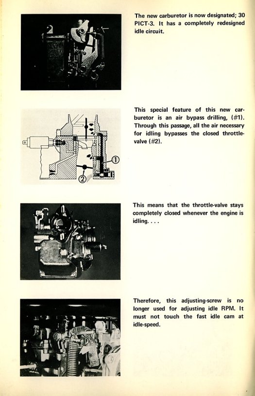

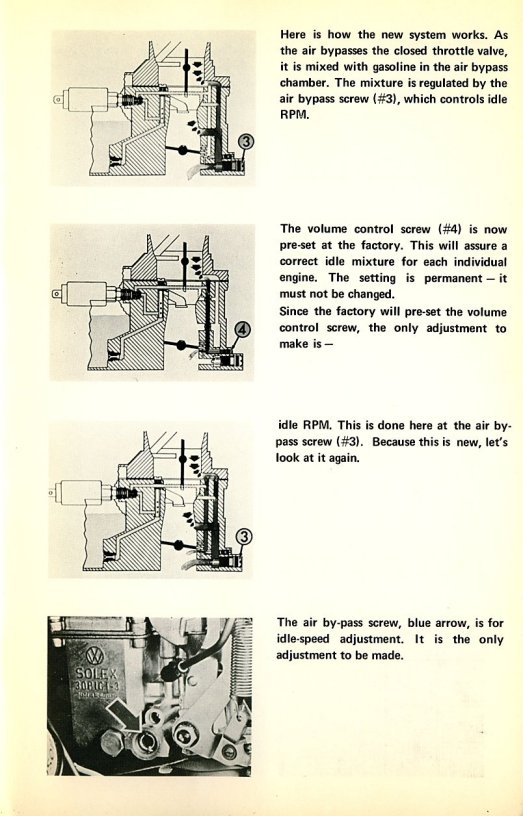

What is the purpose of the large brass bypass screw above the volume screw on passenger side of a pict 30? Thanks |

Now, there ARE NO adjustment screws on the passenger side (USA, left hand drive) side of the carburetor. As you sit in the driver's seat, one side of the car is left, the other right. You should use that as your orientation when you talk about where stuff is on the vehicle.
Now, it sounds to me like you are talking LEFT side of the carburetor, and if you have a Large Screw, that would be a 30PICT-3 or it's derivative, the H30/31PICT. (or a 34PICT-3 if you have a later engine) In all of these the big screw basically lets air past the throttle butterfly (which in such carbs, needs to be set so that it is SHUT when the choke is backed off) and functions as the idle speed setting. The smaller screw affects "some" of the idle mixture enough so to allow for emissions adjustments.

Thanks to both. Yes I screwed it up. It is on the left of drivers side of my 34Pict 1. Thanks for the help. |
