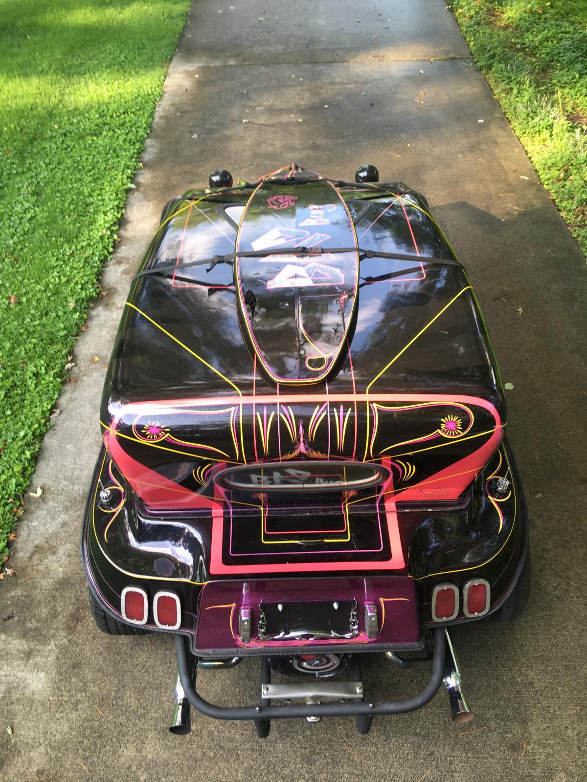

Finished the surfboard last night.

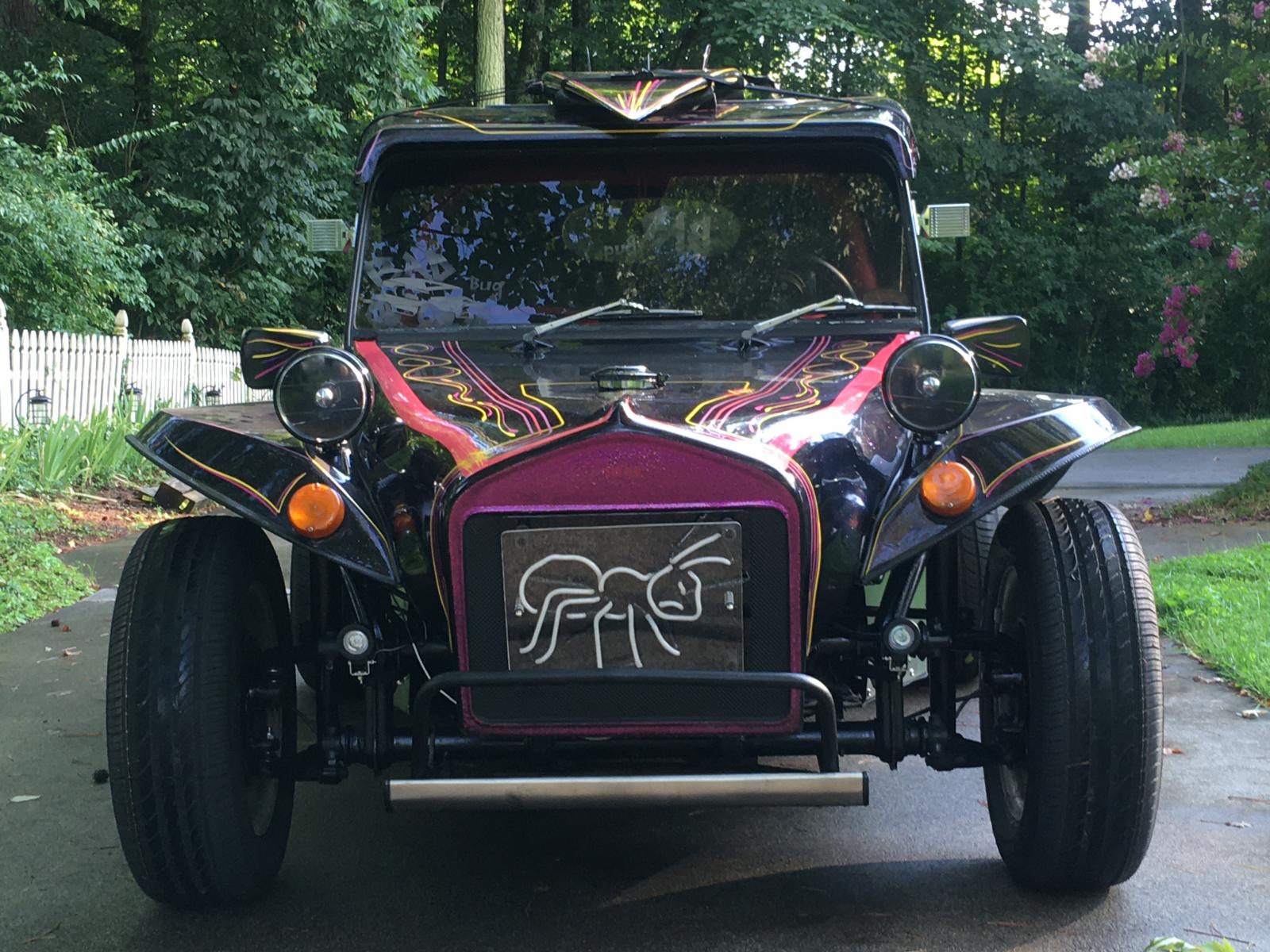

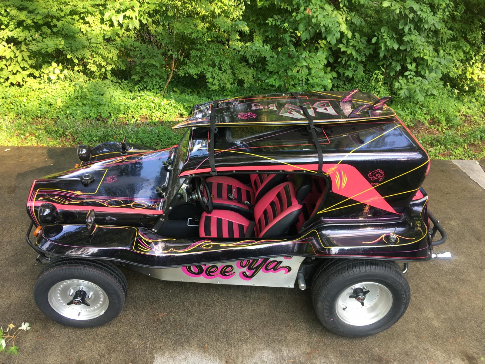

My straps Have arrived and i made some new gutter hooks to mount the board.
Between rain i took the buggy out to see how it looks with some sunshine.
I am pleased on how it looks for now.

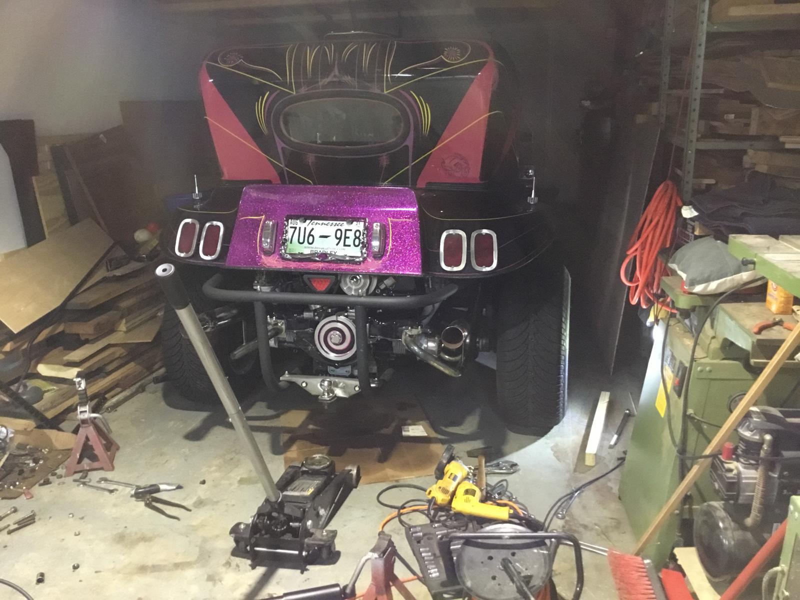

Yes. I have been doing exactly that. On my first longer drive I had my sister following me just in case. I have had some electrical issues but those are sorted out. The headlights I have are not illuminating anything so I an changing those out. Yesterday I replaced the rear shocks with air shocks to adjust the rear height. They had made some weird shock mounting points so I had to modify these to use the air shocks. They needed to have more clearance to the chassis, since the body is wider. With 20 psi the wheels are sorta tucked in and on 120 PSI nice and straight. No air management system yet. I might do some in the future. About 5" of height travel.
Sorry for the mess in the picture. I had to spread out a bunch of tools to do this. It has been raining, otherwise I'd take the bug outside for a better picture.

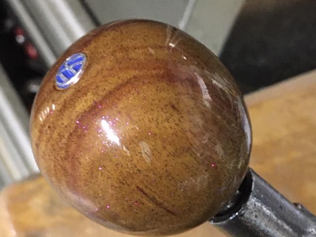

This weekend I had time to do some work. It was raining again all weekend. I Wanted to replace the plastic lower shifter cover. The shifter was missing the rubber collar and the plastic thingy never really stayed in place. I also have a rectangular neon loop that surrounds the shifter. I really wanted something of a boot and "neon tray" combined. I had ordered a generic vinyl leather grain shifter boot with purple stitching and made up some cardboard template first.
I welded some tabs to the shifter base with some threads to bold on the steel surround, added the boot and glued it to the steel plate. Now I can unbolt it from the shifter, lift it and have access to the bolts that attach it to the tunnel. Pretty please with the outcome. Also added some clear with purple flake to the knob. I did install it but it was already late in the evening. Neon sits nice on the new ledge and it is a little more cushioned by the boot than sitting on the bare tunnel.
