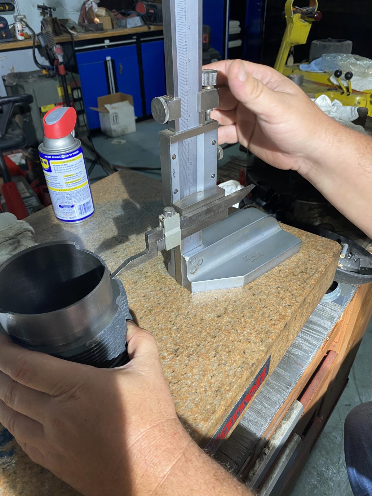

The cam is back from Web. It looks great! Over the next several days, weeks, months - whatever it takes, I hope to be able to start putting this thing back together.

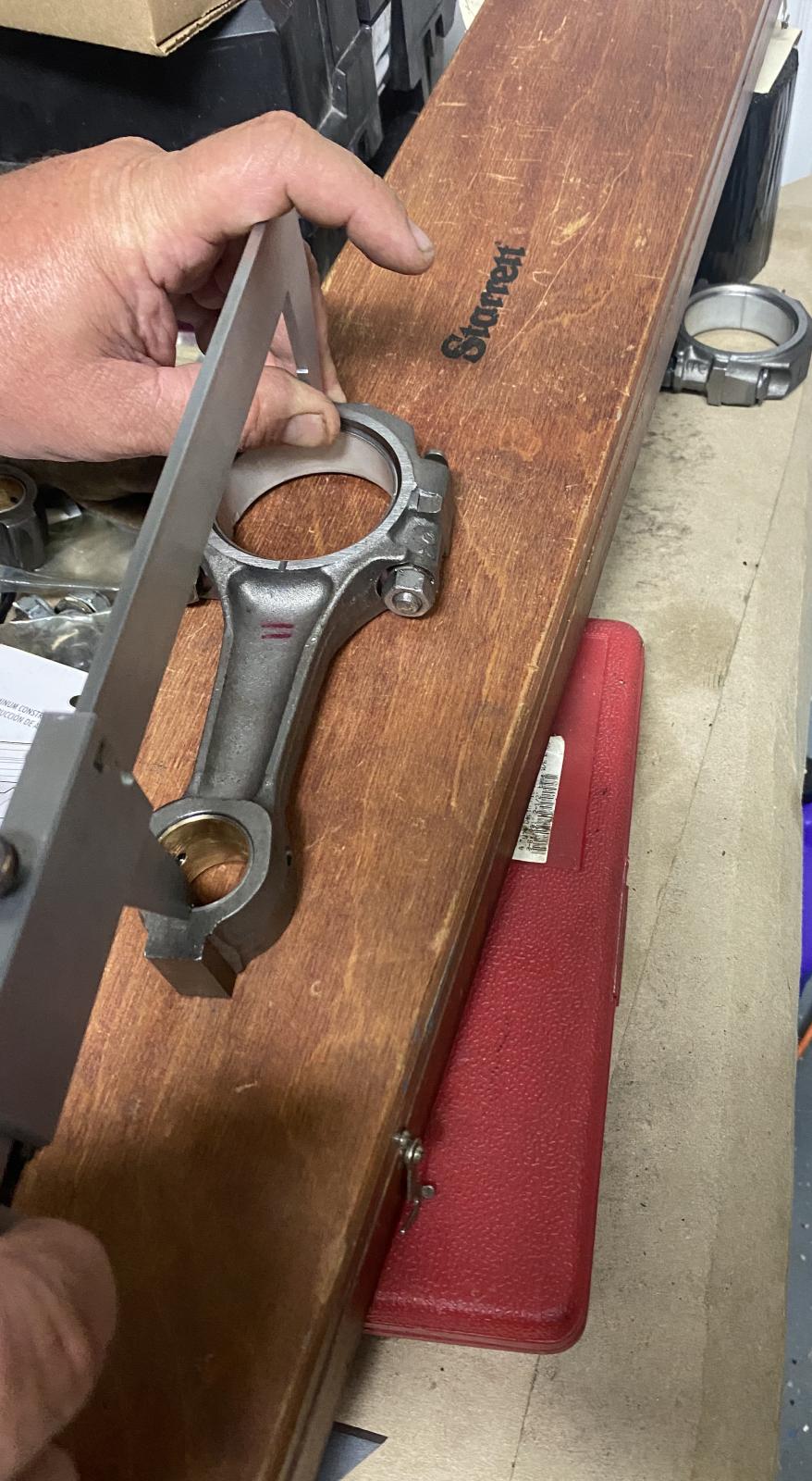

Before I do, I thought it prudent to measure everything, as I had a little difference in the deck height, on the #1 cylinder, as seen above. I spoke to Rocky and he suggested that I measure everything. So, that is exactly what I have set out to do.
First up was to measure the connecting rods:
Once again, I must give thanks for having a neighbor with a machine shop and the willingness to help me. As you can see, we measured from the outer edge of the large end, to the outer end of the small end. The bearings were in place. Readings were consistent throughout, to within 0.002" (6.552" - 6.554") all the way around.
That was day one. The next day we went back up to his shop. Just in case you've never seen one of these before, this is what a 98" Starrett vernier caliper looks like:
Whoa! Pretty amazing to be able to measure to that level of accuracy over such a large span. Anyhow, I just thought it was cool and wanted to share.

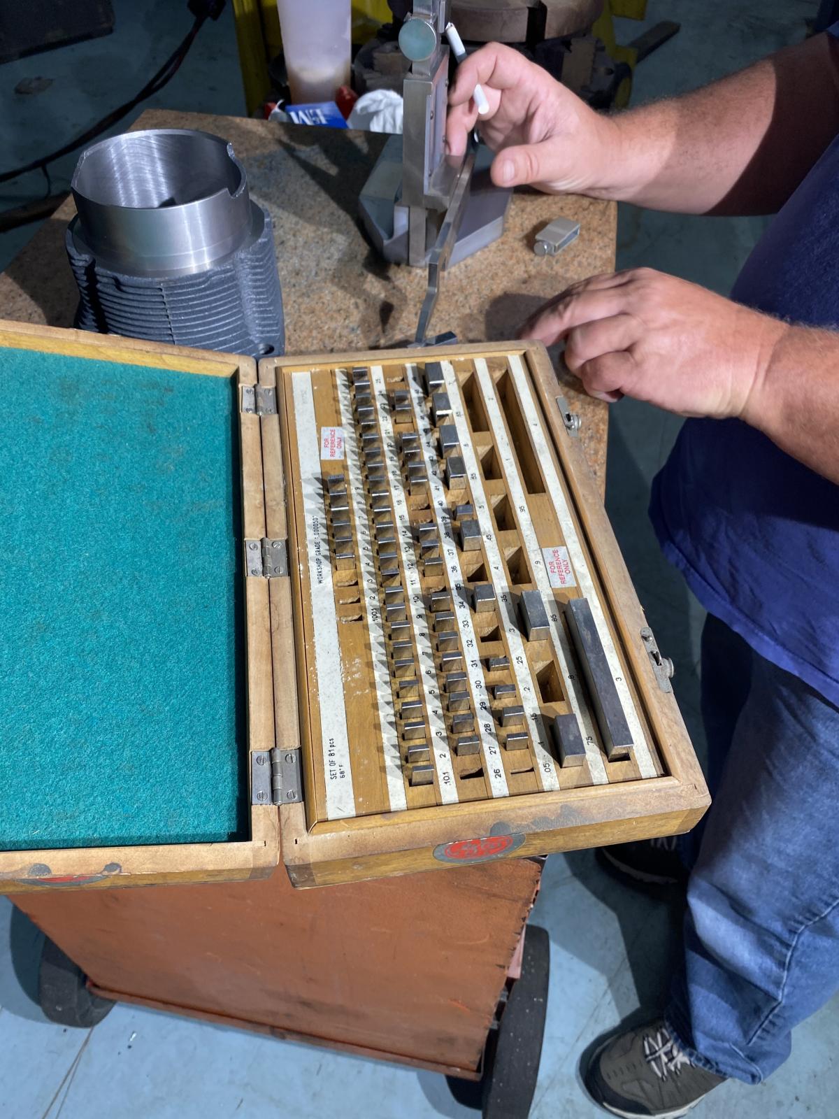

First order of business was to make sure we had the instrument calibrated for the correct height:
Time to start measuring:

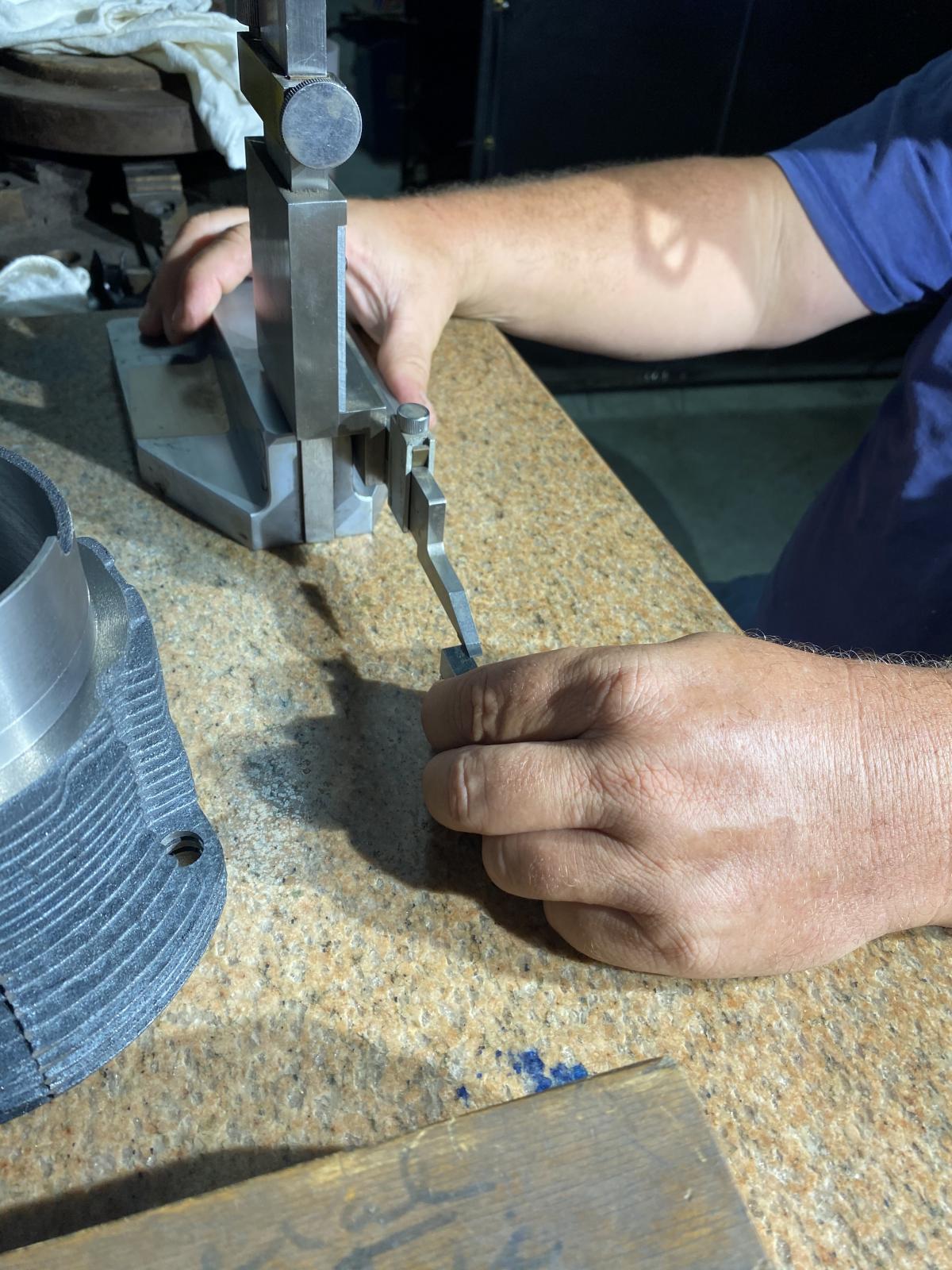

Measurements were taken at the same 4 points for each of the cylinders. The measurement was taken from the lip that the heads sit on, to the base of each cylinder, that goes inside the spigot on the case. Must confess to being pleasantly surprised with the consistency!
We also measured the pistons themselves. First up was to measure from the top of the wrist pin bore, to the the top of the piston:
We measured both sides for each of the pistons. Again, extremely consistent readings across the board. They were all 1.184"
We also measured the crown of each piston and again, they were all the same. 3.639" The skirts measured 3.661"

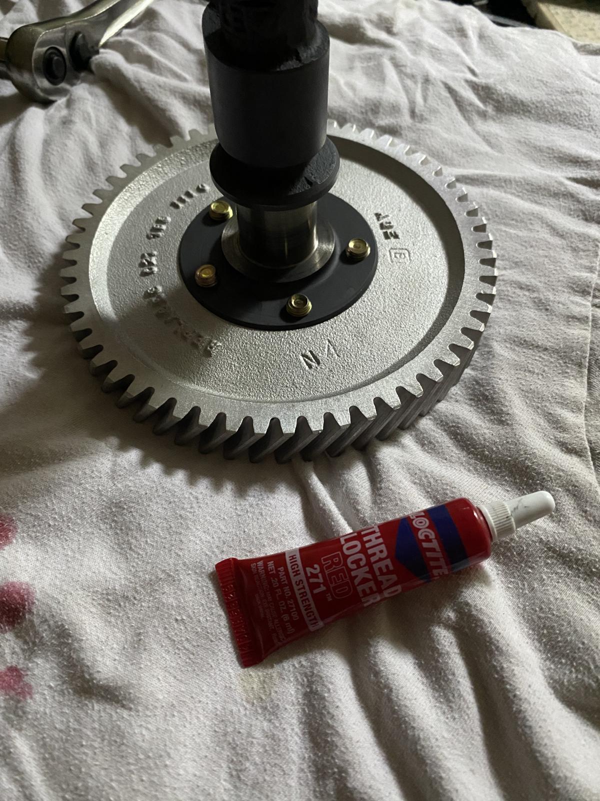

Installed the cam gear:
Per a conversation I had with Jake, I used red loctite, with no washers and torqued to 18 foot pounds.

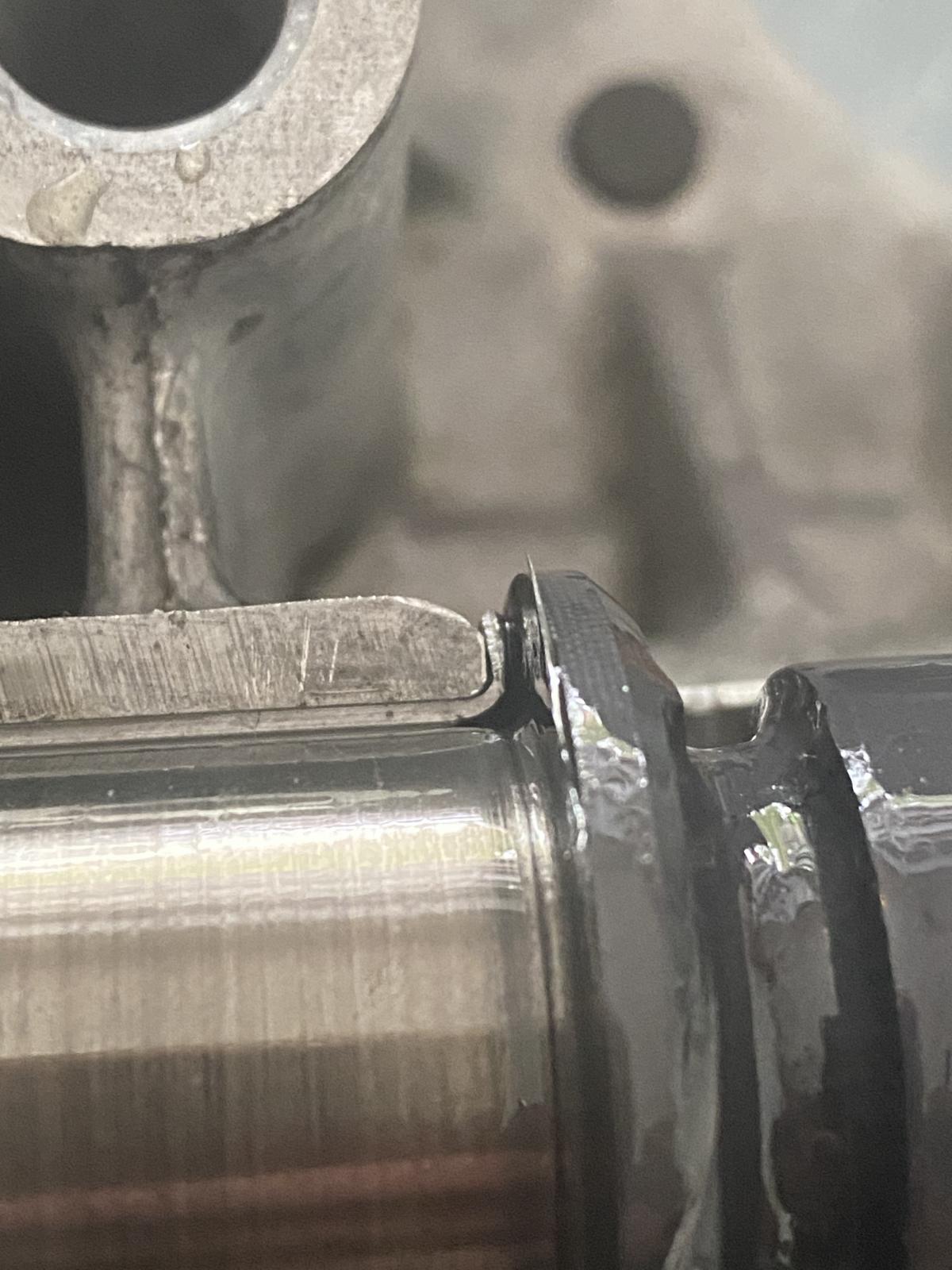

Attempted to get going again on the engine. Installed the cam bearings and the cam. As soon as I began turning the cam, I could feel resistance at a couple of spots.
Much to my chagrin I noticed some metal shavings:
So frustrated!!! Not sure where to look at this point! I've started reading a couple of the threads on cams and cam bearings. There is some parkerizing material on one of the thrust surfaces. Is this supposed to be here? Is it possible that it is uneven and it could be causing the biding? I've got a call in to Webcam. I hope to hear back from them soon. Any and all help would be greatly appreciated.

PostPosted: Mon Mar 22, 2021 3:45 pm    Post subject: Re: 1800cc Type 4 engine rebuild - 74 westy Reply with quote
From here it looks like the cam shaved those off on the way into the bearing, did you drop it in evenly?, did it require force to seat down in the bearings?, what do the thrust faces of the bearings and cam look like now?

PostPosted: Mon Mar 22, 2021 3:52 pm    Post subject: Re: 1800cc Type 4 engine rebuild - 74 westy Reply with quote
Thanks for checking in! Those shavings came up after rotation. Yes, I dropped the cam evenly, as far as I could tell. It did require a little pressure. I was so disappointed the first go round, that I tried another set of bearings. The picture above was after the second attempt. So bitter, as now I have seemingly two sets of NOS bearings that are shot. The thrust surfaces are gouged on one, and I couldn't even stomach looking at the second, so I just quit for the night. I will try to get pictures of the bearings a little later.

PostPosted: Mon Mar 22, 2021 7:06 pm    Post subject: Re: 1800cc Type 4 engine rebuild - 74 westy Reply with quote
I did the whacking thing with the thrust bearing which allowed the cam to turn freely. The endplay was still a little tight so I used a sharpening stone to adjust it a bit. I think I tried about 4 different sets of bearings. The reground stock cam I used fit fine. Maybe the webcams are a little tight. Sanding thrust bearings seem to be SOP with aftermarket cams.

PostPosted: Tue Mar 23, 2021 9:18 am    Post subject: Re: 1800cc Type 4 engine rebuild - 74 westy Reply with quote
Not really.....not until you have seated it in. Don't sand the thrust bearings until last resort. The cam needs to be rapped pretty sharply...and in both directions.
Make sure the case is buttoned completely up...all bolts...not just the six big ones.
Rap it fore and aft. Turn about three revs....repeat. Take it apart and inspect.
Each time you put it back together...you will have to repeat at least the initial for and aft rap. The primary thing that is getting aligned when you rap it fore and aft....are the open legs of each bearing shell along the case centerline.
What happens is that they twist and squirm as they make contact with each other putting stress on on the shells as they warp.
Your cam thrust surfaces do look rough. Ray
NOS bearings are on the way from Europe. I will do as you have outlined above.
Orwell84 - I guess I figured out where I'd read the rapping on the camshaft thing. Disregard the question in the PM. Embarassed Laughing Shocked Laughing
