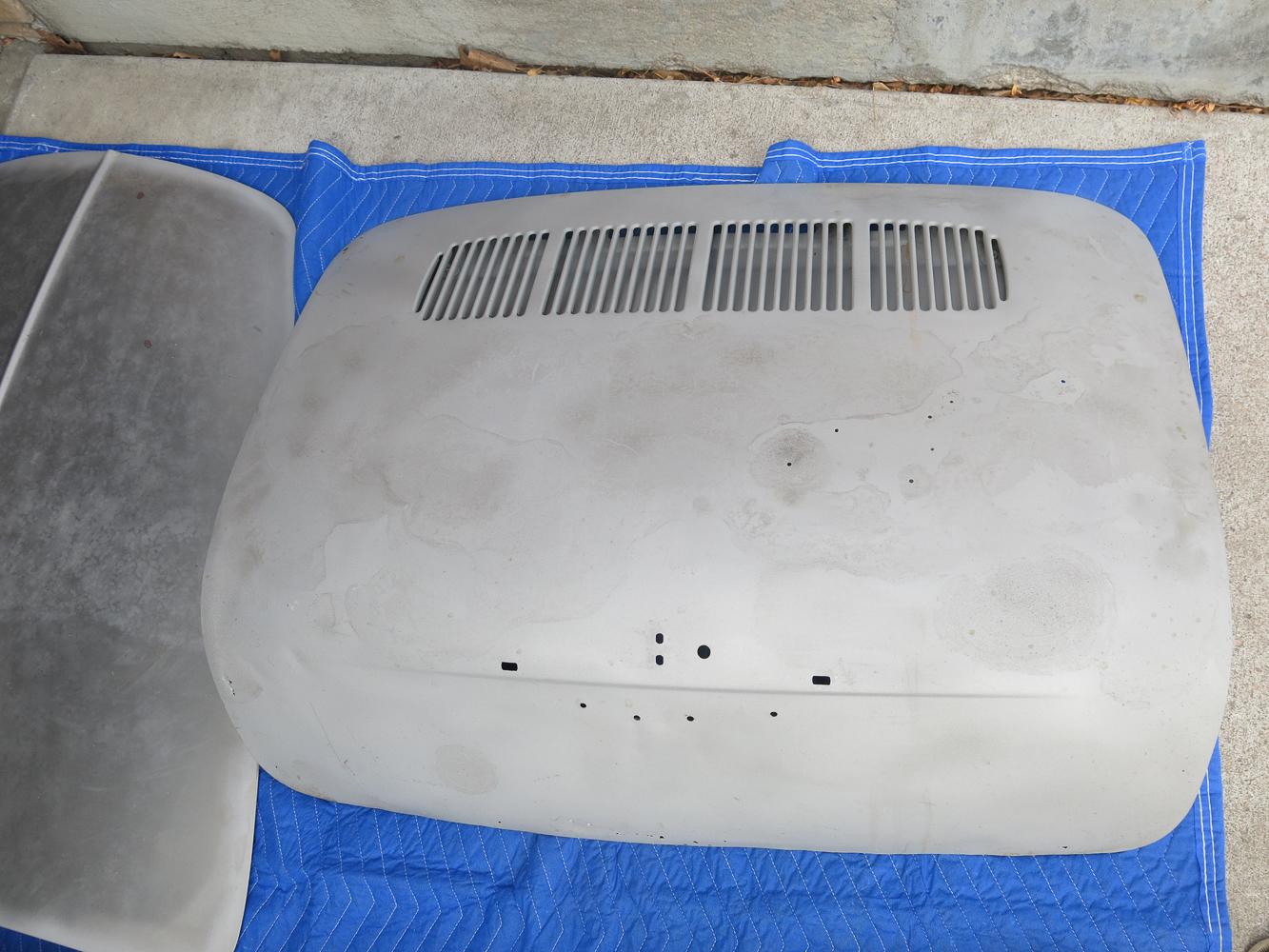

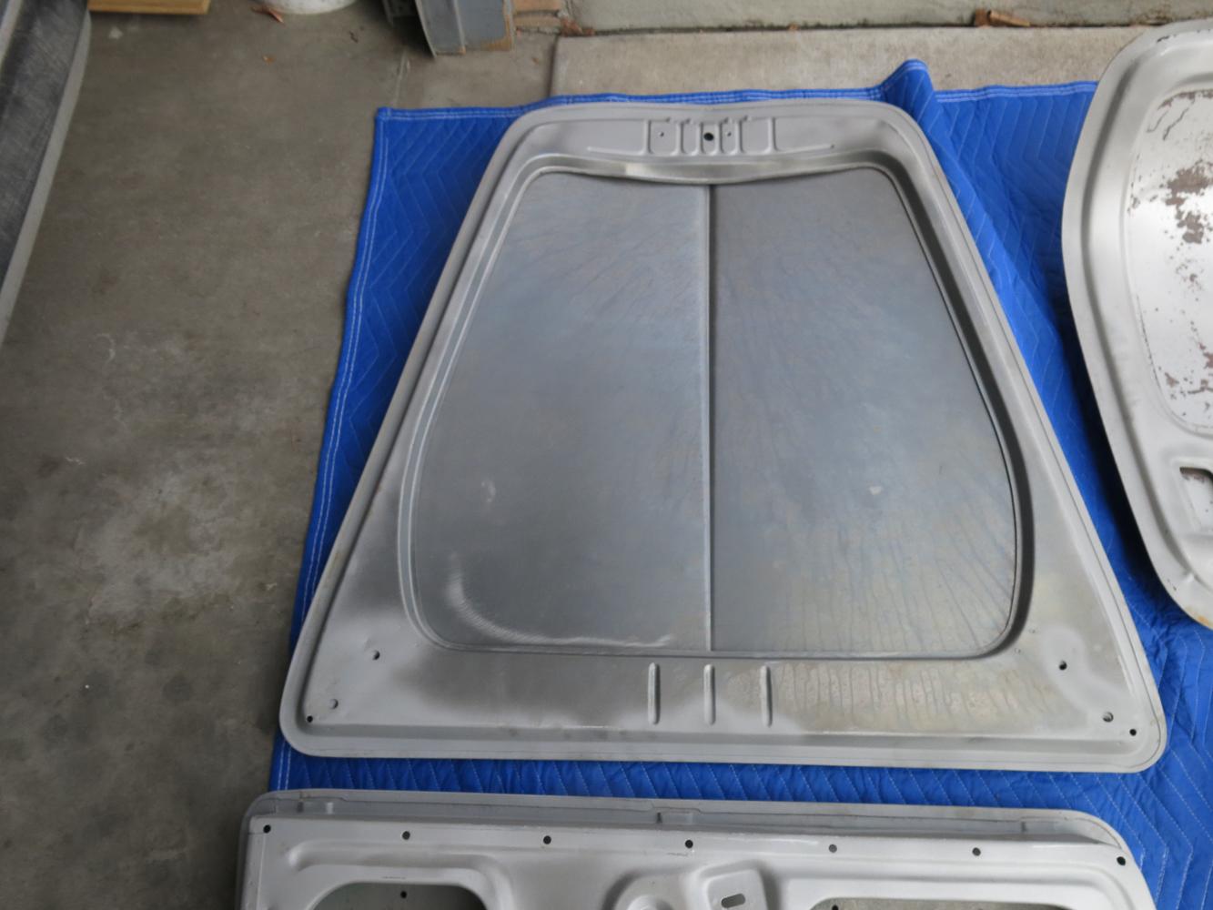

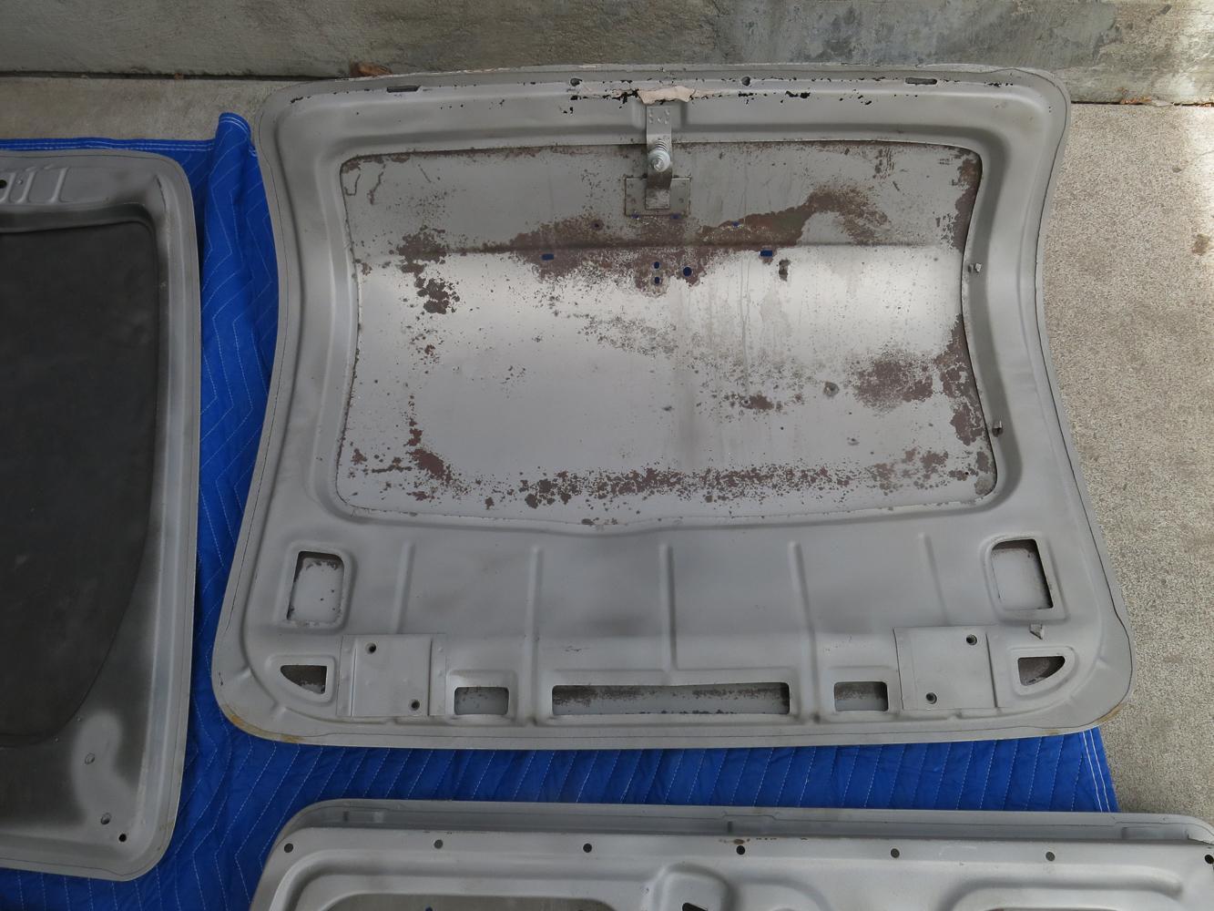

Again at risk of over saturation here is the rest of the photo collection showing other spots needing repair, etc. Thanks @c21darrel. As for what's next there is a shop in a suburb of Denver where I live called The Metal Surgeon:
http://www.themetalsurgeon.com/
I have spoken with the owner, and as in anything, I could spend whatever I have doing every repair necessary fabricating body parts and installing them. I am also so inspired by Antoine:
https://www.thesamba.com/vw/forum/viewtopic.php?t=713906&highlight=antoine
I bought arc and mig welding equipment and I am almost brave enough to go for it. First, though, I hope to go to work for the aforementioned metal working shop, and I also plan to take welding classes. Don't worry, I won't ruin the Ghia after having gotten this far. I'll let the experts either do it or guide me through it.
After metal, the car will go to the body shop and what I would like to do is have them take it all the way through primer, and then I want to bring it home and shoot the paint myself. I will probably prep and prime the hard-to-reach invisible places and the other non-essential places like the insides of the doors, etc. before sending it to body and primer. I will convert my garage to a booth for a couple of days and paint it with single-stage. We are thinking one-color or two-tone, and haven't really decided what. Latest choices are Neptune Blue body and eiter Bermuda Blue or Black top, and Castillian Yellow one-color or Castillian Yellow body and Black top. I would like to keep the interior color that it started with and I saved (pictures posted previously, light sand) and I'm not sure it would work with a two-tone Castillian & Black and Neptune & Black but I think it will work with Castillian one-color or Neptune Blue & Bermuda.

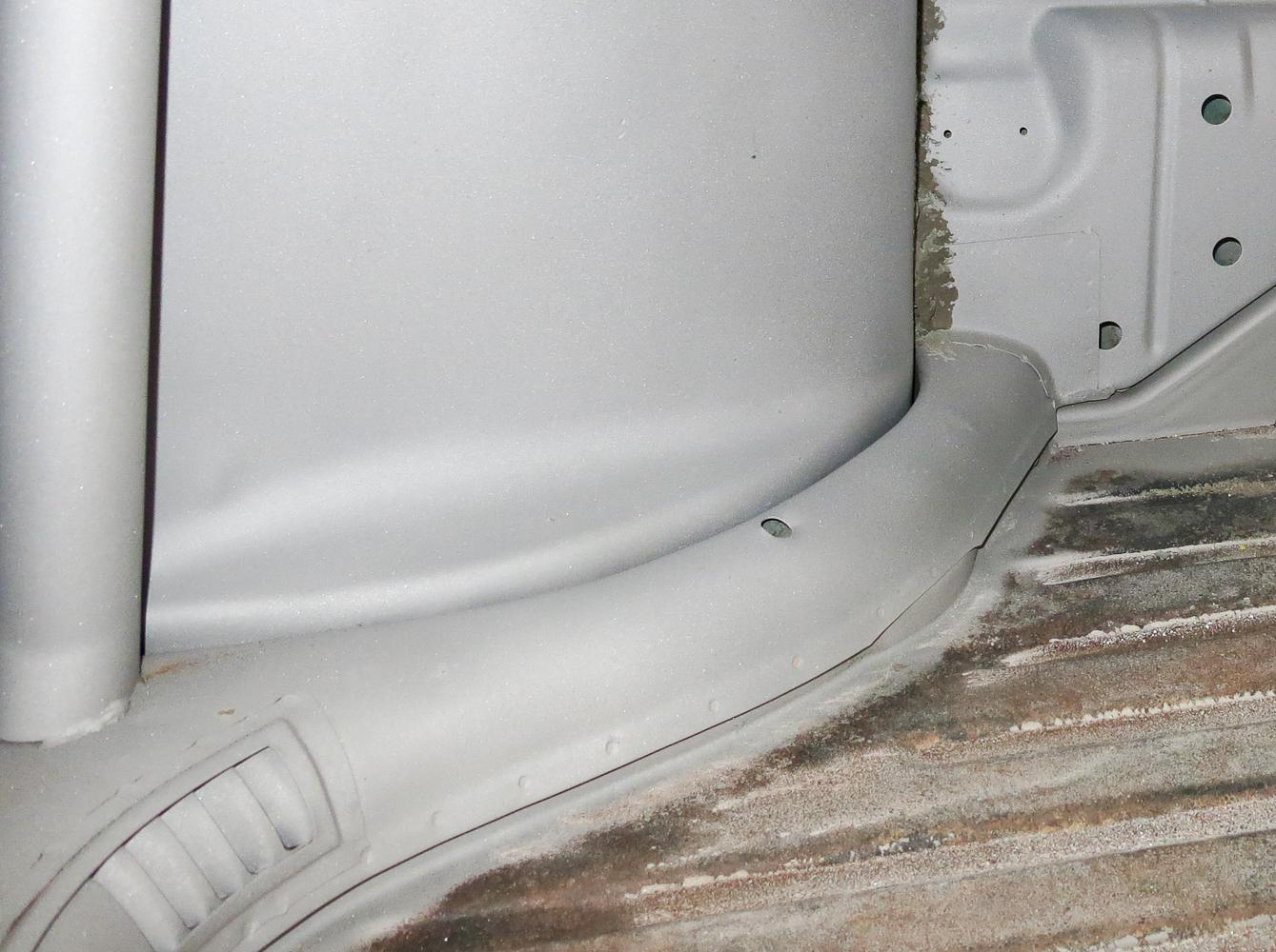

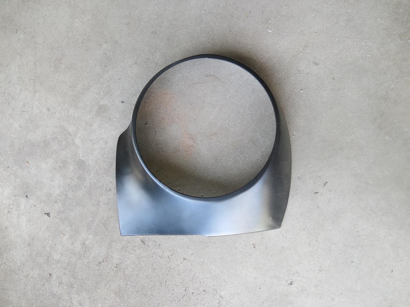

@Peter D. what exactly are the dog legs on a Ghia? I am familiar with them on a Bus but not on a Ghia. Is it just behind the door? Also I think the battery tray is very repairable - am I wrong? it doesn't look all that bad to me. As for the rear quarters you are right, they are pretty toasted. A donor body would be ideal. I have a 69 but am not sure if I want to cut it up or restore it like this one. And perhaps those sections can be cut out and new ones fabricated? We'll see.
I neglected to look carefully at the vent control and that's why the car went to the blast with it still in. I am on the road right now but when I return I will look at it very carefully. I appreciate what you are saying and will keep it front of mind. Also see the new headlight piece you sent me, and also the floor pans from Volkstory you recommended.

Dog legs on a ghia are the curved piece where your front heat outlets are.

Yeah, the doglegs are the curved end of the heater channels by your feet.
These are the one's I bought from France because I'm insane:
Your outer rocker skins look bad but hopefully you can save the inner.

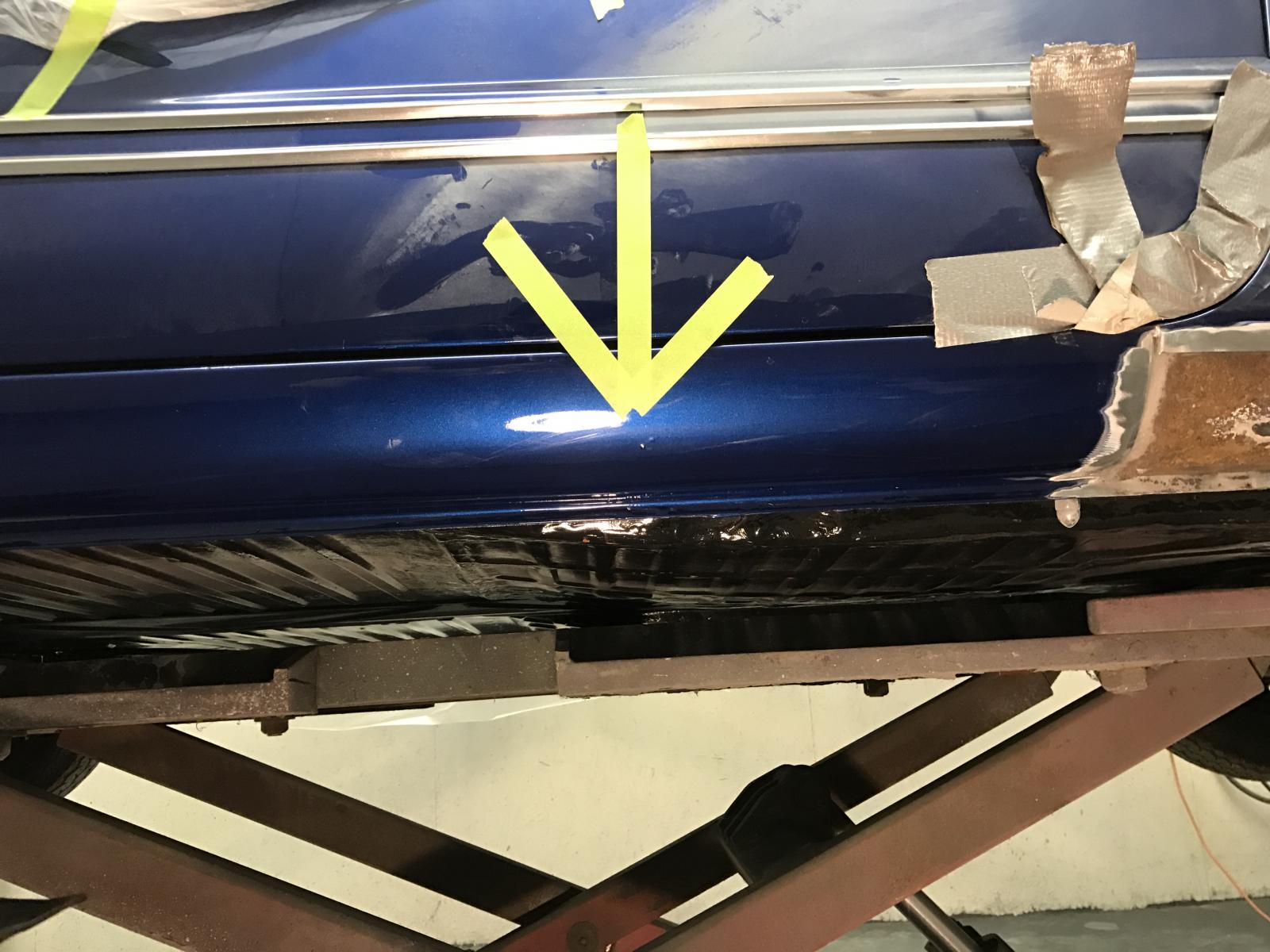

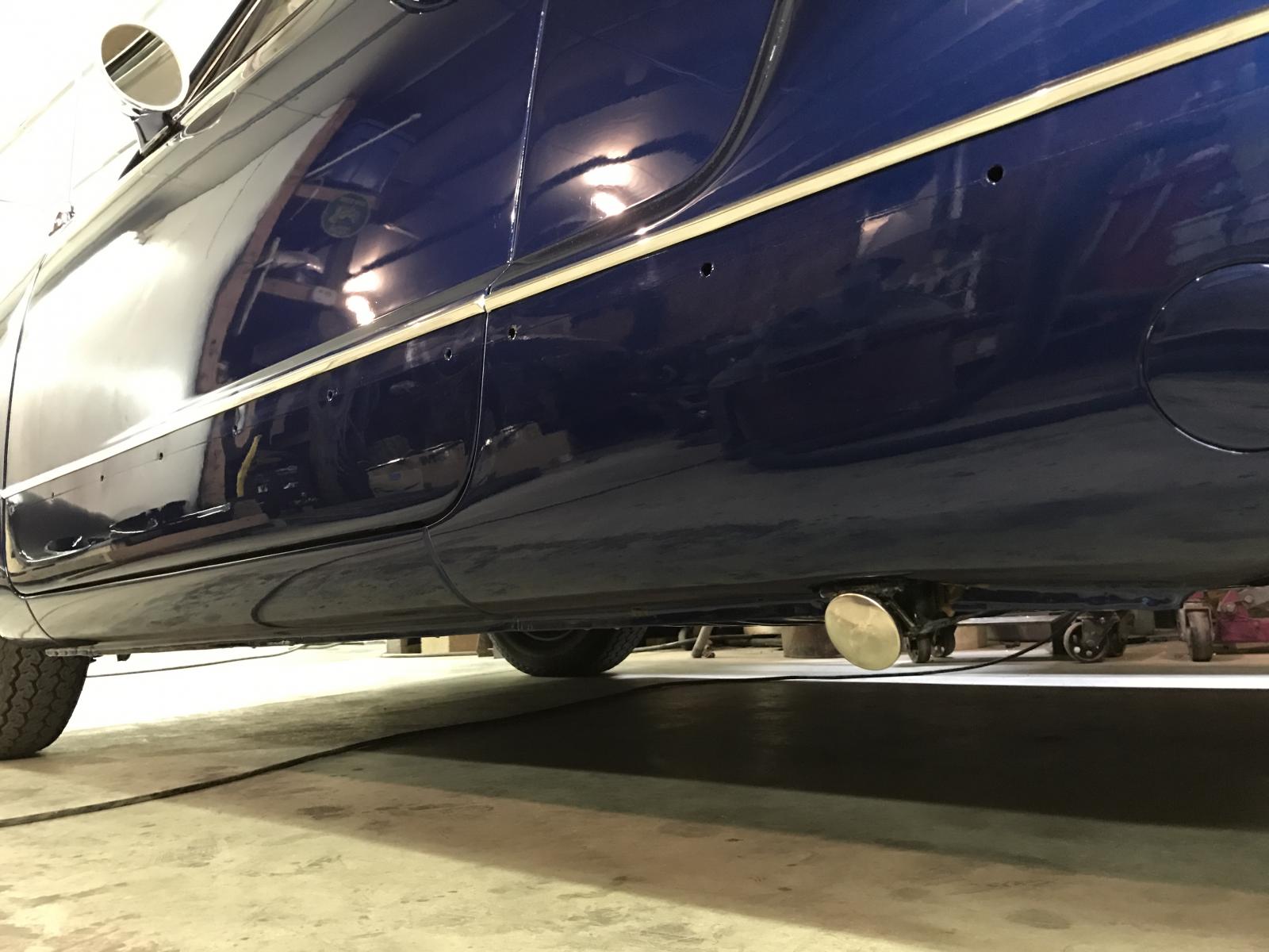

I read that you are taking care to make sure to rust treat all the inaccessible places especially rockers. That's a wise move even if they look good and corrosion free as mine did at the time.
Case in point;
My paint and bodywork was finished in 2006. The drivers side rocker started showing signs that rust was forming as the paint was just starting to bubble about 2015.
I decided to have the area repaired in 2017.
It's great you are being proactive so as to avoid this in your future
Paint bubble
Rocker full of rust scale
Completed repair

@Peter D. thank you for the pictures. It's pretty clear to me now what dog legs are! I think mine are structurally sound but I am new to this and right now I am not near the car. You all know more what you're looking at - does anyone see anything of note in these images?

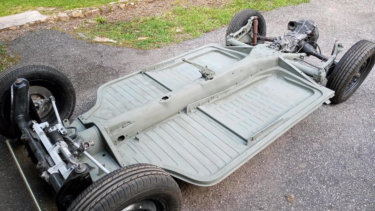

I bought the Volkstory pans as well. What I can tell you is that they fit in place with no trimming or massaging, and they look exactly like the originals, unlike the Dansk pans.
I get the argument about keeping original metal, but you're on the same bare-metal body-off path that I'm on. If there's any pockmarks or thinness to your floorpan fronts, might was well make it new while you have the opportunity. My floorpan front halves were intact enough that they could've been left alone, but they were pockmarked on the top, and I wanted clean fresh metal.
I bought the repro seat tracks from CIP1. They come with reinforcements that the originals didn't have, so you don't actually need the crossmember support piece. But if you want the crossmember, there was a Samba member who was making them last summer, which is where I got mine. Search through my old posts, I think I posted about it and no one seemed to show any interest.
Here are my volkstory pans installed with the repro seat tracks and crossmember, in primer.
