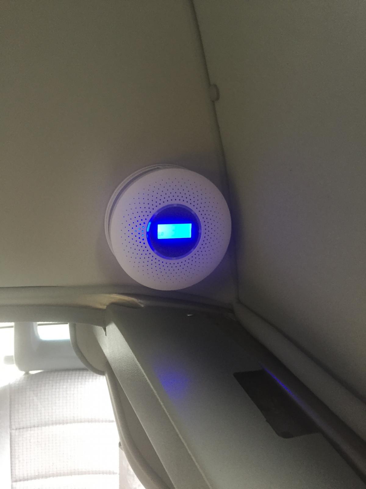

Agreed on the CO detector. You can't read the numbers in this photo but they're more informative than a binary detector.
Lighting the stove can definitely prompt a reading some times.
And to both of you, how often are you really checking the digital readout?
I’m not knockin it in any way, just trying to understand how practical it is to use and pay attention too.
Despite what follows, I'd say a CO monitor is a great of device to monitor lightly until the alarm sounds at which point it deserves some attention. The indoor/outdoor thermometer and battery volt meters get more attention. Certainly, any drivetrain monitors get much more attention.
I'm 100% certain that my experience this past year is unusual. I installed the CO detector maybe 18 months ago. I made the van my wfh office at the start of COVID and I've spent at least 250 8-10 hour days in the van since then (days, not nights). Every day I light the stove a few times to boil water to warm my coffee cup or make tea so I probably have 500 - 750 or more stove lightings while sitting in the rear bench while on a MS Teams meeting (think zoom if you don't know Teams) while I stare at the CO detector.
I've experimented with lighting one burner, two burners, waiting 10 seconds, 20 seconds, etc. before lighting the burners. Sitting in a closed van I notice it when the the CO detector reads 75 but opening the slider for 30 - 60 seconds drops the reading pretty quickly.
In short, nowadays I check it way too frequently but it's for science. When camping, I might notice it occasionally and have it provide peace of mind before turning-in (it's also a smoke alarm).
