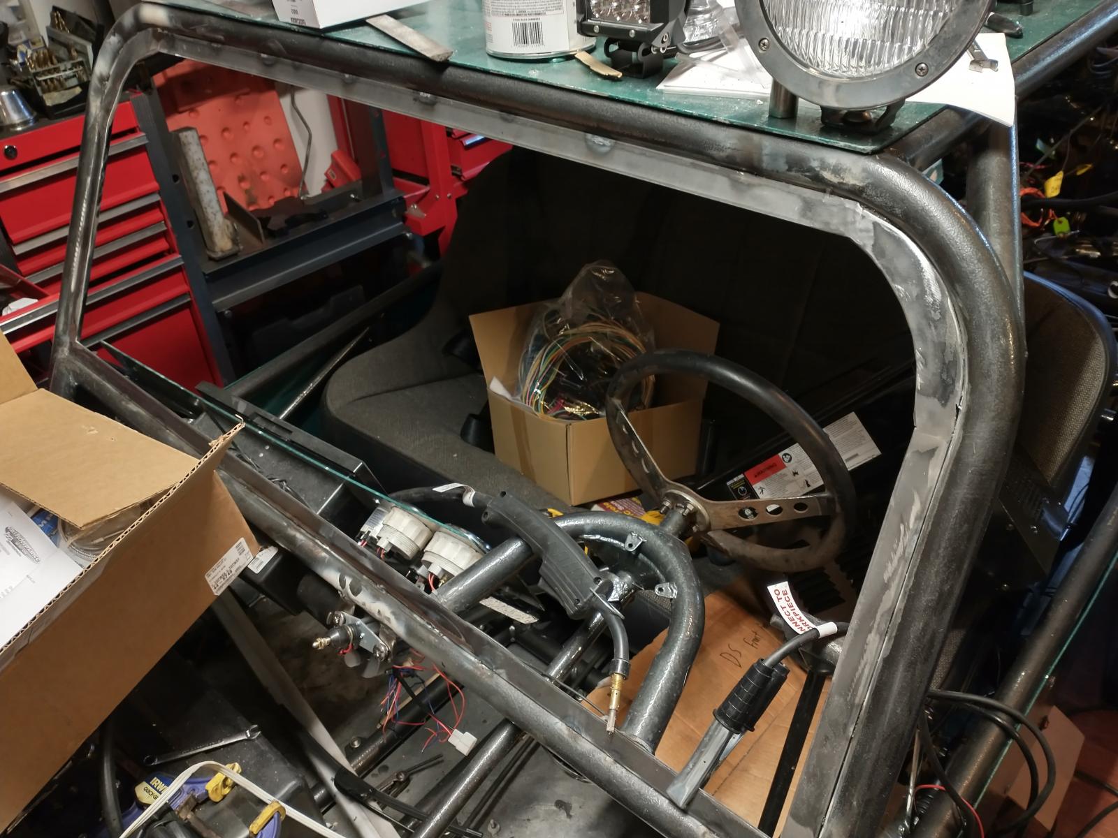

Finished up the windshield flange. My plan is to have a glass shop glue one in like a modern car. Also mounted up a utv wipe motor, looks like it should work.

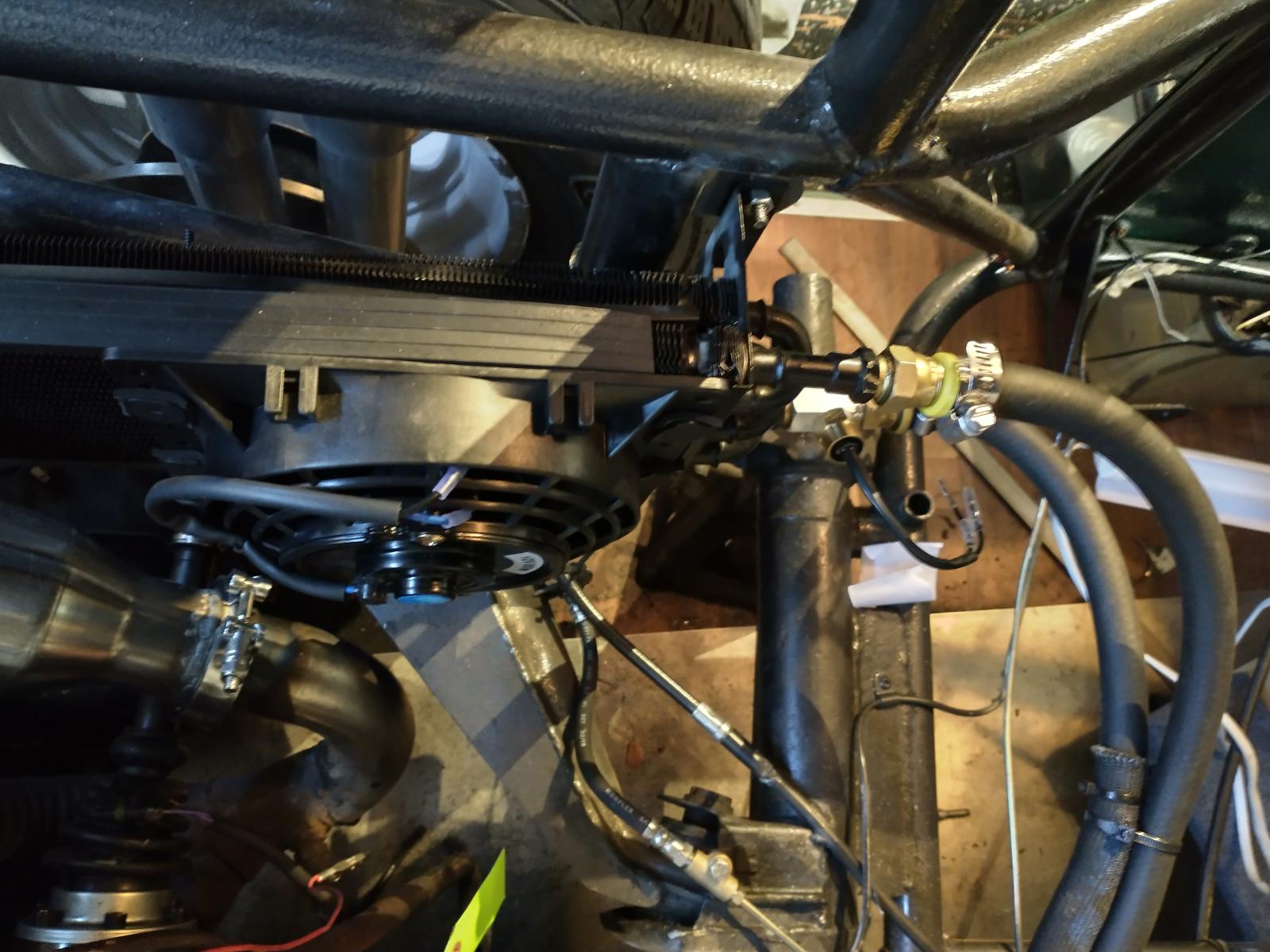

Also mounted the trans cooler fan and thermostat switch, plus mounted up a fan on the rad.
Have to get a new Engine coolant temperature sensor and I can finish up the wiring harness. Things are moving along nicely right now.

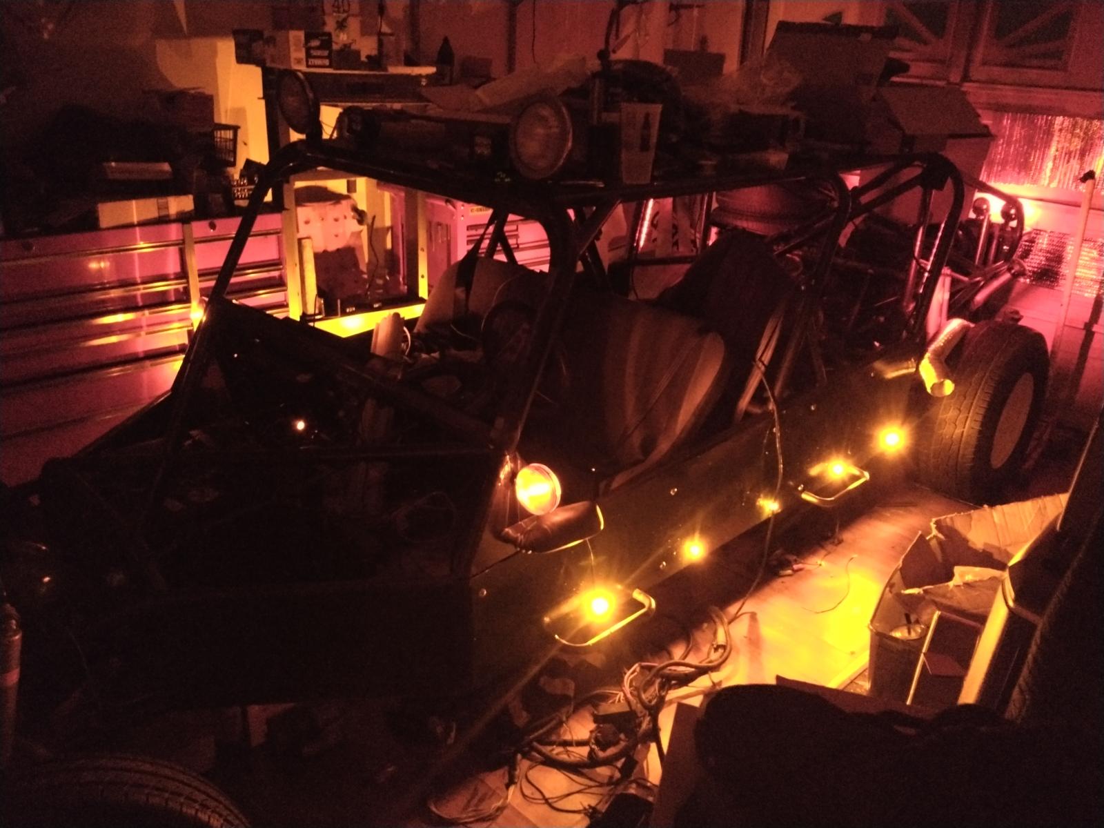

Well I'm starting to wiring up this thing. Got the reverse lights wired up and the headlights. Still a lot more to do, but it's getting closer.

Got some more wires ran. Park lights and brake lights.

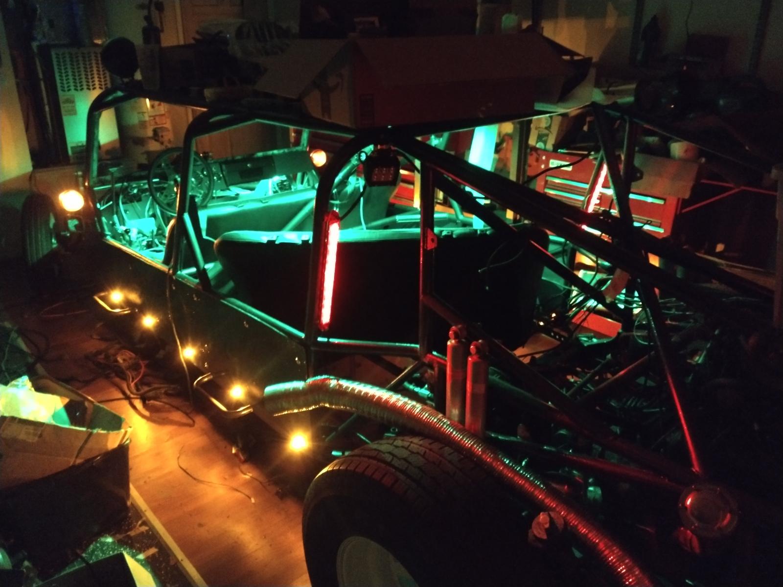

Got the turn signals wired up and the headlight switch also.
Getting closer.

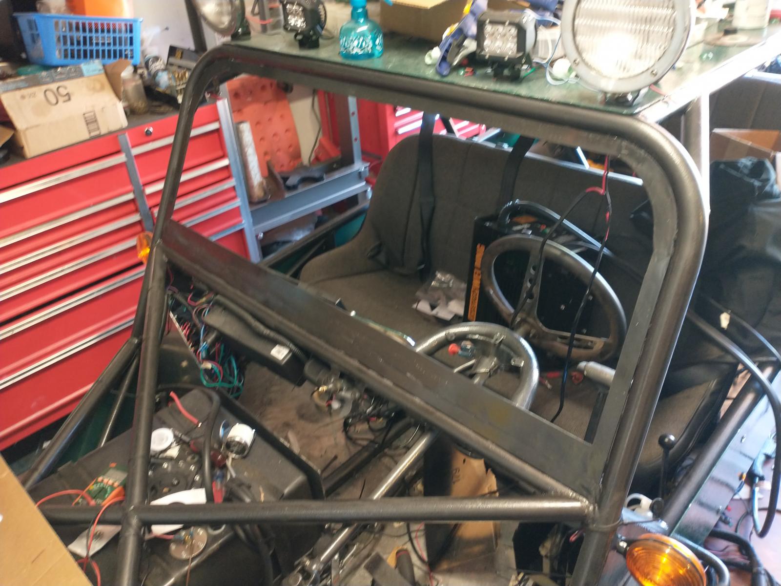

Well I am well pleased with the work I got done today. Not the prettiest work, but I did it and it is done. So the windshield has been a thing that I wanted to farm out, but no one wanted to touch it. So I went and found a windshield on amazon for a 66 Ford bronco as it is flat and DOT rated laminated glass. It measure 56x16.5" so to wide and a slightly shorter on height than I would like.
So I welded in a 2" strip of steel to my lower windshield frame , to make it work. Amazingly that $75 Amazon windshield showed up undamaged in a cardboard box LoL. I bought a glass cutter and watched a few YouTube videos and dived in. I figured I can break two or three windshields and still be time and money ahead from what a shop would charge me.
Amazingly it was easier to do than I thought. Just took my time and it came out pretty good.
So boys and girls don't let it scare you, this was one of the easiest jobs on this thing so far. Cutting a flat glass was not that big of a deal.
Added steel strip to bottom of window opening.
Made a cardboard template out of the box the glass came in lol
After I cut the glass I sanded the sharp edges with a flap disc
Glued it to the windshield flange with 3M urethane windshield sealant.

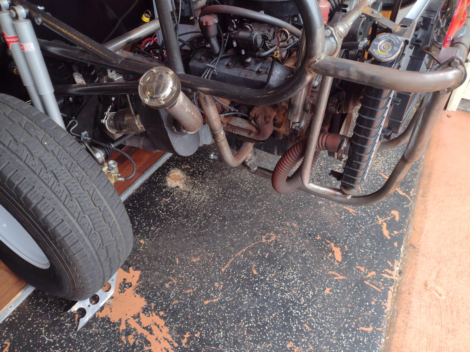

First off I put a new radiator in it as the og s-10 one had a pin hole leak.
