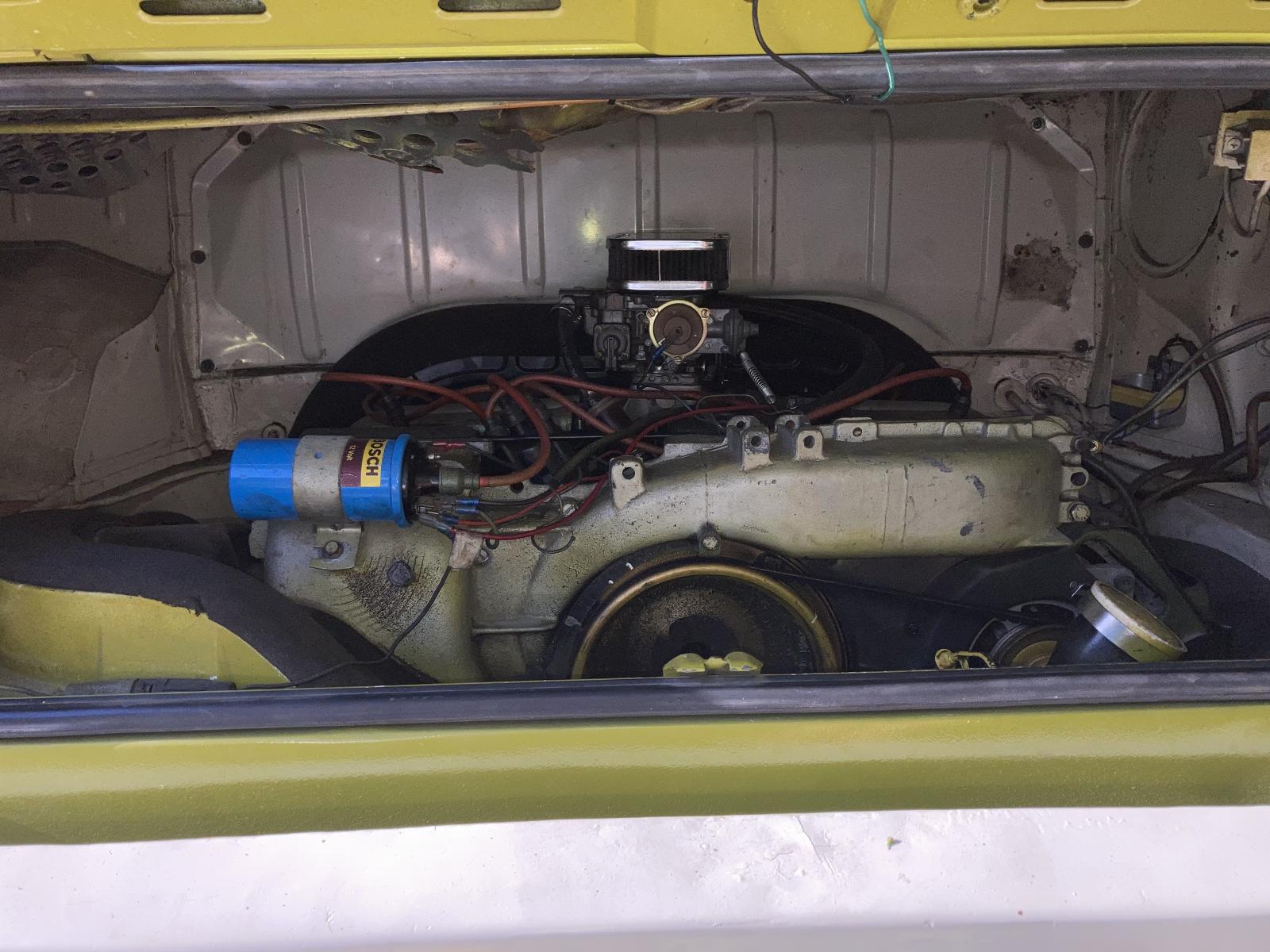

I was going through the Bentley manual and reading up on the carburettor, as I was trying to figure out why the idle seemed to be a little too low on cold starts ( it idles fine after warming up ). Apparently, the OG dual carb setup had an automatic choke. It looks like the OG carbs have been replaced with a weber, which I'm personally stoked about, because I don't have to worry about syncing carbs, but I was wondering if any of you could tell me the following based on the images below:
1. What model of weber is this? I want to do some reading up on it
2. Can anyone tell me what the spring highlighted in yellow might be for? It seems that when I take it off, the idle goes up a bit. I was thinking it might have been put there because the accelerator cable was sticking?
I'm curious what the hive mind's thoughts on this is. What's the spring for? What are the first things I should do to it ( i was thinking spark plugs / tune up )? Did I get a good deal?

i also have the single progressive. on mine, when you take off the spring, the gas pedal loses its "return" from the floor. it is also hooked to the breather box. feel free to unhook it and jump in and flutter the gas pedal (engine off)
you will feel/see what i am getting at. 1973 bus as well

The color of that fuel filter concerns me a little, as for the carb and the trhotle return spring here's some reading: https://www.thesamba.com/vw/forum/viewtopic.php?t=217070

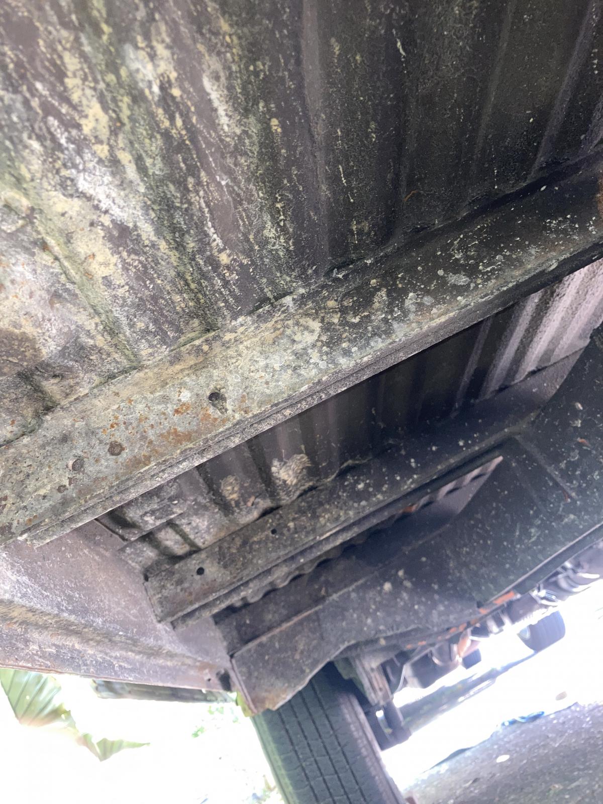

Bus looks okay from the outside, hows the underside? Lets see some interior shots too.

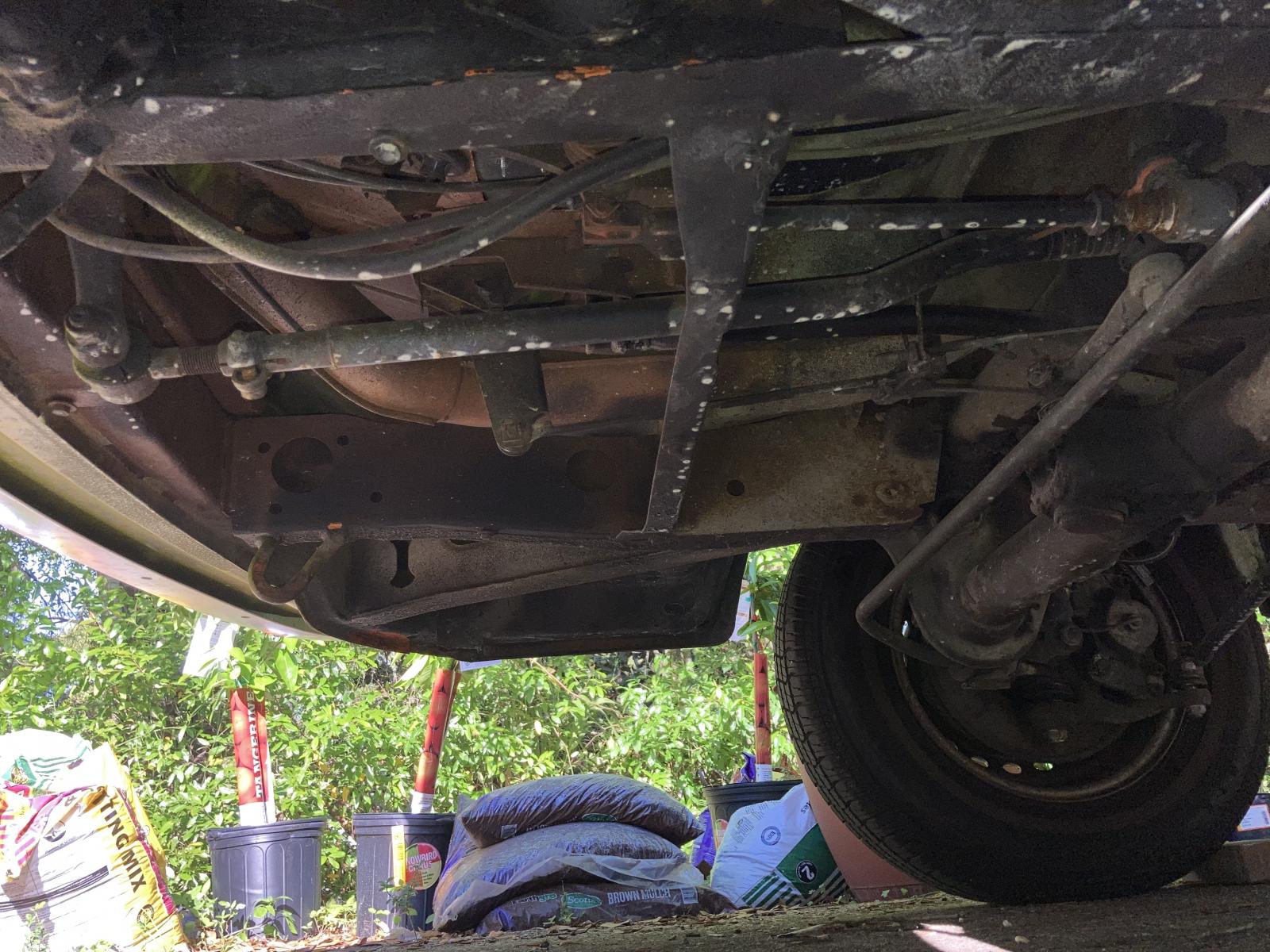

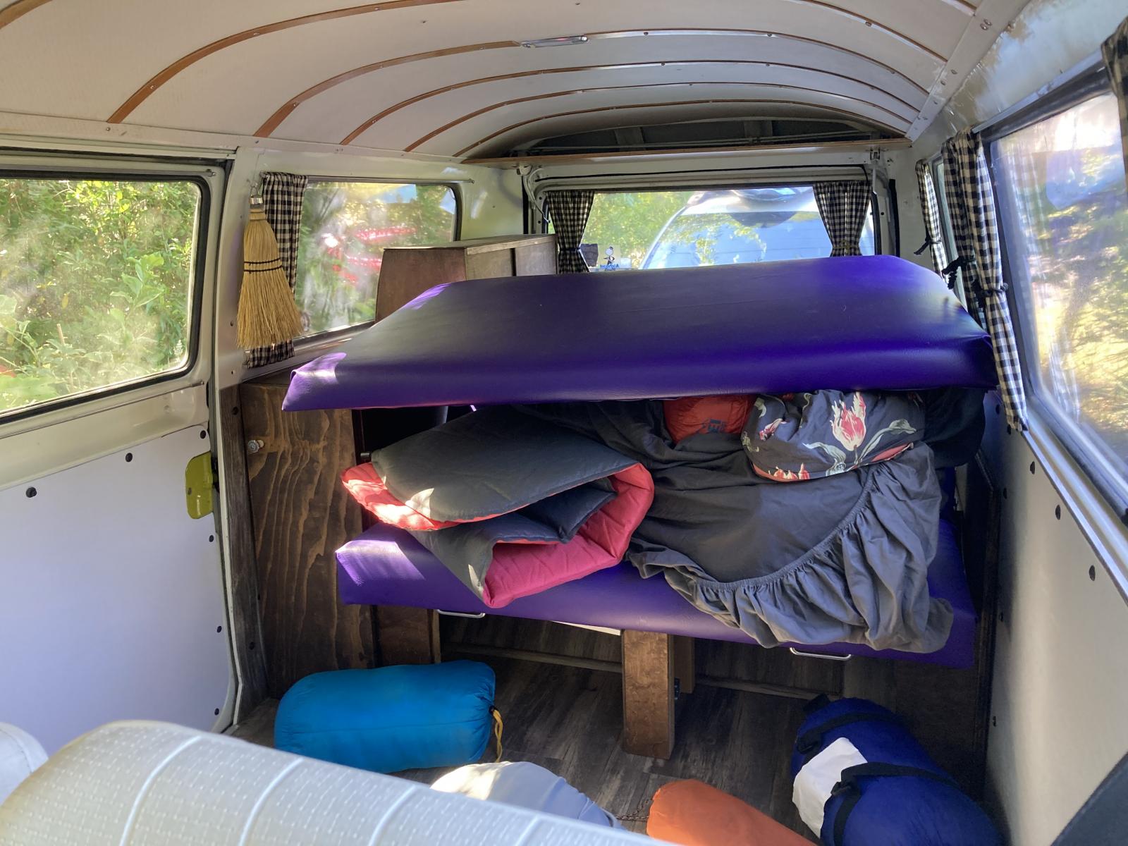

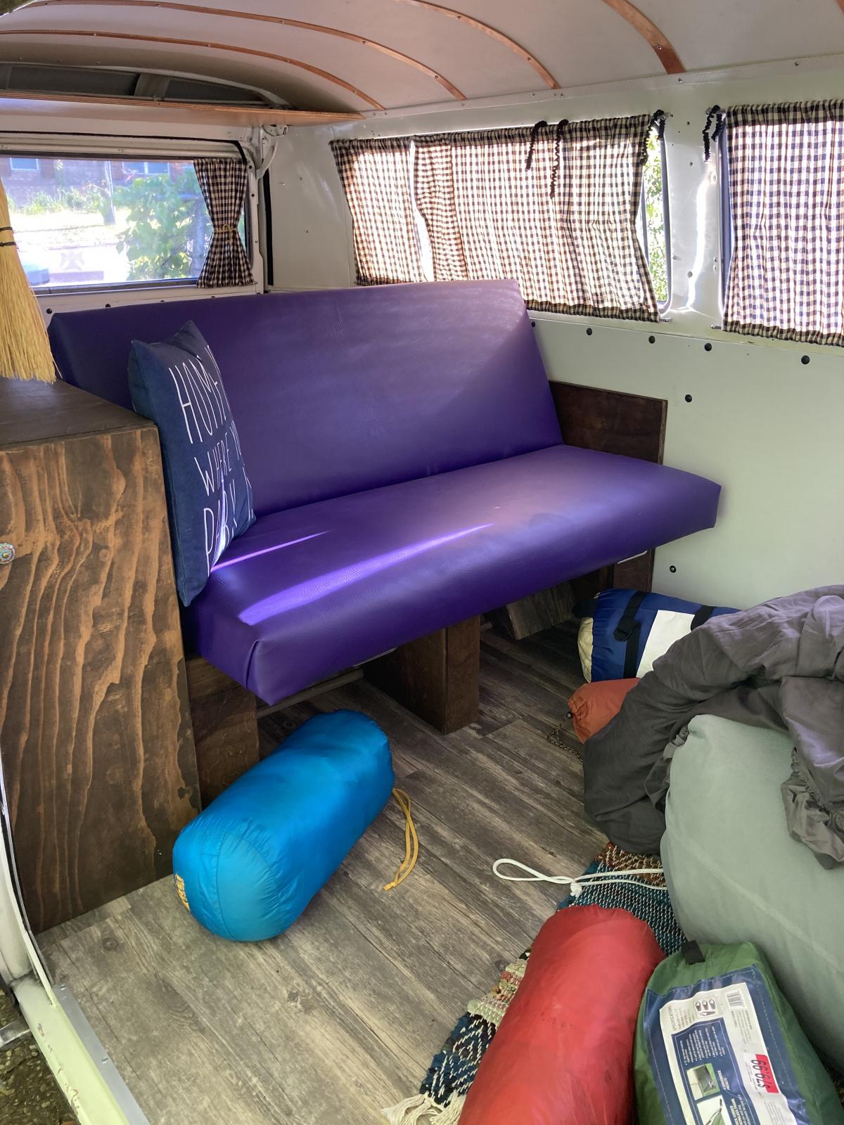

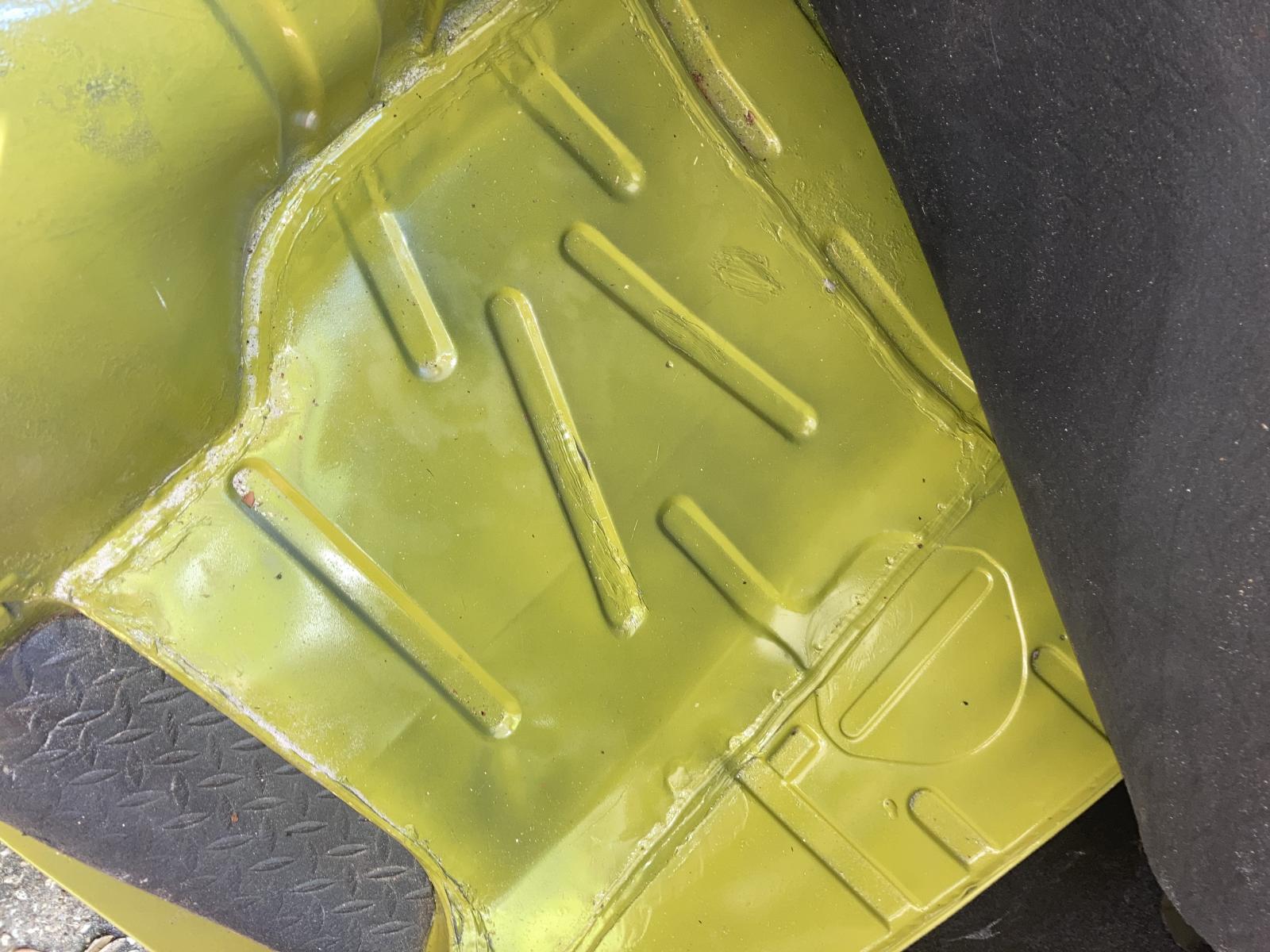

Alright, here's the photo dump for everyone. Sorry about the interior... all my camping stuff is in there right now and I haven't had a chance to organize it yet Smile. And I took the bed apart to get a good look at the top of the motor.
I'll start reading through that! I was thinking about tackling the fuel lines as one of my first projects. I have a fire extinguisher already, but I'd rather not have to use it. Please let me know if you see anything else of concern! I'm hoping to compile a list of todo's so I can start researching.

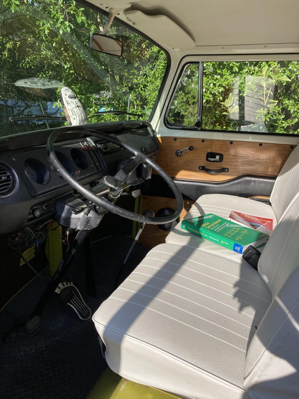

I had that "big foot" gas pedal on my bus when we bought it - it drove me crazy for some reason. I went on the hunt to find an original gas pedal. Just before buying a pedal, I accidentally discovered the "big foot" was just a bolt on cover - the original pedal is underneath
Just sayin' in case you're not a fan either. Smile
Funny you mention that... Earlier today I was scrolling through busdepot trying to find a replacement for both that and the window crank handles Very Happy

Damn, yea everything looks nice. Very interesting interior choice, but I dig it. I want to do flooring similar to what you have, just a big sticker yea?
You'll be on the lookout for a pedal pan, I can't remember what late bays look like

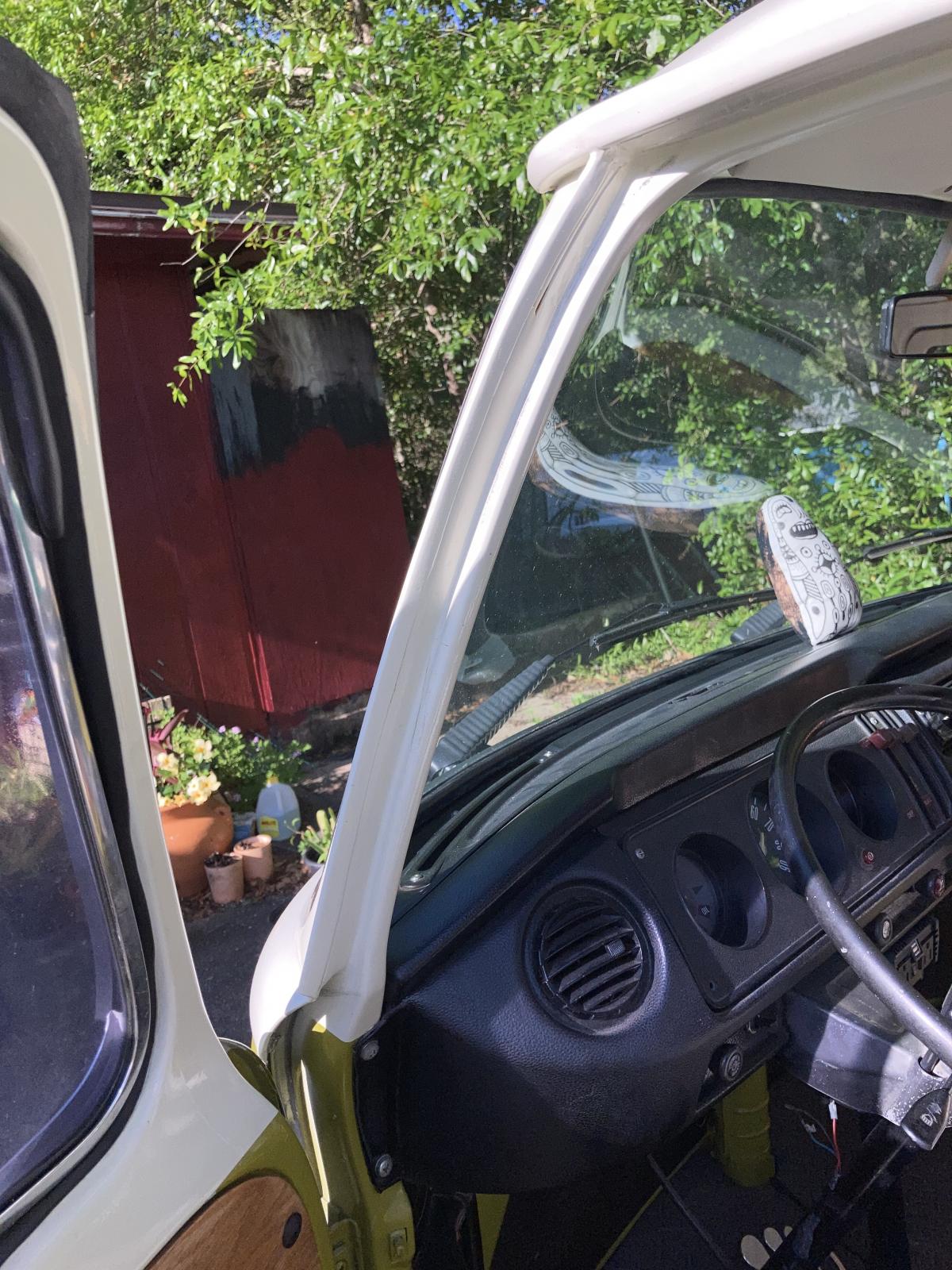

Looks like a solid bus. The frame and front beam look great. Looks like factory paint under original undercoating. The original heater tubes look to be all there. That’s usually the first thing that rusts to bits.
the PO did mention that the heater isn't working. I was planning on asking the hive mind about that once I figured out the idle, fuel lines, and oil light. He did mention that the only rust on the bus when he owned it was the front floorpan, and he cut the whole pan out and replaced it with a new one
https://www.thesamba.com/vw/forum/viewtopic.php?t=597785
Pretty sure it's all laminate, clip together floorboards! Yeah, really stoked on the interior. It was originally a transporter, but the PO built the bed and the cabinets himself. Personally I'm not a huge fan of the purple upholstery... my gf is in charge of the interior for now. I think the plan is to remove the purple bits, add memory foam padding underneath, and reupholster with something with a bit more 70's vibe / feng shui Very Happy
