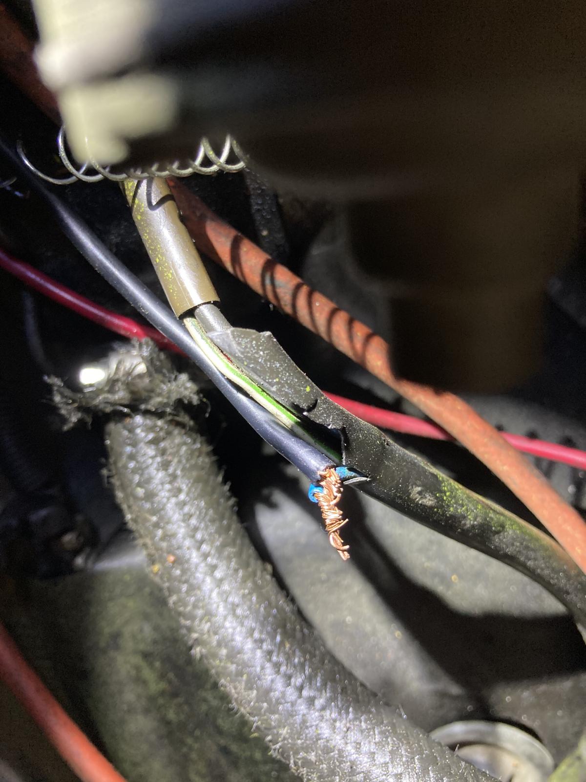

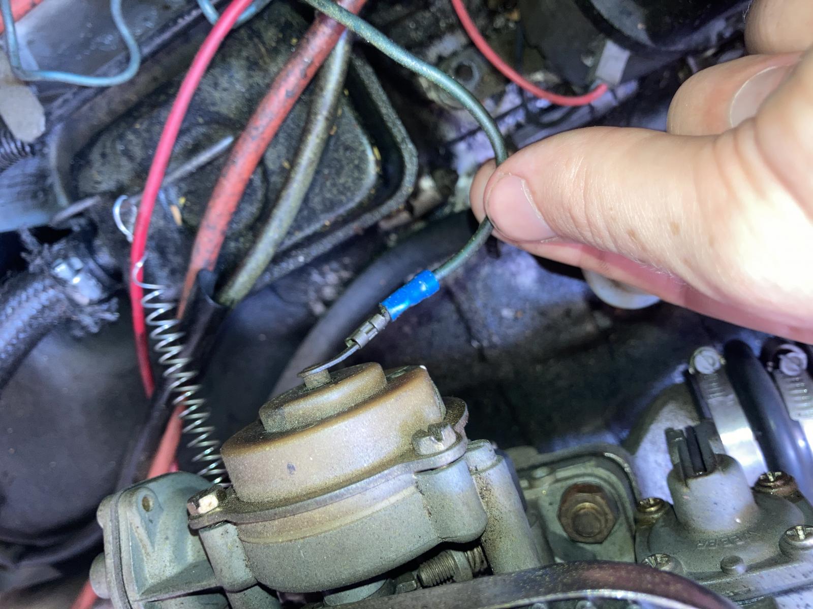

So, taking a look at it again... It looks like there's a green wire that goes from the ignition coil to the weber carb. Could it be that the PO removed the oil sensor because they needed a 12v connection for the electric choke on the weber??
wire being touched in both photos is the same wire. one end goes to the ignition coil, the other goes to what I assume is the electric choke on the aftermarket weber carb.
Ordered an oil pressure sender, should be here by EOD. Also ordered some other stuff from busdepot... extra bulbs, dipstick oil temp sender, fuses, and a replacement fuse box cover, cause it looks like mine is missing.

That was added by whoever installed the Weber, the oil wire doesn't supply power. Follow the black wire that one is teamed up with on the coil up to the roof of the engine compartment, sooner or later it'll become a thin harness near the booster fan mount, the blue/green wire is in that.
If they did that, it was a bad idea.
Yes, that is your electric choke. Power for the choke should come from a new separate wire, direct from ignition coil +, to the terminal on the choke. If that's not how it's wired now, wire it that way with a new wire.
Keep in mind that the oil pressure sensor does need 12v+, but it needs to come through the bulb in the dash, like we talked about. Not just regular battery power like the electric choke uses.
Alright, I've followed this black wire, and after cutting back some of the harness, I found and connected the new sensor to the blue/green wire. Going to turn the ignition, and the oil light still doesn't turn on. the bulb looks ok... is there anything else I can check?
Do the rest of the idiot lights work?, specifically the charge light?, if they do the bulb is the #1 suspect.
