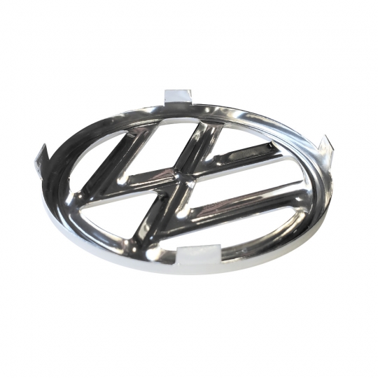

I've seen pictures of what looks like clear putty or wax over the emblem tabs under the bonnet/hood. What years would have had that, and what would it have looked like?

I heard the seals called witches hats. The replacement seals in my bug are some kind of squoze on putty

Does your emblem have pins or tabs?

Pins. Was the putty used for tabs?

The later models with pins used these, pressed into the hood first, followed by the emblem:
Earlier models used tabs, which I think were sealed with a putty similar to that used to seal the tab gaps on the back (front) of the dash.
But those with early models can confirm or correct.

Crests use these rubber seals, which look to has a slit. I can't tell he scale, though, and they are listed for the crest, not the VW emblem.
https://www.wagen-werks.com/hood-crest-gasket-bug-to-1962/

Seen some original 1950s beetles that used butyl rubber AKA Dum Dum sealant. That type of sealant comes in a lot of forms from somewhat liquid in a can, to caulking gun tube, to ribbon tape. The last is probably the best for your use if that is your situation.
